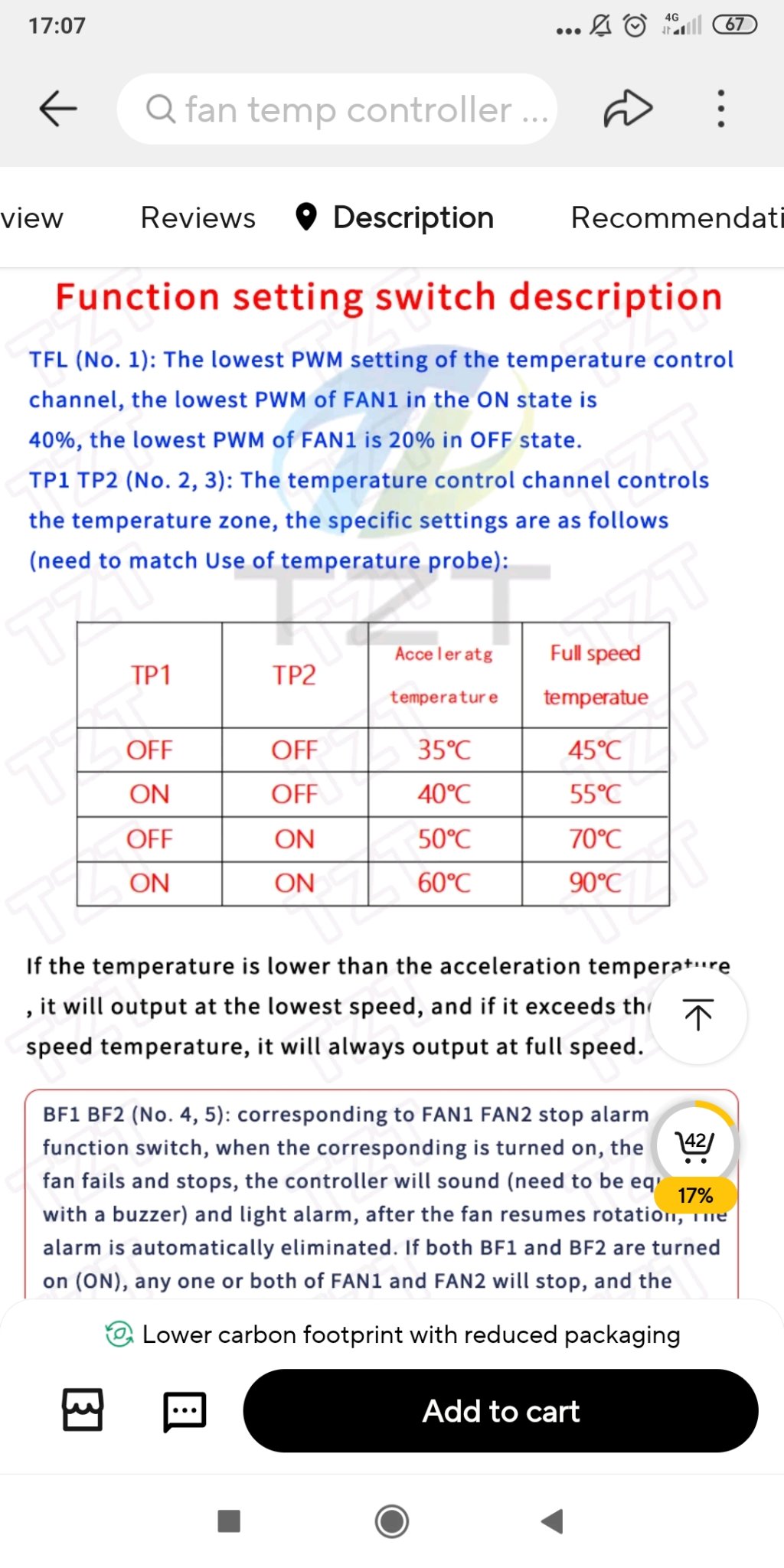

As I use a 20mm diam washer on top of the mosfets ... it is hard to measure the temperature of the body. So I point my laser temp gun at the head of the bolt which clamps the mosfet to the heatsink.
. My assessment is that the operating points of the outputs are on the limit; my view is that dissipating so much heat we should monoblocks; perhaps 4U would be OK but each heatsink could then serve ONE output device, not two. You can see his excellent work at #3045 post in this thread, in fact.
During the beautiful journey of building this particular amplifier for me, I tried to place the mosfets in a common heatsink 41cm x16 x 5 , the ambient temp now in my room in Greece is 29-31 C we always talk about version 4R and I know it's forbidden. The temperature that develops in the body of the mosfet scared me quite a bit. Since I have nothing else hahahah. Τhe transistors of the power supply must not be placed together with the mosfets outputs. I have mentioned this in my previous post...I said NO WAY.....
Then I'm fine...I measure on the metal surface of the mosfet about 50C and on the housing on the mosfet about 45 degrees Celsius. This with the second stage setup 40-55C of the controller pwm fan where the fans play much more relaxed and are not heard at a distance of half a meter .
Thanks Mr Hugh.

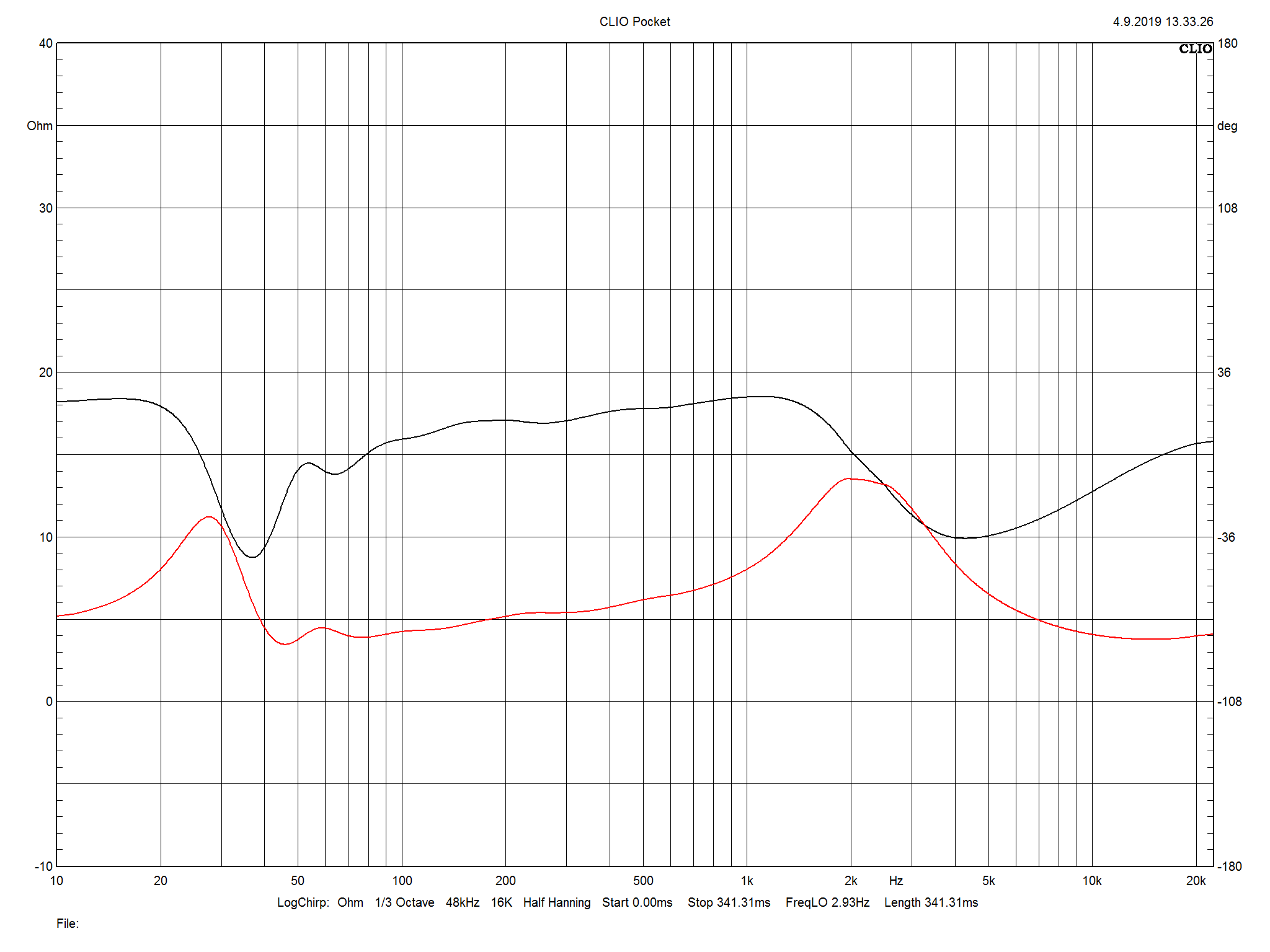

@rdb64
Looking at the region from 50Hz to 5khz, much of it is in the 4-6 ohm range. Usually if it’s a true 8 ohm speaker, I usually don’t see much of the range below 80% of 8 ohms or to be accurate, not less than 6.4 ohms. We can round down to 6 ohms to make it simple. Your Sonus Faber’s have several large ranges where it is comfortably below 6 ohms and even at around 5 ohms from 10khz to 20khz (where there is comparatively little music). As such, I would choose a 4 ohm version of the AN39.
Keep in mind there is still a lot of musical information particularly midbass, between 50Hz and 200Hz and you are solidly in a 5 ohm region there.
And finally, your phase angles are fine for the most part although at 40Hz, you do have -36 degrees and 4 ohm, which will demand current from your amplifier.
Best,
Anand.
Best,
Anand.
Great analysis, Anand! 👍
Totally agree with your conclusions. (And the TAS review I found put them as 4ohm spkrs!)
The only thing I would worry about ... is the power available from the AN. I suspect these SFs need more than 40w to make them sound their best.
