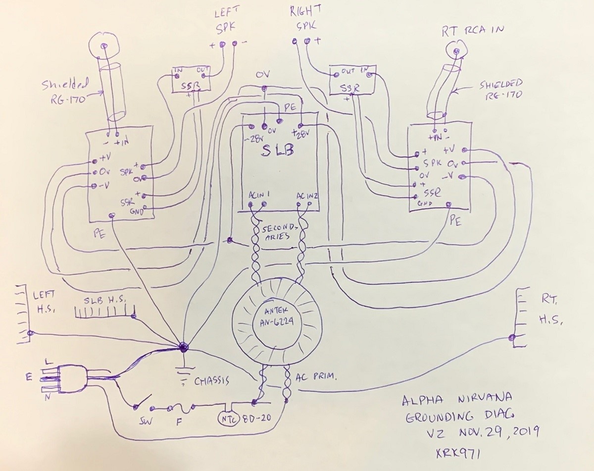

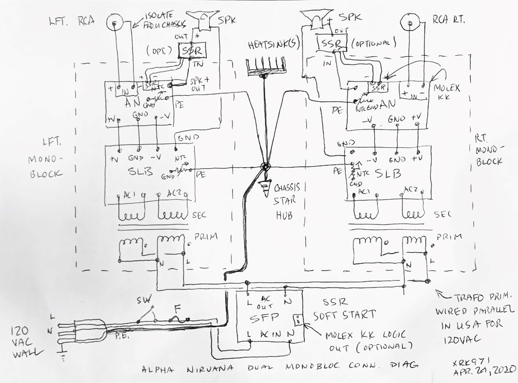

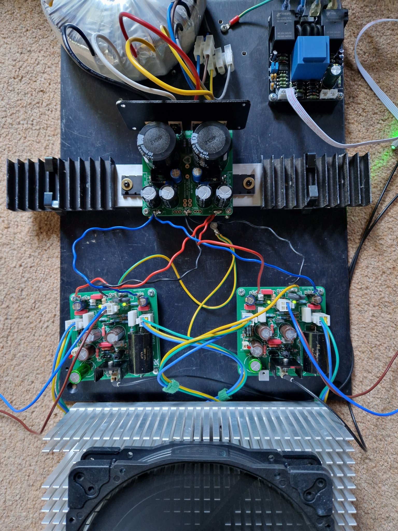

greetings! I’ve been working steady on the an39. I have gotten the soft start and the slb to successfully work. Now I am finishing up wiring up the amp boards to fire up. My worry is that I’m not understanding the wiring. Can someone post a pic of there board hooked up to an SLB? I’m having a bit of a lack of confidence as to where the + - wires connect on the input and output. Also, just want to make sure I’m connected correctly. Thanks for all the help everyone!
I measured one side which seems to be working correctly. On the NPN and pnp G=21v, S= 26. On the other othere side I’m getting NPN G=9v, S=13.5v. PNP G=34v, S= 39v.
