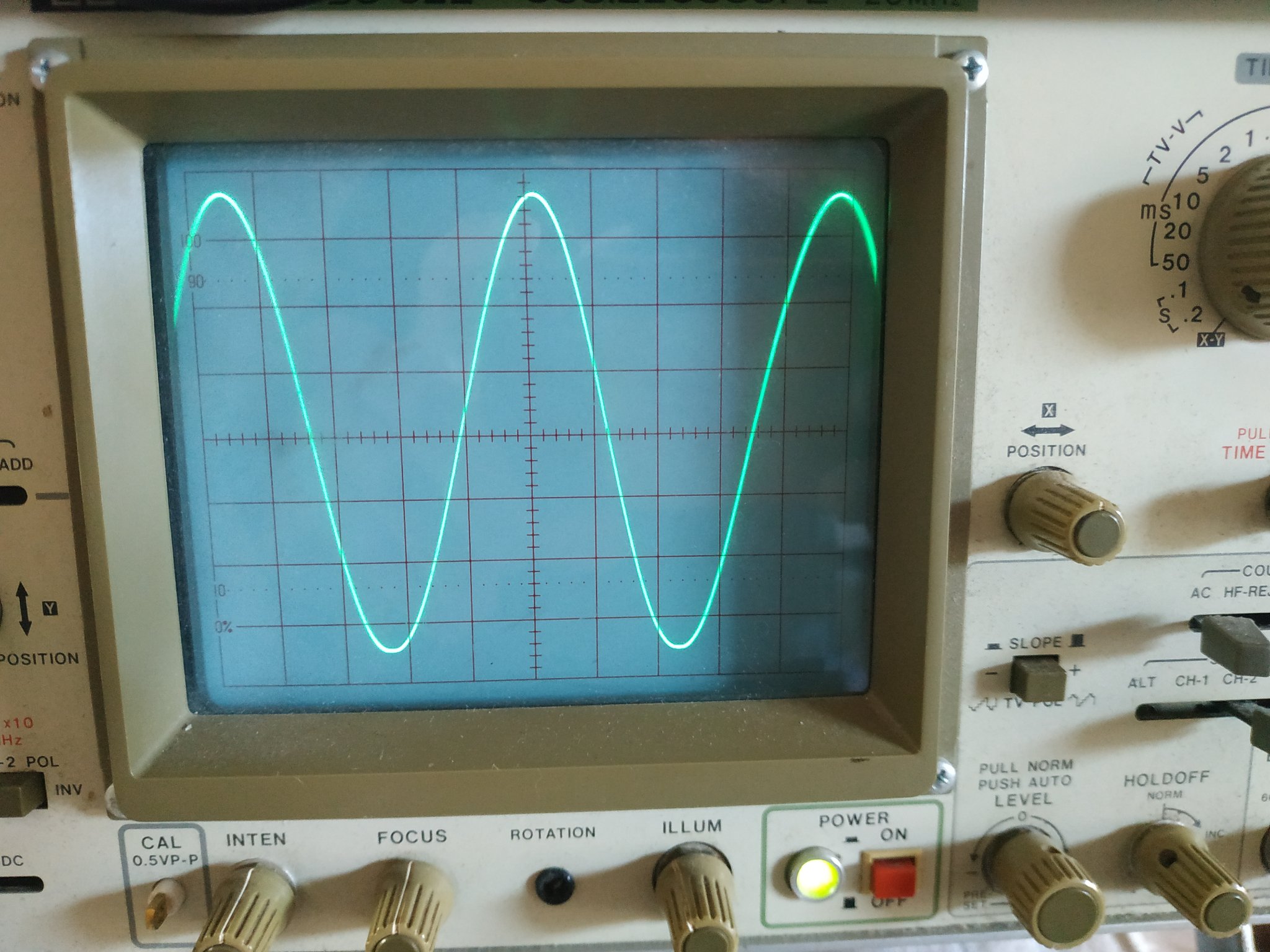

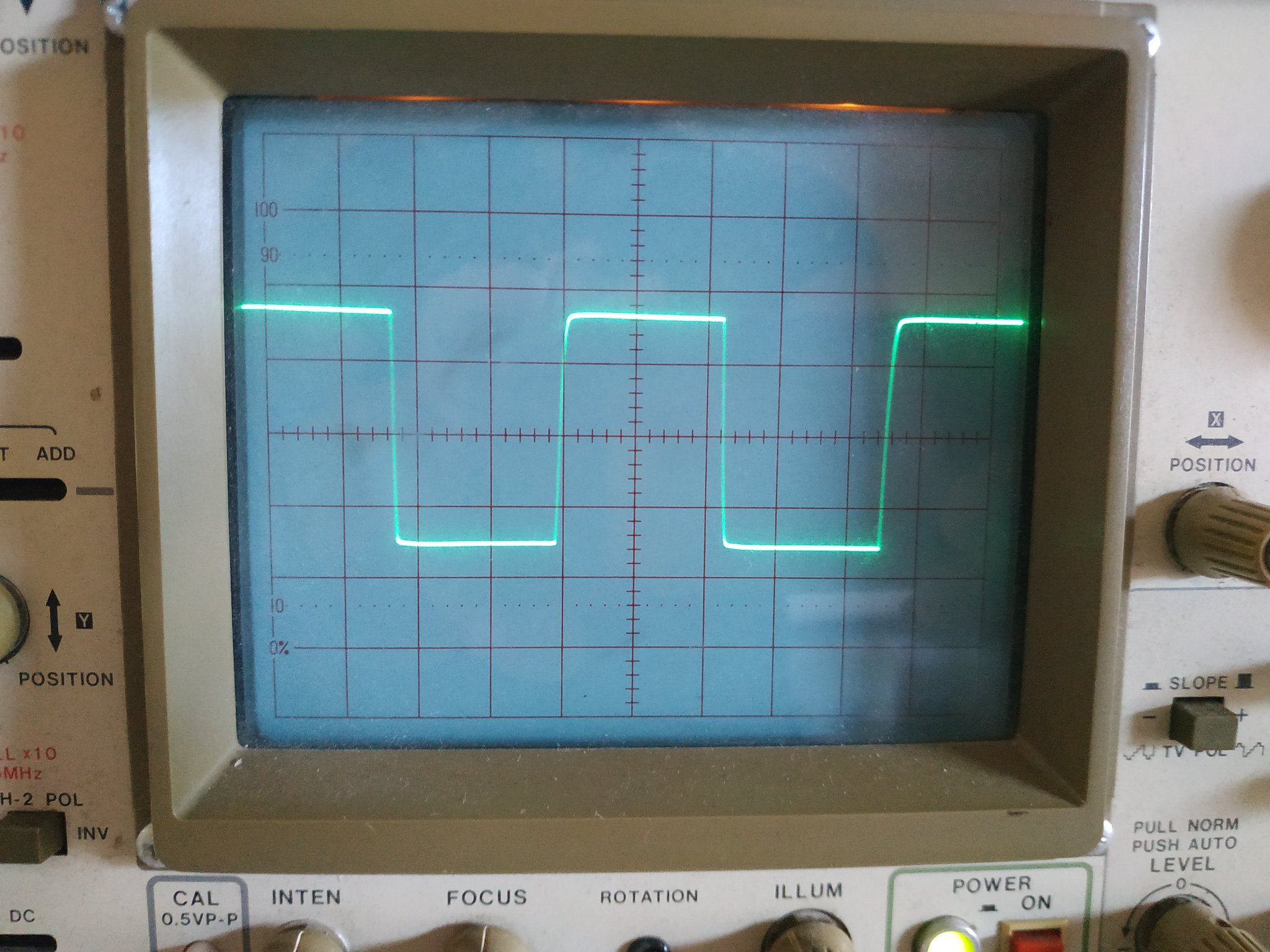

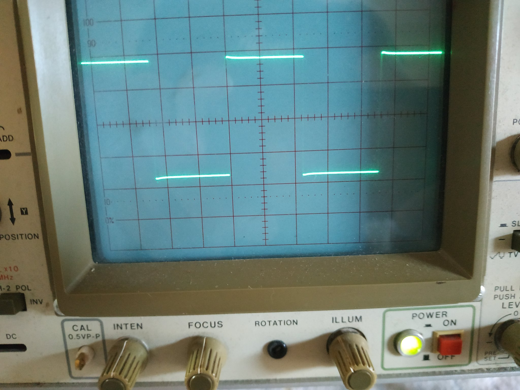

Load 3.8Ω
1. Sine 1khz wave before clip about 37-38 volt p-pk and my true rms multimeter shows me 12.67-13Vac
2. 1khz square wave about 18 ppk
3. 10khz square wave about 17 ppk
4 . Load 3.8Ω
4 . Load 3.8Ω

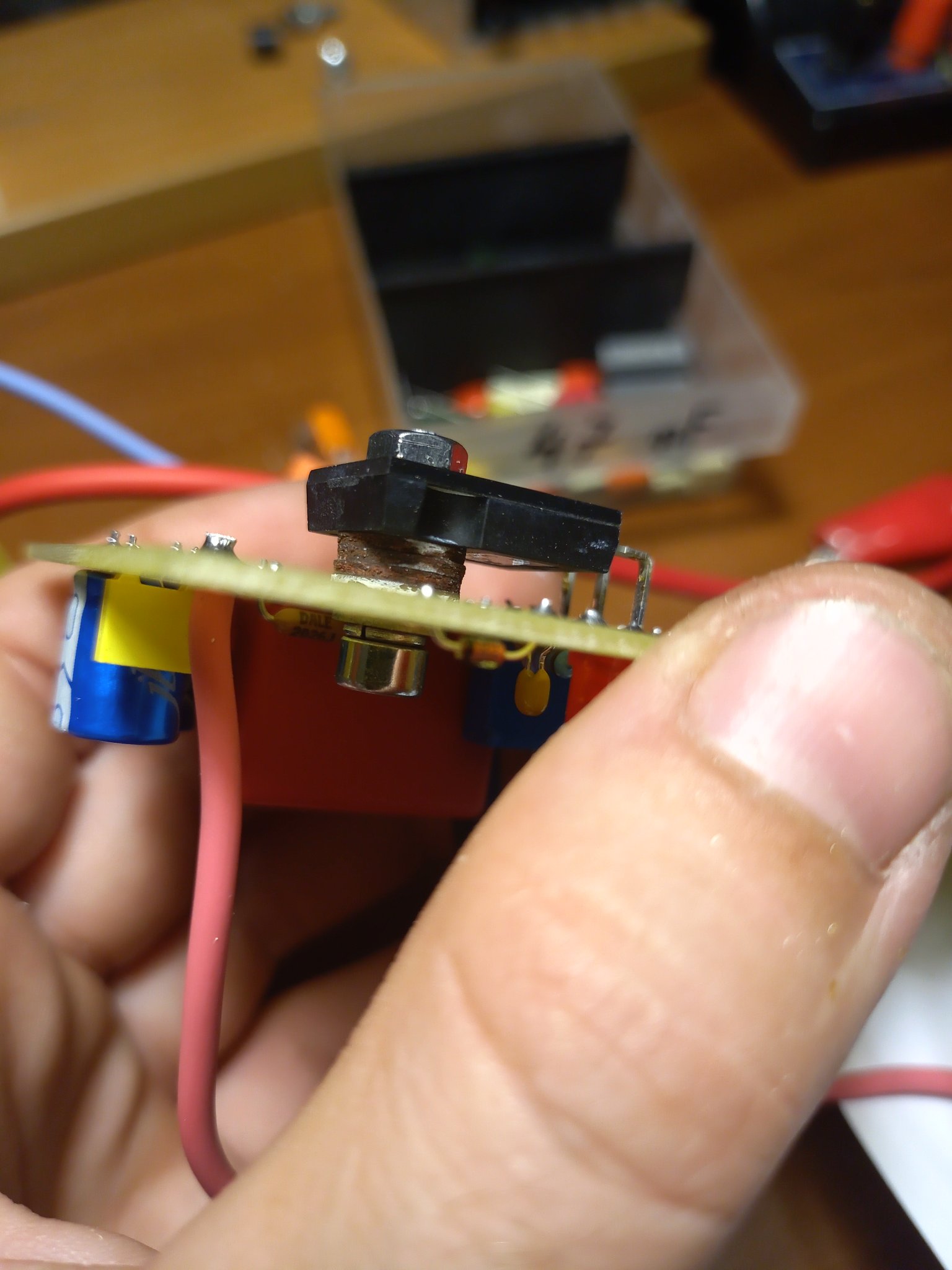

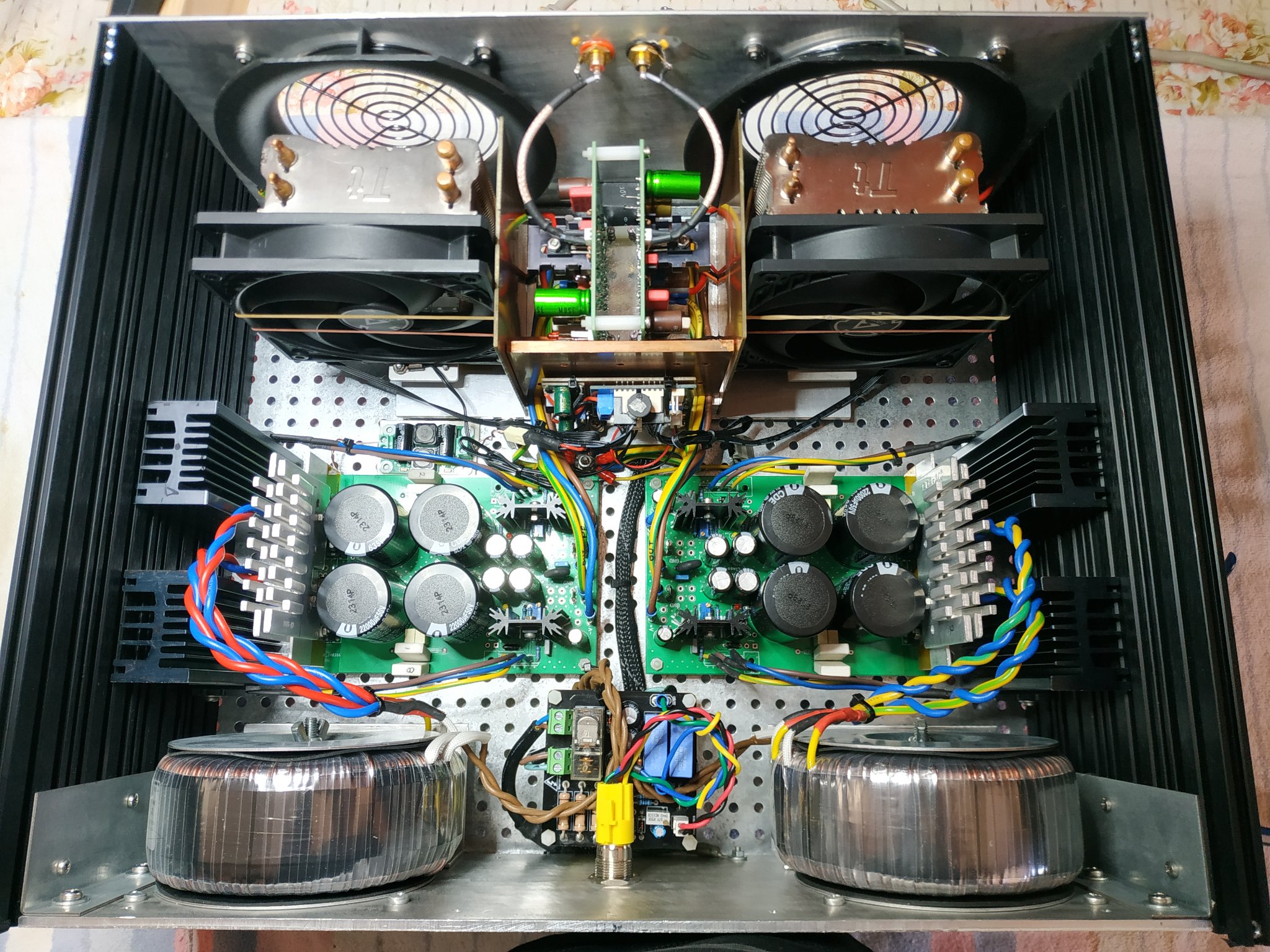

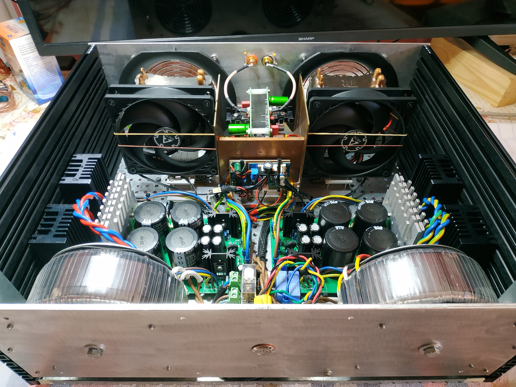

This weekend unbraid my mosfets wires.... painful...
It's really annoying to take apart a finished and working device...it's not a fun thing to do 🙁

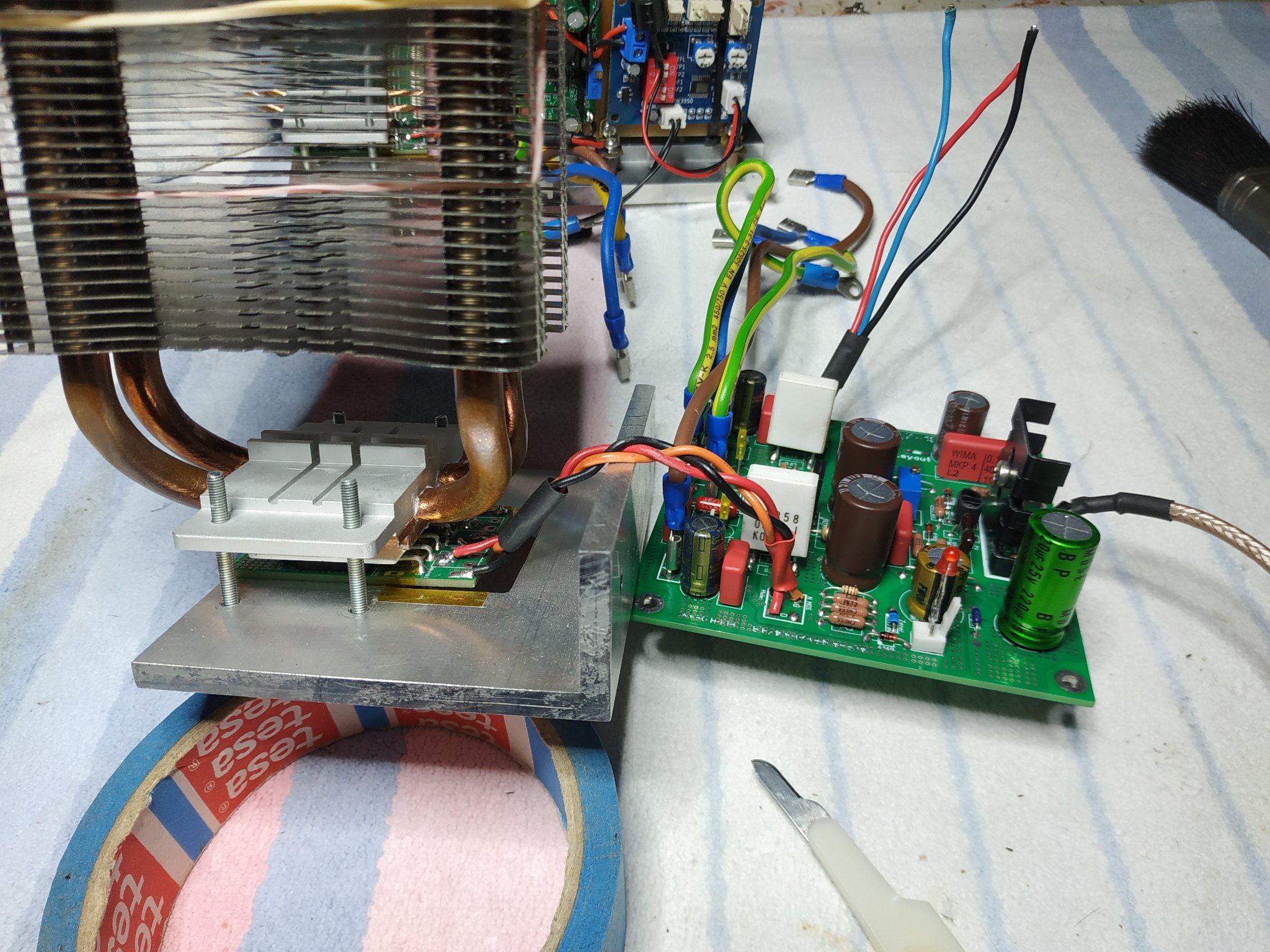

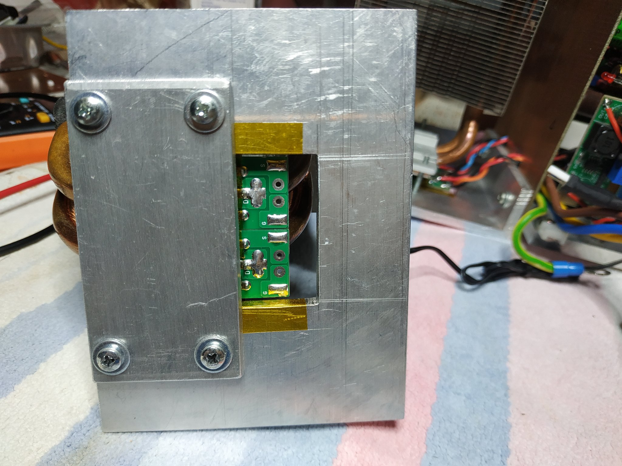

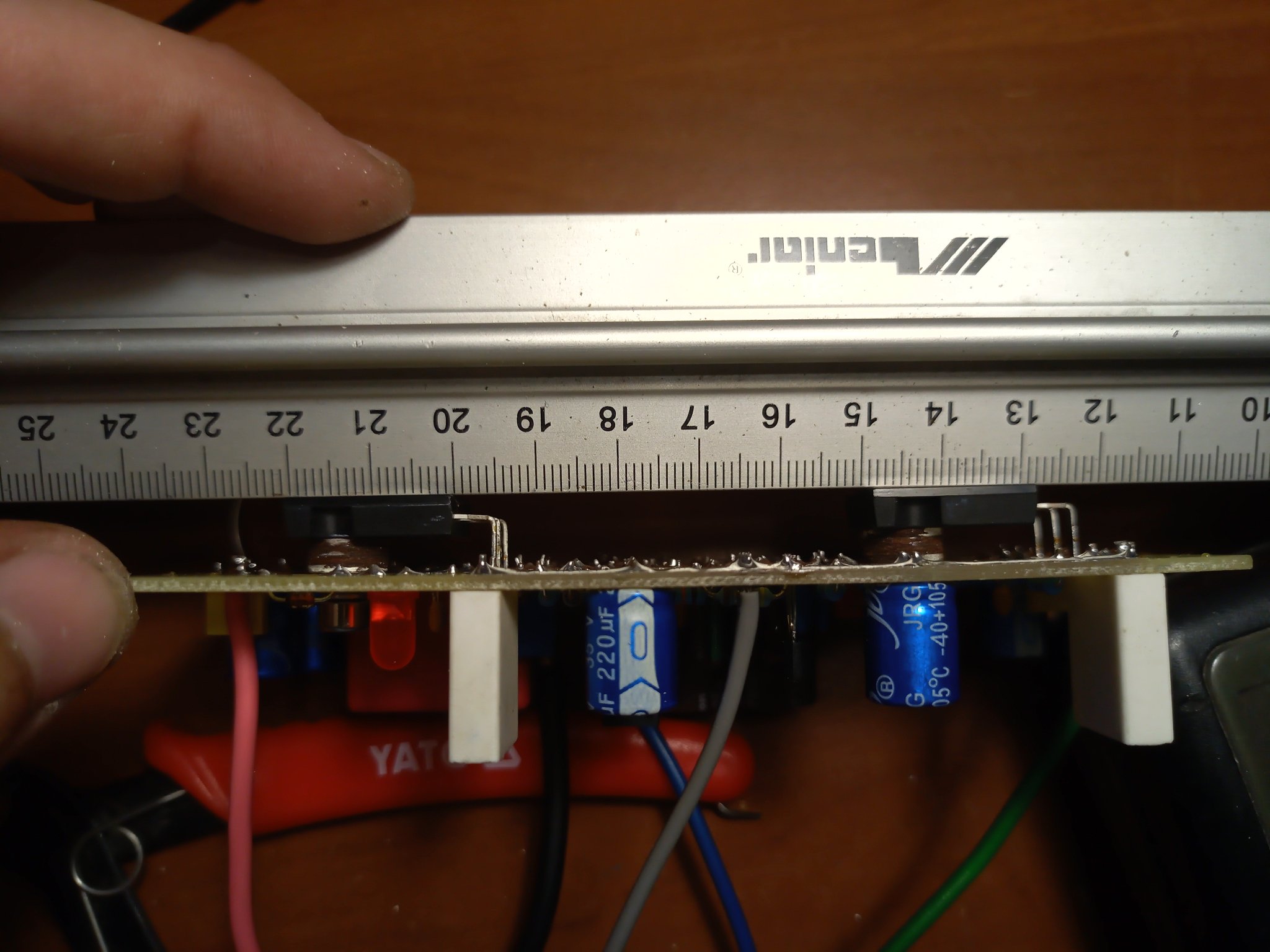

And I didn't spend time on the amplifier for listening , I wasted a lot of time on the changes... I also removed the 100Ω gate resistors on the main board i did some sine -square test without load ....everything its ok.

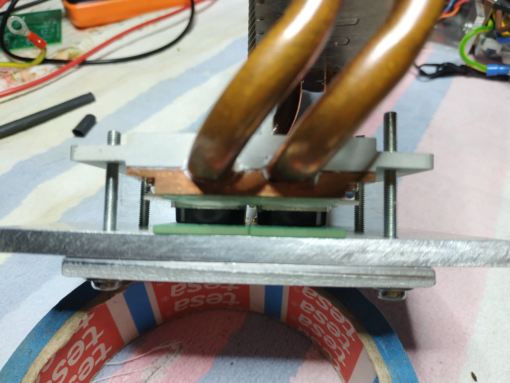

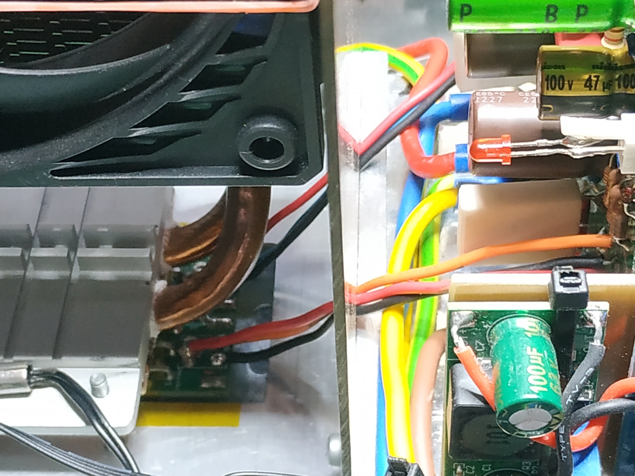

I also put a 5mm copper shield between the ΑΝ39 boards and the MCU fan it seems to slightly affect the output with optical noise the output of my amplifier, meters in AC mv about 0.45-0.60 mv on my cheap multimeter dint change after that ....
Μaybe I should move this board further but I have no reason since I have no noise at all even if I place my ear deep inside the woofer, only visual indication on the scope..we talking about 0.0.. Ac μv.

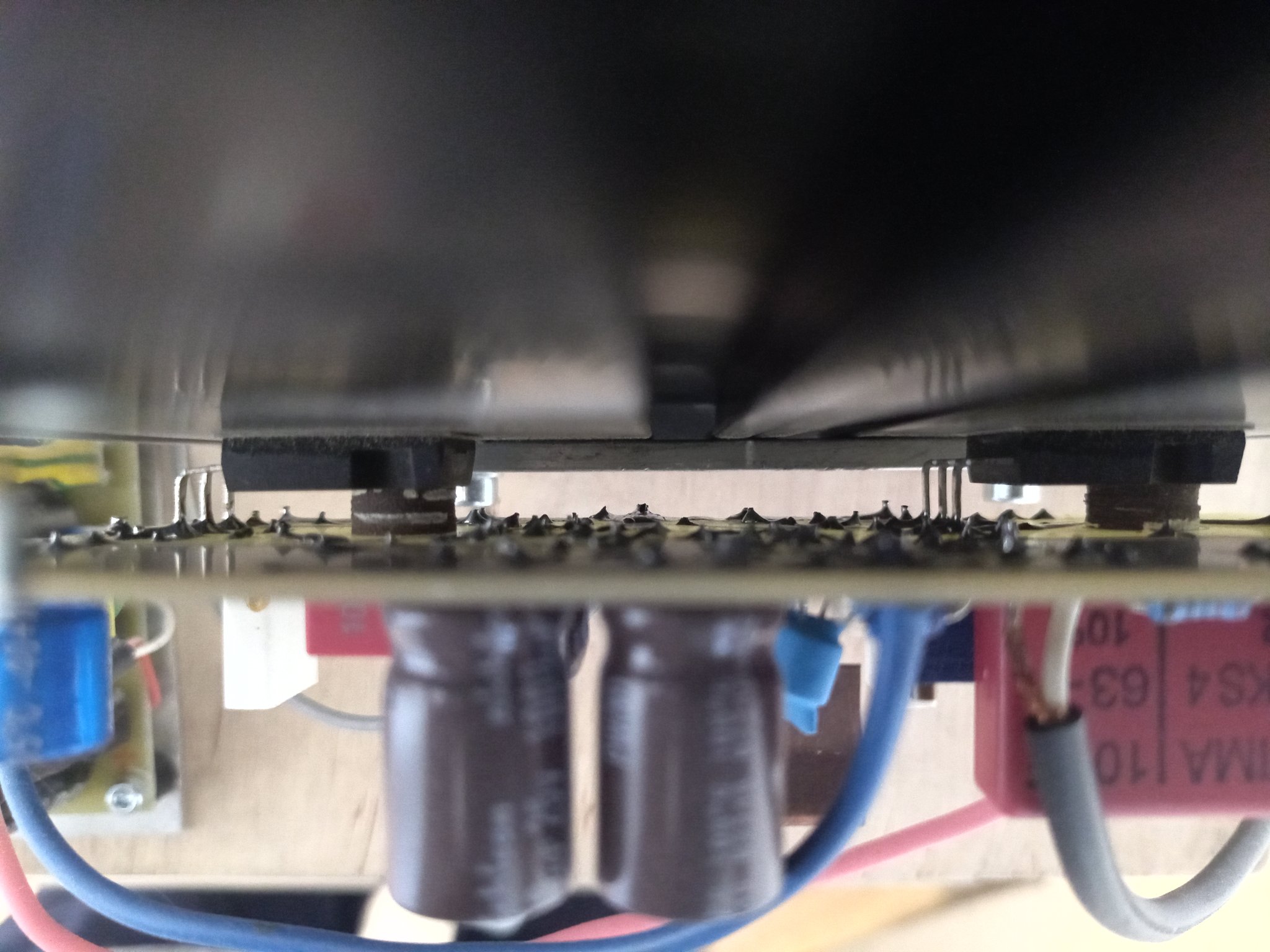

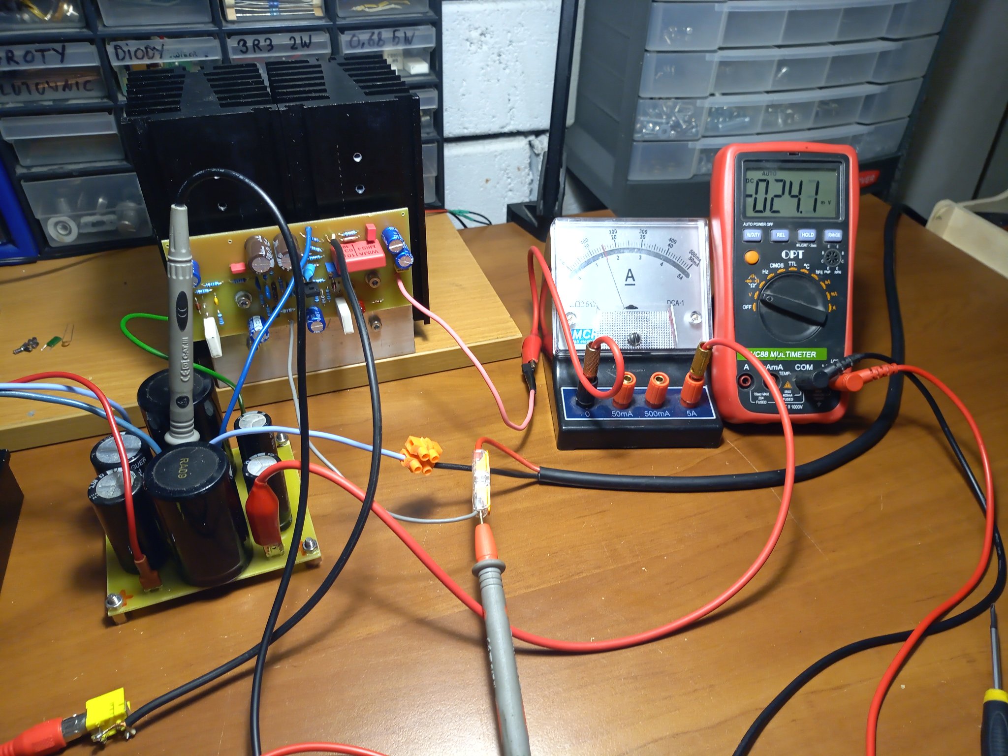

A slight update on my amp, replaced the 0.22 biasing resistors to 0.15R/5w on both sides. I could set the voltage to max of 8.3v one channel and 8.35v on the other across the 3.3k resistor, as the trimmer is out of turns at max. I could see the bias is now 0.7v on both the channels giving me around 2.3A current (4.667A) measured across both the power resistors. Heat sinks are able to hold on to the extra heat measuring 350/150/55mm when I ran for more than an hour. I am liking the sound with this bias with my PAP clone 4 ohm speakers 🙂

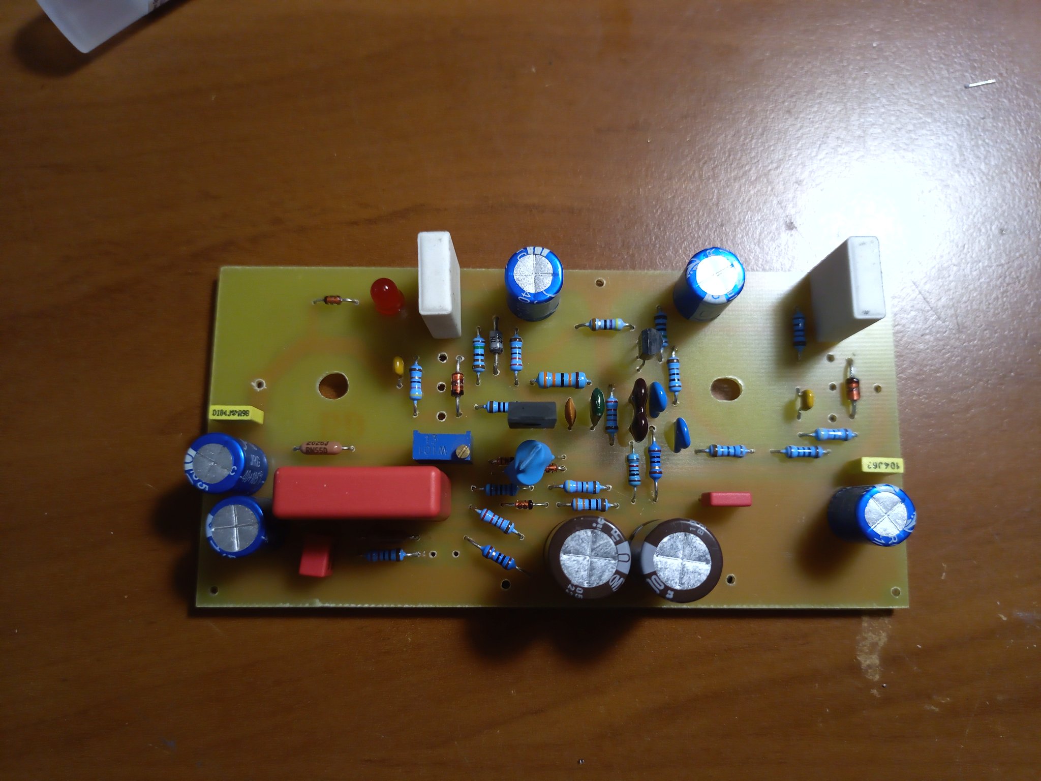

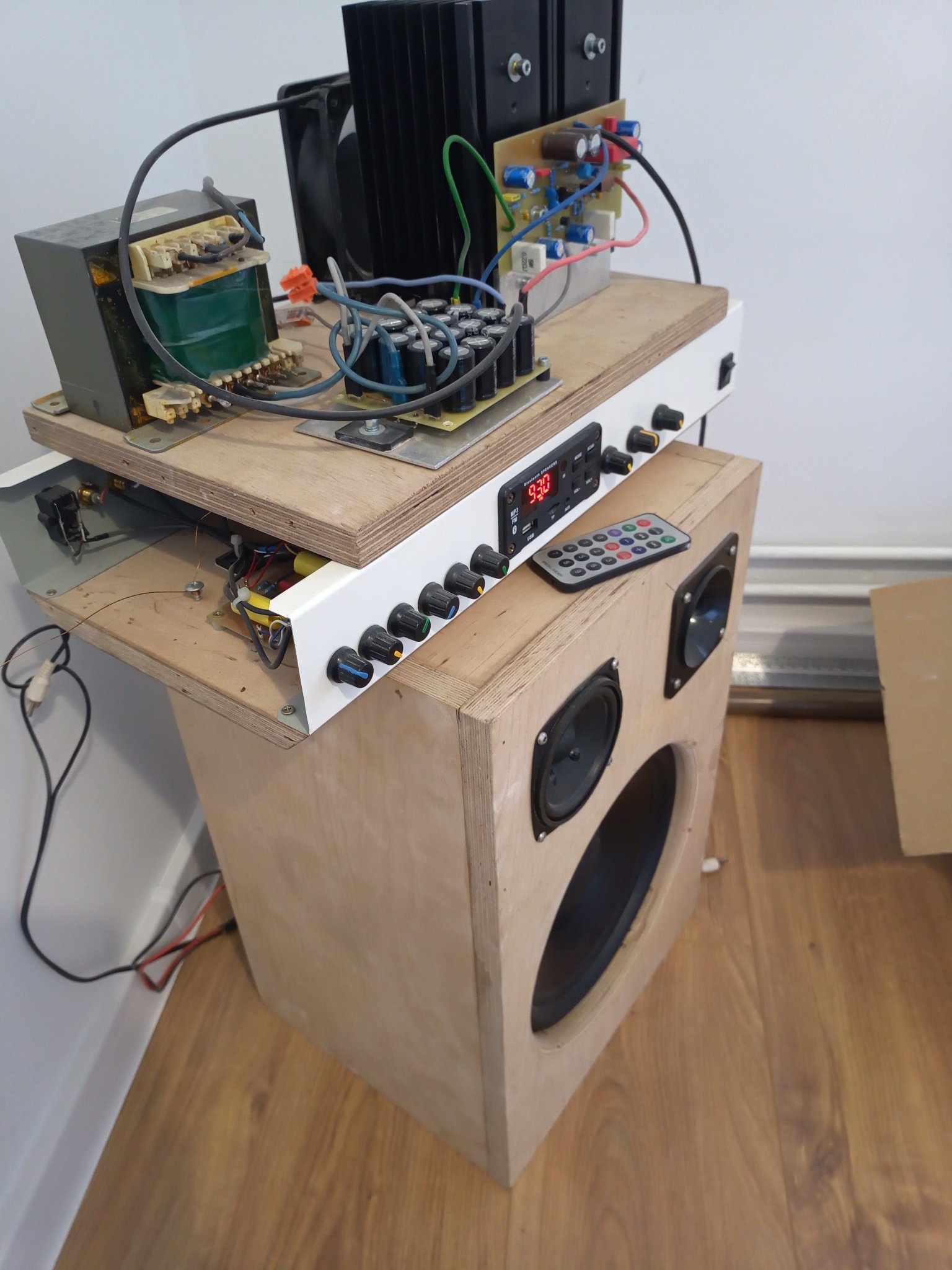

Here is my amateur prototype build of AN 8R 😉
I'm very satisfied by the sound. Super low frequency and the rest too.
There is a lot of power from this little class-A thing and that is best.
It is running on +-22V 1,5A and here is some current on the output when amp is warm and stabilizes at abut 10mV when hot(49 celcius on heatsink).
I took it as a mono radio setup to my apartment to listen while renovating the bathroom and kitchen. The speaker is also prototype one with Mr Nelson Pass idea of passive 3-way filter (as much as possible xD). Another advantage are cheap parts. Cooling is problematic but with a little fan it is possible to use higher voltage and current up to 2,6A. I use 2X850gram alu heatsinks. PCB is mounted by the same screws as output mosfets for easy unmounting. I will make a stereo version for sure also with less power as it is enought for my needs and saves energy xD
Thanks to the inventor for sharing this great amp.
