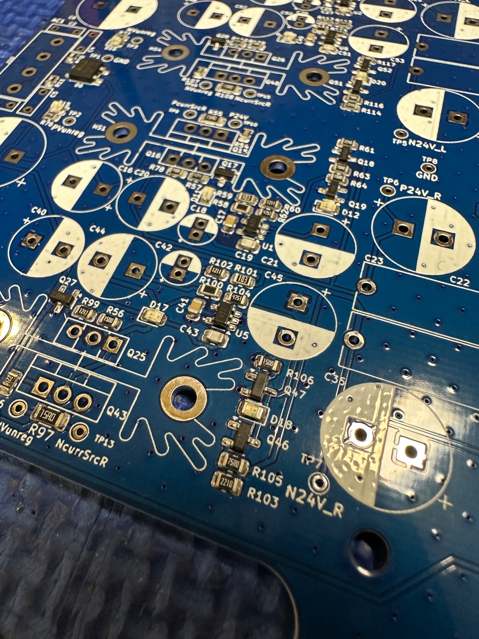

The few SMD components in the AN project should not be driving force to abort the mission. There are other aspects to successfully building an amplifier that should concern you more than a couple surface mount parts.
Like any project proper tools go a long way in accomplishing your goal. A quality solder iron with easy to swap tips is a good starting point (Weller & Hackko are good examples), eye magnification headgear is a must, look on Amazon. No hot air station is needed here, just a fine tip, flux and eye magnification.
With all the good through hole transistors going EOL, surface mount soldering is going to be the only choice if you want to stay in this hobby. Sounds like you're not afraid to give smd soldering a go, great! The only way to get better is to dive in.

SMD need not be so hard. Just a fine clean tip, tweezers and a magnifier is all you need. Dot one pad with a modest blob of solder. Get the component on the board, place it on the opposite side of the footprint to the pad you blobbed. I use my right hand to gently hold the component in the tweezers whilst melting the blobbed pad with the left. Slide the component into the molten solder and check the placement before you remove the iron. Solder the other pad and that's it. A 1206 is easy, I can do SOICs and 0603s with not too much of problem. Some solder wick is handy if you get enthusiastic with the solder.

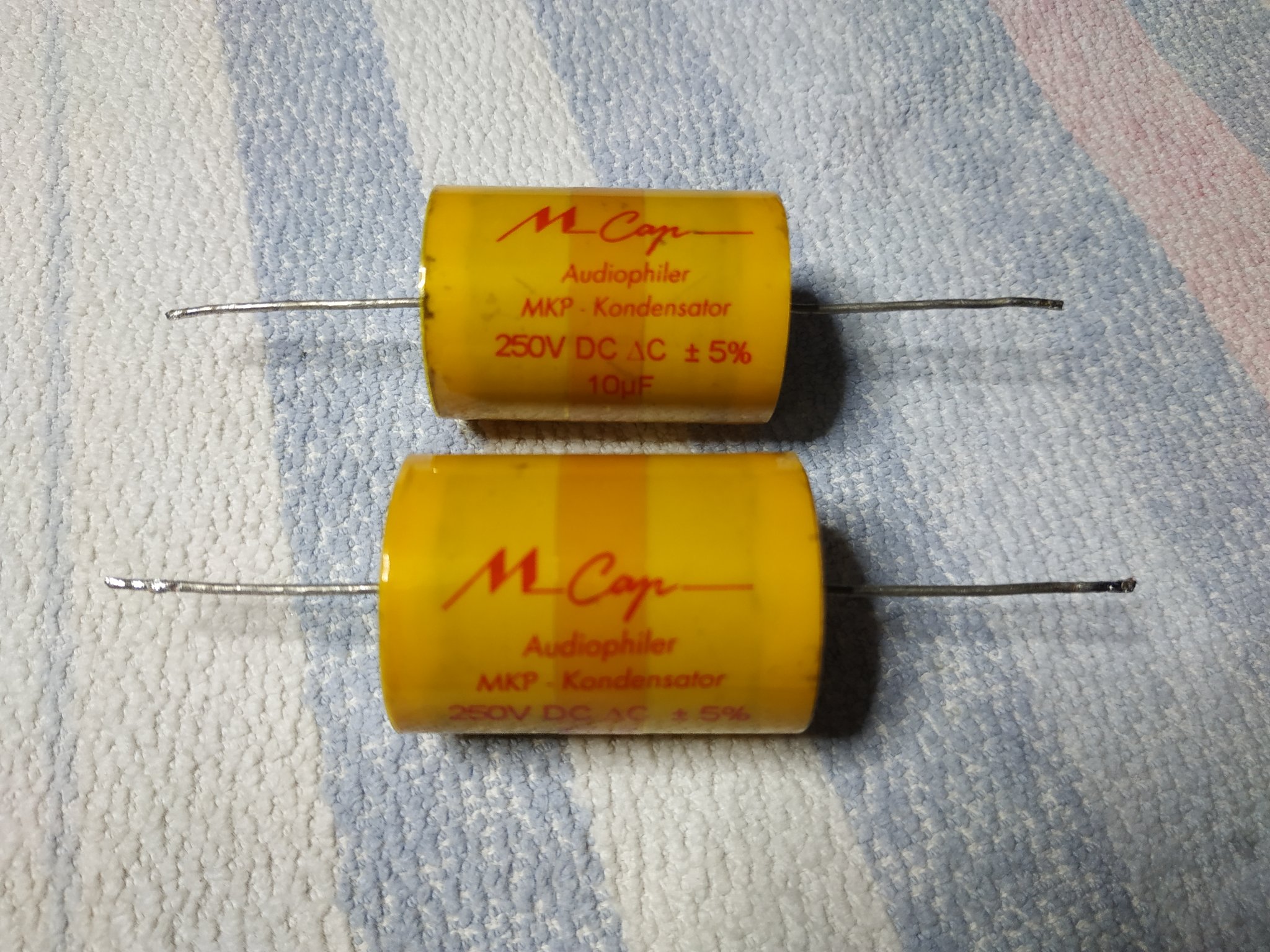

The last change I made to my Nirvana amp was to replace the input capacitor from which it was Έlna silmic electrolytic In a simple M cap 10uf/250V The difference was very noticeable for the better. I would also like to proceed with reducing the feedback gain 22k/820 to 22k/2.2k or 1.8.k since I have version 4R I would like the opinions on this from those of you who have done it.
It is truly a very detailed and colorful amplifier, very pleasantly surprised.

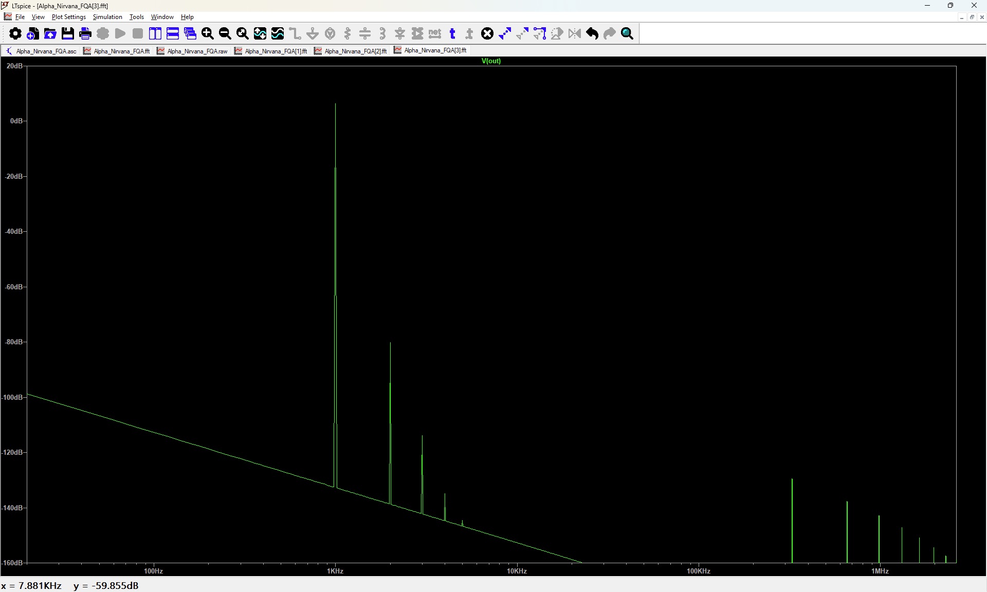

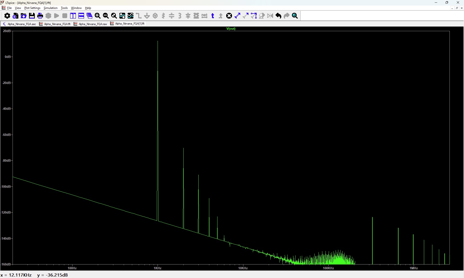

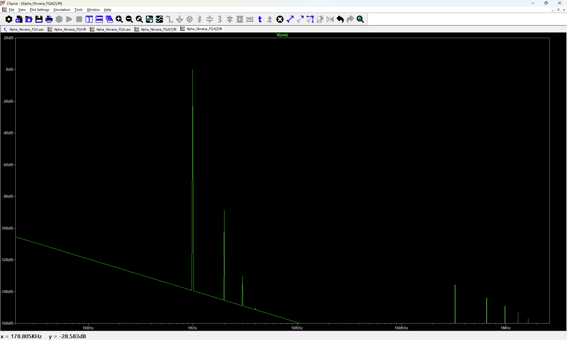

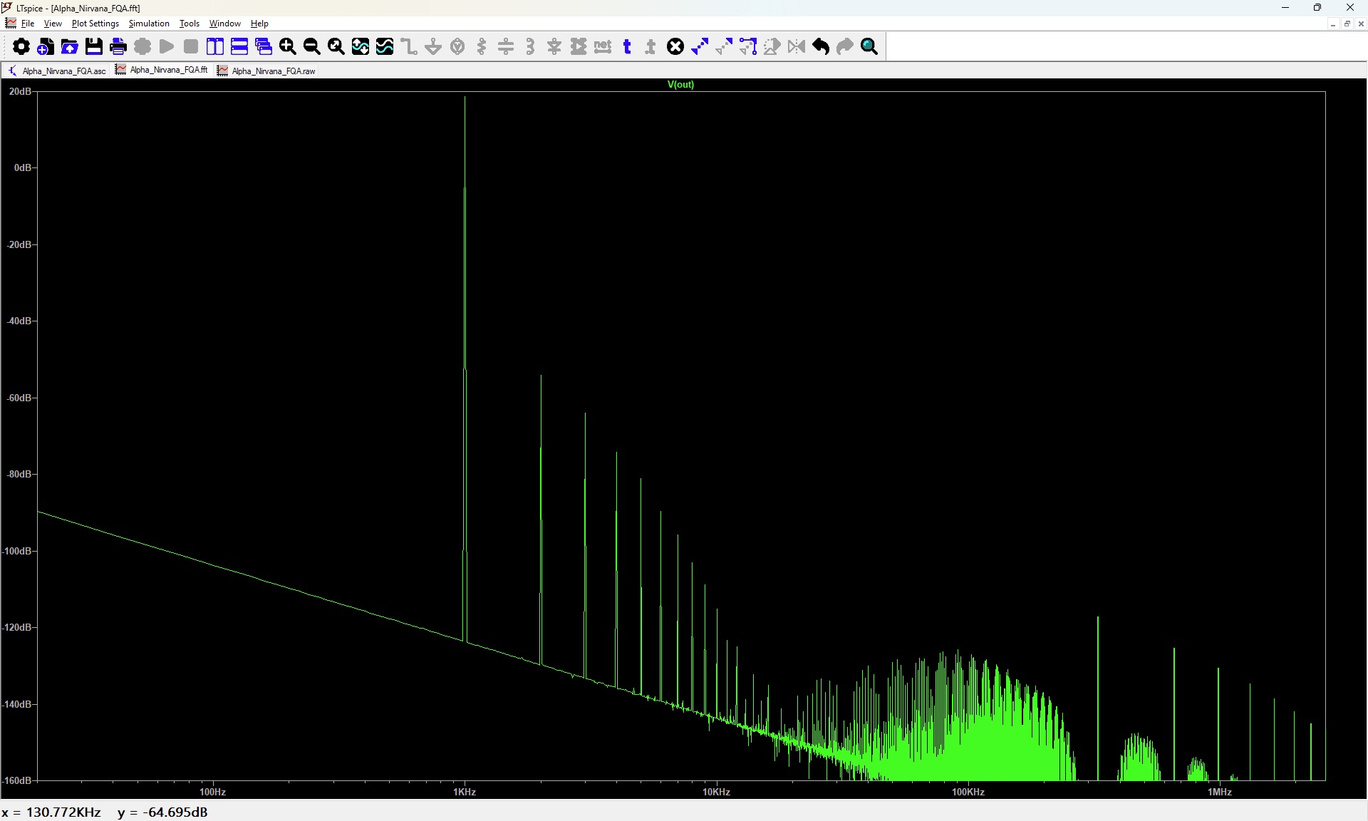

Varying R124 from 820R changes the harmonic
distortion of the AN. I wouldn't move too much from 22k/1.8k - 2k2. Increasing R124 gradually fades the profile that the designer Mr. Hugh Dean has achieved, you know, monotonically decreasing.
Fellow Danny shared with me some fantastic information on this... thanks a lot Danny!!!
820R
1.8K
3.9k
10K
I was going high as 10K and I'm going back to 820R (1.8K I think would also be fine). I'm going to try lowering the gain through a resistive divider filter on the AN input.

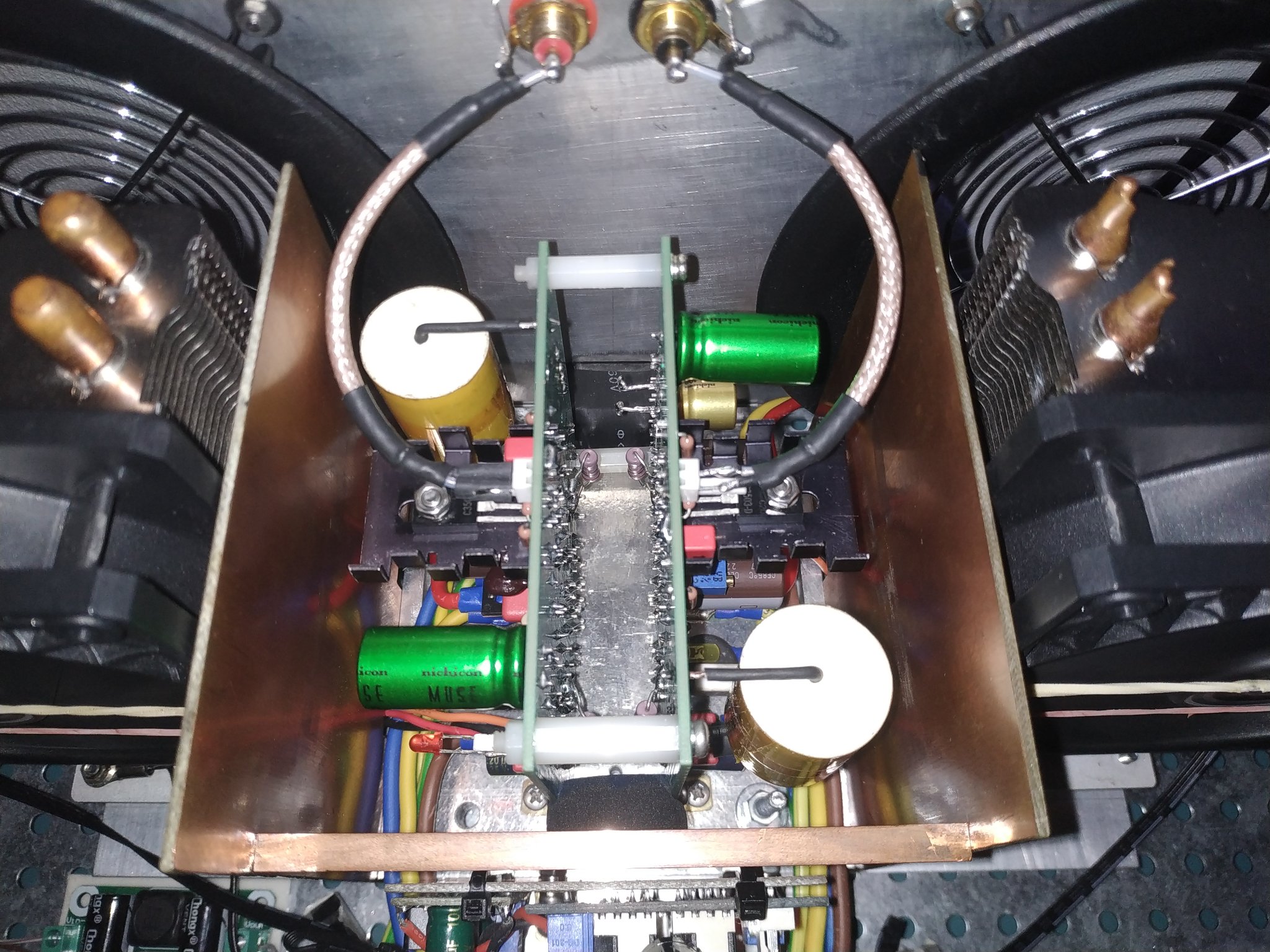

Merry Christmas to you and everyone else on this thread! Hopefully you are all enjoying your AN over the holidays.
Your arrangement is very cool (literally). 😃
The use of CPU coolers is a great way to save weight and expense of heavy heatsinks. Plus, it keeps the amp much cooler running. Your arrangement of the two amp boards back to back and having the two input RCA’s close to each other is an excellent way to minimize the potential for ground loop and EMI pickup since the loop area is very small. Nice work!
Thank you X! Likewise for you and for all the participants of this thread, which in one way or another have been flattening the road for those of us who came behind!!!
Cheers and good luck 👍

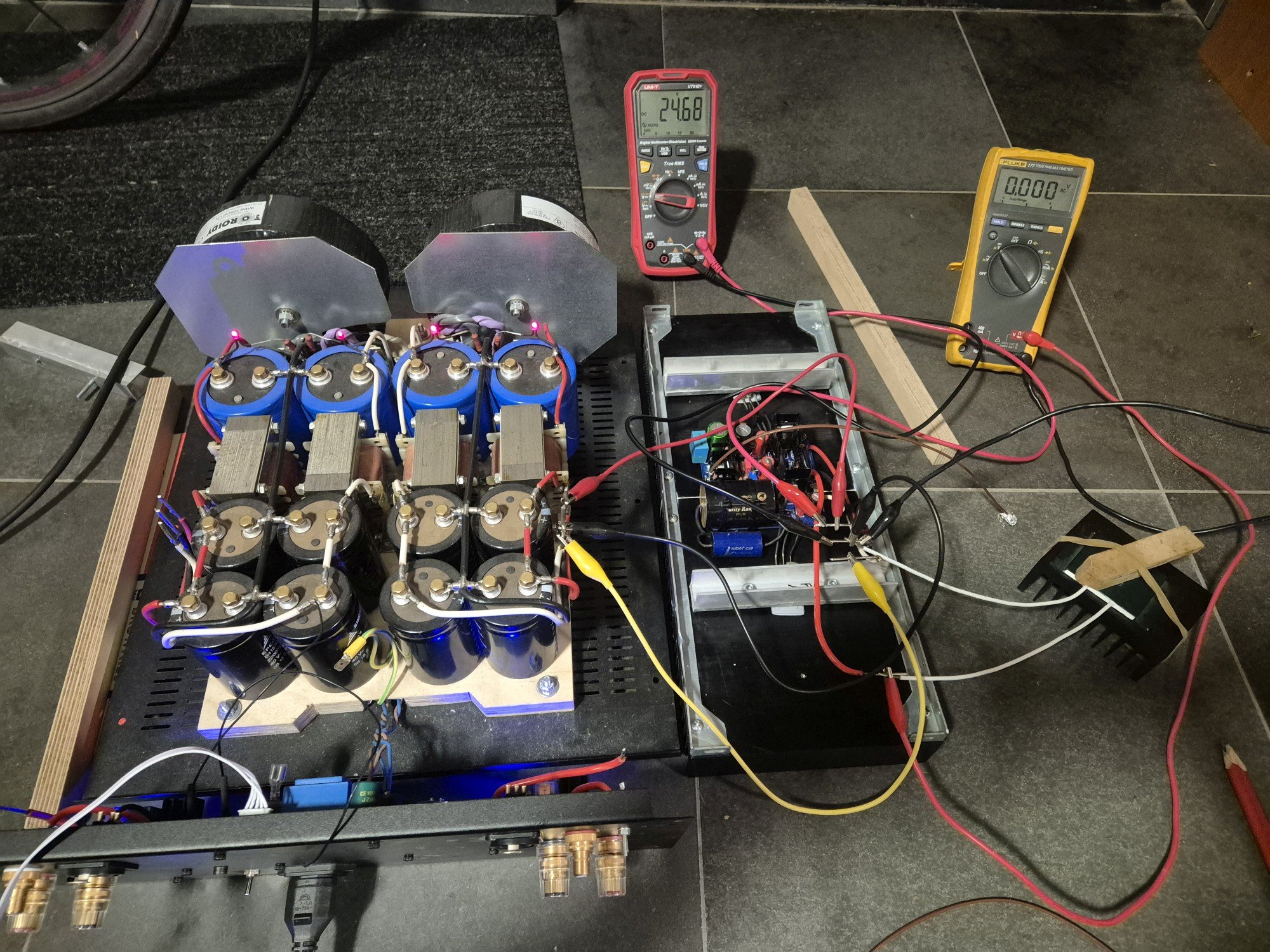

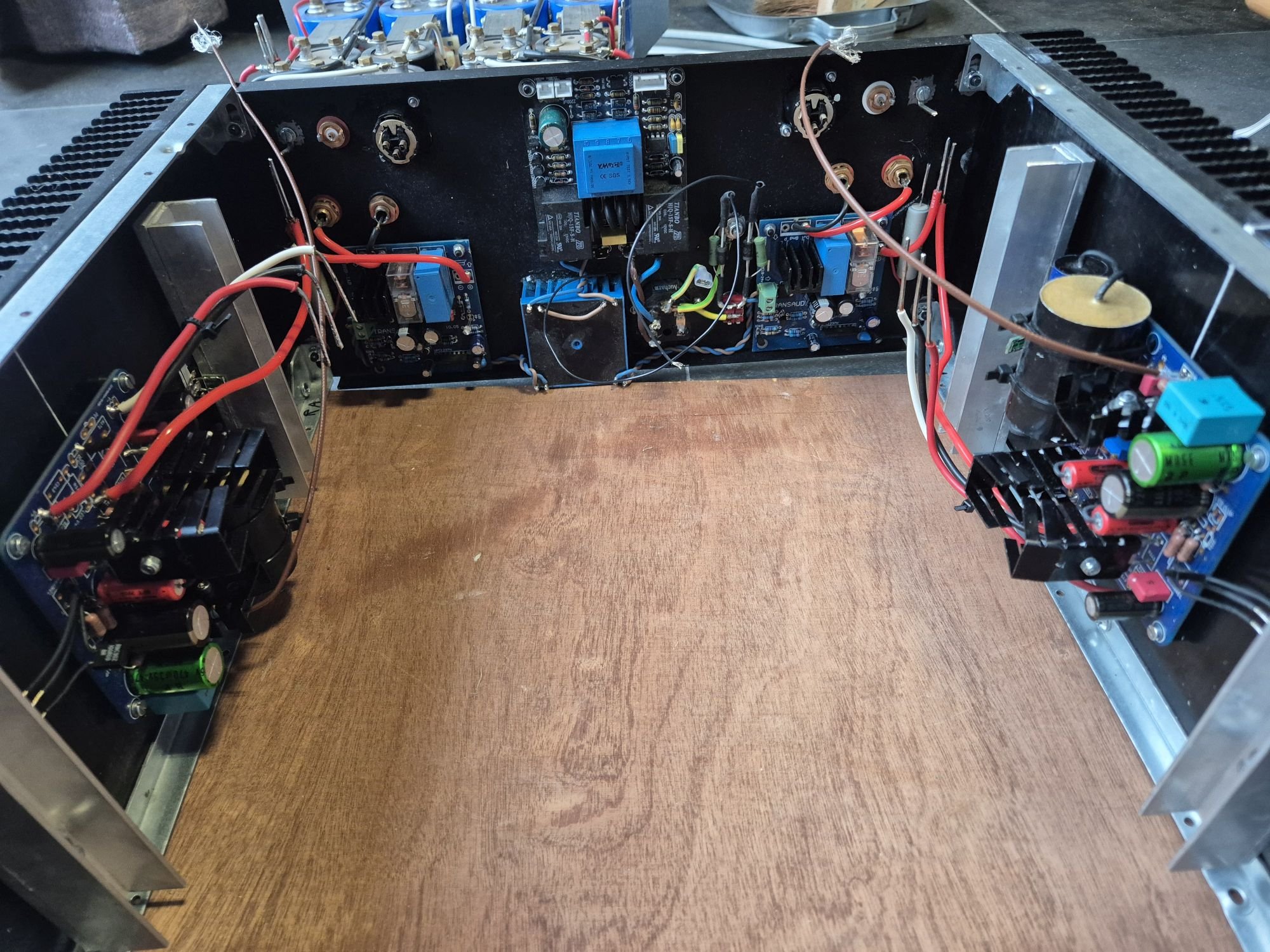

Yesterday, my friend Bernard and I had a listening session and the Alpha Nirvana came out as best.
The last 5 years it was always his FirstWatt Sony vFet PP amplifier that was victorious,
but now the Alpha Nirvana gave a better overall sound, especially the soundstage depth stood out.
And this with the Alpha Nirvana that I just finished assembling a few hours before.

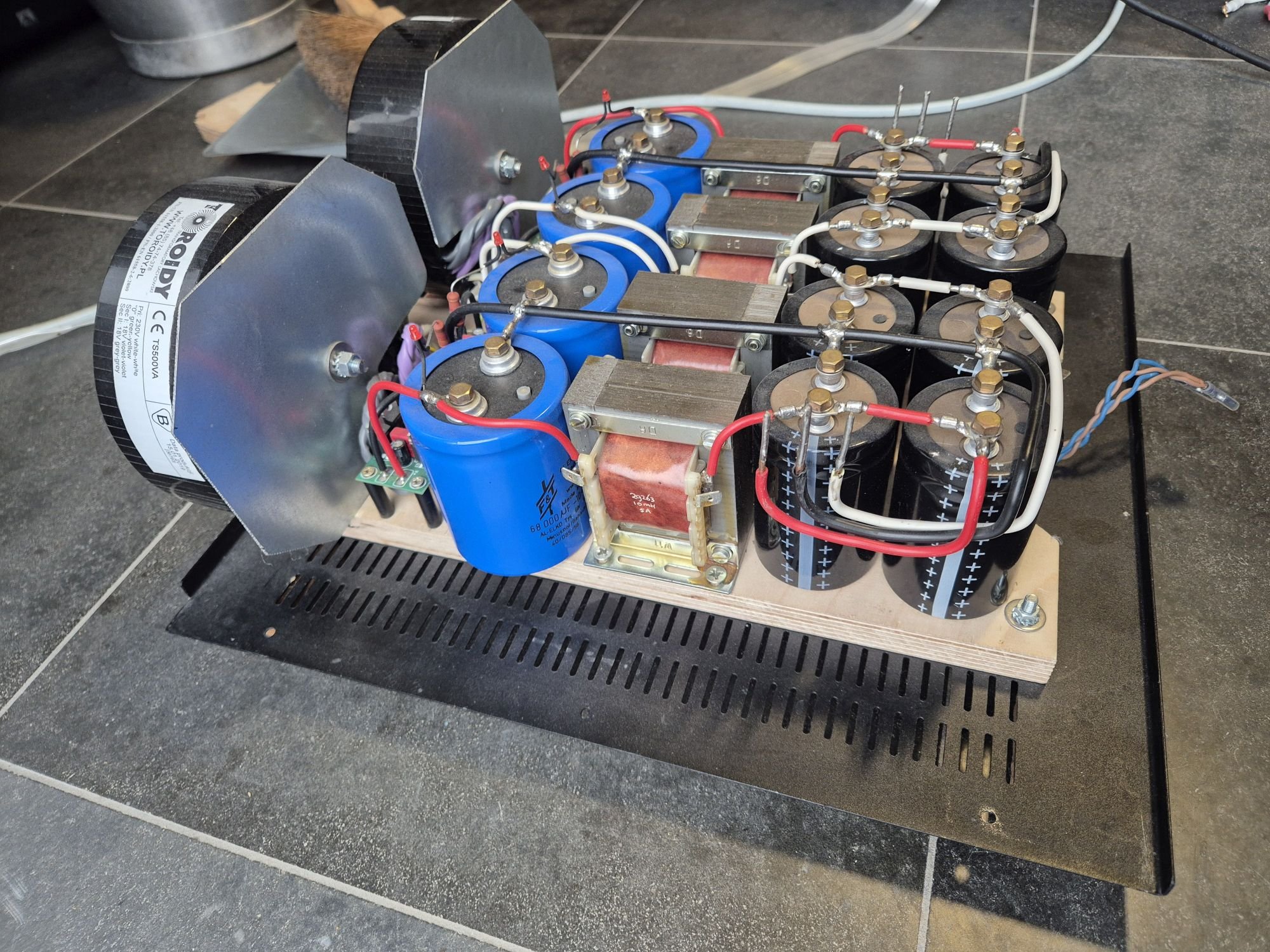

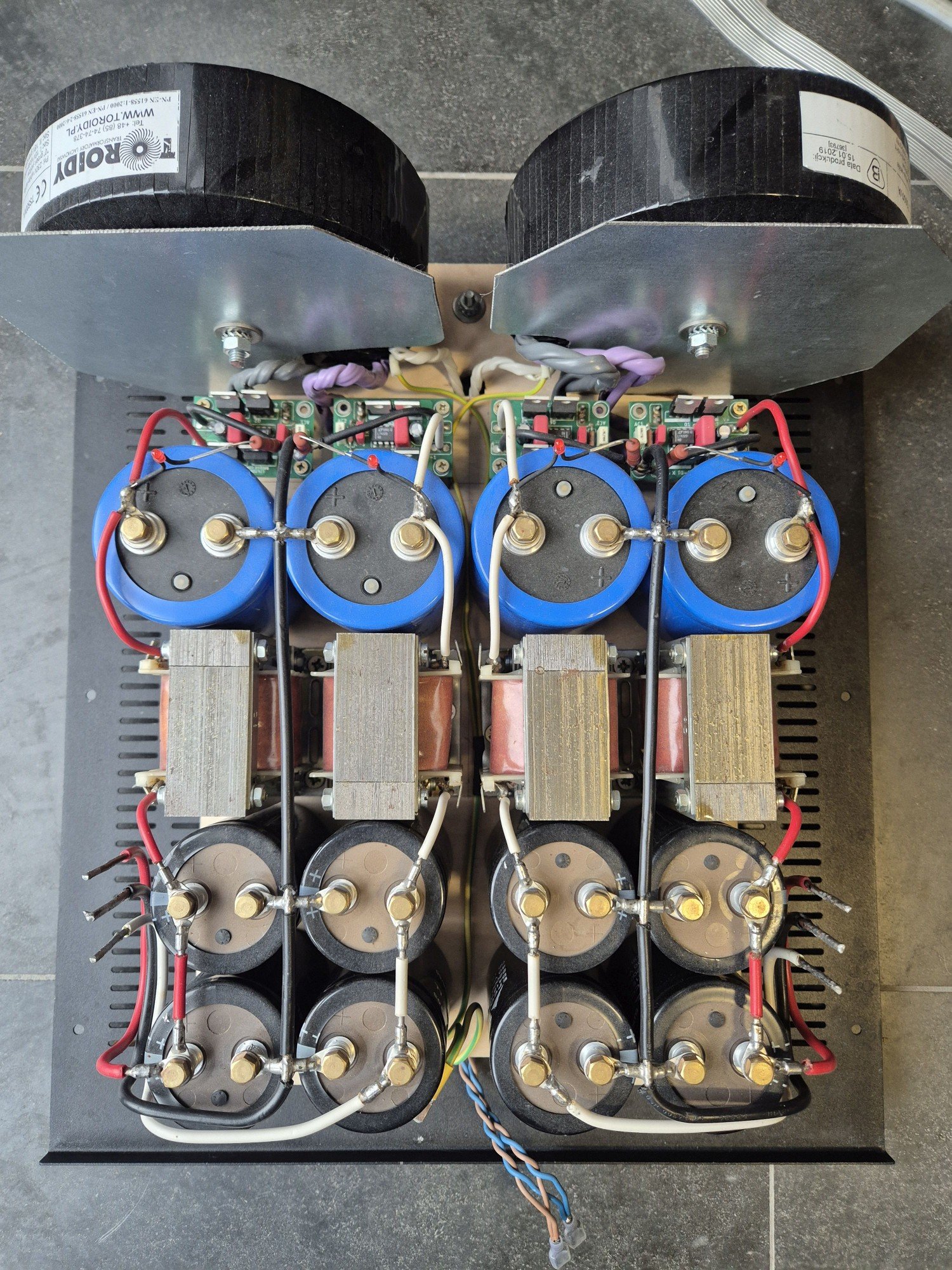

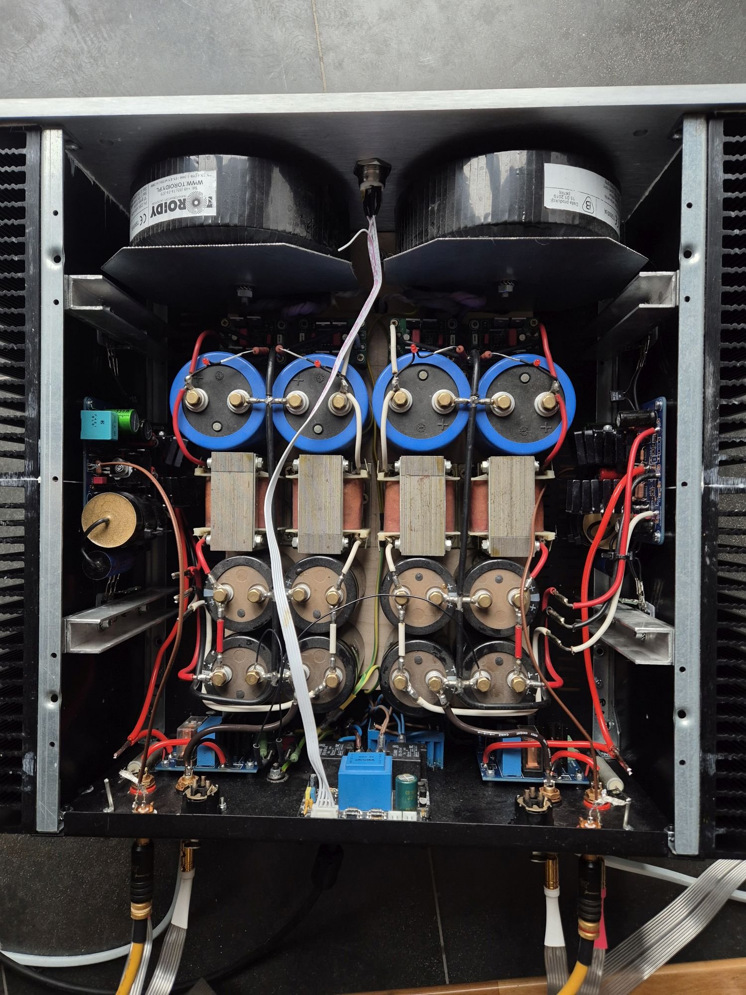

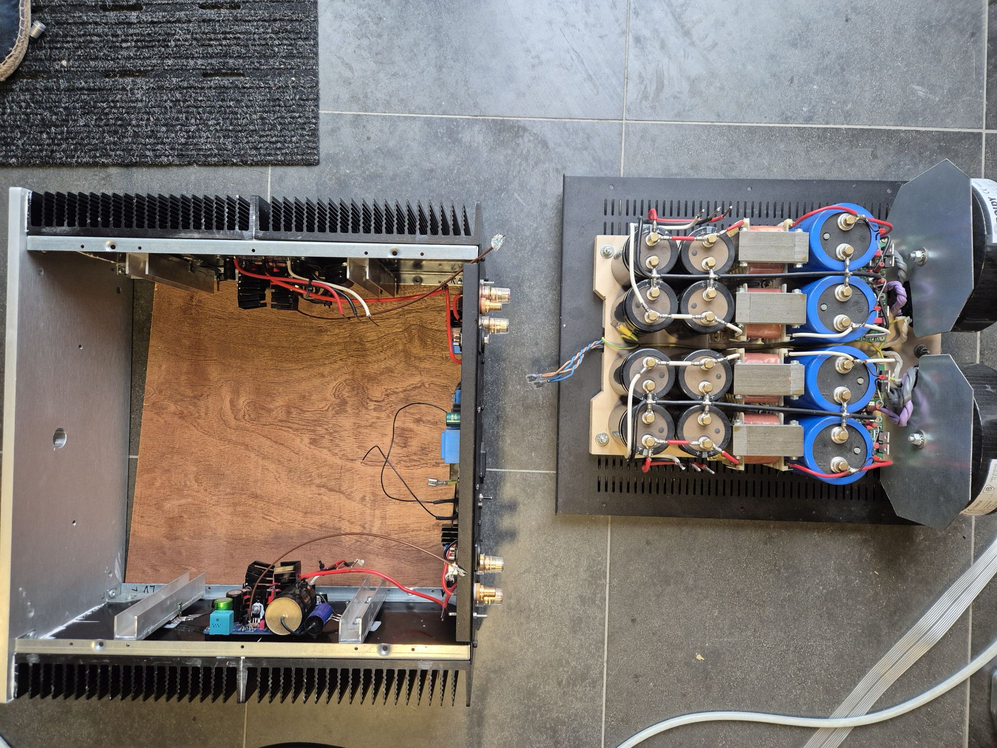

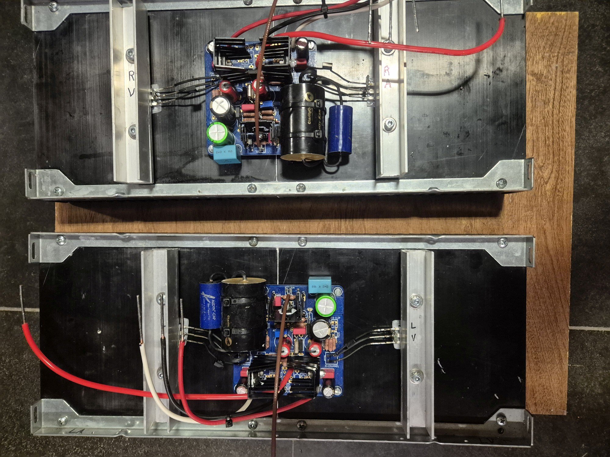

Some more info about the build:
The case and the power supply were from a previous build ALPHA amplifier (the predecessor of the Alpha Nirvana).
The power supply is a dual mono with Toriody transfos, LT4320 bridges and CLC.
For the Alpha Nirvana I used bulk foil resistors for the critical positions and Isabellenhutte PBH as source resistors, other resistors are cmf60/rn60
Input caps are Clarity cap PUR, the rest Muse ES, Elna Simic and Jupiter Cosmos wet capacitors.
As feedback resistor I used 1.8K instead of 825r, this lowers the gain and when using 4 ohm speakers you get about the same FFT profile as with 825r and 8ohm speakers.
Thanks Hugh and X for this great amplifier!
