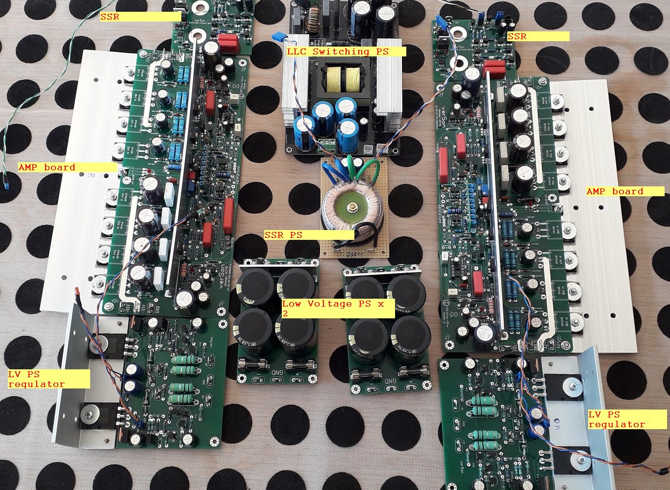

Hello Hugh,
my friend Dadod (forum name) designed amplifier which is combination B and A class where Class A OPS bootstrapped by Class B. I think you know him.
I've borrowed amplifier and tested. It is realy extraordinary. It is much more complicate than standard diy amplifier.

TA,
Thank you for your post - yes, I know Damir and have exchanged emails, where he taught me a few very important lessons, like Bode analysis, TMC and TPC.
He is a lovely man and I hope to talk to him again...... he is a couple of years older than me, and a brilliant telecommunications engineer.
I took am very interested in Class AB designs which 'sound' like Class A, it is a knurly, engineering challenge!
Hugh
