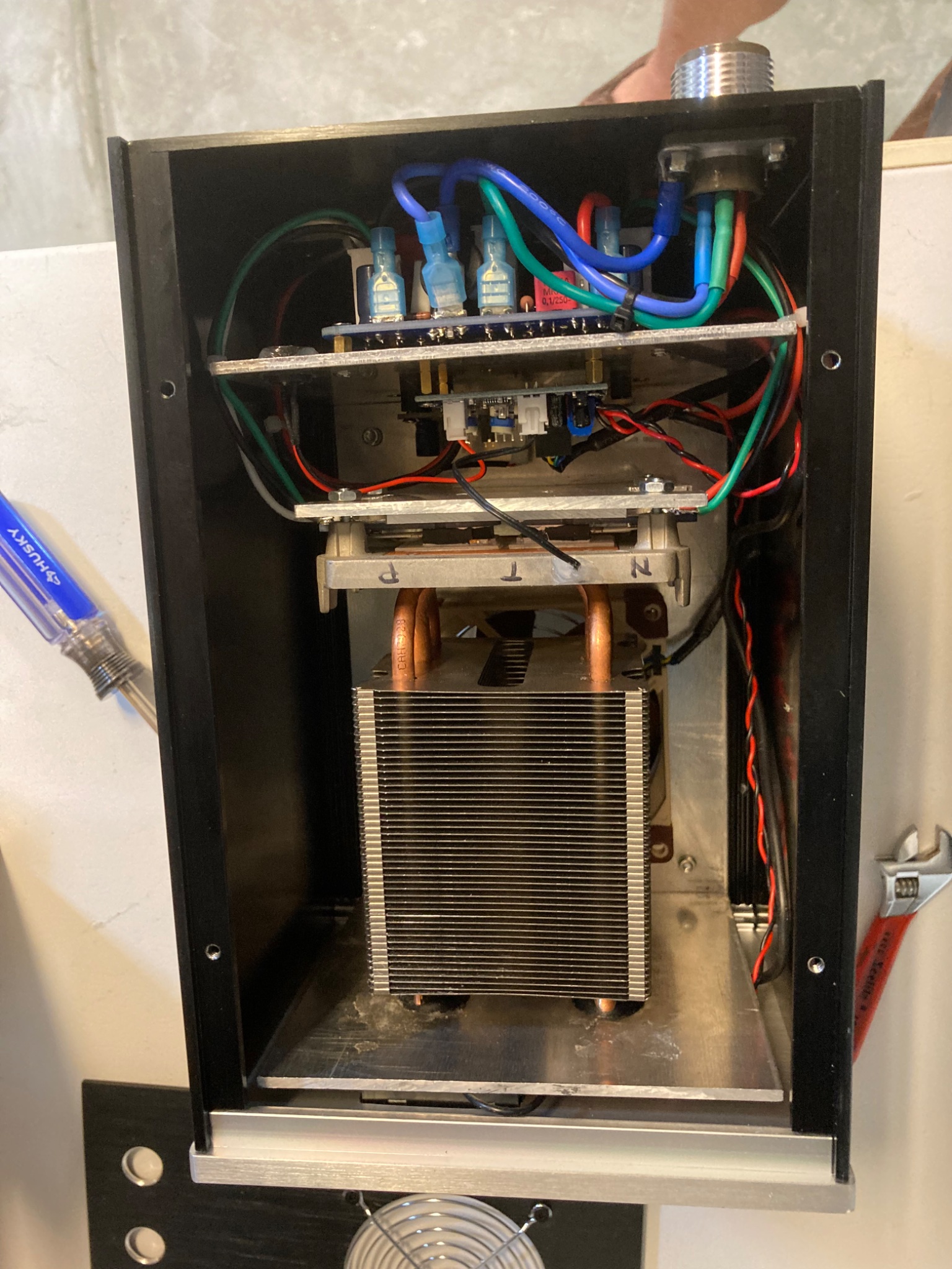

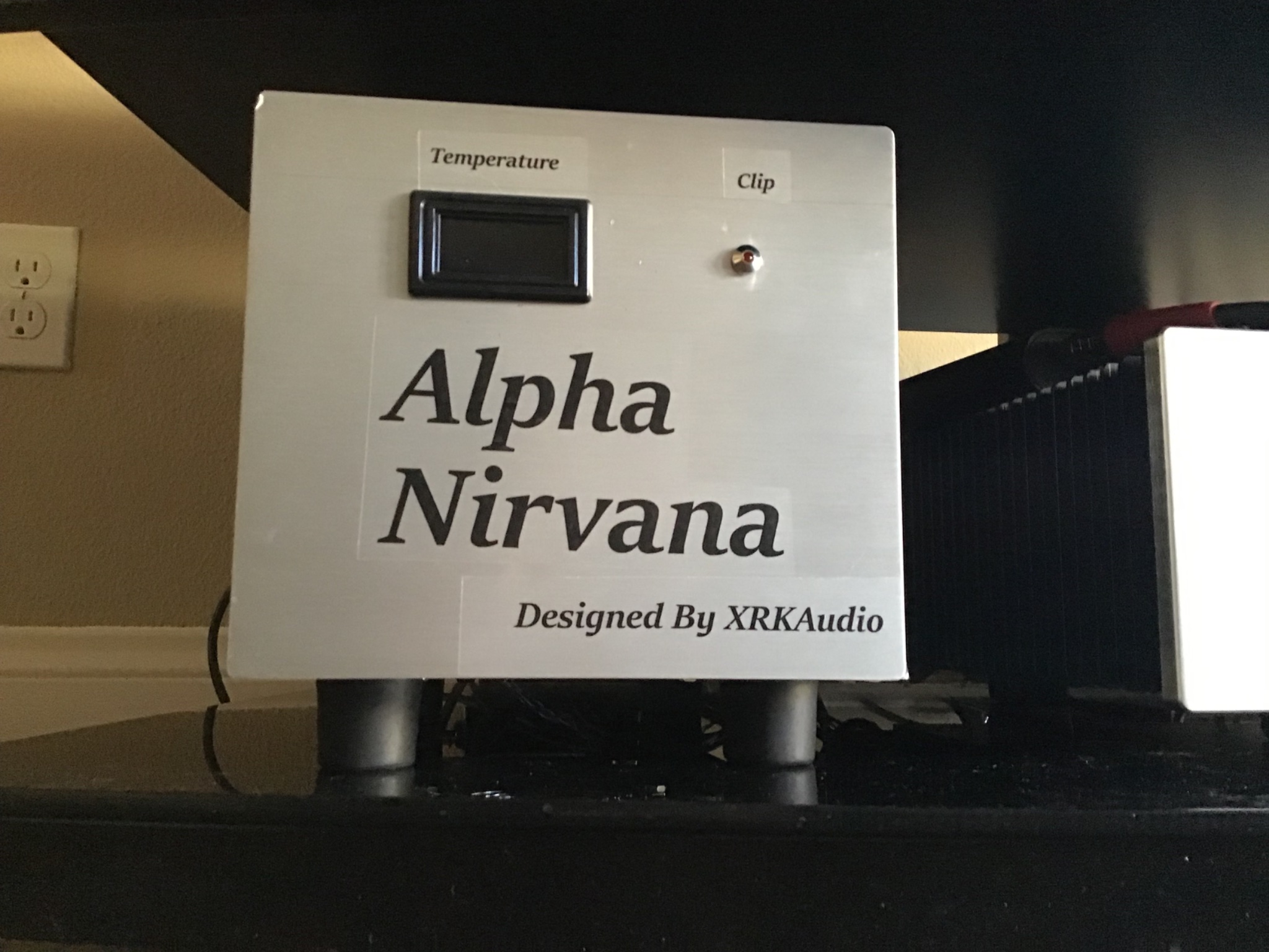

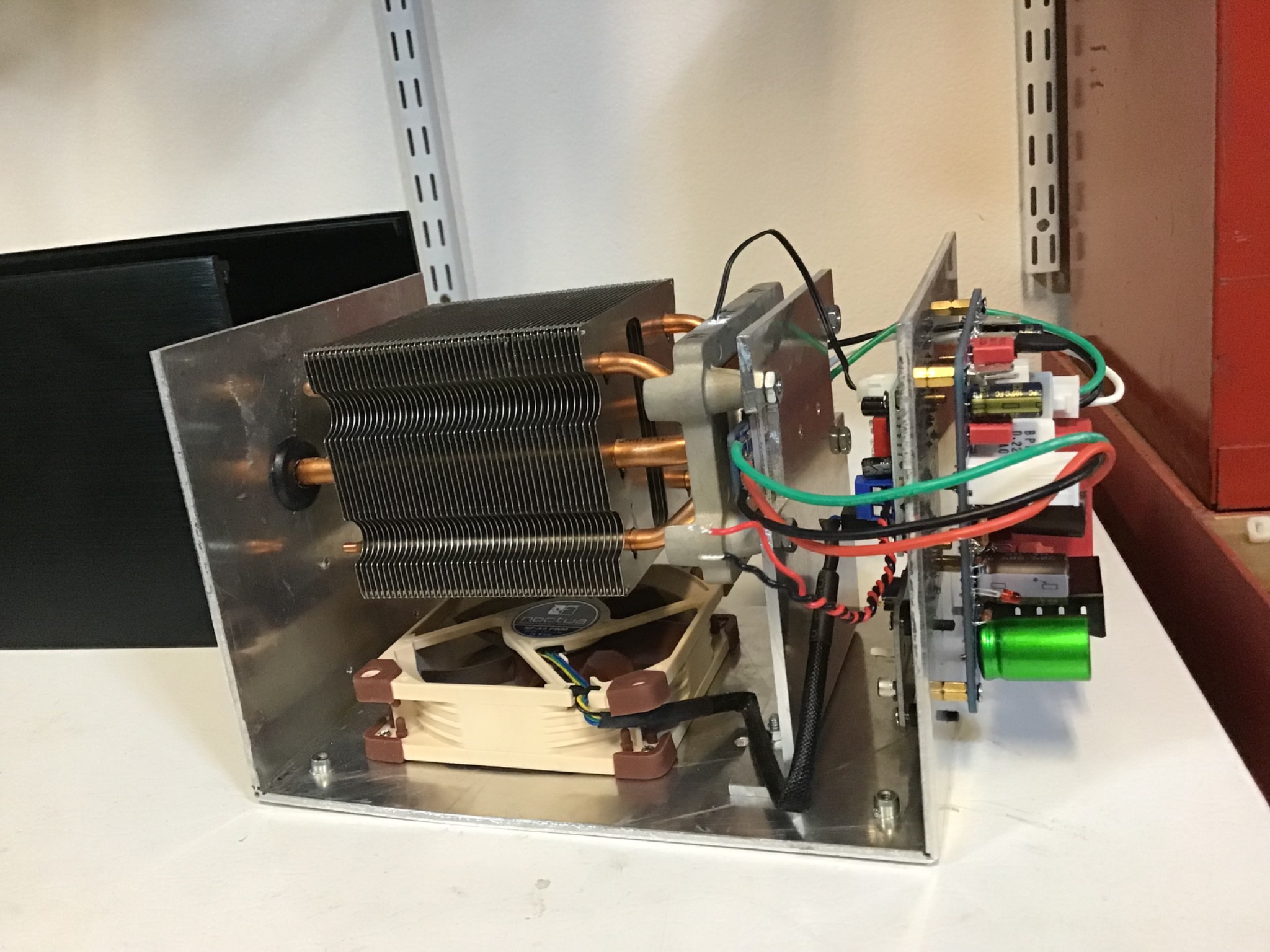

I built mine as mono blocks with cpu coolers. The fans run so slow I only hear them when I am right next to them.
