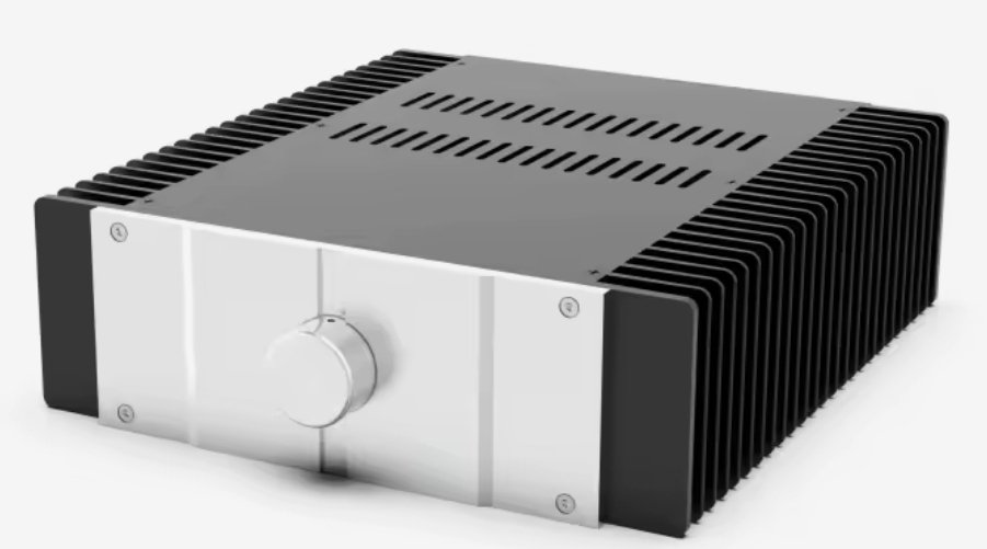

@Vunce In my case, the total area of the radiator will be about 1200 centimeters, which seems sufficient for dissipating 90 watts of power.This chassis is way too small for the heat AN39 creates!
For the stock 8ohm build each channel dissipates almost 100w.
A good example size is the Modushop 4U 400mm chassis.
Μy setup for AN39 is 21.5 +/- rails at 2.6A= 56+56 total 112WYes, one channel = two mosfets (P+N) with +25v and -25v rails = 2x 25v x 1.8A = 90W
No problem with active fan .With a room temperature of 29-30 C degrees in summer I have a temperature on the body of the mosfet of 56C degrees and on the heatsink 44-46 C. No noise at all ....120mm fan.
I will follow your example regarding the 1.8K resistor.Thank you.
@manniraj I have had positive experience using the Hood 1969 amplifier with a switching power supply and a small case.Then I think too small internal space to hold the SMPS and the amp board on top which might also induce hum/hiss issues with grounding.
That's 8 watts amp...yes, that chassis can handle jlh amp. Built few versions of jlh into similar case. But AN is different beast. You were warned. Suit yourself.
@adason Yes, maybe I'm wrong, but I want to understand. You use the "4u400 modushop" chassis for two channels. In my case, these will be monoblocks. Then my question is, what radiator area is needed for one passive cooling channel at an ambient temperature of 24 degrees?4u400 modushop
plus fans on each side at half speed
Yes, I agree. But JLH has 15% efficiency compared to 43% for AN and we are talking about one channel. I will conduct tests )))That's 8 watts amp...yes, that chassis can handle jlh amp. Built few versions of jlh into similar case. But AN is different beast. You were warned. Suit yourself.
Please do. I am not discouraging you from building AN39, its one of the best amplifiers i heard, got two, but it will need forced air cooling in that enclousure, even as monoblock.

Its enough my friend if you put one mosfet per heatsink ONLY but long cables more capacitance....only if you put the main board on the center of the box so...the space its limited about the PSU then....ALL its the bias ... 1.8A? 2A? 2.6A? 3A? biggest heatsinks more comfortable but too expensive and soooooo heavy .@adason Thank you, I will listen to your advice. Perhaps a chassis with dimensions of 282×310×90 would be more suitable for my monoblock.

As Hugh and others have already mentioned, the heat dissipation from the AN is still quite considerable, despite it's relative efficiency as a Class A power amplifier.
Around 90 watts to dissipate per channel, it is better to look for passive heat-sinks that are more like 300mm * 200mm (5U), or if you can get longer ones then go for 350mm * 150mm or 400mm * 150mm. Ideally, the "base plate" of the heat sink should be at least 8-10 mm, and the fin length 35-40mm (can be more).
If you plan to use a more compact chassis - even as mono-blocks, then use fans to help with the cooling.

And that's exactly it. Each mosfet has its own 300mm×90mm radiator with a fin length of 50mm.Its enough my friend if you put one mosfet per heatsink ONLY but long cables more capacitance....only if you put the main board on the center of the box so...the space its limited about the PSU then....ALL its the bias ... 1.8A? 2A? 2.6A? 3A? biggest heatsinks more comfortable but too expensive and soooooo heavy .
You will be on the limit but it all depends on the current..Officially for 4 Ω speakers Mr Hugh gives 2.2A bias.
If you can fit everything inside, a main board amp - trafo 300/400Va - and power supply- SSR output protection-Soft start , it will be fine.If you have already purchased the boxes, go ahead. It's really great to put a fan in it. You'll see it in action.
Then ....you are very cool....if you can put all these above stuff in your box.Elac Debut 6.2 speakers with 6 ohm impedance so I plan to use 1.8A bias current
