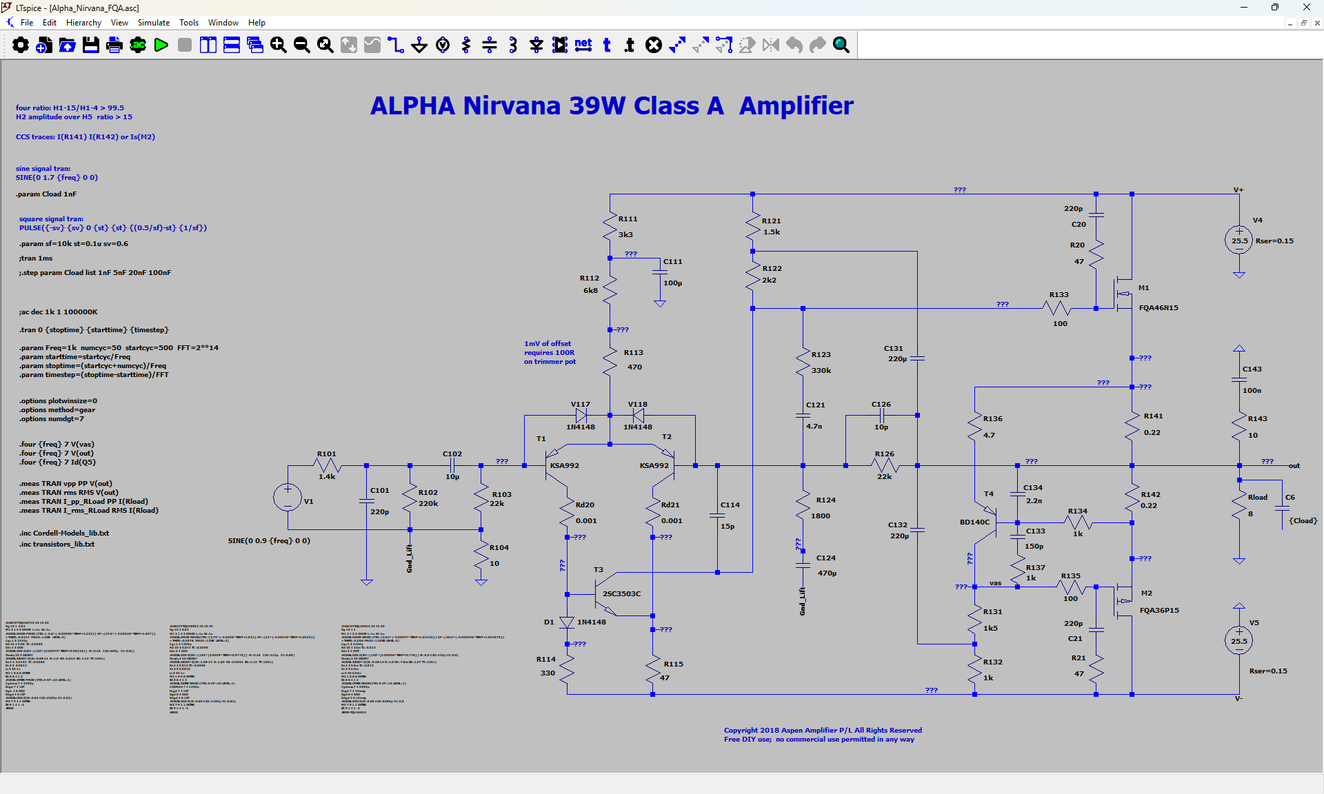

Thank you Danny for all these information and the presentation you gave to all of us. What is the operating voltage and bias you chose for your 4R? amplifier?As feedback resistor I used 1.8K instead of 825r, this lowers the gain and when using 4 ohm speakers you get about the same FFT profile as with 825r and 8ohm speakers

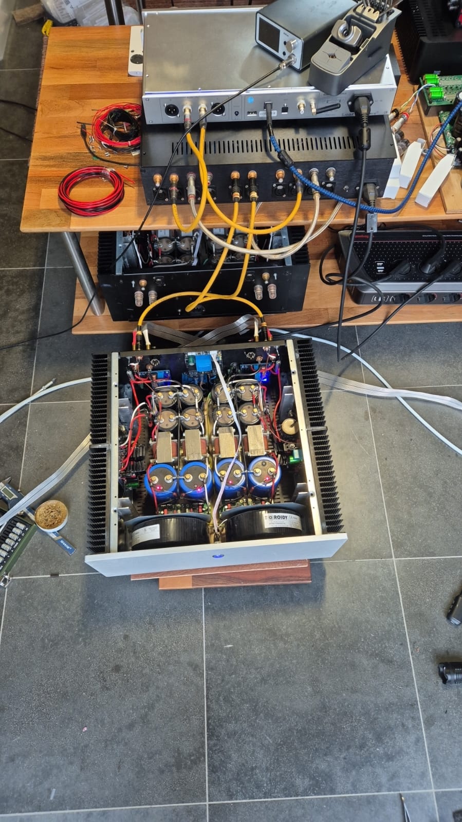

Hi Nikos,
My DC rails are about 25vdc, output transistors biased at 1.8A.
My speakers are 4ohm and about 93db sensitive , so I don't need large output voltage swings.
I'll post my Ltspice files tomorrow.
Danny
Danny

What chokes are these? Do you have a preferred supplier?The power supply is a dual mono with Toriody transfos, LT4320 bridges and CLC.
The chokes are from AE Europe, they're located close to me.
The specs are:
10mH 0.07 Ohm
5A DC
WxDxH 80x70x60mm
Another good candidate is the Hammond 196Q2, with the dual coils in parallel you have 10mH 0.12R
single: 20mH 2A 0.24R
parallel: 10mH 4A 0.12R
series: 40mH 2A 0.48R
Grts,
Danny
For the Alpha Nirvana I used bulk foil resistors for the critical positions and Isabellenhutte PBH as source resistors, other resistors are cmf60/rn60
Input caps are Clarity cap PUR, the rest Muse ES, Elna Simic and Jupiter Cosmos wet capacitors.
Please excuse the ignorant question, but what is the purpose of 6 transformers in what appears to be 2 stages ?
TIA
The black round donuts are the two transformers, one for each channel,
the four square ones are chokes, one for each DC rail, left+25dvc -25vdc, right +25dvc -25vdc
