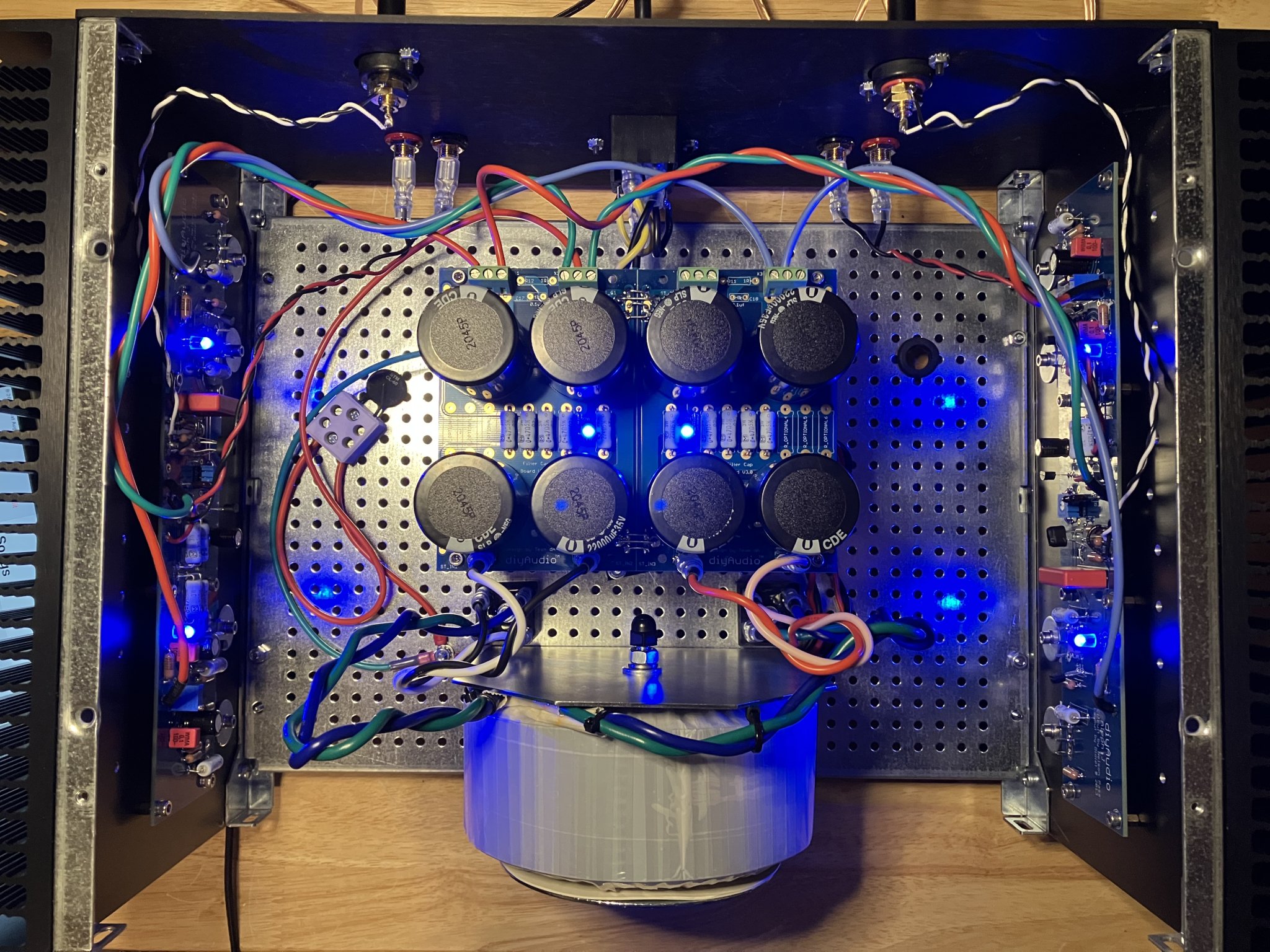

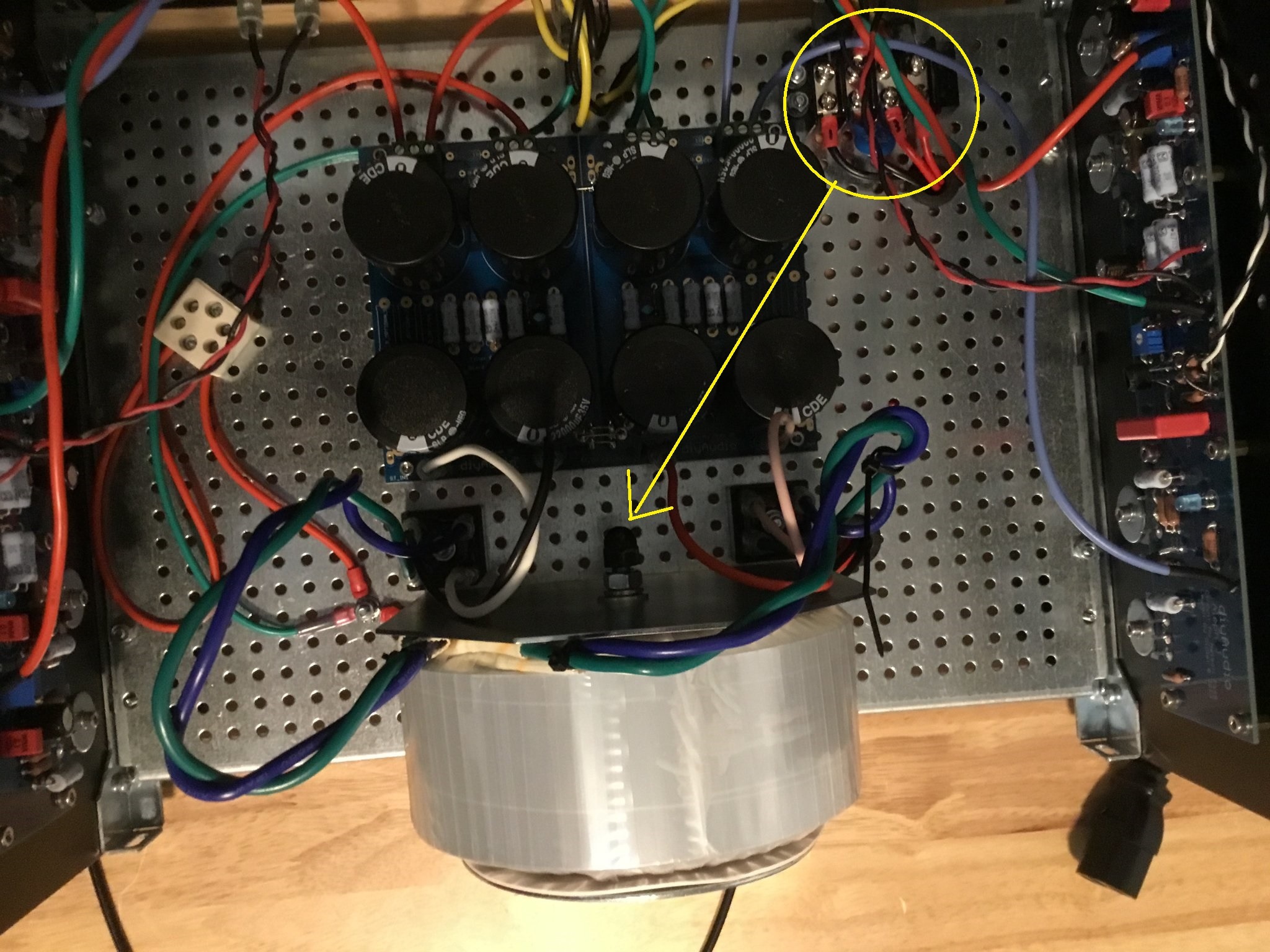

But before you give up on the arrangement in your picture of post #1040, I suggest you move the incoming AC and thermistors to between the PS board and transformer and at the centreline of the chassis. Also run the AC line from the IEC connector down the centreline of the chassis. The goal is to keep the AC away from the signal wires and the amplifier boards.
Also twist the V+ V- G wires together from the PS board until they reach the amplifier boards. Tightly twist the wires from transformer to rectifiers and rectifiers to PS board, input + and G, speaker + and G. They should be twisted tightly, not loosely.
Route the speaker and input signal wires close to the amplifier board on their way to the back panel.
Route the transformer secondary wires away from the amplifier boards on their way to the rectifiers.
Basically keep AC wires away from the signal wires and components and keep signal wires away from AC.
Once all this is done, rotate the power transformer to find the position of lowest or no noise.
Also be sure to have good ground connections between the two halves of the power supply board at the power output. I see empty ground pads. Connect the two sides with wires.
I forgot to mention, also tightly twist the AC wires from the IEC connector to the thermistors.

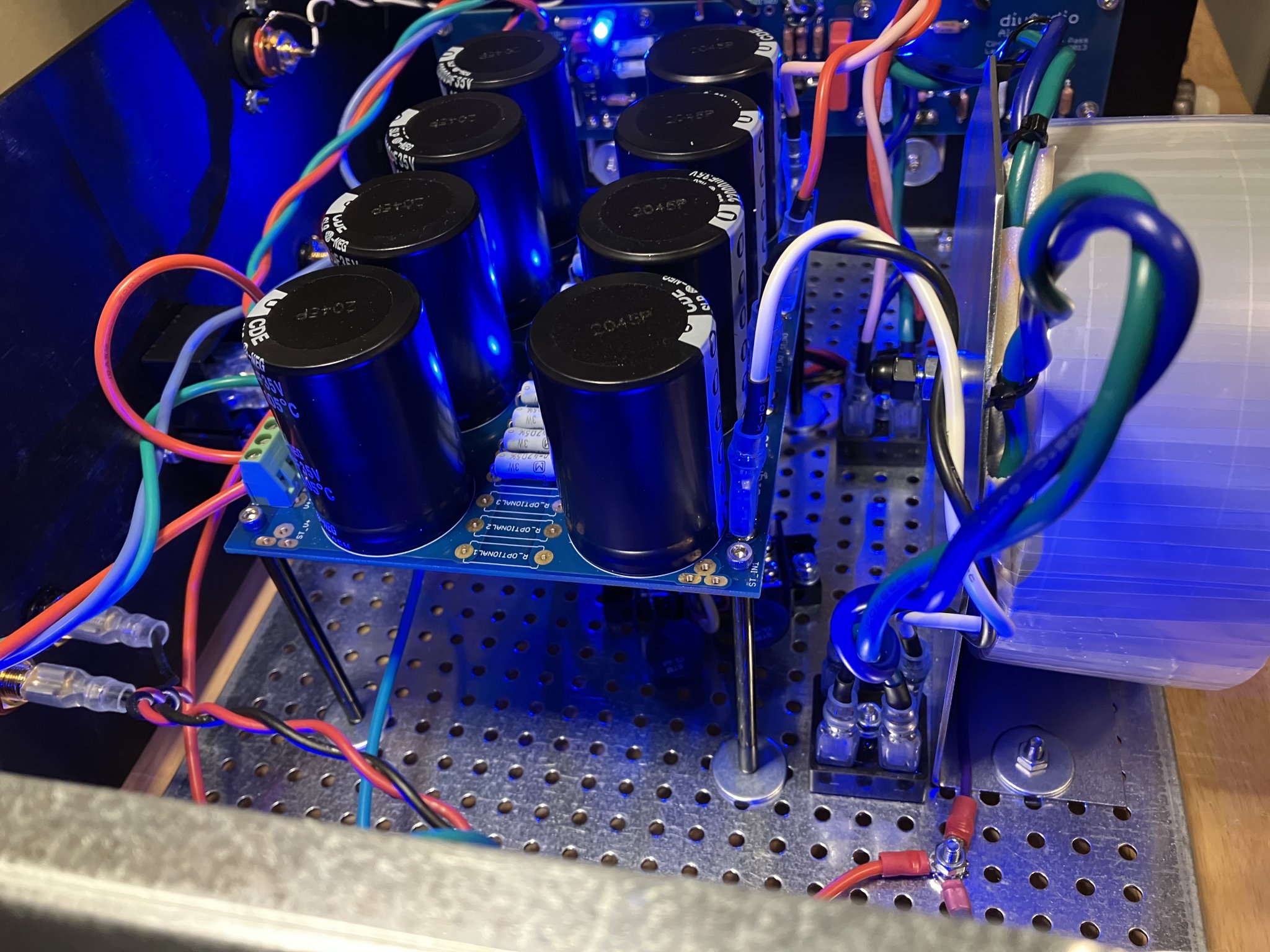

I wasn‘t comfortable with the space I had to move the block right behind the transformer with the PS board just off the base plate. Then I decided to use those 80mm stand offs to raise the PS board up so I could fit the block under it. That also raises all the wires from each amp board up so I can route and twist them better. Now there is no hum or any kind of noise at all from the speakers, just a little buzz from the transformer and Ican live with that.
I really appreciate the help and encouragement Ben and all.

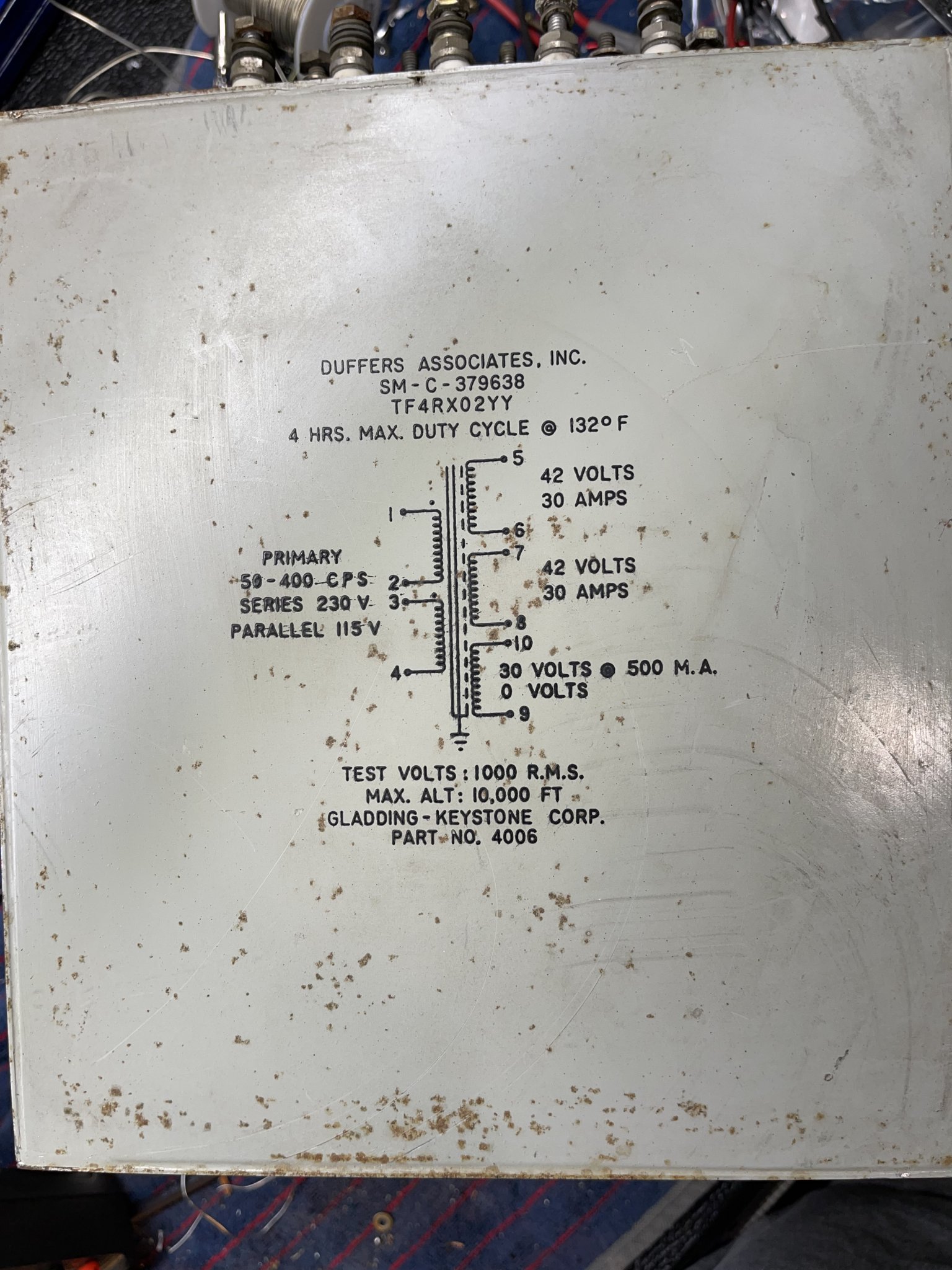

I've yet to start on the case. It's still in the box. Building an mosfet amateur radio amplifier atm.
Theoretically it should produce 2800 watts of HF RF. If I can get 1200 I will be happy.
