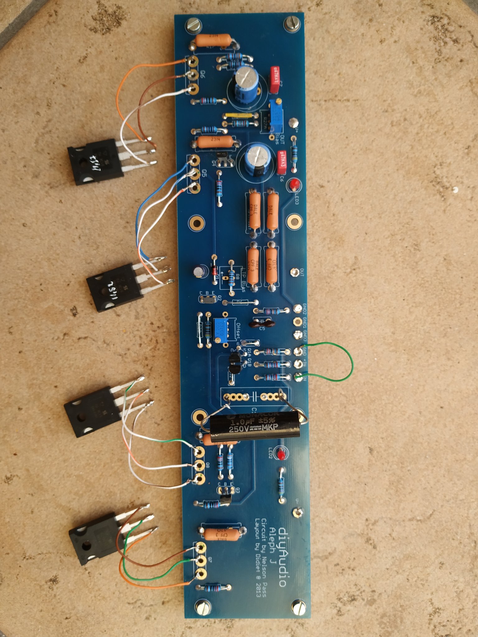

I am happy for you. I have built it and all measurements looks ok, but the sound for me is disappointing. I would like to know what speakers you have. Thanks.

Any chance you can show us the inside photos?? We might be able to provide a few pointers on how to improve the sound... I think you mentioned in one of the posts Dynaudio speakers... I also have Dynaudio speakers, but the sound is great. Once you get the amp running stable, you could consider removing the C1 (this will improve the sound even further... a lot!)... and the short circuit protection...
I attach the image, I have already tried to eliminate C1, the result is different but not better.

Well, that's because you have to get the basics right first. Using CAT5 wires to connect the MOSFETs to the PCB is not good at so many levels.... the damping factor will suffer a lot (there'll be no control of the bass cone excursion at all, especially with 4 ohms driver...) and you will have oscillations happening as well, which are hard to capture (you'll need a fast oscilloscope... at least 100MHz or faster).
Once you mount the MOSFETs straight onto the AMP PCB, there are still many dangers lurking, that could degrade the final performance.
Place the MOSFETs onto the AMP PCB first, wire the amp up and then show us the photos of what you did... I am sure we'll be able to help further. You should be able to get a really great-sounding amp.
Then, in the end, you can remove the C1 cap and see if you like the sound better without it.
