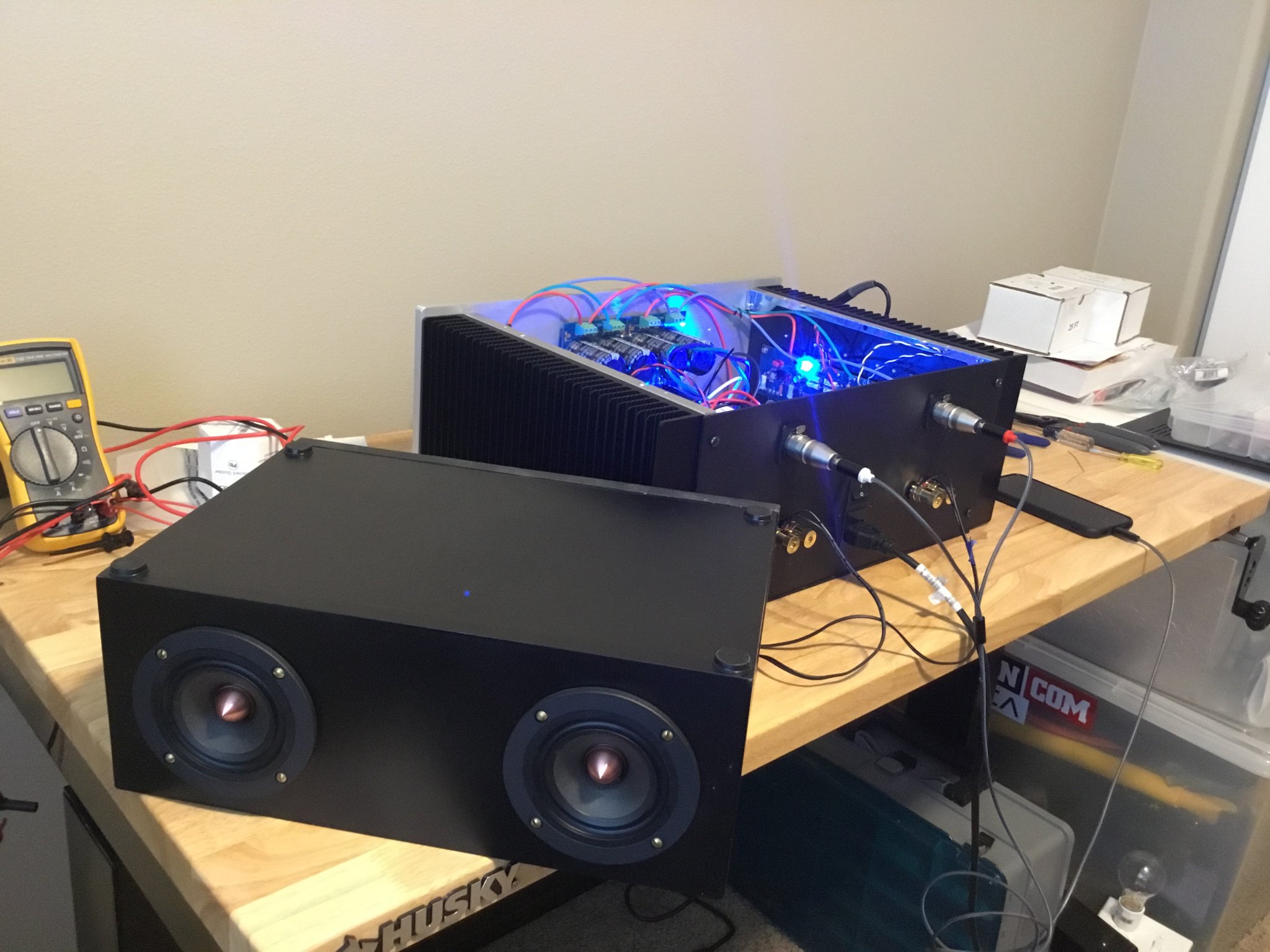

The hum is still there but it is so low I’m going to leave it now while I let it run for the day. I’ll clean up the wiring, tighten up the case and see how it sounds tomorrow.
The hardest part of this project for me was putting the case together. That was a challenge.

Yeah, beautiful sound.
If using RCA's, check the ground lift mod.
Adjusting the bias between 470mV and 400mV changes the sound as well... quite a lot. You can definitely find the sweet spot that suits your taste, the rest of the system, and the speakers.
I’ll give that a try, thank you. By the way, the hum, more of a buzz, is so faint at the speaker that I have to have my ear on the speaker grill to hear it. No way to hear it at all with music, or between songs. I might try to track it down at some point. I would swear I only noticed it when I stood up the front panel which put the power supply closer to the transformer.
It doesn’t bother me but I am curious about it. I read through a couple threads referencing specific frequencies, 120hz and 60hz, ground loops and power supply, mine right above the transformer is around 366hz (using a couple free aps on my iPhone).
I‘m not ready to dive into it since I can barely hear it, I’m just curious if this frequency may point to something specific. I’m still loving the sound and appreciate all the help this site has provide.

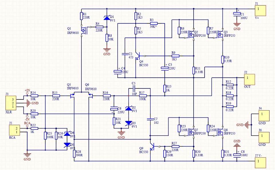

greetings my first visit to the PASS LAB forums found this schematic on the net
i would like to make this amplifier is it possible for a noob PLEASE suggest me
warm regards
Andrew
This may help:
https://www.diyaudio.com/community/threads/aleph1-2-irf240-vs-irfp250.99132/
Also, see the attached pdf
NOTE: the deciding factor is how big the amplifier heatsinks are... how good the ventilation/air circulation will be, and how much power are you ready to tolerate as being safe, for each MOSFET, to dissipate. Nelson has posted somewhere.... what he accepted as a safe dissipation, to ensure good reliability... I think it was 25W per IRFP240.... but they can be pushed much harder... and IRFP250 even harder than 240... but, that is a device dissipation, so you need to ensure good heat transfer between IRFP250 and the heatsink.

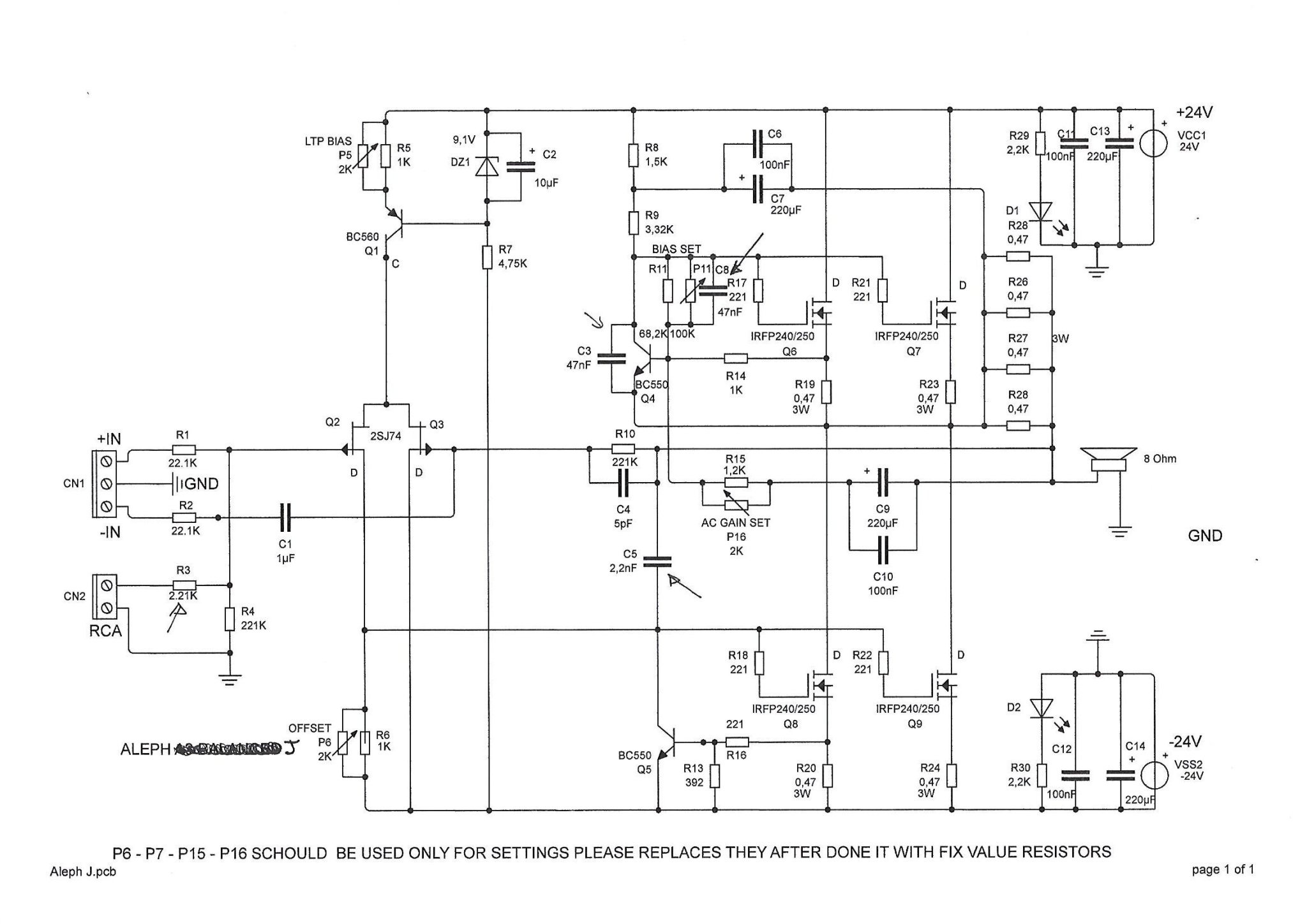

I have just drawn the wiring diagram of the Aleph j collecting some informations that I hope will be useful to everyone.
I would like to know your opinions on whether or not to adopt the following components:
R3 (for RCA input option)
C5
C8
furthermore there are all the calibration trimmers for:
1) LTP bias
2) Bias
3)Offsets
4) AC gain
which are set up on the pcb and which will subsequently be replaced with fixed value resistors.
Every advise are welcome.
Thank you.

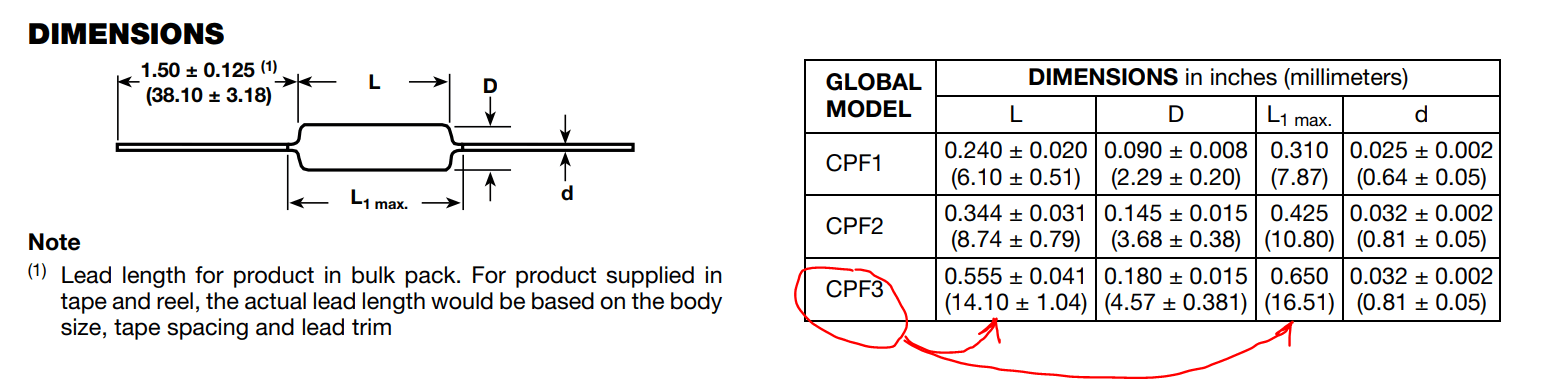

Hello all. I have started down the path of building the Aleph J thanks to this awesome guide. I have built the universal PSU as specified in the build guide. I made one substitution for the 8x Panasonic .47 ohm 3 watt resistors. The Panasonic resistors from the saved Mouser cart were out of stock so I decided to substitute what I believe is a suitable replacement from Vishay/Dale. Would any of the experts here confirm whether this will work as a substitute for this use case? I plan to use these on the amp board as well.
https://www.mouser.com/ProductDetail/Vishay-Dale/CPF3R47000JNB14?qs=MJw/449BOx/BmHgUJauRtw==
Thanks for your help!
