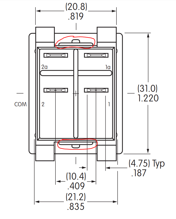

I chose this one b/c of the 10A rating + TV rating for inrush current. It also has a really interesting design to break a light weld if it fuses. There could be other switches someone can recommend, but this one looks like it would last a lifetime. I'd still have a smarter person than me review the spec sheet just to be sure. I also do not know your country's electrical code. This is just an idea/example of what I think a good push-button mains-rated switch for an amp could look like. I don't know if your country requires switching of live and neutral as an example.

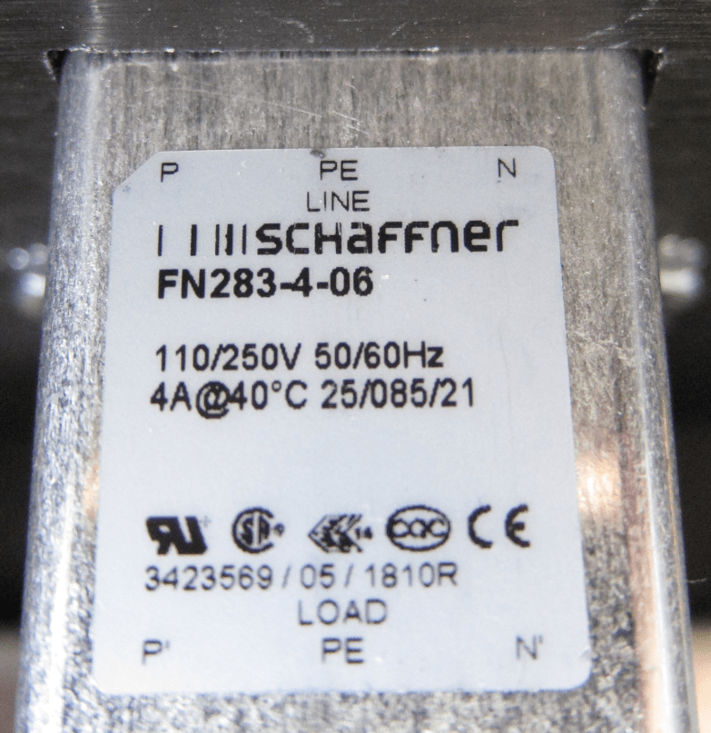

I chose a shaffner blockshutter IEC block with an EMI filter, 250V / 4A. I replace the whole block every 2 years purely as a precautionary measure.
Nevertheless, that switch looks really good and it does seem true that it'd last forever, good find!. My only concern would be the need for metalwork (ahh the horror) to accommodate the snap-in installation.
