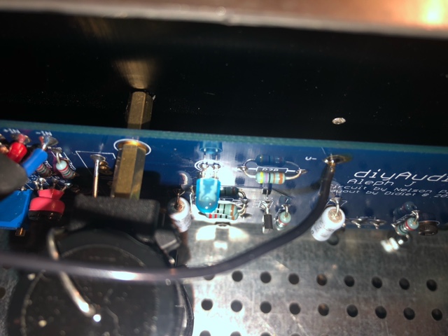

Hello Gents,
Completed the Aleph J amp last night, set bias to 400 mv and I have great sound!
However, noticed " LED2 " on both board does not light up, the other LED3 is fine. It's the light blue version that comes with the kit
Can someone help out, polarity is ok.
Not to second guess you, but are you sure the polarity is correct? One LED comes off the V+ rail, and the other comes off the V- rail. If you have sound and the amp is biased, then you have both supplies working. Maybe double-check. The board is nicely marked to show the position for the flat side.
Alternatively, you could have two burnt LEDs, but that's less likely. If they are burnt, check the value for the LED resistors to be sure they're not mis-stuffed.
Those are the simple checks I'd do first (in that order).
I had similar problem, and discovered that instead of 47k resistors, i used 47M. Obviously, too dim, inspite correct polarity. Otherwise all biased well, sounding great.
Once I discovered my mistake, I did not bother desoldering megaohm resistors, the boards were already on the heatsink, I just piggibacked new resistor on top. All is good.

R28,R29 for both led's are 4.7k installed as per BOM list. I may have screwed up LED orientation - see photo. Is this correct?
So far this is the only boo boo on the build, so have been lucky!
