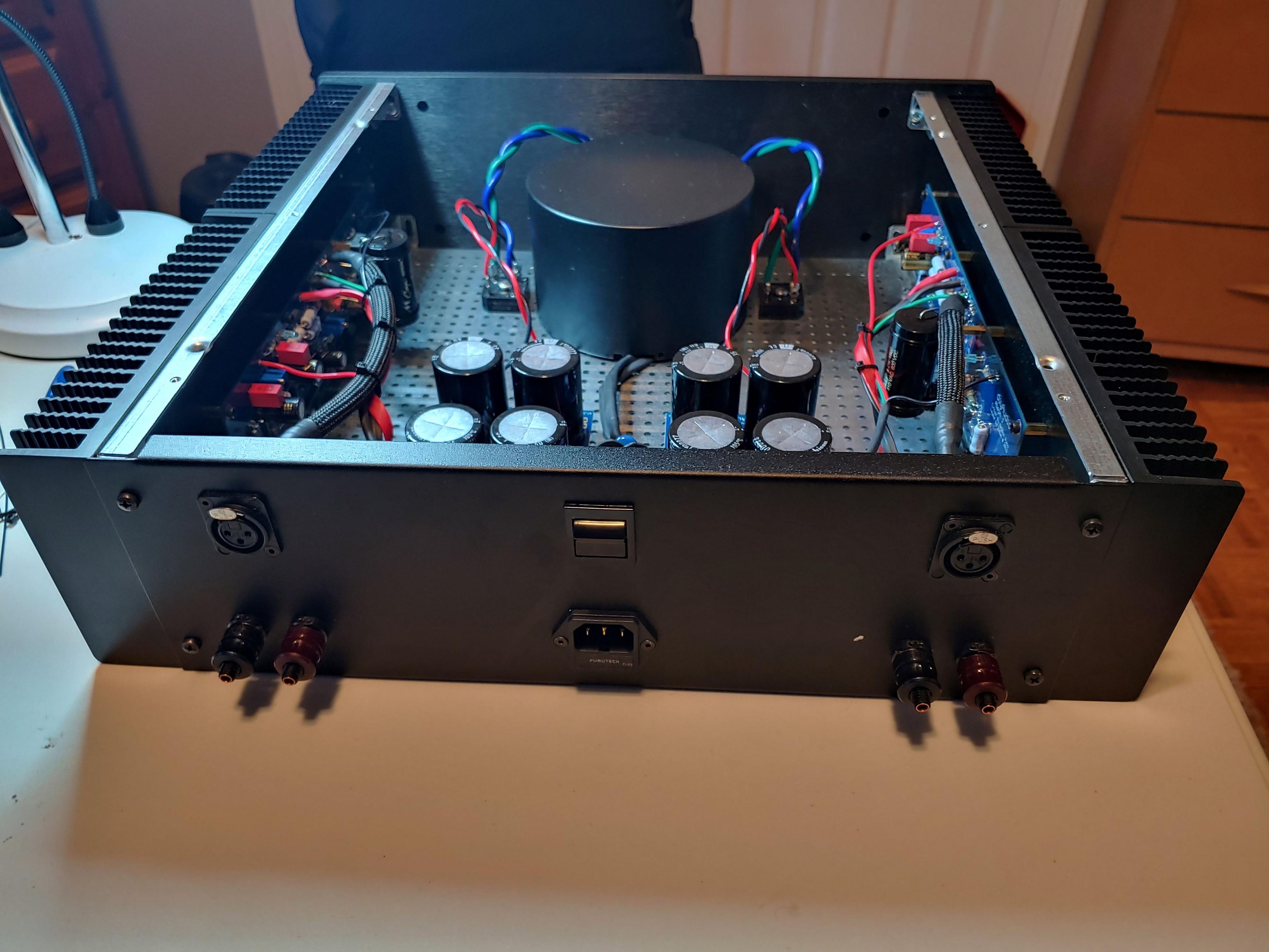

Hello folks
I finished the Aleph J amp last week, tested great. I just wanted to thank the community for all the guidance and advice this was a very fun project over this winter!! For this build, my philosophy was to use point-to-point wiring to most joints as I do believe materials such as tin with various conductivity characteristic can negatively affect the sound - maybe it's just me but I don't like them..I used quality copper to copper connection everywhere with Cardas solder and built my own back panel connectors with Fututech and full copper binding posts.
Sound is very engaging and detailed with clear instrument separation.
Question: how much time does the Aleph J take to properly break-in or loosen up? I find the imaging could be much better, compared to other amps I've own with same system find that I can easily locate where is the left and right speaker are located. With my former Bryston 2.5B3 amp, the speakers would just disapear in a "bubble" in front of me.
I am guessing it needs considerable break-in time, just wondering if anyone had same experience.

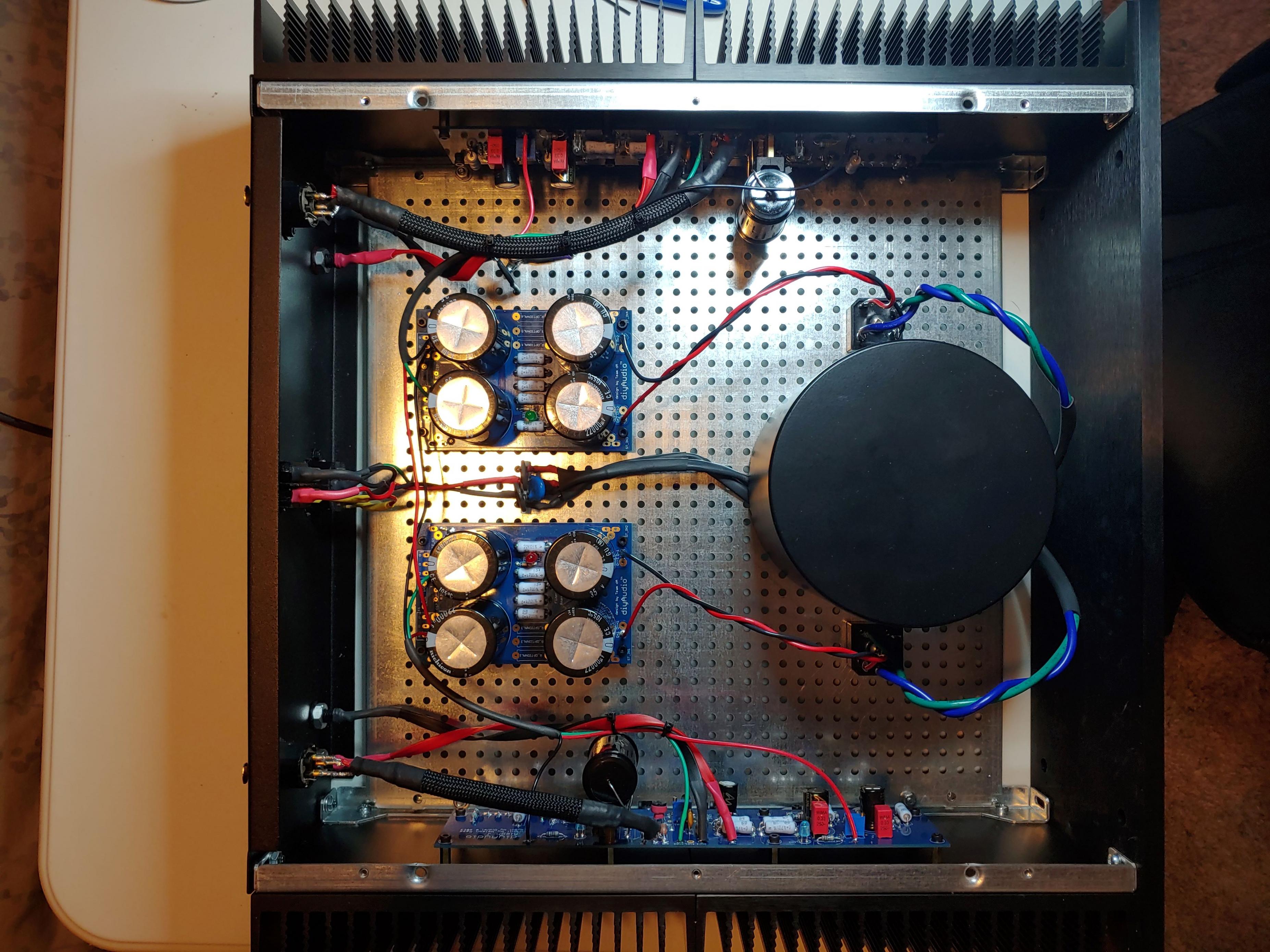

Sebtdi - Do you have your PSU halves connected together in the center? I can't tell from the photo but it looks like they are not...
Also where does PSU ground connect to (through CL60 or similar) chassis?
Yes, ground wires run under the peg board - just a cleaner look IMHO. Both PS boards are connected together to CL60 star ground as per instructions. Don't get me wrong the amp sounds great, just puzzled as to why reversing the speaker output improves the image..
