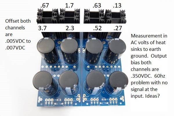

New transformer with purple ground wire installed. No 120hz coming through speakers but now a 60hz tone is coming through with no signals at the inputs. Biased at about .350VDC. Offset is to the third decimal to the right of about .005VDC.
If I touch the signal + connection where the wire attaches to the inside of the RCA connection it definitely gives a very loud, "Yes I can amplify".
Trying to measure ACV somewhere to explain the 60hz tone coming through. The heat sinks are anodized?? and is why hard to get a good ACV reading to earth ground but the attachment show what I got. Some of the readings are up and down and not steady. Maybe these reading mean nothing. Have twisted wires where I could.
Any help appreciated. Thanks
