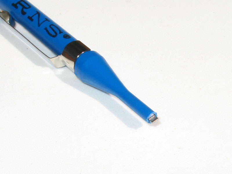

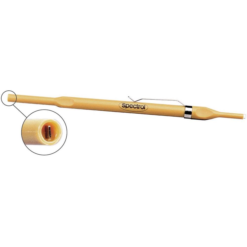

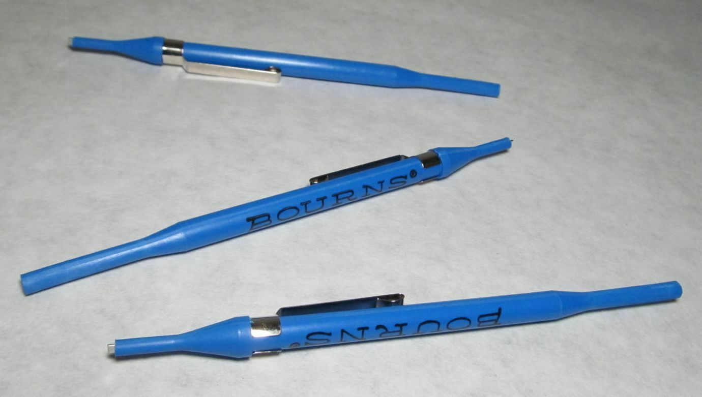

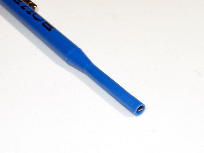

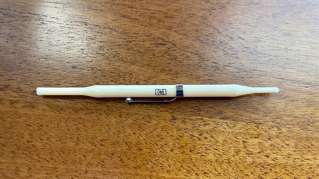

I just open and found an interesting tool for trimmers:
Vishay / Spectrol ACCTRITOB308-T000
ACCTRITOB308-T000 Vishay / Spectrol | Mouser
Bourns make them too.
Bourns H-90
H-90 Bourns | Mouser
My screwdriver sliped many times when I adjust DC output at my DAC.
And I was really scared to short something.
I will try one or both. Thanks!

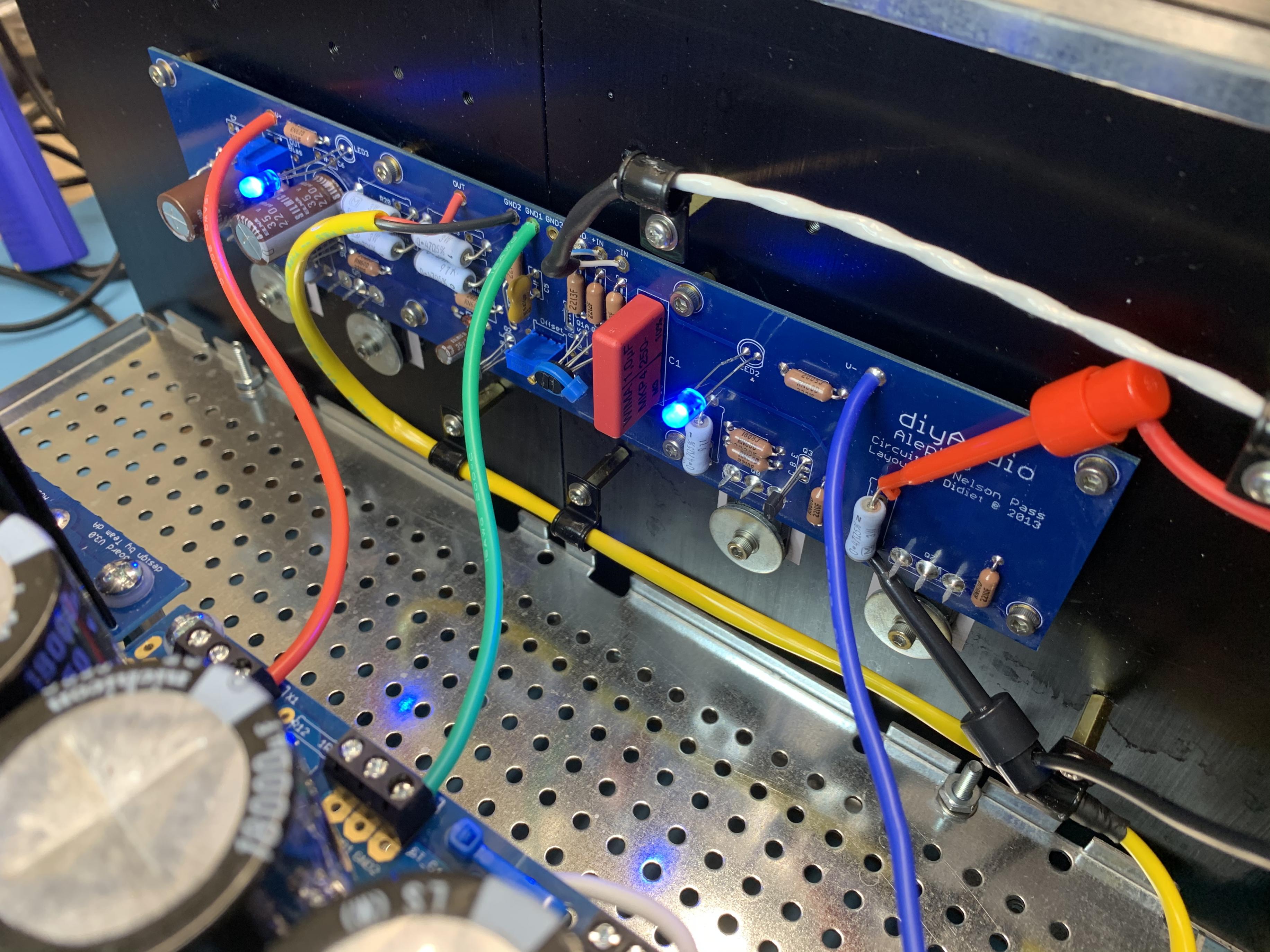

Amp Board Dim Bulb Test Failure Question
Fellow builders,
I need some suggestions on diagnosing a problem.
I have searched the Aleph J threads to address my issue with finding a result.
I am testing the second amp board and the dim bulb test light brightens and then goes out. This is not according to the instructions. LED 3 does not light (LED 2 does and stays on for some time after the power is off, as expected). I have done a visual inspection of the PCB mounted on the heat sink and nothing appears out of line. The power test and the first amp test went as expected and all of the values are within spec.
I readjust the trim pots, checked the mounting of the capacitors and diode, and the values of Q2 and Q3/Q4. No grounding of the MOSFETS. I have not taken the shrink wrap off of Q1A and Q1B to check those yet.
I am looking for a place to start before tearing thing apart.

Two questions: Does the dim bulb (incandescent, 100watt) go out completely? If not, it’s probably doing what it’s supposed to do. And, are your LEDs the same color on both sides? When I fired up mine, with the green LED on one side, I thought it was out, but it was fine, just very low output compared to the other colors I had.
RE: Amp Board Dim Bulb Test Failure Question-Partial answerr
Thanks for the suggestions. Root cause was the ground from rectifier was not seated firmly in the quick disconnect. Traced my steps and repeated the testing on the good amp right board to confirm before checking the bad ground connection. Same issue with the LED. Reconnected the ground and now all lights are on.
Now I need to determine why I am getting negative values on the left board. I was fiddling with the trim pots. Can trim pots be turned too far and fail? I am letting the amp sit and discharge before remeasuring the trim pots before for the initial settings (R27 at 68K and R7 at 1K).
Negative values like this? For me it was because I had the leads reversed. It’s no big deal if that’s the case. The voltage measurement number is the important part.
Chris, thanks for the photos. Something like this. My current questions is related to the Trimpots. I cannot set the initial resistances for the Trimpots. I think I may have over turned them in my attempts to diagnose the Dim Bulb issue. Can the Trimpots been “over cranked”? One is now clicking. Is it time to get new ones? Thanks
As Andy described, they click at their limit. When it starts clicking, stop, you’re at the end of its adjustment (nothing is broken, it’s by design). Then start turning it the other way and counting how many turns it takes. When it starts clicking again, you’re at the other end. Should be about 25 turns. Presuming this is the 100K trimming pot, it should start out adjusted to about 68K when it’s installed. The starting bias should be 350mA during burn in, but the 68K setting yielded over 500mA for me to begin with which took a fair amount of turning to tweak out. So as a rough starting point, count back 12-1/2 turns to get it near the middle of the range. Should get you close to a point where you can make adjustments, I suspect.
Anyone else, feel free to suggest otherwise. It’s been a week or so since I did this myself.
