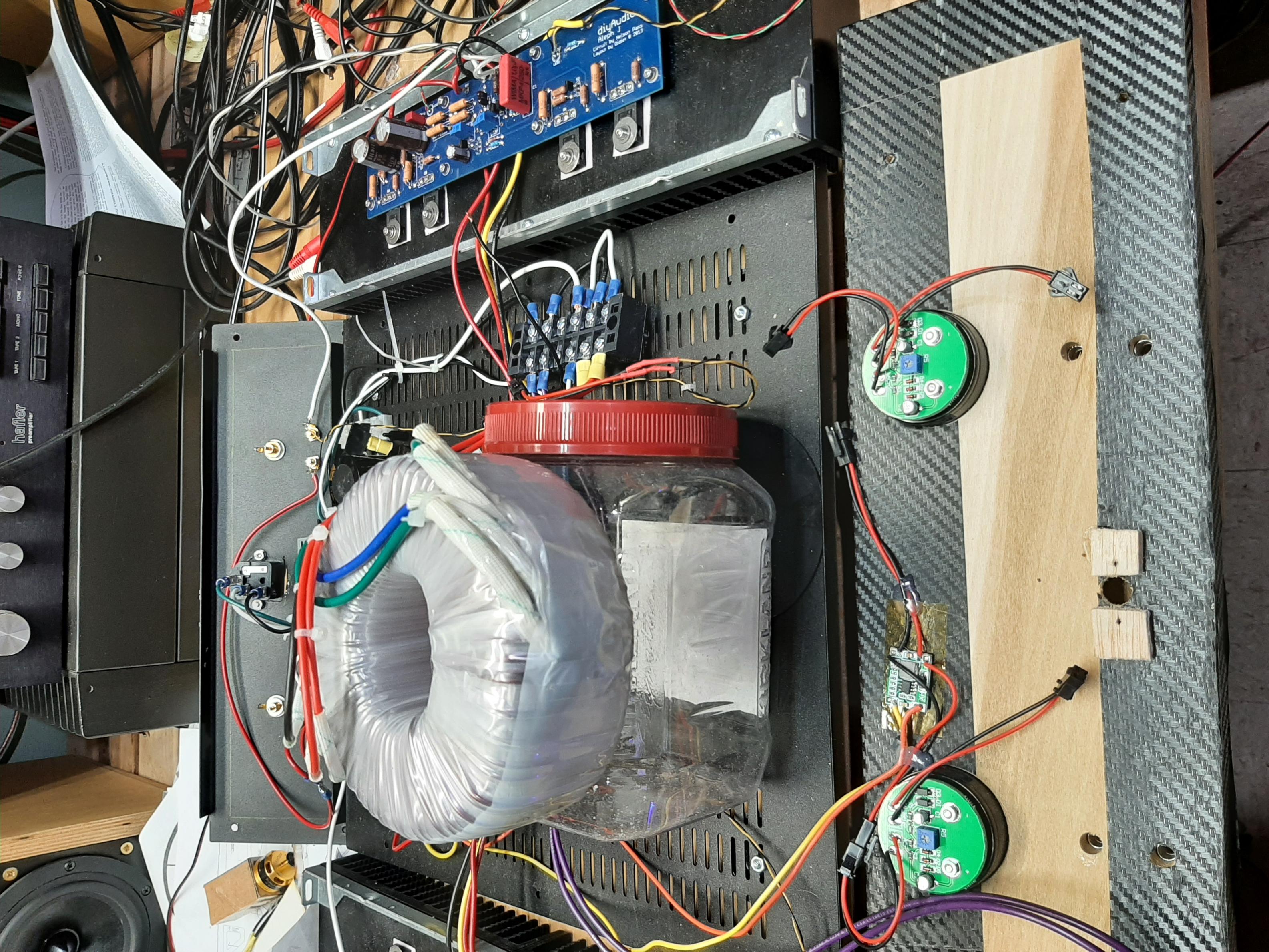

Unbolt the transformer and lift it as far away from the rest of the circuitry as possible.
Unbolted and set on top of plastic container. No change but was hoping. so. See picture

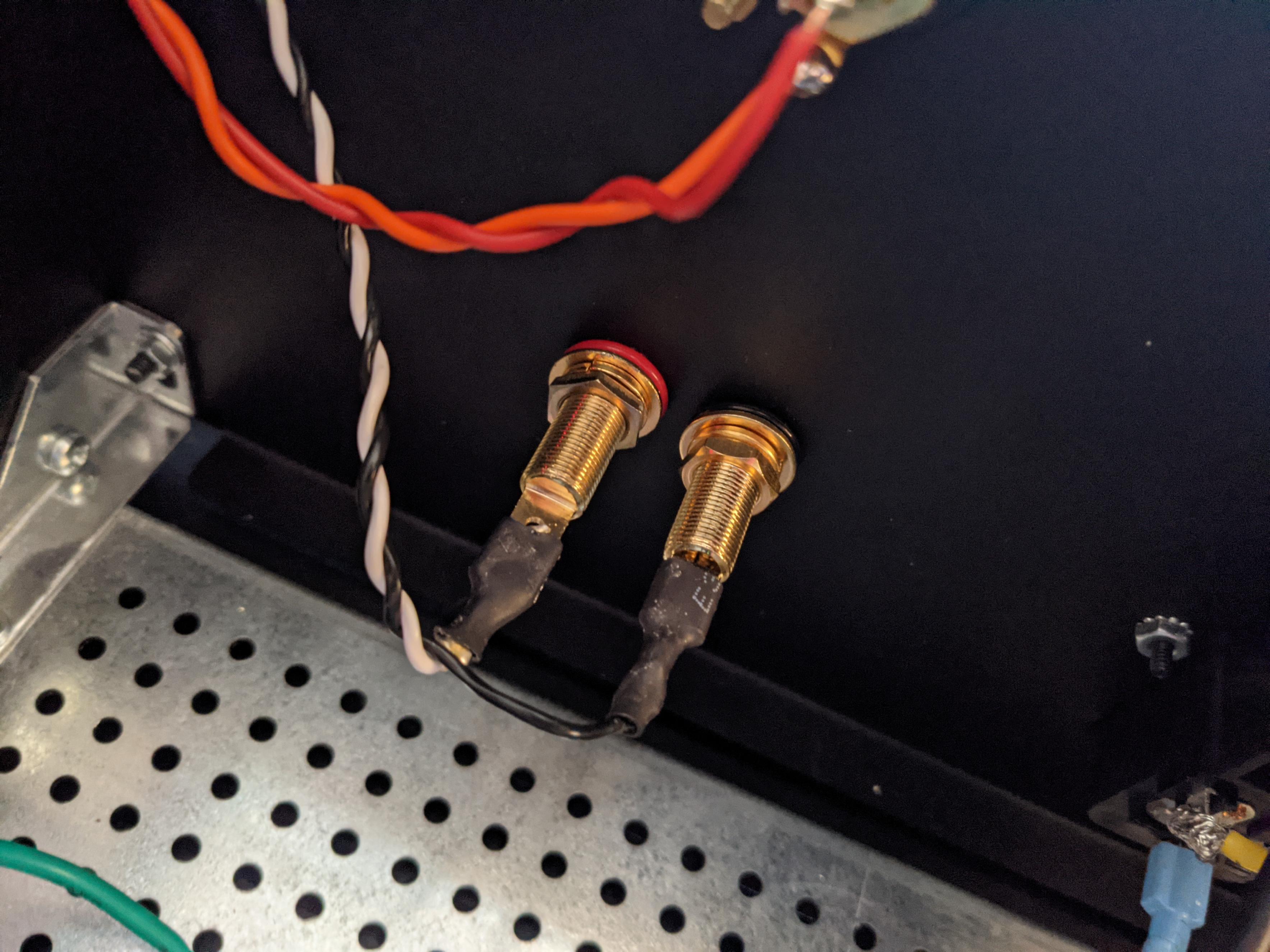

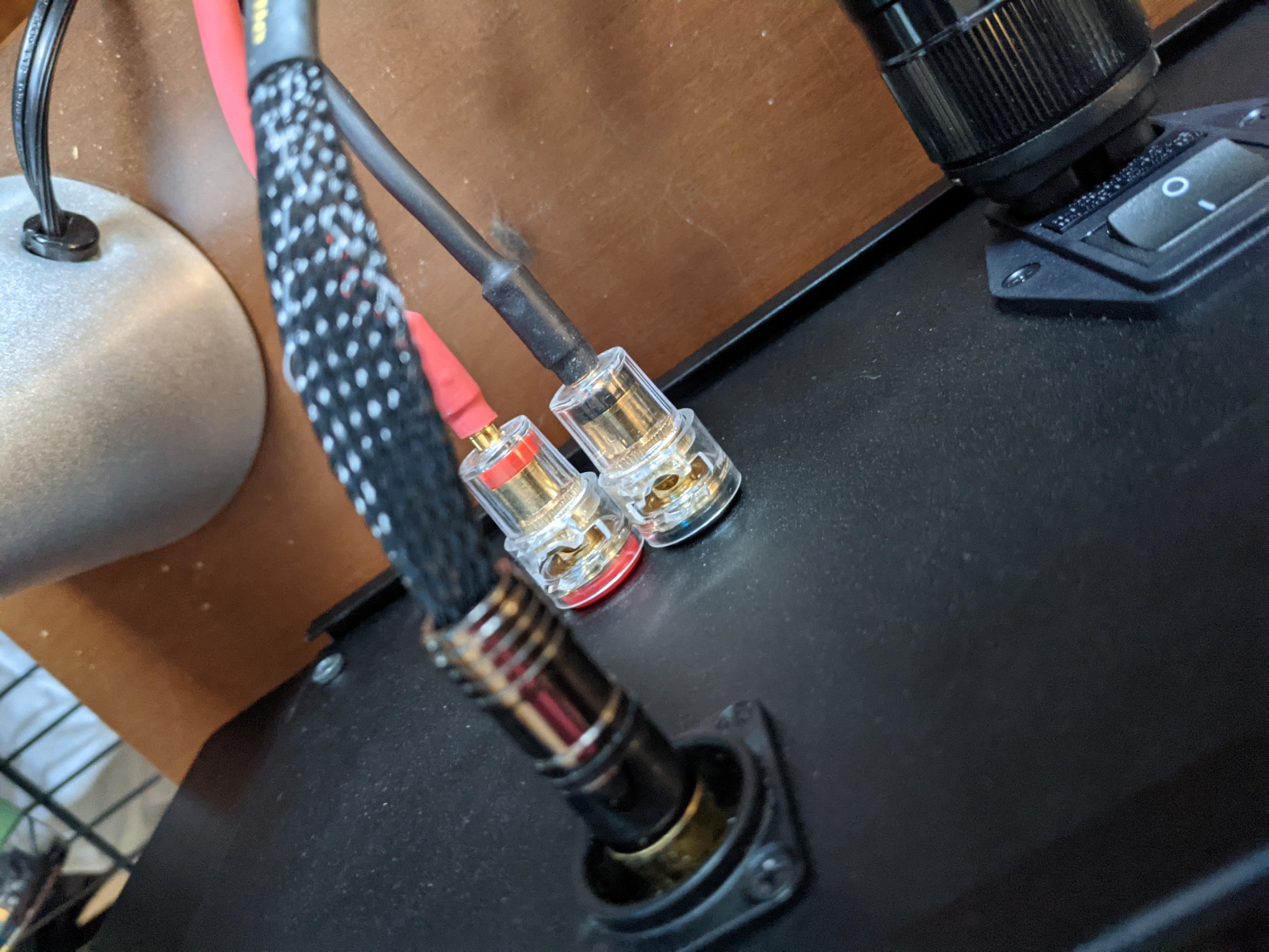

Also with the speaker terminals, I have the notch in the slot in the chassis but the second washer on the inside doesn't have another slot to allow me to tighten it fully. There's still a gap when tightened all the way. Is there something I'm missing?
Nevermind about the speaker terminals. I read in another thread about the issue and how to fix it. Just have to buy some nylon washers and file them down somehow.

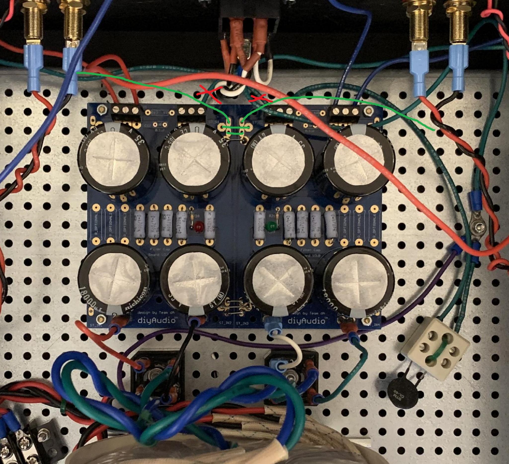

Check the photo I attached. The mains wiring and the CL-60 are all soldered to the IEC filter block lugs. This will dramatically reduce the mains wiring length to approximately 13cm (5 inches max) in total.
The secondary wiring is twisted and tucked underneath the transformer metal plate and power supply PCB, and then fed to the PCB from underneath, and then sodered.
The power supply PCB is positioned in such way, to minimise the length of the DC wiring as well.
The above will give you the best performance and a very neat look.

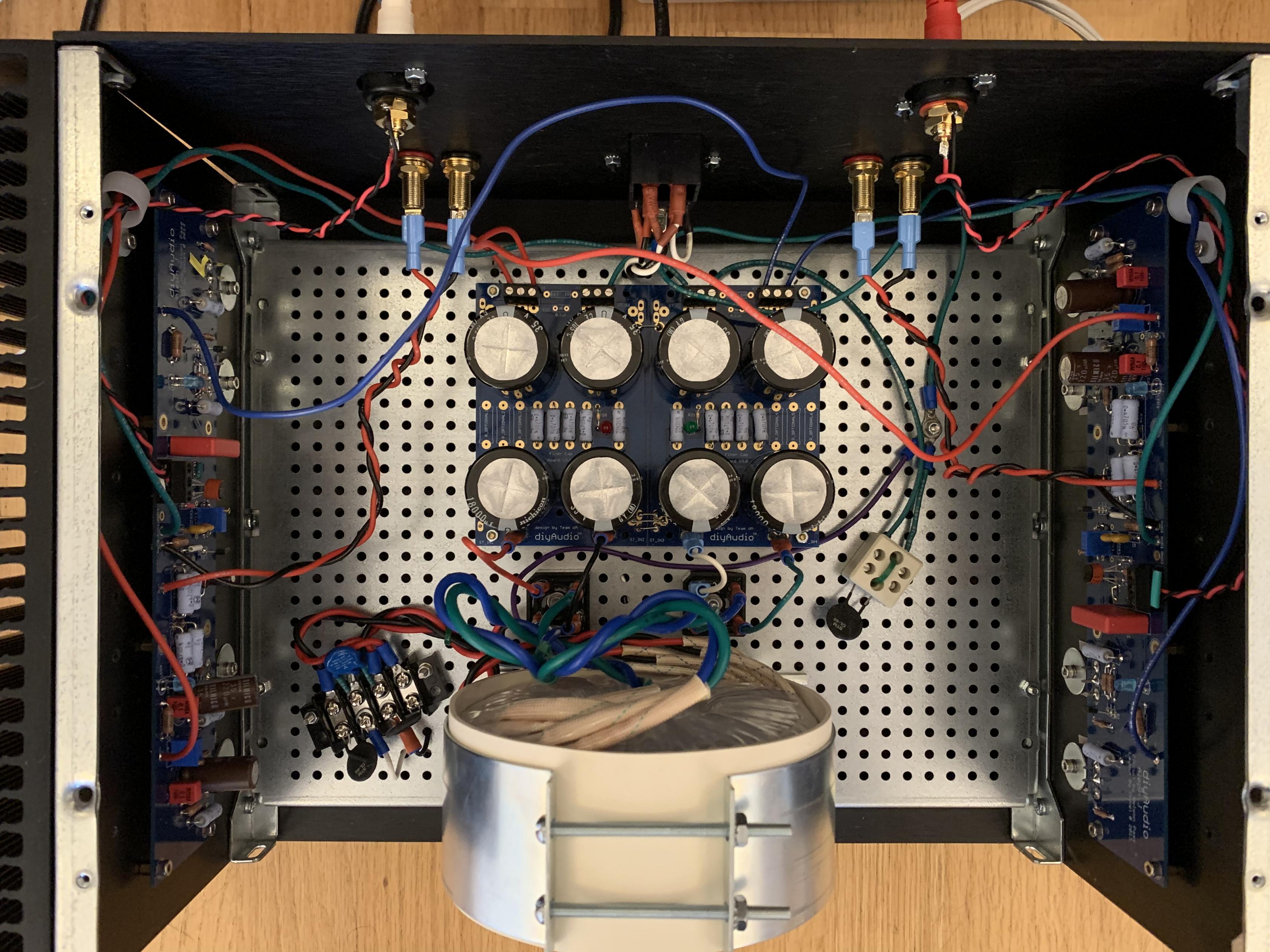

At last after months of lurking the newbie guide with its Mouser shopping cart was all I needed to get nudged to the starting line...
Still there’s a slight hum when I hold my ear near the speaker. When the source isn’t plugged in I notice the buzz is louder when I touch the input lines. But when connected no amount of jiggling things around seems to make a difference. It’s a quiet hum- not perceptible when in use. But it’s def not dead quiet.
I ran the AC lines underneath the board. Rotating the transformer doesn’t seem to make a difference. As for options I followed those indicated in the newbie guide which I think is based in 6L6’s build guide.
Any thoughts for this newbie welcome.

Quiet is relative. It depends on the speaker sensitivity. If you have speakers that are not very sensitive, a noisy amplifier may seem quiet. However the best approach is to have your amplifier as quiet as possible so that if you have highly sensitive speakers, your amplifier appears quiet.
Here is something by diyAudio member Bonsai:
http://hifisonix.com/wordpress/wp-content/uploads/2019/02/Ground-Loops.pdf
I highly recommend following his advice and recommendations. I do and my amplifiers are quiet enough for my 103 dB speakers.

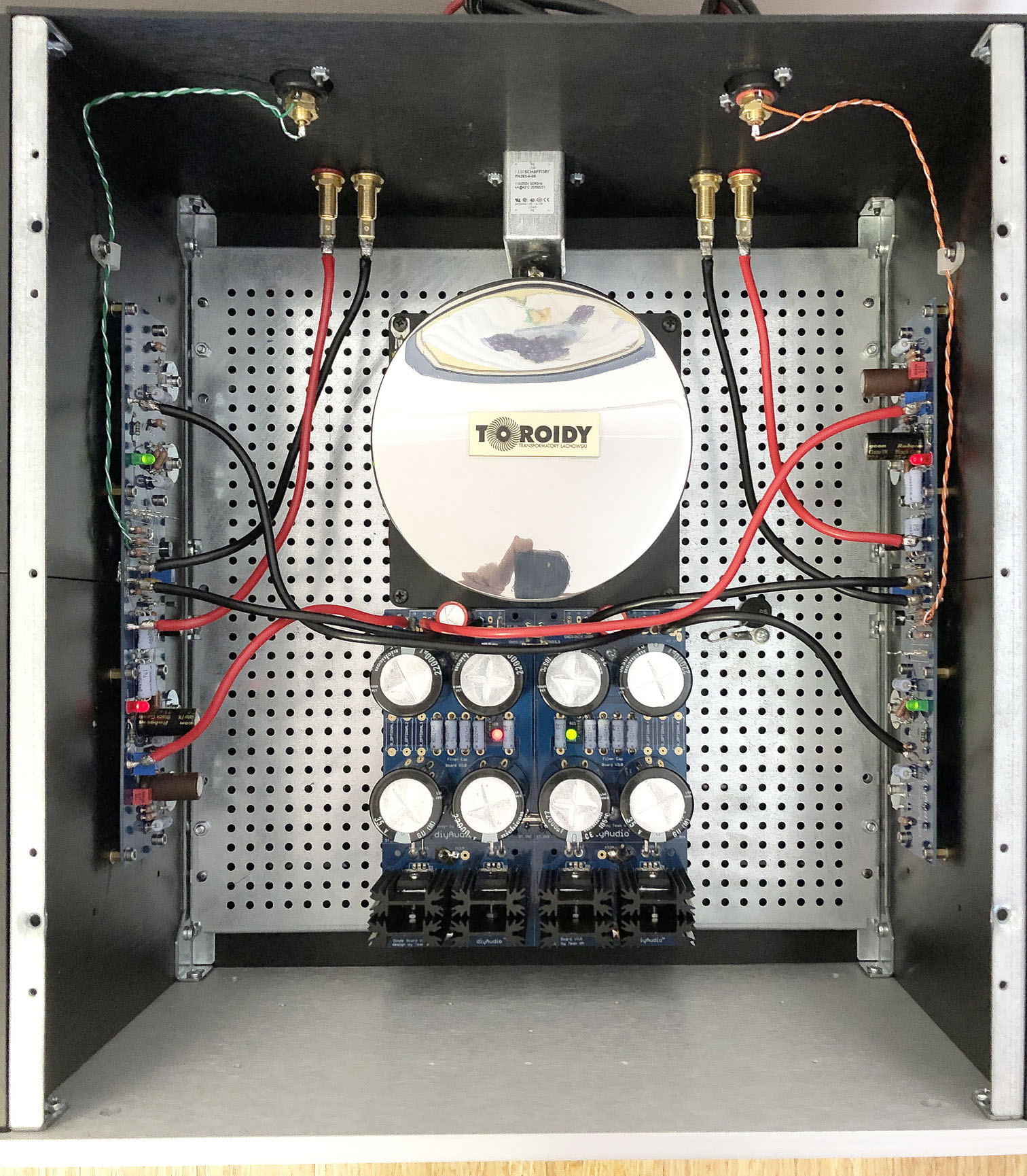

I see that that you have done a good job of twisting some of the wires in your amplifier. However, your V+, V-, and Ground wires from your power supply board to the amplifier boards are not twisted at all. The three wires to each amplifier board should be tightly twisted too.
If you look at Bonsai's recommendation for the ground point from the power supply, you will see that he recommends taking the ground from a location that is centred between the V+ and V- capacitors. Unfortunately the diyAudio power supply board makes it easy for builders to not do this. I have marked up your photo to show how this can be done. Instead of taking the ground off the board as you have done, take the grounds from the board where I have shown by soldering the ground wires to the board. Also add two more wires to join the grounds from the two sides of the board to better unify the ground.
The terminal block with AC wires is also quite close to the left channel circuit board. Moving it closer to the chassis centre line would probably be helpful. You can move the left rectifier block if needed to provide a bit more room.
One final suggestion is to rotate your power transformer so that the wire exit and entry points are at 12 o'clock and 6 o'clock. Those are leakage points and it is best if they do not point toward the amplifier circuits.
