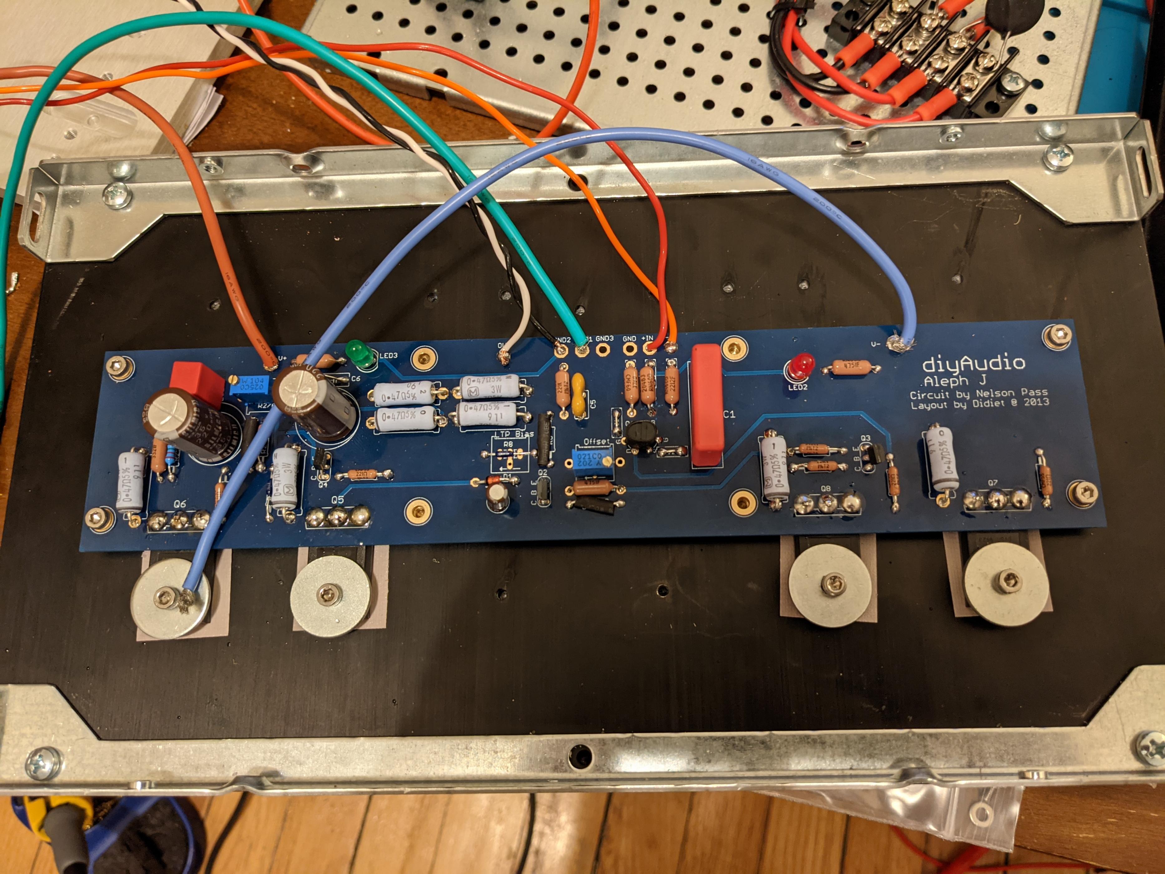

So the good news is that I took the board off reheated some connections and now the offset is incredibly sensitive and I'm able to adjust it now. Unfortunately when I turn the amp on with the leads connected there's a large amount of voltage that comes out of the speaker terminals, I can easily adjust the offset back down to close to zero although it does fluctuate a bit. The bias holds steady. The same thing happens when I turn off the amp.
I think it might be happening because I was missing one safety capacitor that connects on the terminal strip with the two cl60s.
Here are some photos.

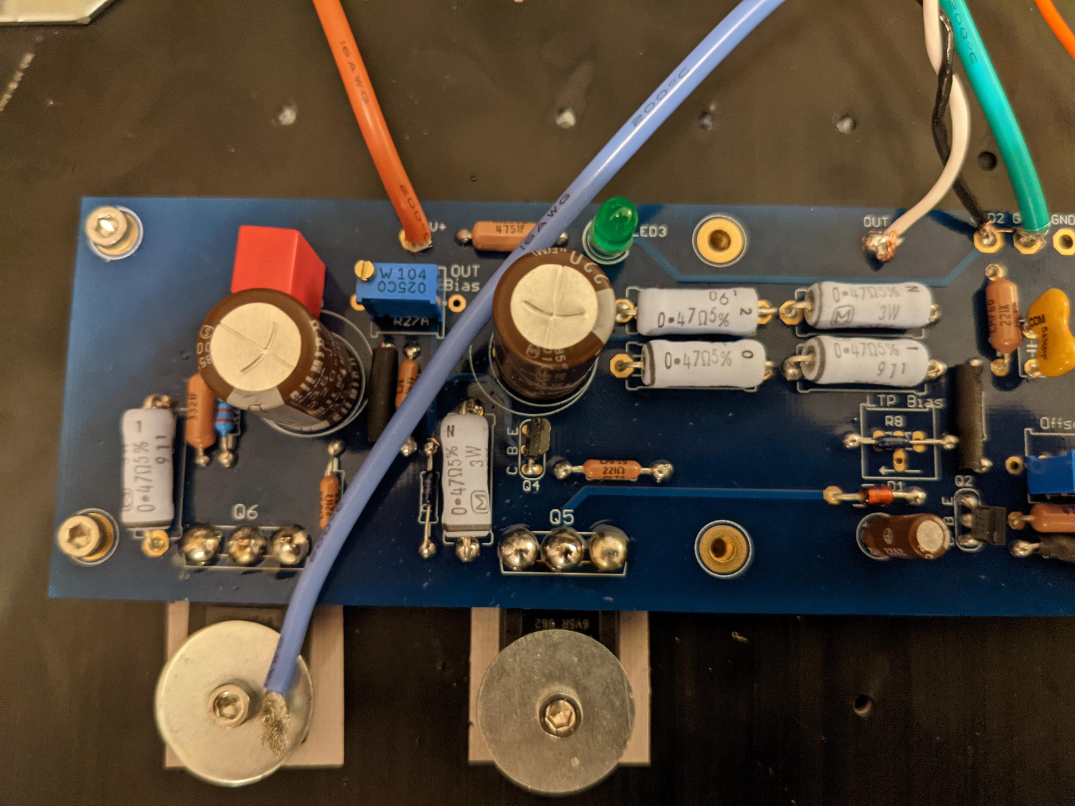

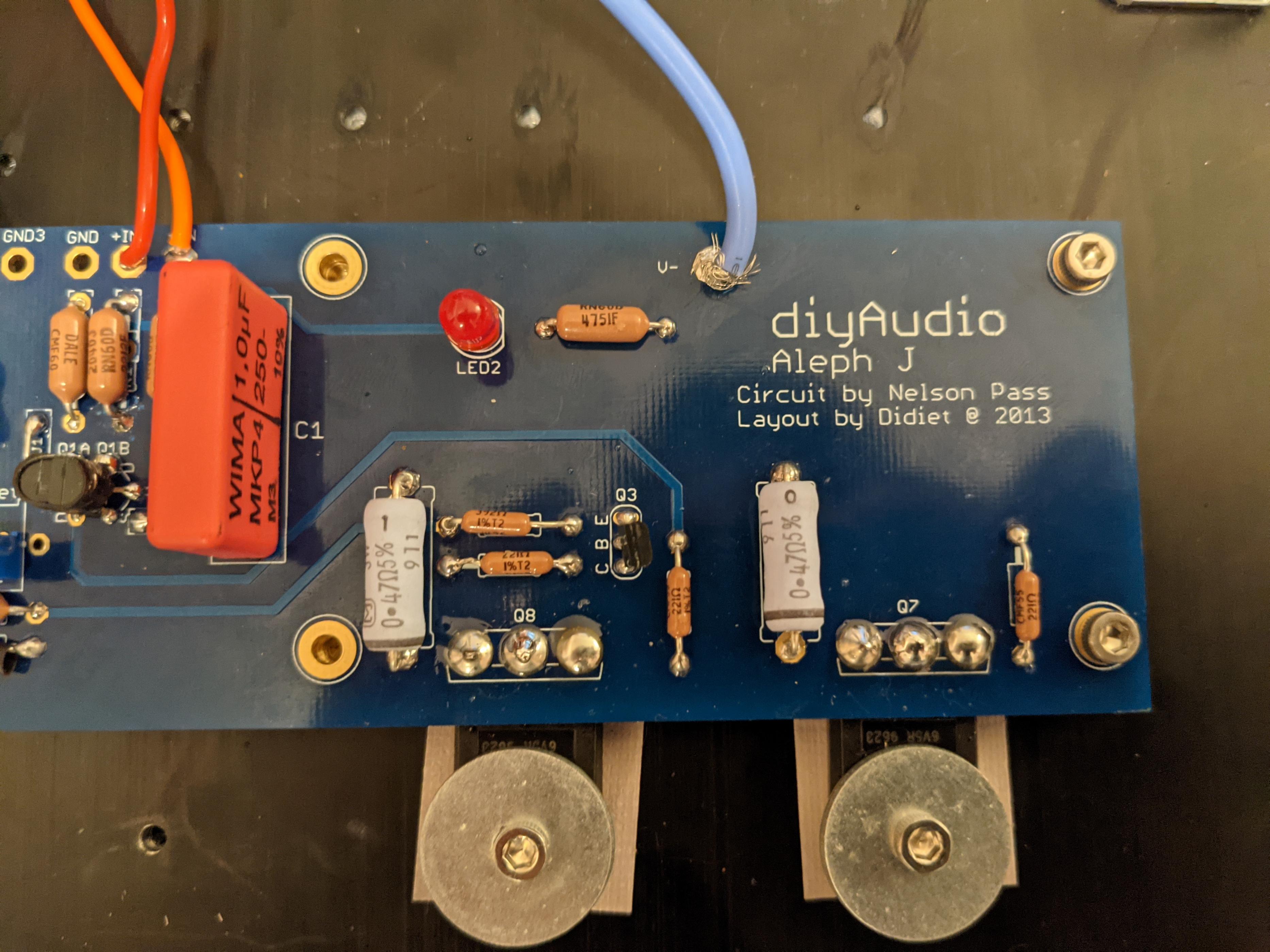

I'm having a bit of trouble uploading the images of the problematic board. I posted it on IMGUR and tried to link the images here, hope that's okay and not against the rules.
I wired in the other board and it's completely perfect, offset as close to zero as my meter will read and bias is steady and easily adjusted.
The problematic board, board number 1, gets a huge influx of voltage on powering on and off. I can adjust both offset and bias after power up but it doesn't seem like the change affects anything when I turn it on and off again. There's still a big spike of voltage. Hopefully these photos upload so someone can give me some direction.

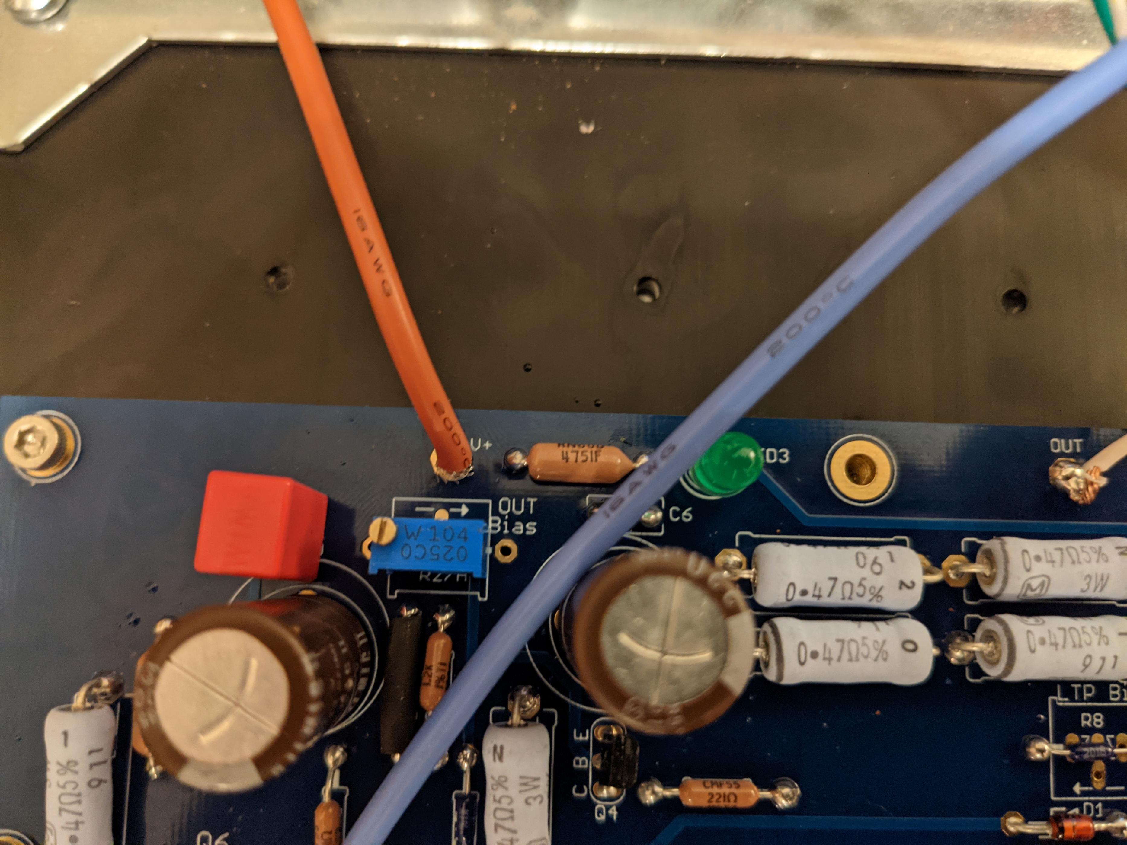

So I desoldered a connection I put in where one of the optional film caps would have gone. I think it might have been c6. I thought possibly I had to have a jumper there but I was mistaken.
Now I'm able to adjust the bias and it holds steady but the offset is stuck at -22 volts or so. I can't seem to make any adjustments that will make this change by much.
Any trouble shooting I might try before giving up for tonight?
I'll try to upload the photos again but I think they need to be resized for the forum.
Lets see if the photos post now.
Check Q2. Looks backwards.
Thank you so much! That was the problem! I fixed it and it's working perfectly now. Thanks again!
