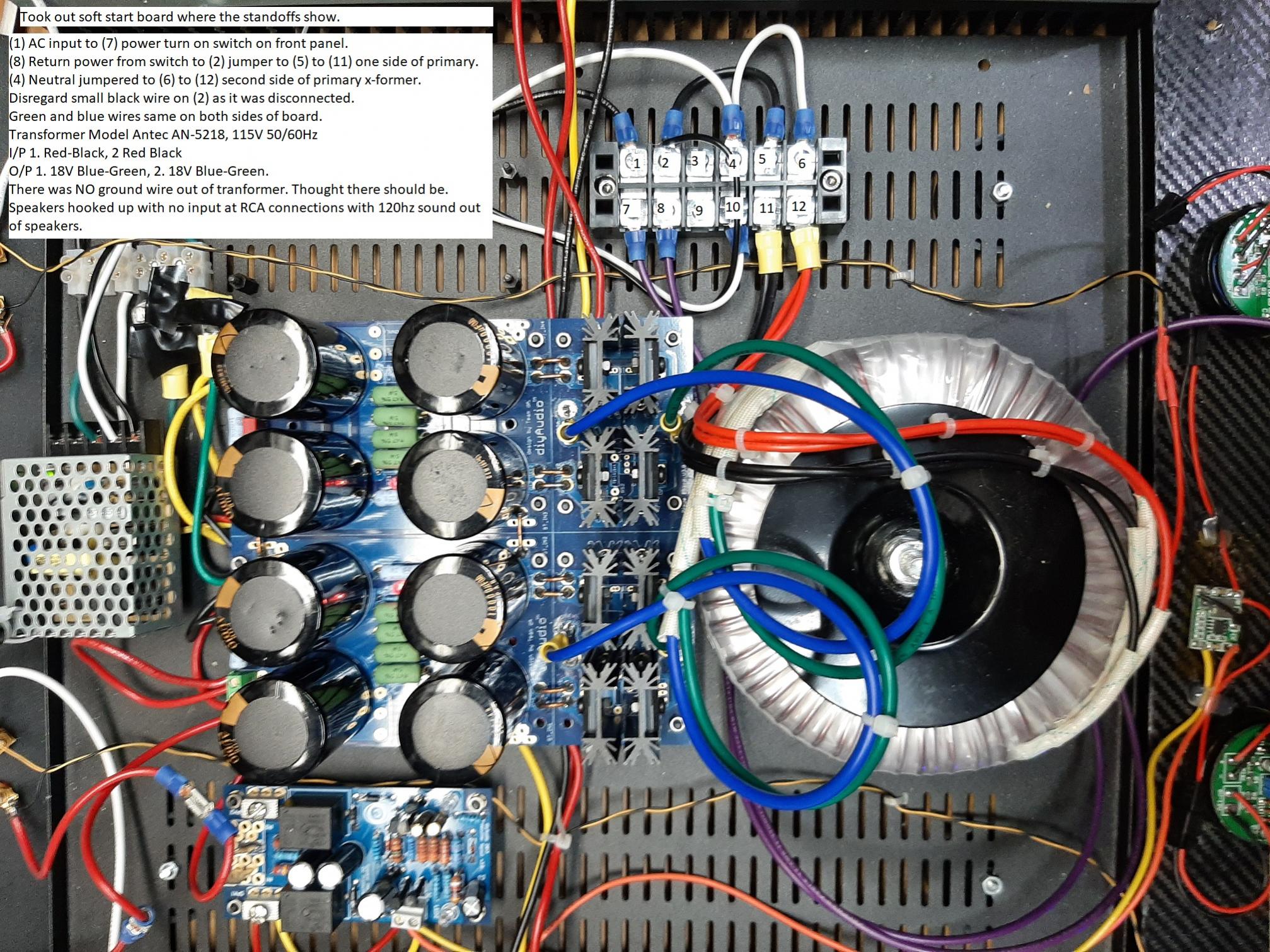

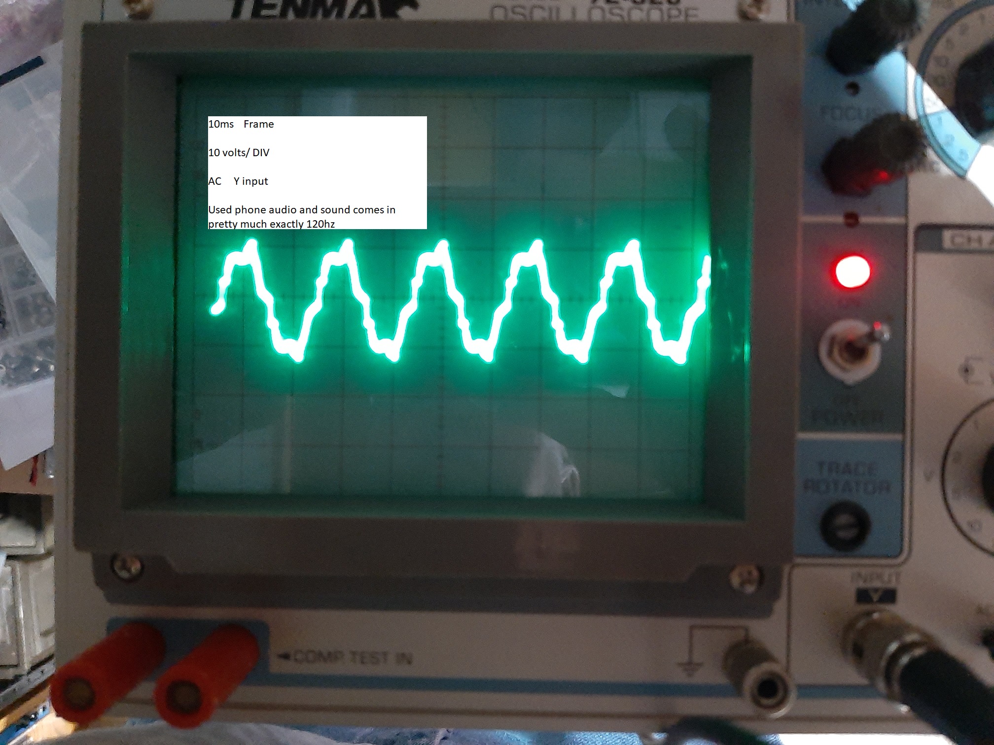

120hz sound coming from speakers.
Back at it after sitting out for a while. This has never worked, not complaining just a FYI for help with the problem. 120hz sound out of speakers just being powered up.

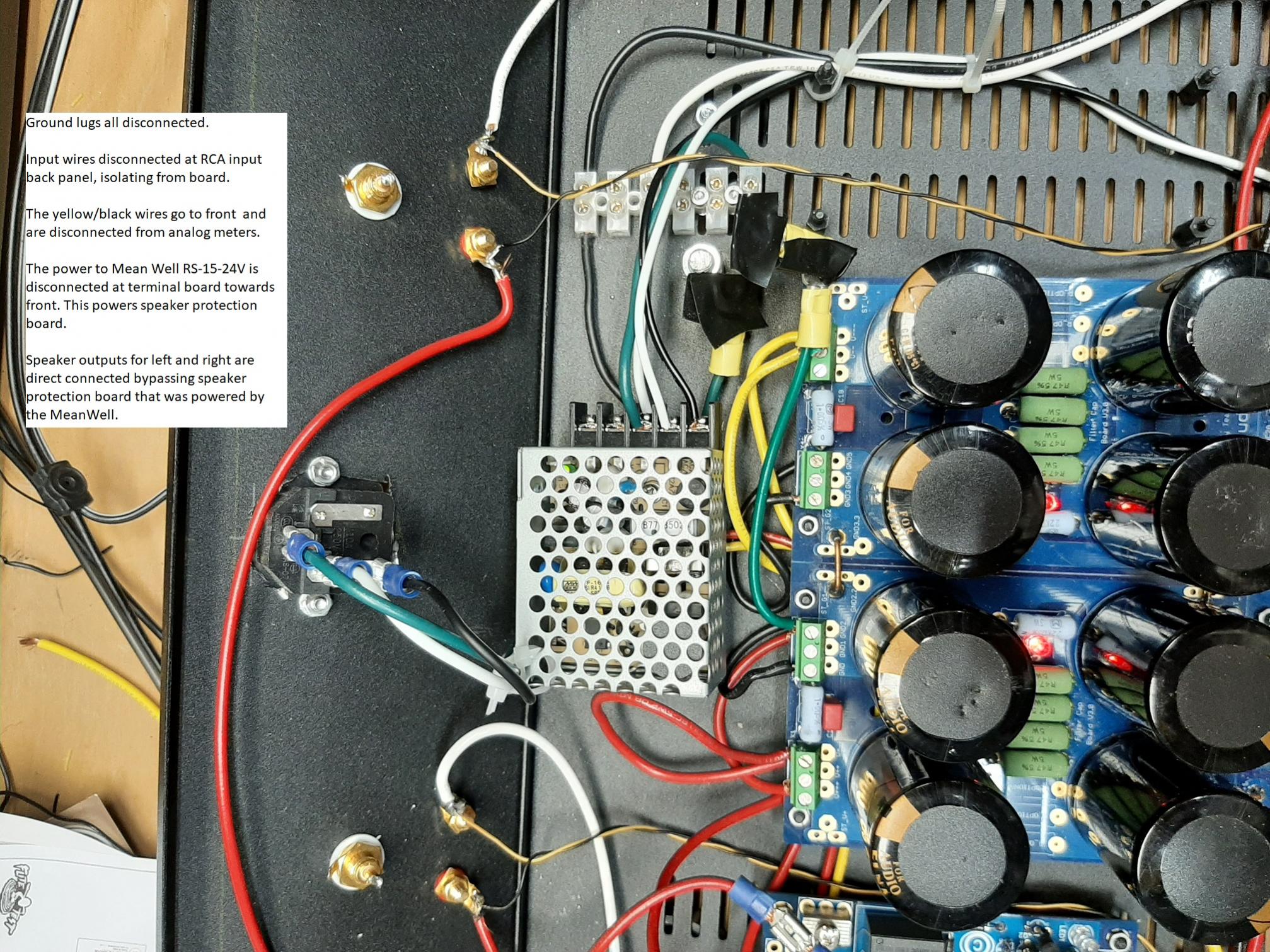

See pictures for more information as to what has been done. Bypassed soft start board (removed) and bypassed speaker protection board.
Grounds landed and taken off. Still same 120hz sound out of speakers.
Bias was set at 4.0mv but lowered it to 3.50mv to a more lower chassis temperature.
The scope picture was taken with light off to get the signal trace to show up on camera.
Scope readings were basically the same most everywhere on the chassis with trace mostly staying the same in amplitude.
Tried jumping with alligator clip wire from ground to neutral TB neutral (4) to see if hum sound changed and it did not.

Have build two Amp Camp 1.6 versions and they work fine.
I see others and use what help you give them also. Appreciate what ever help you can give for ideas to try. Tried to anticipate questions to me, so hope most are covered as to what has and has not been done. Don't need you guys to do all the legwork. Thanks and happy new year.
