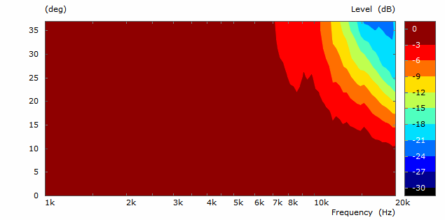

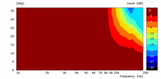

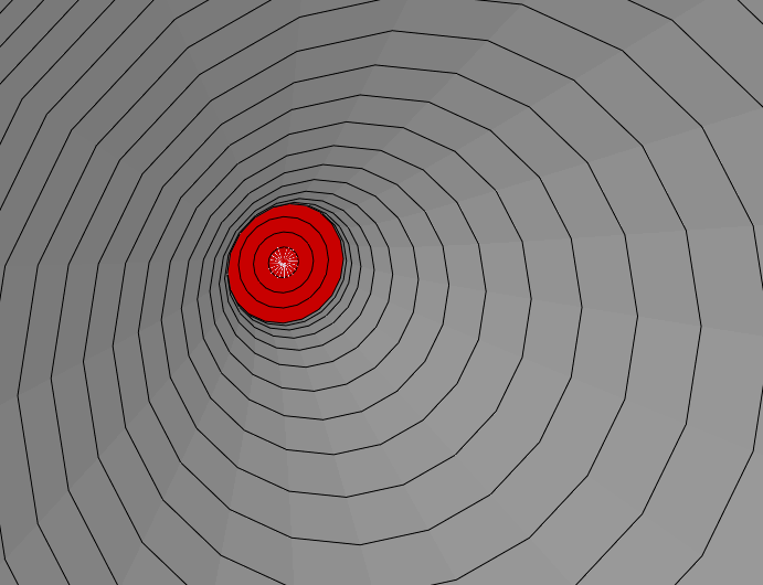

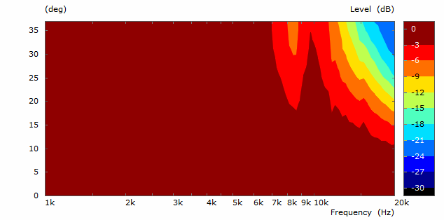

I tried the step-tappered throat amplitude but not much of improvement so far. Maybe the exact wavefront profile is much more critical than I anticipated.
(2" throat, 75deg coverage; from left: flat, taperred(1), tappered(2))
Did you just shade the amplitude? Is there phase shift as well?
I do see some substantial effects even with what you showed. I would not expect a huge effect even best case. We are talking about 2nd order effects here.
Just the amplitude. I tried the range 1 -> 0,5-0,8 with various steps. Some was better, some worse. I want to try this on a real driver some day.
