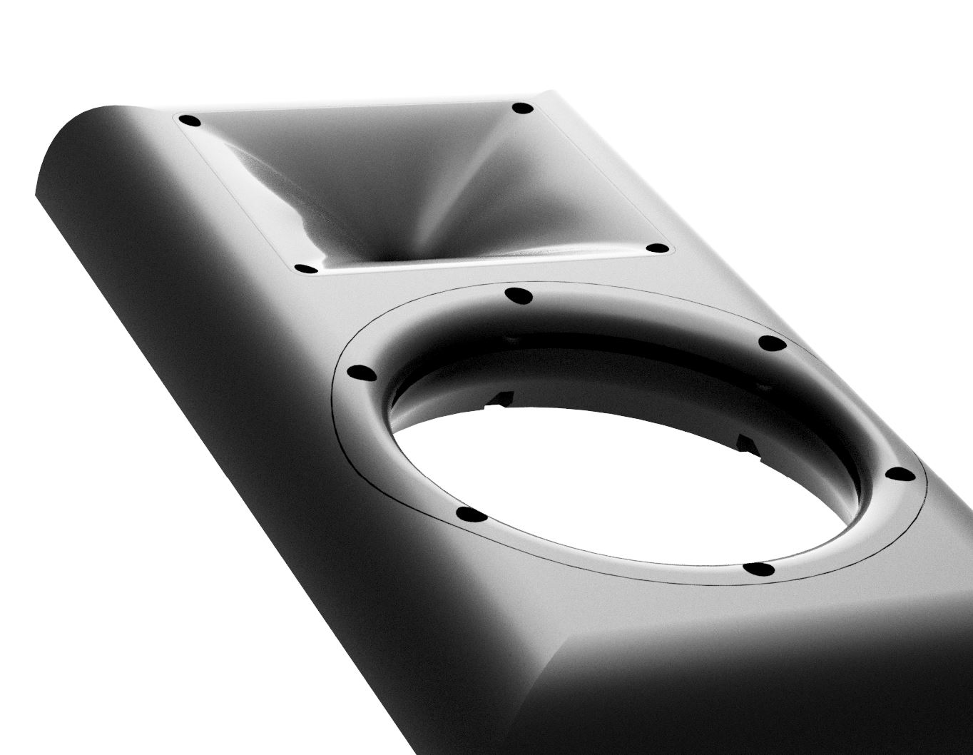

what were your thoughts on how to achieve stiffness of the baffle?
I haven't had such thoughts 🙂
I think it's already good enough, actually. The baffle is pretty thick and can be printed really stiff, if desired. It's just a toy, this is not rocket science. Anyway, I'd be perfectly happy even with the (mostly hollow) PLA prototype.
Still some minor modifications...
The overall thickness is 44 mm, which is really what makes it stiff. It's like holding a piece of wood, only much lighter. This is nothing like an injection molding, if that's what you mean by a "thin and resonant baffle made from plastic". Did you ever try to actually print anything?

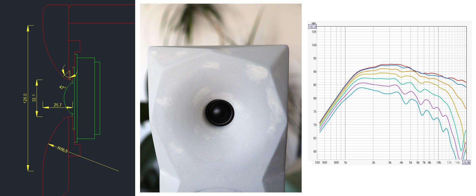

I've been playing with a 5 inch wavguide idea.
but crossover will be around 2.1-2.5kHz or so.
keep in mind that (in particular with this WG size+ crossover frequency combination) it's essential to consider the whole baffle (speaker) to be part of the waveguide.
a 5" driver will just start being directional at around 2 kHz, of course depending on the baffle shape.
I guess you can find lots of good waveguide examples for dome tweeters at www.somasonus.net
I can show my very rudimentary "hand carved" version:
the faceted "roundovers" are mostly for visual pleasure, but they optimize the directivity. roundovers would probably be even better.
EDIT: and never mind if you were asking for a CD waveguide!
