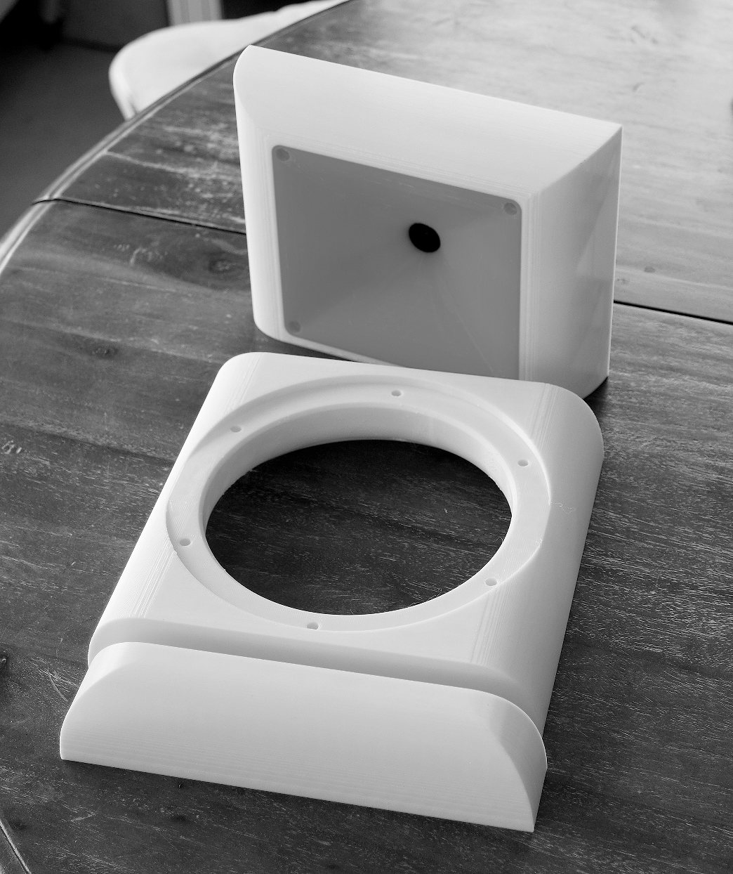

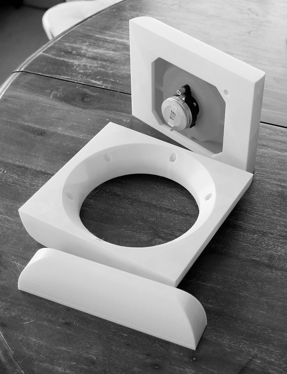

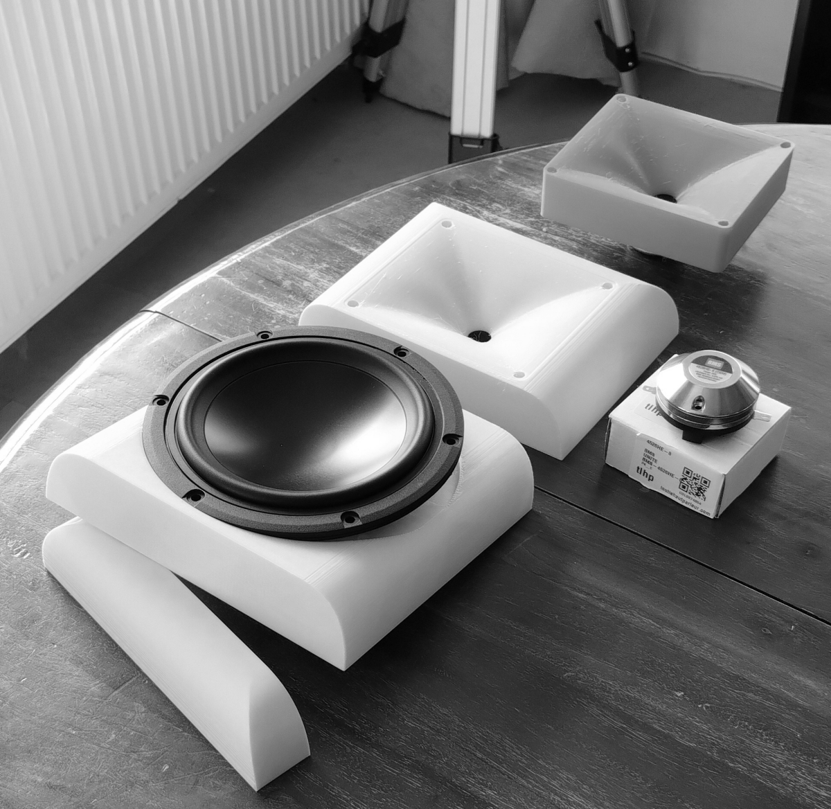

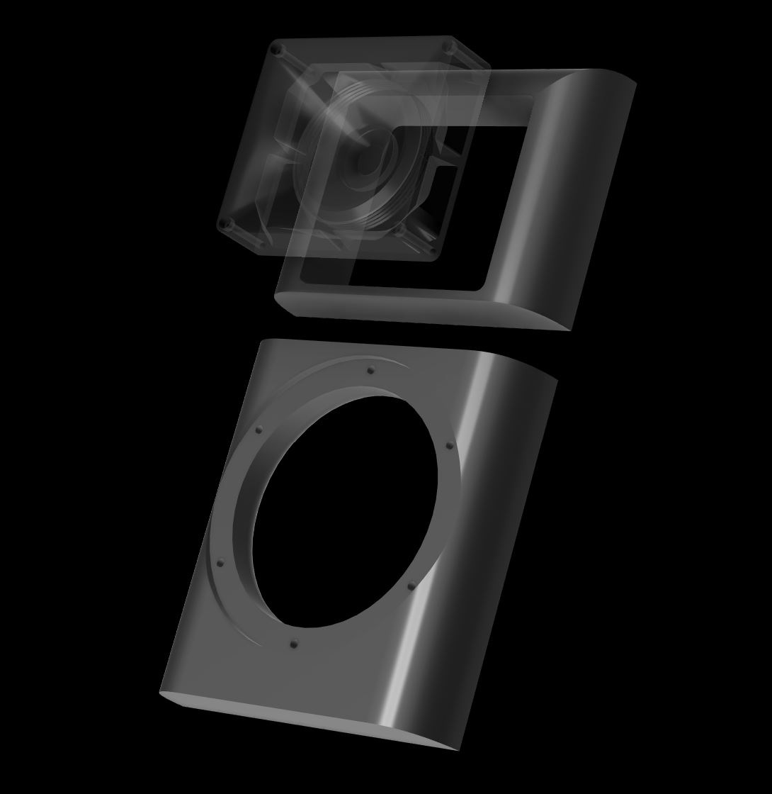

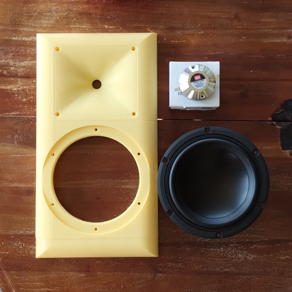

So, something like an SB17 chassis? Cool! My printer is good for 220 mm, so I'd be right there.

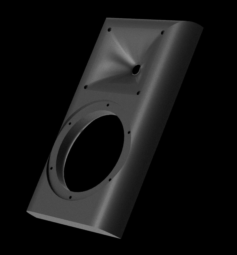

Sure, anything of that size, it's just a matter of different cutouts (STEP file without the cutouts will be available).
I'll be making a full design with Dayton SIG180 (not sure about the HF driver yet) including the crossover etc.
I like the idea of adding just a simple box to the printed parts. This can be done in a kitchen 🙂

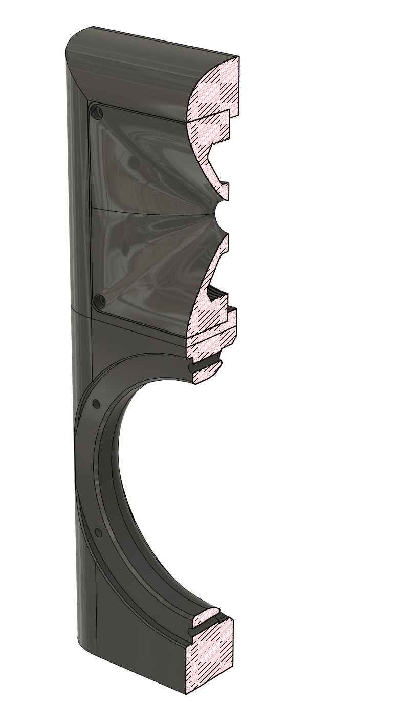

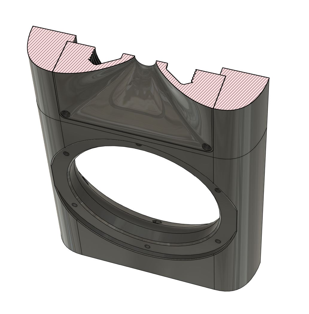

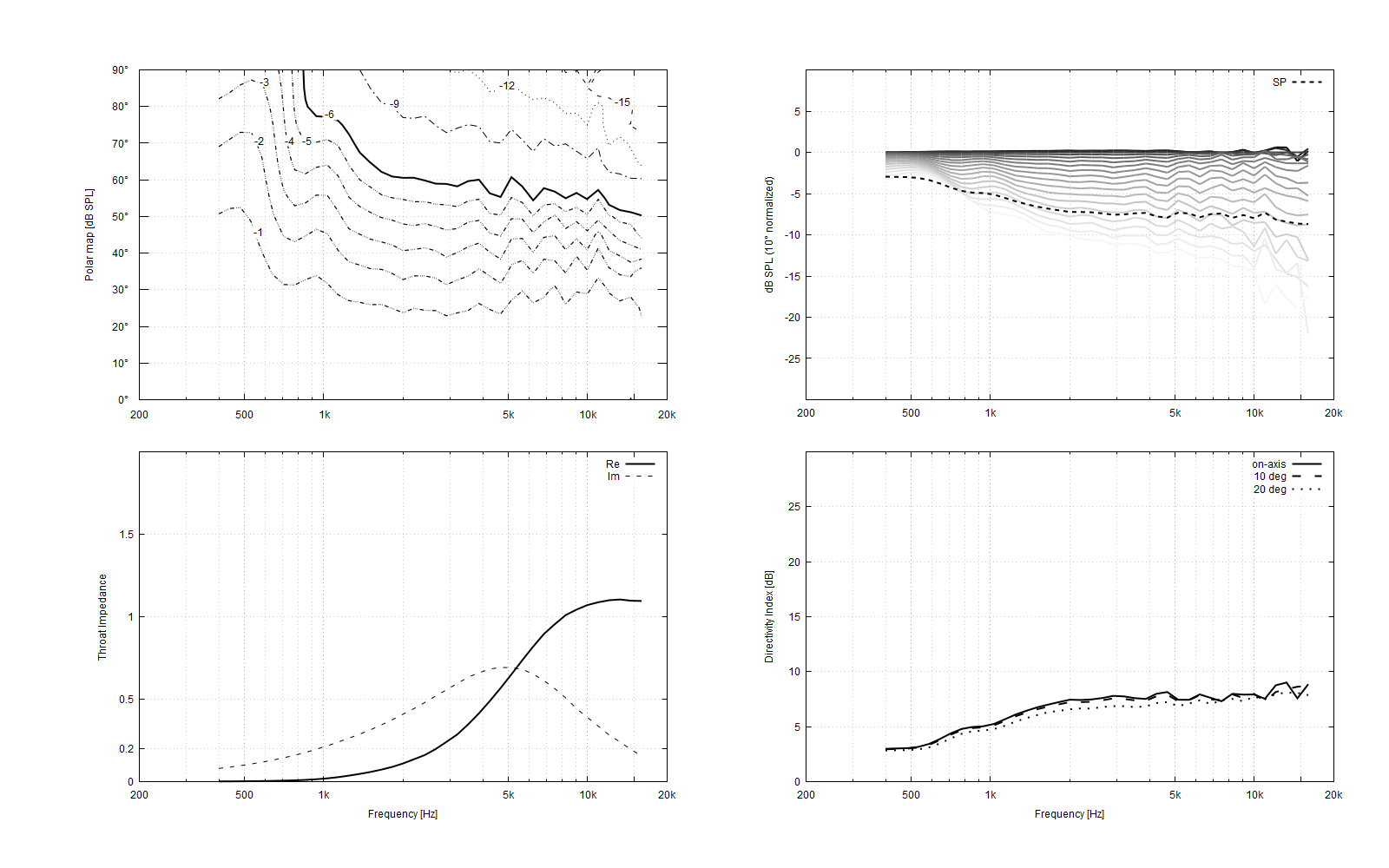

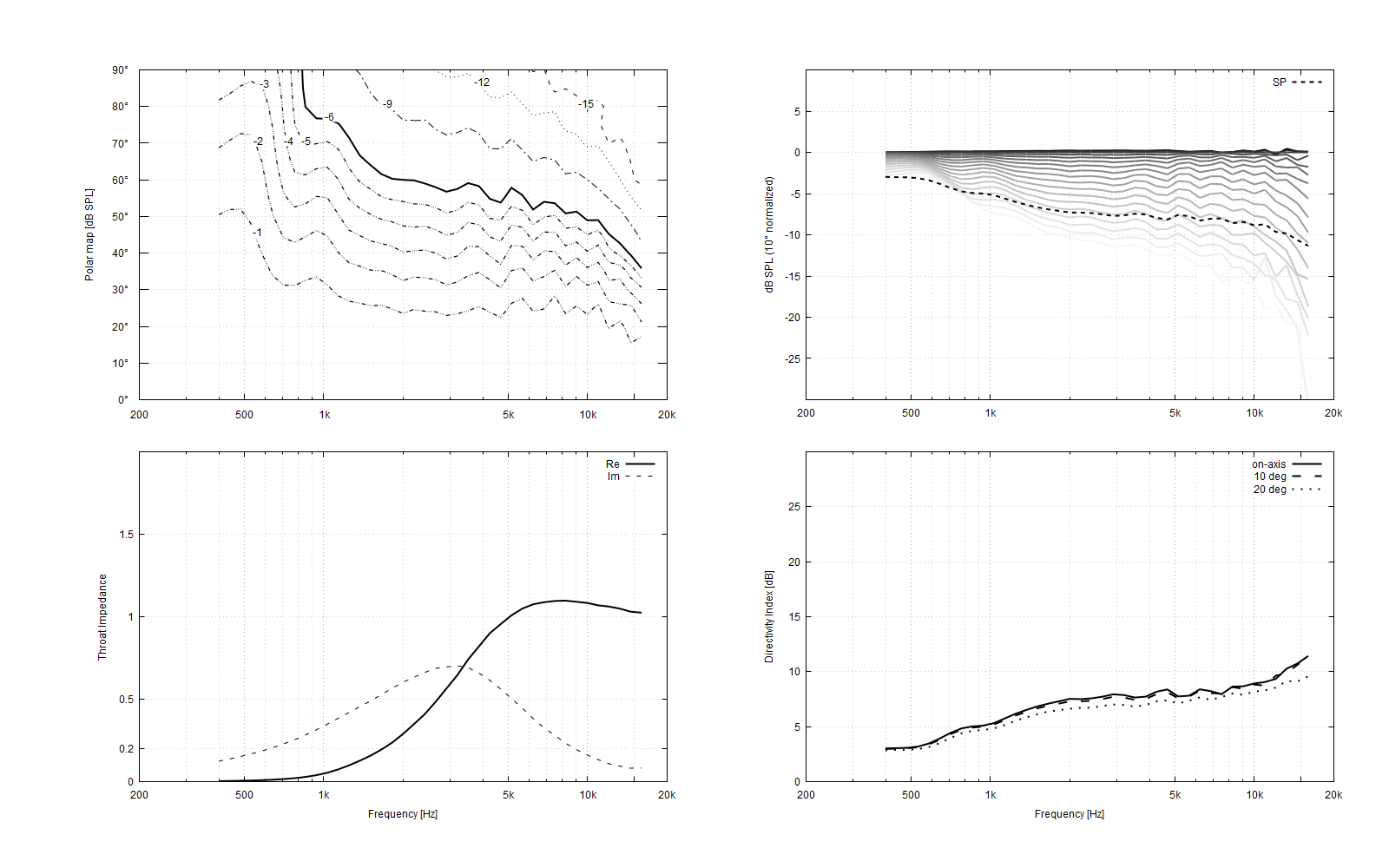

A quick sim including an intended enclosure.
1" throat:
0.63" throat (BMS 4526 / 4526HE):

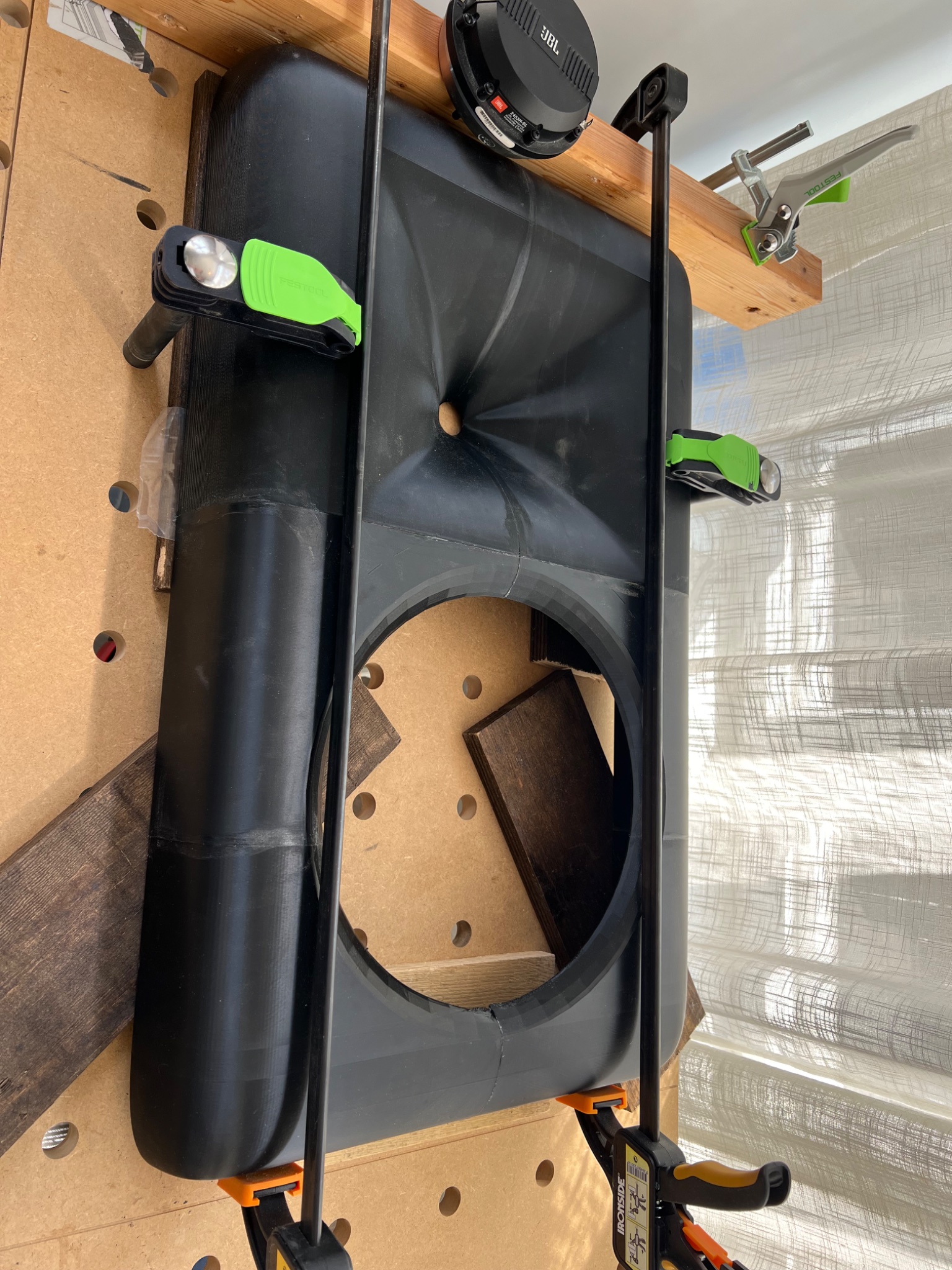

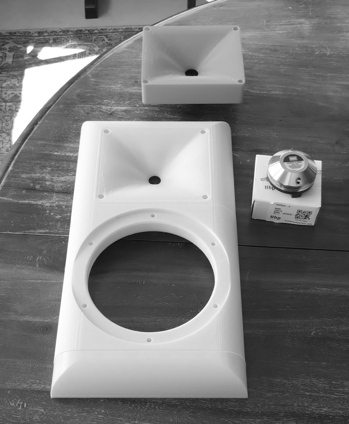

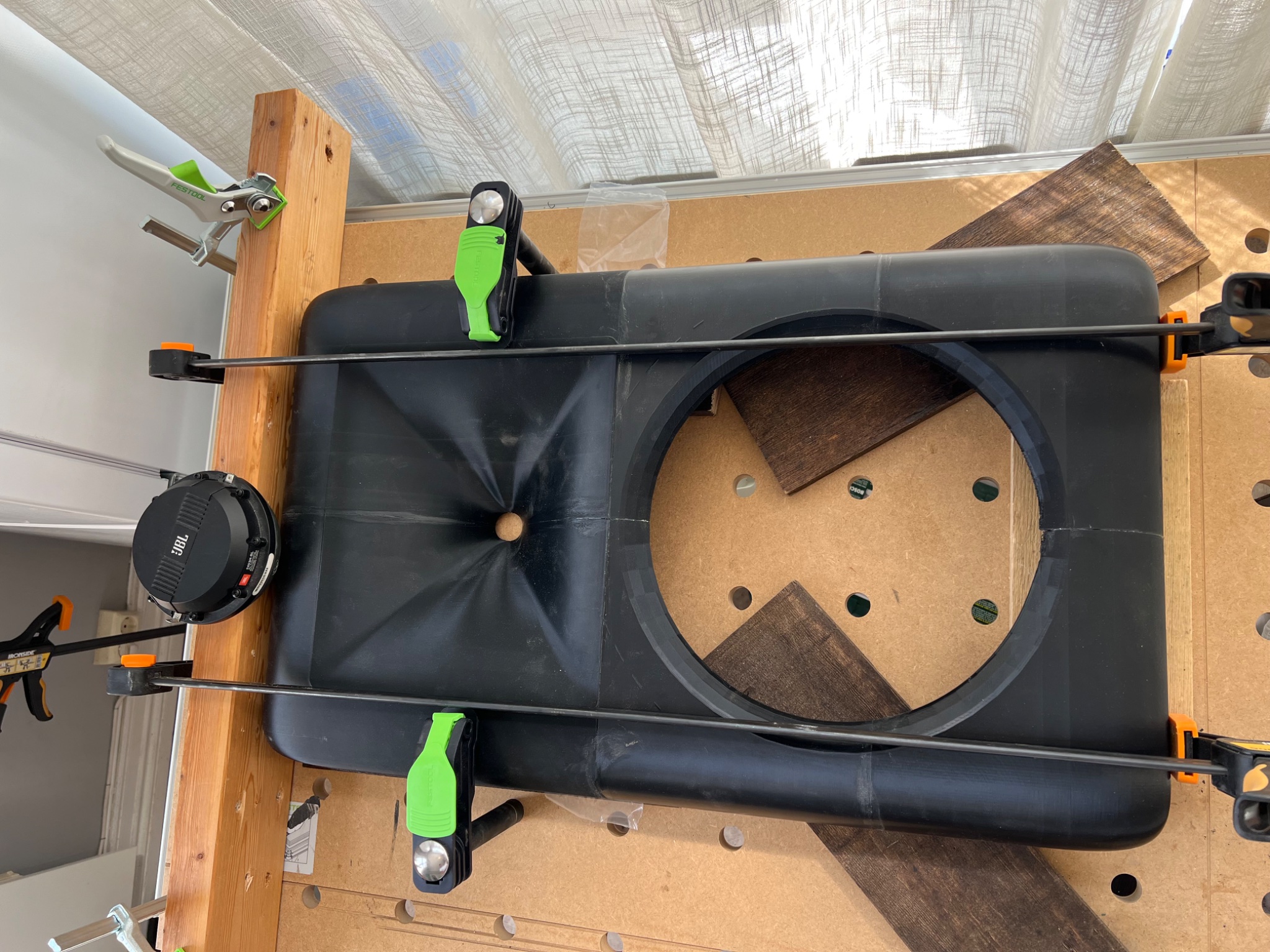

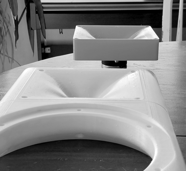

This way of integrating the waveguide do make the final product rather similar to whats out there before. Only better performance of course.
My take on a 12"+ Tritonia M turns out looking like a first gen JBL EON of sorts.
Its a rather clumsy attempt as I do not master any 3D CAD programs, I just cut and paste in the slicer program.
