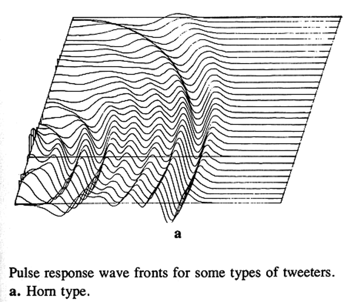

From the AES Journal, January/Februrary 1976:
Pulse response wave fronts of a compression driver + horn.
Looks pretty spherical to me.

Put a CD on a plane wave tube...Place N microphones at Xn distances. From the math you can find one mode for each microphone N...

The non flat wave-front can be analysed as the sum of a series of modes, a sort of Fourier analysis - but into spatial modes.
And, as usual in maths, as the number of unknowns increases we need more information to pin them down.
I think Earl's comment implies he assumes rotational symmetry.
IIRC some data shows the wave-front was not as symmetric as one would like, due to production imperfections in the driver and|or the plane wave tube.
Also IIRC some of that data was from Earl himself, so I am interested to read his comments.

One could use a sine wave, but that would be inefficient since we would want to know how the curvature varies with frequency. I would use a broadband signal and something like HOLM to find the transfer function for all frequencies. In a PWT, there is no need for a window, so there is no LF limit.
The transfer function is complex so yes both amplitude and phase are measured.
There is a cut-off effect for a PWT below which only evanescent wave will propagate, but these waves still contain the information necessary. To what extent one can get good resolution of the curvature from the evanescent wave will be determined by the numerics and the SNR in the measurements. This is an implementation problem, not a theoretical one. But remember that there is also a cut-off effect for the waveguide itself so the evanescent modes will not propagate in the waveguide either, making them less of an initial right off the bat.
Location of the "ideal" measurement points would need to be investigated, but I would say that, in general, one would want to be in the near field of the device, at least as it exists inside of the tube.
By rotating the driver on its mount, the first rocking mode - probable one of the most significant - could be determined. More rotations than just three, would allow for even higher non-axi modes to be determined.
The math and the calculations are not easy, but certainly doable.
