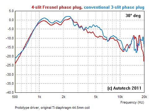

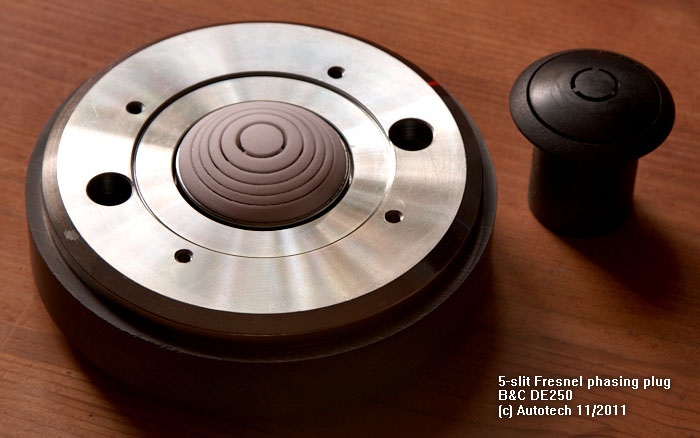

Has anyone tried to build a 3D model of an "ideal" (replacement) phase plug for an OS-type waveguide?
I've tried in 2011.
care to share more details of that saga?
Improves Chinese driver but not necessarily a good one like BC 🙂

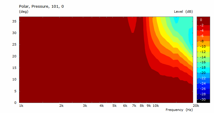

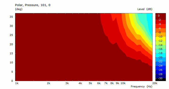

Step-tapered throat amplitude, 2" throat, 75 deg coverage (left: flat; right: four steps from the axis: 1 - 0.9 - 0.8 - 0.75):
- Acoustic Horn Design – The Easy Way (Ath4)
