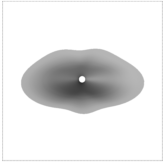

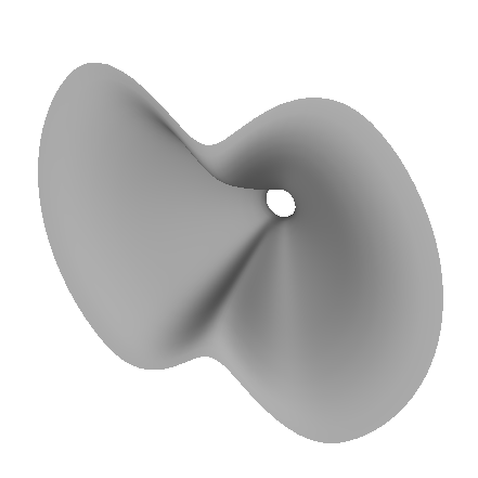

I don't know if better but certainly possible if unbaffled is the goal. There's no need for a mouth curve to lie in a plane. It is no more difficult to calculate, slighty more difficult to generate the mesh and much much more difficult to fabricate. I only wouldn't use a beaming profile as a basis.A better option is to project the ellipse on the surface of a sphere:
Indeed, a free standing was one of the goals. And you really cannot compare a waveguide like an OSWG with a "long" horn like the spherical wave horn. Beaming is relative and by far not the most important fact. This new design reduces the beaming considerably. BTW, if the flare rate of the spherical wave horn is increased the horn would open faster with less beaming but this was not the goal. We also simulated the OSWG with ABEC3 as a free-standing horn and the results were more than discouraging. The wave fronts were looking terrible and so far as I remember also JMLC showed a similar behavior in one of his presentations.
