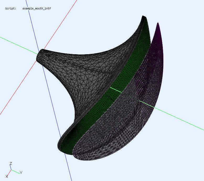

Performing BEM simulations I was not sure how to set correctly an interface splitting the BEM object into internal an external sub-domains. I set the interface as depicted by semi-transparent mesh in the picture below. Now I doubt, wouldn't it be better to choose the shape of the interface so that it would be tangent to the mouth

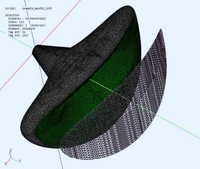

Performing BEM simulations I was not sure how to set correctly an interface splitting the BEM object into internal an external sub-domains. I set the interface as depicted by semi-transparent mesh in the picture below. Now I doubt, wouldn't it be better to choose the shape of the interface so that it would be tangent to the mouth. Interestingly, is there any rules how to split an object into internal and external sub-domains to get correct results in BEM external radiation problem ? Perhaps this is where additional error comes from ?
The 10mm inner horn mesh size is fine.
The inner/outer split should be something like this. I moved the mouth interface subdomain boundary so you can see it, but it actually sits at the horn apex even if there is rollback.
Did you change the inner horn wall impedance in any way? It is rendered green which means it hasn't a default setting (100% reflective), IIRC. Or is it green because it's in the interior subdomain? Now I'm not sure. I first saw a green boundary after I changed the wall impedance....As regards the "impedance hole", I'm not sure if this is a peculiarity of the horn or is it some kind of numerical simulation error.
I have not found much differences between different interface shapes, some may be slightly better than another in minor numerical aberations but nothing like what you show. From the manual it's also clear that it shouldn't make any difference in principle. Only avoid very sharp angles, but that holds everywhere. I don't think the interface boundary itself could be the cause here.
- Anyway, if I was to choose an interface boundary to your horn, I would make a "bubble" heading from the mouth apex outward.
I didn't change the wall impedance, it is set by default. Only the color of the walls was changed. It seems that dr. Gedddes was right, the problem was too coarse mesh (10mm). With a finer mesh (5mm) the "impedance hole" disappeared.

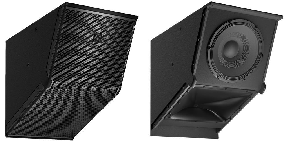

Is it a difference between this:
Tech Focus: Variable Intensity (VI) – ProSoundWeb
and straight waveguide tilted?

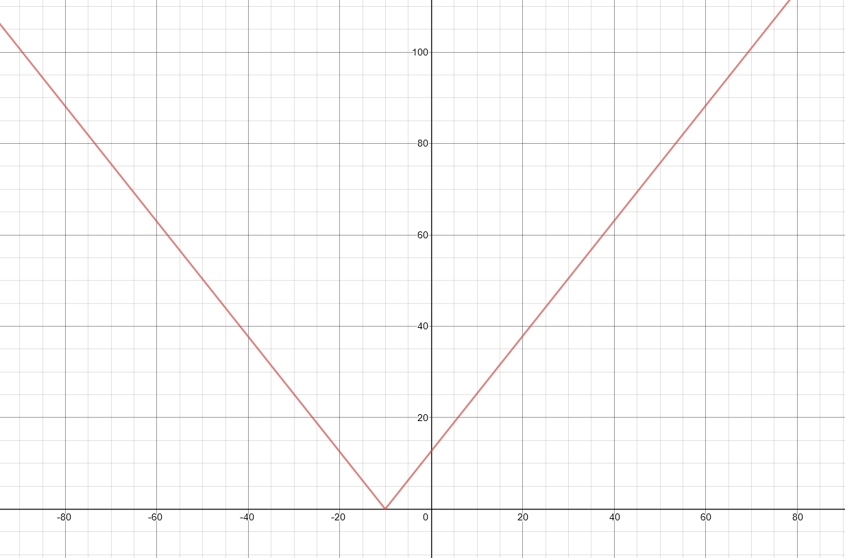

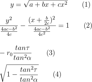

I came across my older notes so here it is:... You can try to convert my OS formula to the first form - you'll see where the center is and what the semi-axes are.
Eq (2) is a rewriting of (1) and from that follows that to take a throat angle (tau) into account, the contour must be shifted in x coordinate by (3) and its scale multiplied by (4). It is all incorporated in the "modified" OS formula.
- If one wanted to have a throat angle the same as a coverage angle, it would (surprisingly) collapse into a cone 🙂
Also note that the maths doesn't prevent you from a throat angle even bigger than the coverage - see what happens 🙂
Link to the online graphing of this example: Desmos | Graphing Calculator

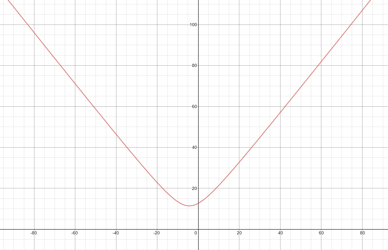

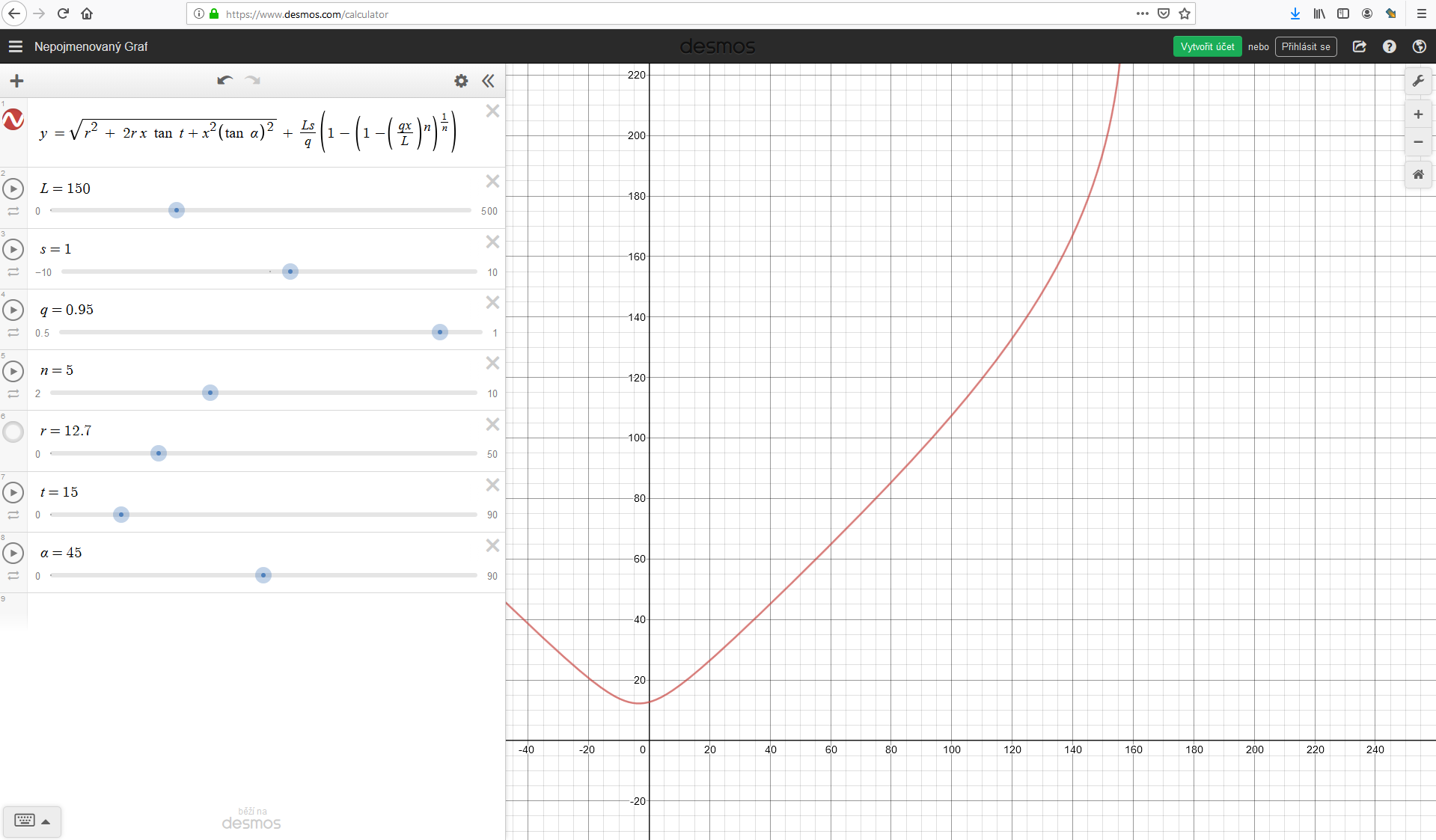

BTW, for those who would like to fiddle interactively with the last OSWG-SE formula, this is a great tool (angles in degrees): OSWG-SE / Desmos | Graphing Calculator
- Note that x is supposed to be limited to [0, L].

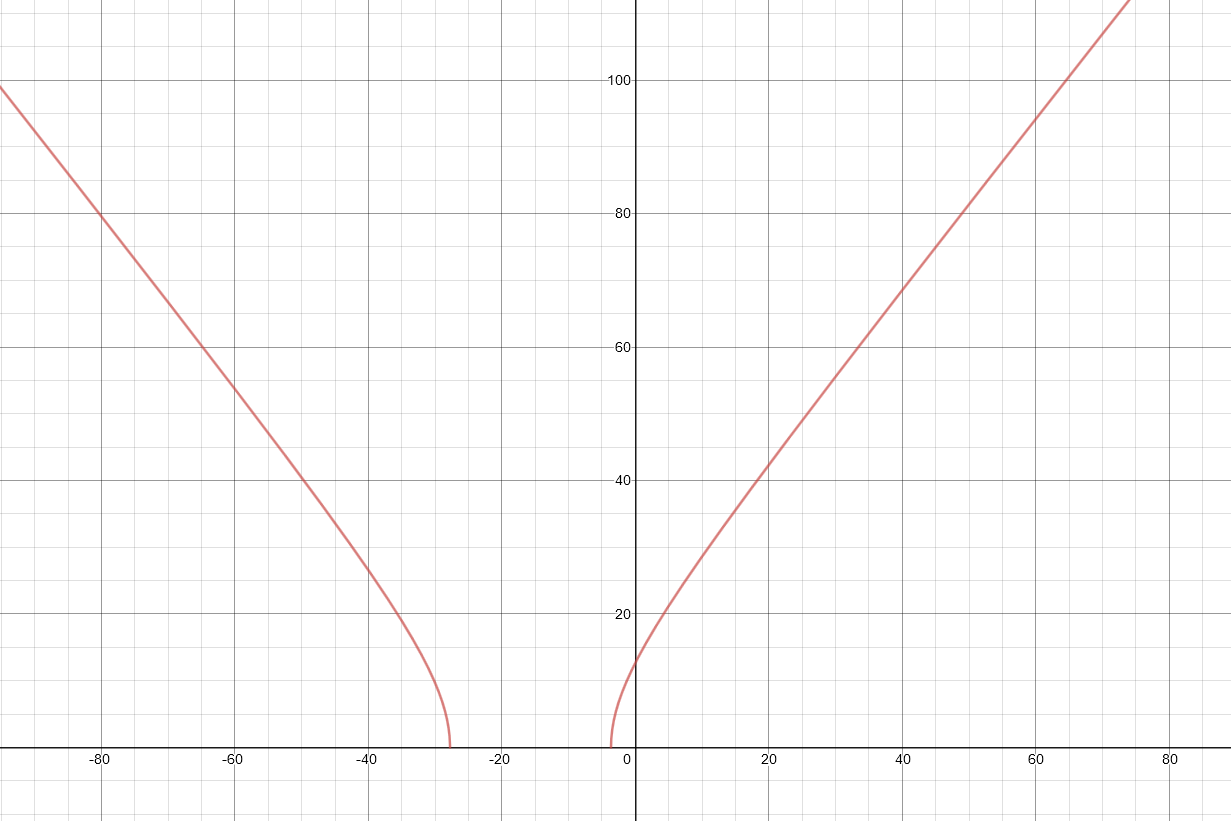

I guess it should be more like this: Desmos | Graphing Calculator
For s = 0 you have a pure OS. Increase it to add more of a termination.
- Together with a cone of the same coverage angle: Desmos | Graphing Calculator
(You can observre the effect of a different throat radius (r) on the contour.)
