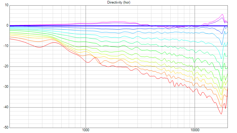

Funny thing is, I actually made something similar without knowing that they did this, even tough I used Matlab for the optimisation and not the COMSOL module, even got decent results which looked pretty similar:
Mesh of half the resulting 2" Horn
Normed Directivety Horizontal:
