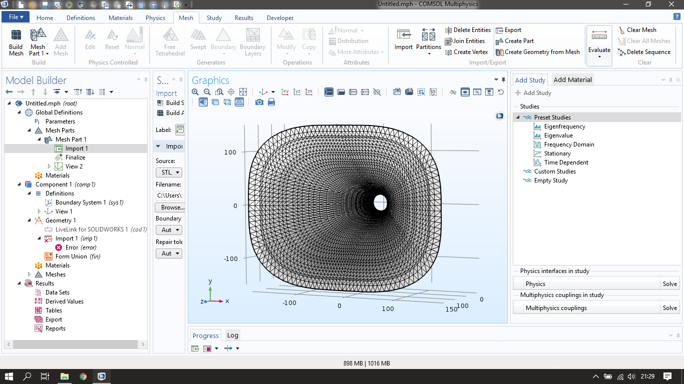

I've tried to run sims in COMSOL of a waveguide generated with mabat's STH tool, but didn't get far. You really need a deeper understanding of acoustics and electronics to know what you are doing.

The mesh quality of the current output is still rather poor. In fact, I'm in a process of a complete redesign of the tool and it will be much better - curvature controlled, not fixed. The new one will have a GUI with interactive paramatric controls and will offer some unprecedented possibilities - I'm utilizing the last waveguide formula which makes it all a piece of cake.
Alright, I am uninstallings Comsol then

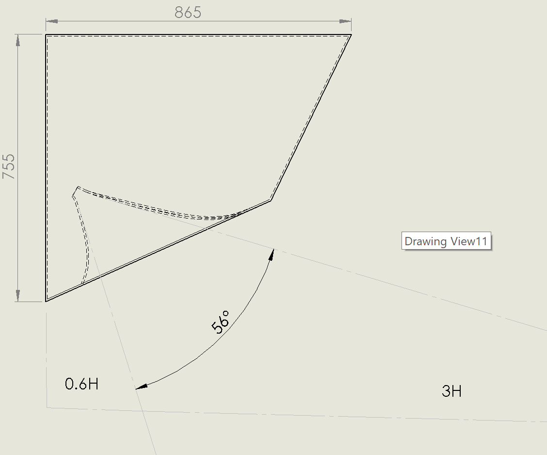

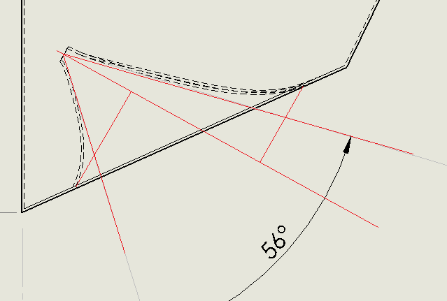

Yes, in principle this is the kind of thing you will be able to create. There are like seven design parameters to be specified and each of them can be an arbitrary function of the rotational angle (see the waveguide formula). So to achieve that you just have to find the respective functions of these parameters. In this case you would change mostly the length and coverage angle (and maybe the s and q). I could also implement this as an import from a text file in a form of a table. All of this should be possible to evaluate based on the WG formula and the shape requested, for example the 3D mouth curve coordinates.
- BTW, is this an OSWG profile? It looks like that.
Also some fancy looking unbaffled horns will be possible. Or an elliptical with a circular mouth, etc...
Neither do I.
- When I think about how to imlement this specifically, I would let the user simply to select a mouth curve, distance from a throat and an inclination of the mouth plane. Could be this easy without the need of calculating it all externally. This could be one of the ways how to set the input parameters.
