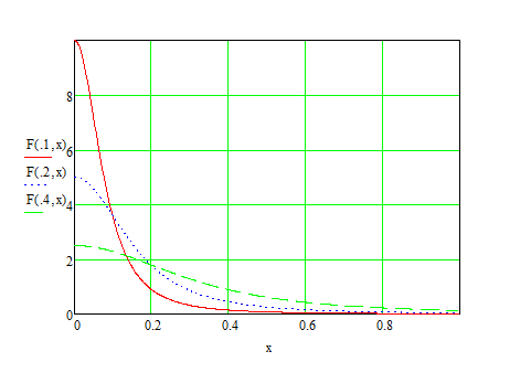

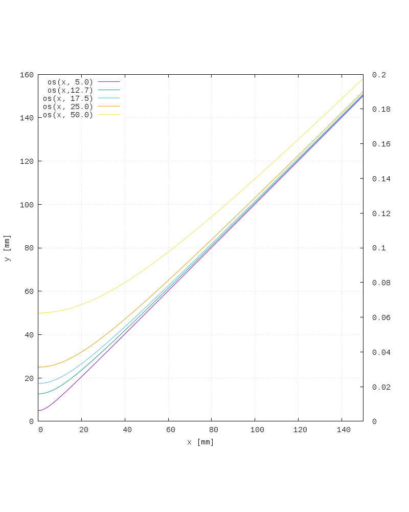

I'm sorry, this is how it is. The larger the throat radius, the smaller the curvature at the throat. Try it if you don't believe me.
I'm saying then that what you have must be wrong.
Look at the equation for an OS waveguide
y(x) = (r0^2 + (tan(theta) * x )^2)^1/2
This equation has the exact same 2nd derivative for any value of r0.

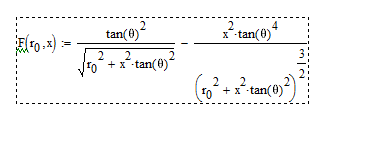

My mistake - I forgot about the square root. MathCad gives the 2nd derivative as shown below. The values at x=0 go lower, but the values above some point go higher.
d2/dx2 = (tan(b)^2*r_0^2)/(tan(b)^2*x^2+r_0^2)^(3/2)
Yes, when simplified that is the same thing that MathCad gives. (Sometimes its algebra processor does not return the simplest form.)
That's right. So what is more advantageous from a HOM viewpoint?
That's a good question.
What I do know is that as the throat gets larger the HOMs cut-in frequencies get lower. Which has the higher values I don't know, but generally lower cut-in is not what one wants. In a 1" OS the first cut-in is at about 6 kHz. For a 2" it is about 3 kHz. I'd prefer the 6 kHz as that is nearly out of band.
BTW, what I add to the "pure" OS equation cited everywhere is a term that is taking the throat angle into account. It only shifts and scales the hyperbola accordingly (a little bit), so there is the desired angle for x=0. But it's still a "pure OS" contour, exactly, i.e. a hyperbola.
I saw that, but I don't think that is correct. That term basically rotates the whole thing, which is not the same as starting the OS at a given angle. For an initial angle of 0, as you show, it's fine, but I would question its correctness for larger angles.

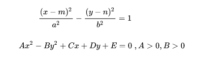

This is the general equation of a hyperbola (two forms of the same). The point [m, n] is the center, etc. You can try to convert my OS formula to the first form - you'll see where the center is and what the semi-axes are.
I agree with you now.
Curious? Do you know how one would rotate the hyperbola around its origin?
Update: I see now. The X and Y would need sine and cosine values for the rotation angle.

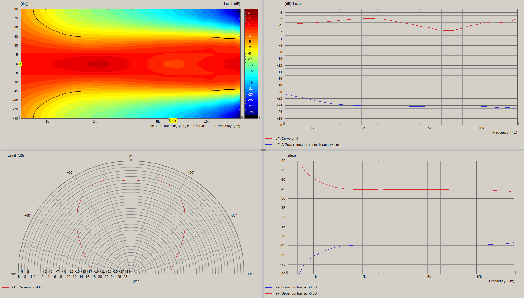

I still wonder how to detect HOMs in these BEM simulations. Like the last question of the throat size, it would be interesting to see the influence. Is there any chance to trace higher order modes in this kind of numerical approach? I can imagine terminating the simulated waveguide with an absorptive boundary/cap so no mouth reflection or diffraction comes into play. Wouldn't the HOMs manifest as a non-spherical wavefront somewhere down the device?
I'd say that would be exactly correct. Any spherical shape can be expanded into modes and these is well know. So you just take the velocities on the surface of the sphere and find its modal representation. Those are the HOMs. The expansion must use spherical harmonics.

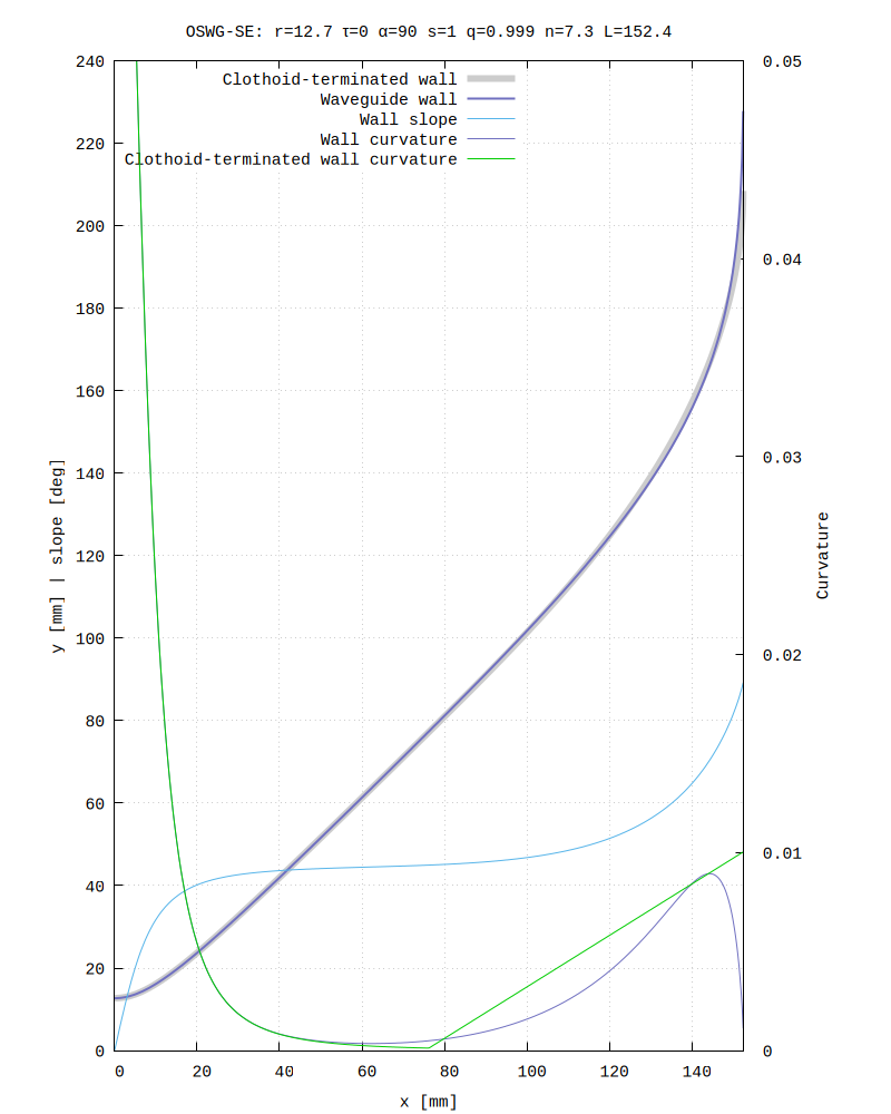

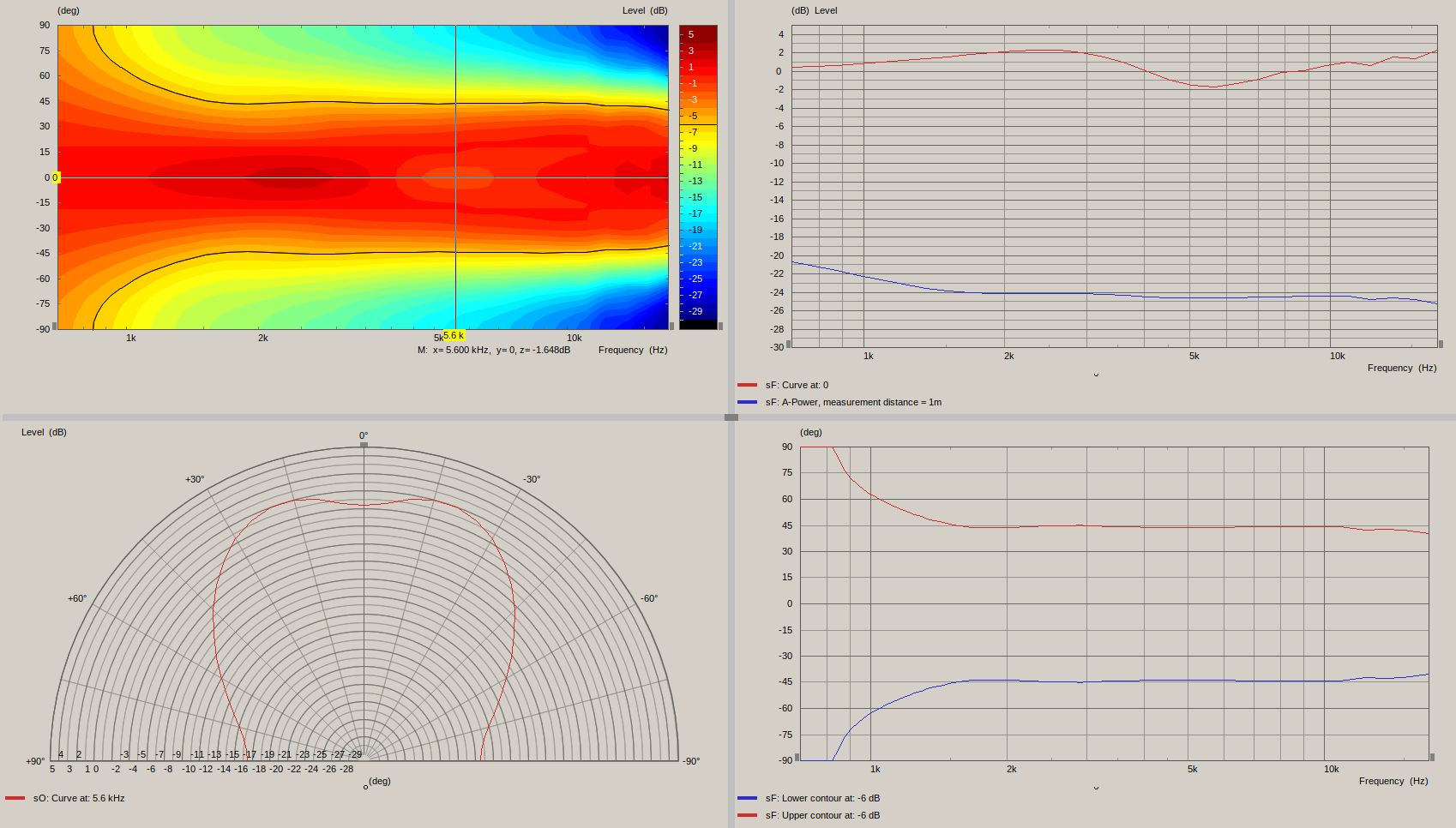

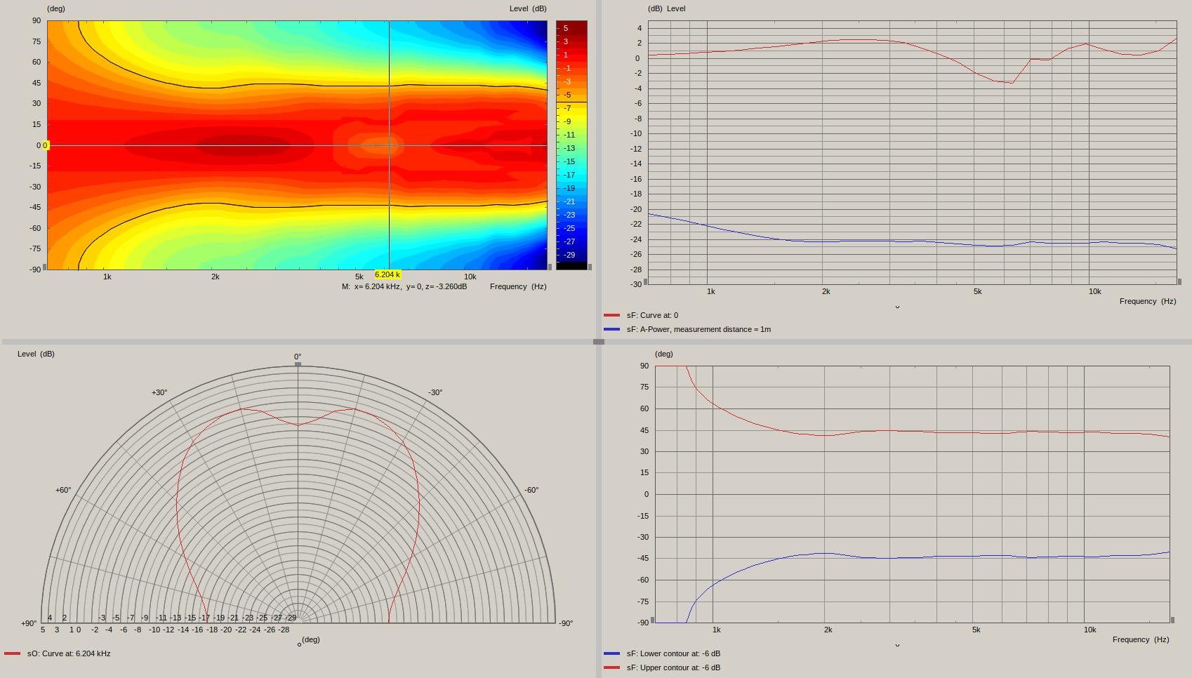

Some more simulation results, if anyone is interested. This time, the waveguides are a bit deeper with about the same mouth size as my last post (p. 28, #277). The overall result is as you might expect: directivity is held constant to a lower frequency, but there is more axial ripple. First is Marcel's superellipse-based equation with L=152.4; s=1; q=0.999; n=7.3. Next is a slope and curvature matched clothoid termination starting at 50% of the total depth. Last is a circular arc termination with a radius of 129mm (~5in). The clothoid termination looks the best to me in this case.
