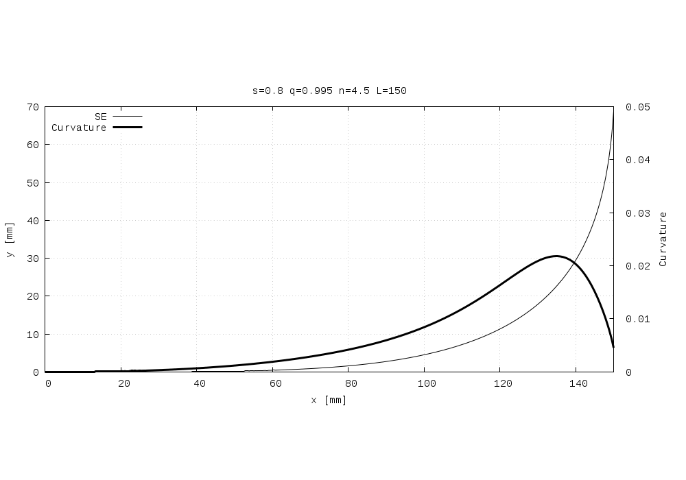

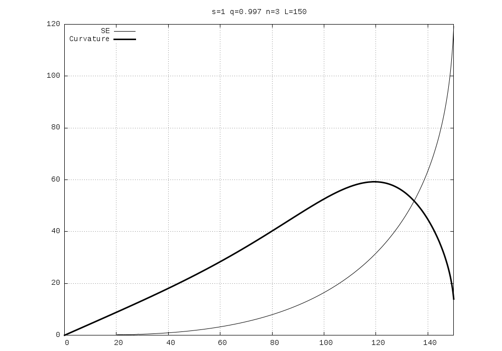

Here is the termination term SE(x) alone (i.e. from OS(x) + SE(x)) with its curvature. It's interesting.
The curvature rises very gently, then for a while it rises almost linearly (i.e. approximates a clothoid), then after reaching the maximum it decreases again. So it is more like two clothoids smootly connected one to another. It makes sense after all, as long as the baffle is flat. It makes a very nice transition from a throat all the way to the baffle.

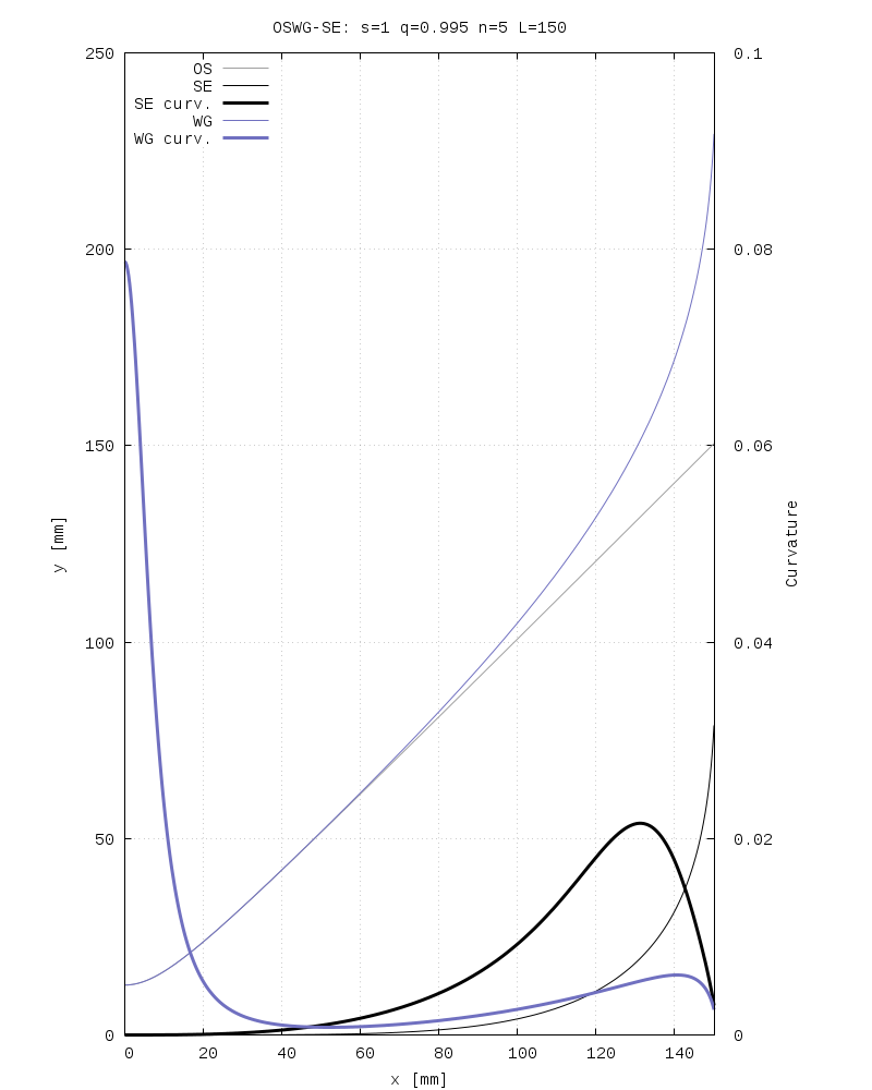

Here's the math -
Code:
set term pngcairo size 1000,700 font "Courier New,11"
set output "se_curvature.png"
q = 0.995
s = 0.8
n = 4.5
L = 150
set grid
set size ratio -1
set key top left
set samples 600
set xlabel "x [mm]"
set ylabel "y [mm]"
set xrange [0:L]
set y2range [0:0.05]
set ytics nomirror
set y2tics
set y2label "Curvature"
set title sprintf("s=%g q=%g n=%g L=%g", s, q, n, L)
se(x) = L*s/q * (1.0 - (1.0 - (q*x/L)**n)**(1/n))
fd(x) = L**(1-n) * q**(n-1) * s * x**(n-1) * (1.0 - (q*x/L)**n)**(1/n-1)
sd(x) = (L**(n+1) * (n-1) * q**(n-1) * s * x**(n-2) * (1 - (q*x/L)**n)**(1/n)) / ((q*x)**n - L**n)**2
curv(x) = sd(x) / (1.0 + fd(x)**2)**1.5
plot se(x) axes x1y1 lc rgb "black" t "SE", curv(x) axes x1y2 lw 3 lc rgb "black" t "Curvature"
I stand on the shoulders of giants 🙂
This is all the math involved for those interested to pursue it any further (a gnuplot script producing the above picture):

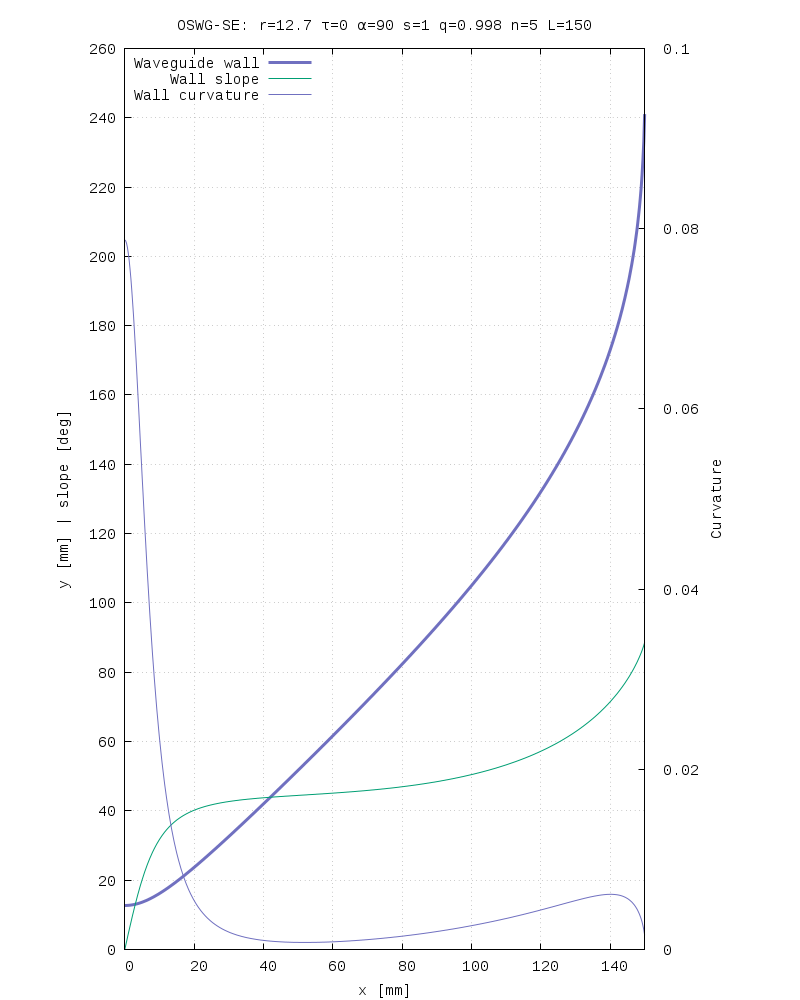

Waveguide wall contour, slope and curvature -

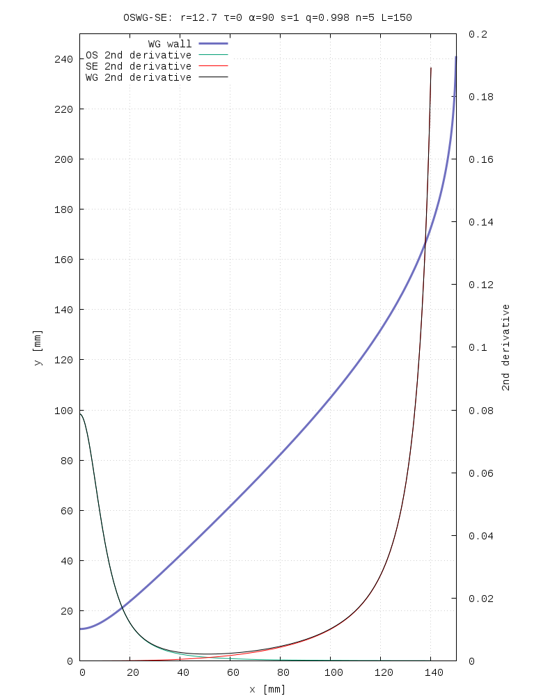

That's nice. Would be interesting to see how the two wall profiles differ from y=x.
I see this as a minor difference and as you have shown, the acoustic output is almost indistinguishable. What's quite different is the convenience of use. It's really not that easy to work with the clothoids although some claim so 😉
I wonder if there could be differences in sound quality that are not obvious in the simulations (higher order modes?). Dr. Geddes has said that the OS contour is optimal because it has the lowest 2nd derivative:
What one wants to do is to minimize the 2nd derivative - constant would be less than optimal. It can be shown that the OS contour does precisely this, it is a catenoid between the input angle and the output angle. No other function can have a lower 2nd derivative. Now the mouth treatment is another issue and where all the tradeoffs come in.
Now, of all the surfaces that can connect a circular plane wave to a sperical wavefront, the OS can be proven to genetate the least HOM of any other contour, because it is a catenoid and has a minimum 2nd derivative for a given entry angle.
It seems to me, looking at the graphs, that your new equation has a lower 2nd derivative than the OS+clothoid shape. Perhaps that means that the superellipse-based termination is theoretically superior, even though the simulation results are almost identical (I've done some more sims... the two profiles don't appear to differ by more than a few tenths of a dB out to at least 60°). Thoughts?
I've never really understood this 2nd derivative thing. As a function it will be smoother by itself (I don't know whether "lower" - lower where?), that "feels" better, but to what degree it has any impact, I have no clue.

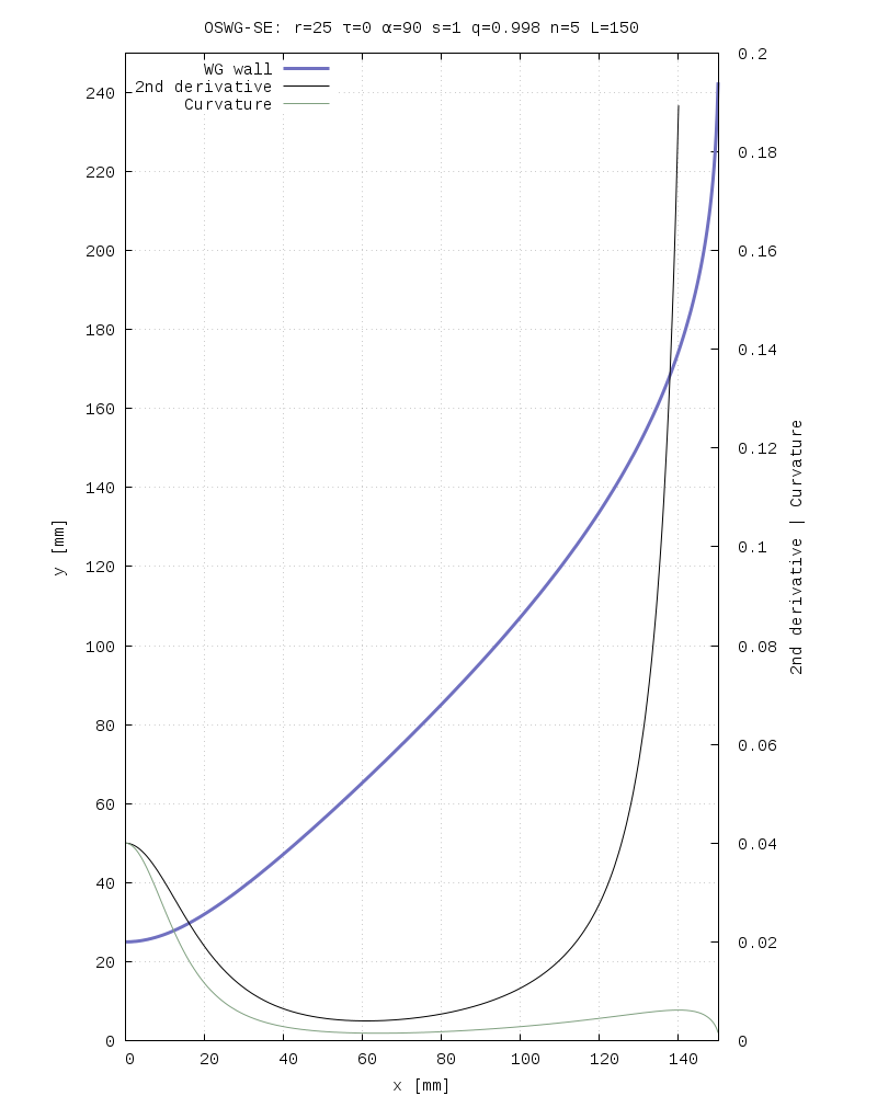

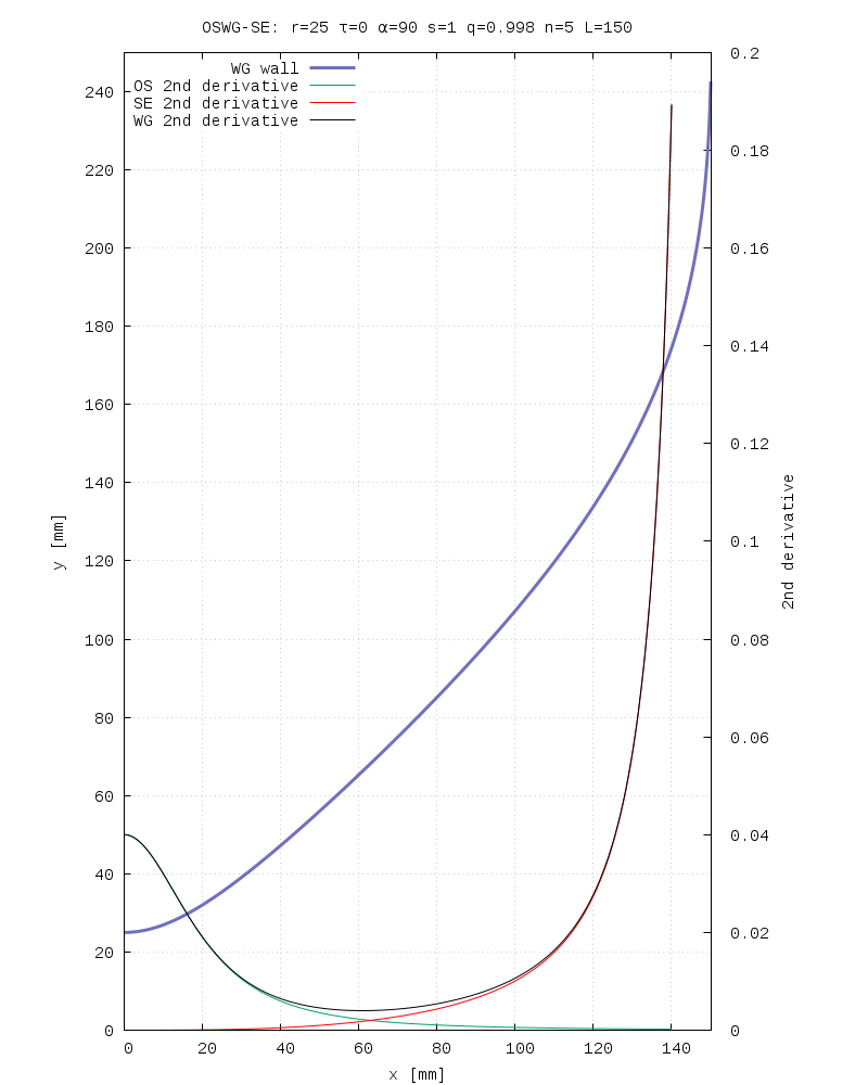

Waveguide with a 2" throat will have lower 2nd derivative near the throat - does it make less HOM because of this?
