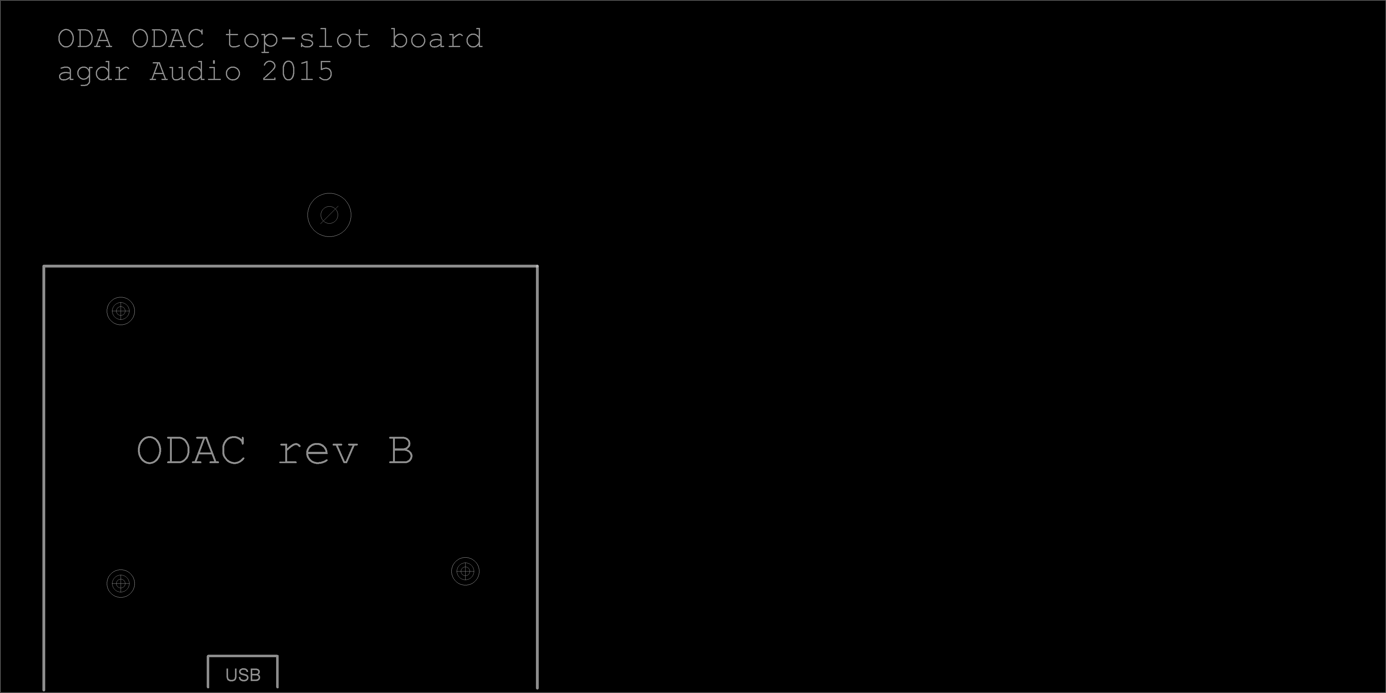

A top-slot carrier board for the ODAC rev B

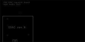

I had planned on making a top-slot board for the ODA where the ODAC could be mounted from the start of this project. But I had read enough posts over the years where people were having very occasional random problems with the ODAC board that I hadn't been willing to make the board unless a galvanic isolator for the ODAC was included. Designing a galvanic isolator was more than I've wanted to get into.
But now that George has released the new version B of his ODAC
http://www.diyaudio.com/forums/head...headphone-amp-diy-project-87.html#post4325434
and the pesky problem has been tracked down - the occasional PC USB port with ceramic capacitors on it that resulted in the ESR being too low, causing the ODAC's LDO to oscillate - I'm going to go ahead and make the top slot carrier board. 🙂 No galvanic isolator needed. The ODAC board is powered from the PC's USB bus of course. It doesn't hook into the ODA's power supply.

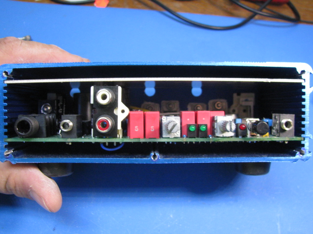

There is not much to see here, below. Just a blank PC board that slides in the top slot of the ODA, with the three 3 mm mouting holes for the ODAC. I've specified a 5mm hole to allow the twisted pair audio wires to pass from the ODAC to the ODA. The ODAC audio wires can go to the PCB holes by either the 3.5mm jack or the rear panel RCA jack. Best to wire the ODAC into whichever jack you use the least.
Please post if anyone has thoughts about changes or additions to the board. With this design the USB port will be in back of the unit. The vent holes that are on the most recent set of rear panel FPE CAD files at the google link all sit below the level of the top slot board, allowing the output chips' heat to still escape by convection without heating up the ODAC board.

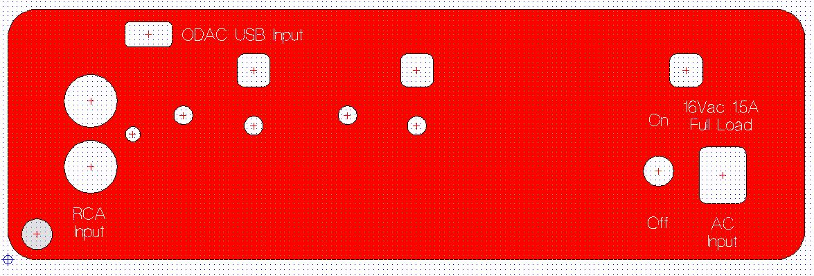

I'll add a cutout to the rear panel CAD file for the USB connector. The connector is a tiny mini USB so a hole can simply be drilled for it on exsiting rear panels. I'll post the X,Y locations of the hole. I'm going to have this board fabricated, but since it doesn't contain any traces it could easily be made at home from a blank 80x160 single-side copper clad board with the 3 mounting holes drilled by hand. The side under the ODAC has to be copper-free since the ODAC will mount flat down on top of it. If the fabricated board checks out when I get it back from fab I'll post all the mounting hole locations. An easier way than measuring is just place the ODAC where you want it and mark or scribe the 3 holes through the ODAC mounting holes, then drill.

Allendaze,
Good job! Have u powered it up and done any critical listening yet? I have an ODA and have been using out for many months daily.
I hope you enjoy yours as much as I do mine!
All the best
Alex

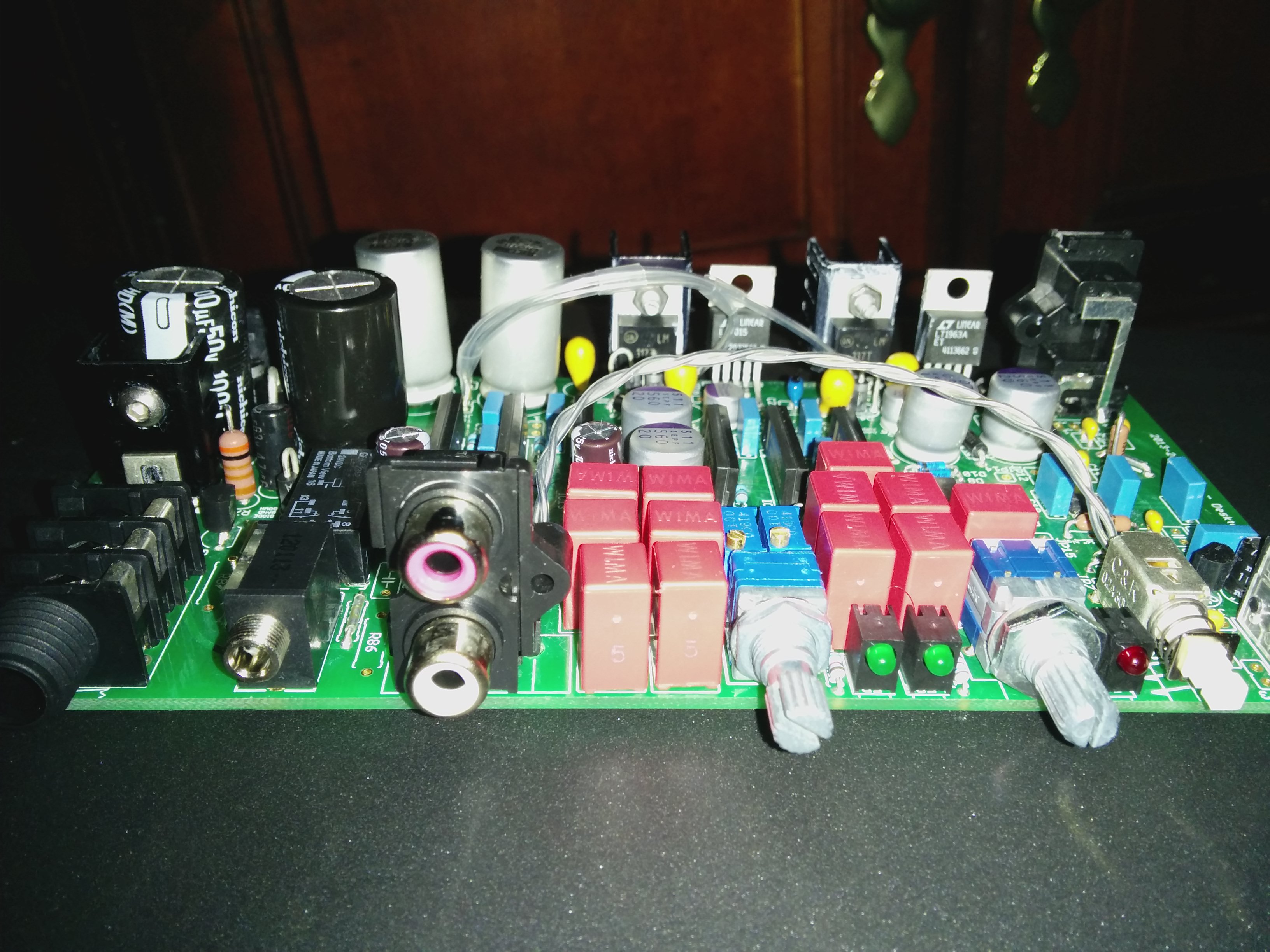

So after a bit of troubleshooting, desoldering, resoldering and swapping components that were in the wrong place I put A/C jack to the AMP and switched it on to measure the voltages... They came out to what I expected... so I soldered in a jumper wire to power the rest of the board and all the lights came on!!
My first impressions...
WOW
I have not been able to listen to headphones in a few weeks due to my last amp biting the dust and so building agdr's ODA has been a very exciting project for me. I was able to find some old headphones I've long replaced for the AKG's and plugged them in for a test run. To my absolute surprise the low-end headphones SOUND AMAZING!!! My ears are in music euphoria just listening to the first thing I sampled. (Thirty seconds to Mars - City of Angels)
I'm still letting it warm up and break in but will fill you guys in with what I think in due time.

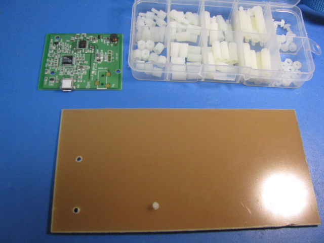

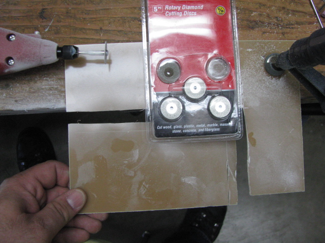

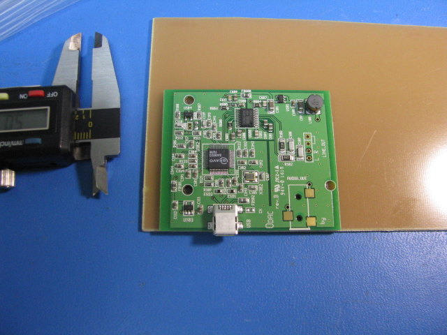

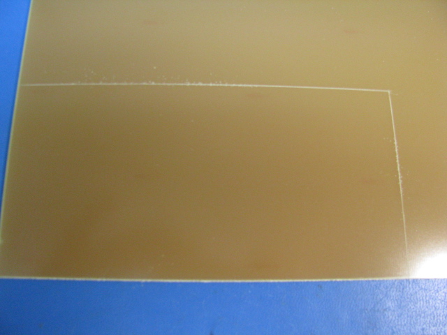

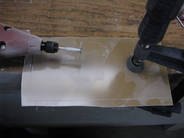

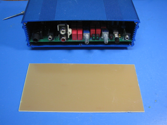

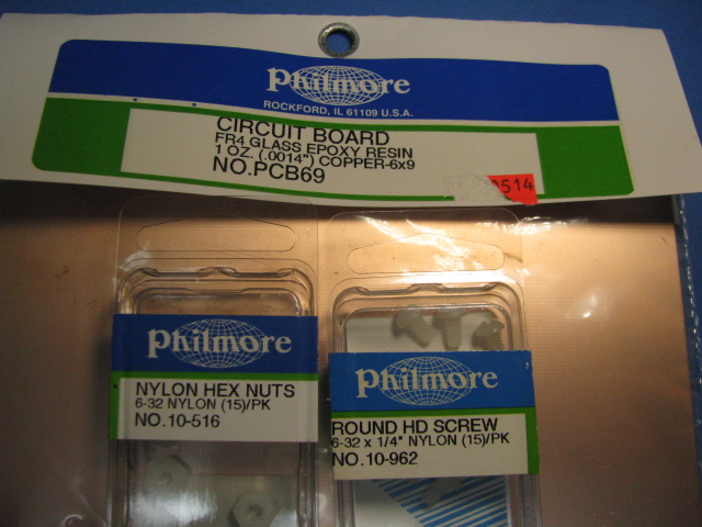

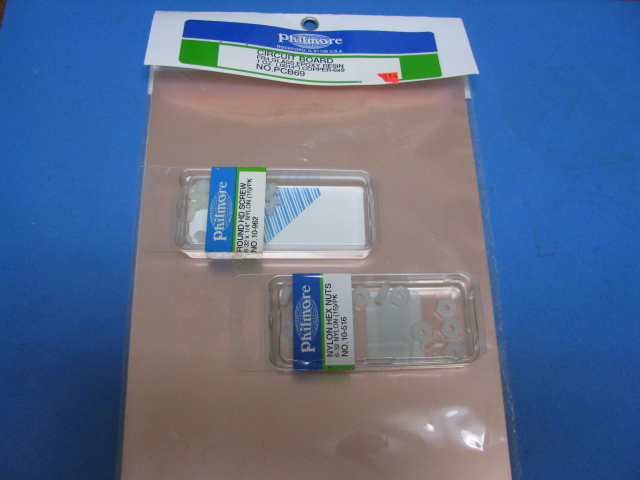

DIY step-by-step photo build for a top slot ODAC board, part 1

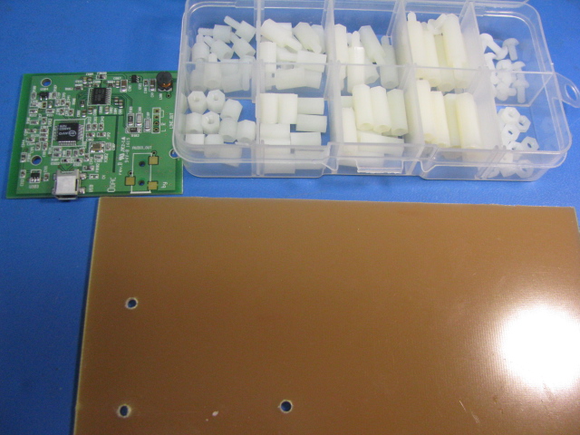

I've finally had a chance to do a photo-build of the ODA top-slot carrier board for George's new ODAC rev B. 🙂 Here are the details.
In the photos below...
* The first two photos show the locally-sourced single sided copper clad board. Don't use double sided copper clad - any copper layer under the ODAC can short it out since it will mount down flat on the carrier board. The part under the ODAC is just the board with no copper. Don't buy the nylon bolts in the picture. I knew the holes in the ODAC were 3 mm dimeter. I couldn't remember when I bought this stuff if I had 3 mm nylon hardware (I did) and couldn't remember if 6-32 english is bigger or smaller than 3mm (it is bigger). So long story short - use 3 mm nylon bolts and nuts. 6-32 won't fit.
* The next two photos show using a bare ODA board to trace the 80x160 outline onto the clad board, using a sharp awl to trace around the ODA board. You can just draw a 80x160 rectagle directly, by meaurements.
* The next three photos show cutting the board with a diamond cutting wheel on rotary hobby tool. The wheel and tool are from Harbor Freight here in the US - cheap, $5 for the cutting disks and $20 for the tool kit on sale. Note! Be sure to wear a dust respirator mask and safety glasses while doing the cutting. The board is fiberglass and epoxy resin, not the kind of dust you want to get in your lungs. The photos show that I first did a rough cut 1/4" or so past the scored outline, since the hobby tool shaft is only an inch long or so and can't reach all the way across the board. I re-clamped the board after the rough cut and was able to get the hobby tool in there closely for the final cut.
* The next two photos show the result. A perfect fit! 😀

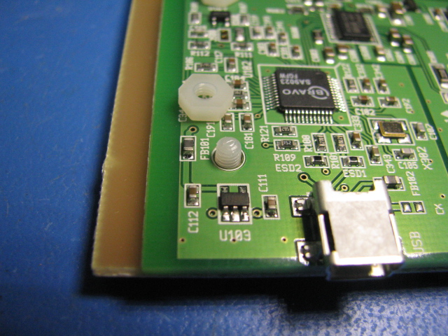

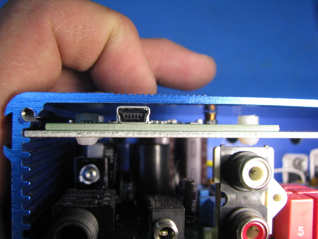

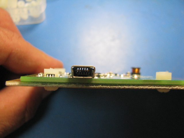

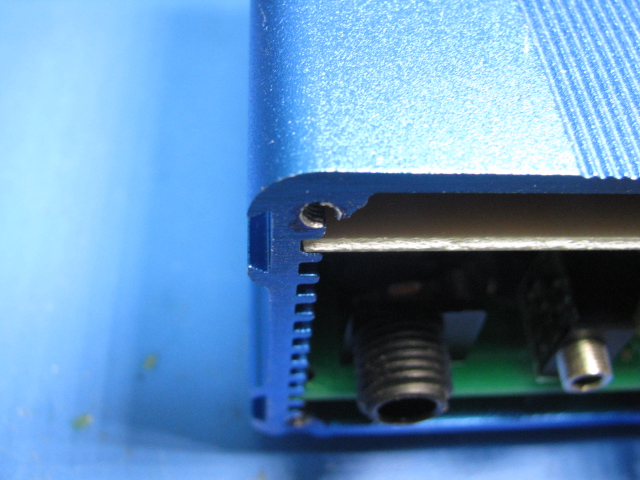

DIY step-by-step photo build for a top slot ODAC board, part 2

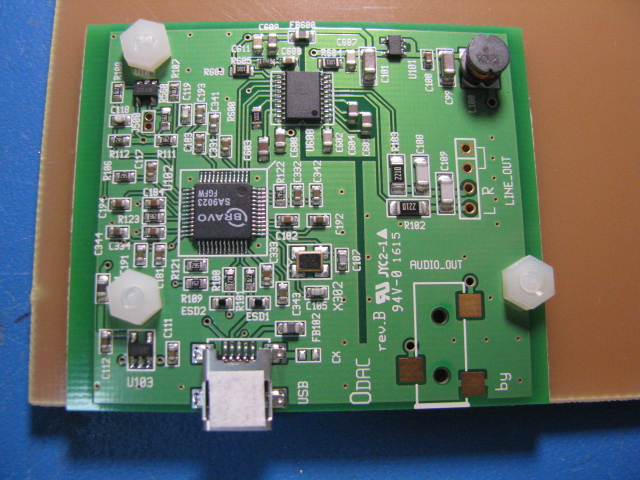

* The first two photos show placing the left edge of the ODAC rev B board exactly 5.0 mm from the left edge of the carrier board. Then scribe marks are made through the 3 ODAC monting holes. Finally the 3 holes are drilled. I first used a small 1 mm bit to help exactly center the holes in the middle of the scribed hole. Then I followed with the final 3 mm drill bit.
* The next four photos show using the 3 mm nylon bolts up from the bottom (the copper clad side) of the carrier board, through the ODAC board mounting holes, then securing with a 3 mm nylon nut. The final photo of the four shows that the resulting height of the nut and bolt extension is just perfect. Doesn't exceed the height of the USB jack on the ODAC board. The 3 mm nylon nut and bolt kit I'm using here is a common thing on eBay from many different vendors.

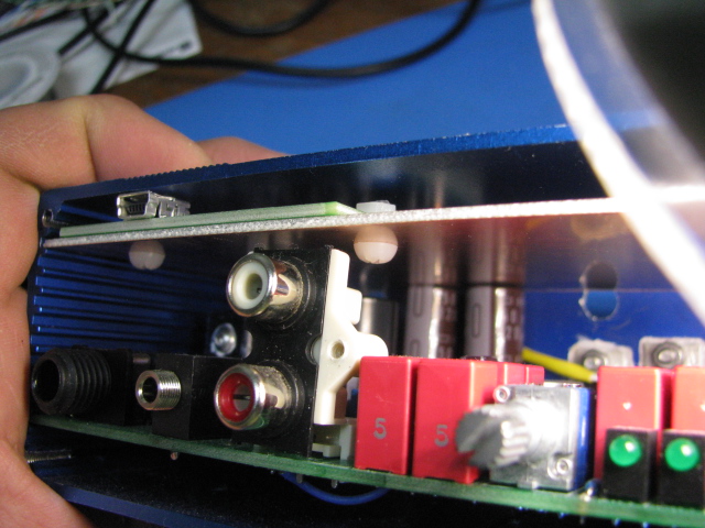

* The next 3 photos show the clearance of the tallest things on the ODAC board, the USB jack and a coil in the background, vs. the top of the ODA case. There is about 1 mm clearance, even if the top slot board is at the top of the slot. Note that I'm showing the front of the ODA here, but the ODAC and carrier board will actually turn around the other way and mount in the back
* The final photo is an image of the rear panel with the ODAC's USB jack hole added. The three existing vent holes have been moved down about 1 mm to stay fully under the top slot board. I'm sending one of these panels out to Front Panel Express on Monday. Once I confirm the hole is in the right spot I'll post the FPE CAD file for the rear panel with the USB jack hole out on the project's Google Drive link.
If you have an existing ODA rear panel and want to add the USB hole by hand drilling, here are some tips. The hole is 5.35 mm (0.21 inch) tall and 10 mm (0.39 inch) wide. Using two 3/16" drill holes side by side will get you pretty close. The remainder can be taken out with a nibbling tool or a file. The center of the USB hole as I have it right now (still needs to be confirmed by this panel I'm sending out) is 5.325 mm down from the top of the rear panel top, and 29.95 mm from the left panel edge.

I forgot to post that those 3mm diameter nylon bolts are 6mm long, which is the length of the threaded portion.

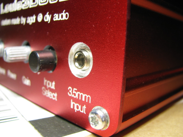

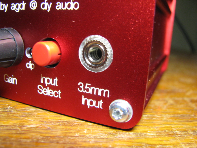

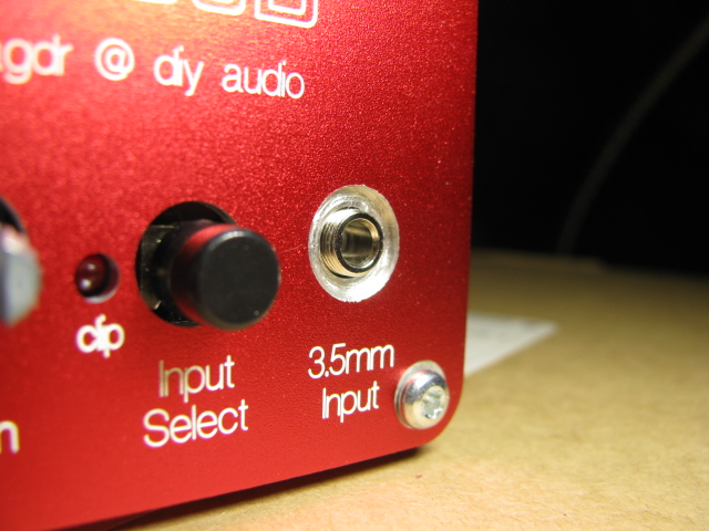

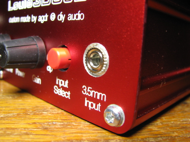

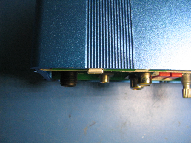

FRONT PANEL INPUT JACK THREADS
In other ODA news I've had a couple of people building ODAs PM me over the last few months about the input 3.5mm jack threads not extending far enough through the front panel. On this most recent build I took some photos of the jack threads, below. The first two show the amount of thread extension through the front panel, about 3 threads as I intended by design, and then the second two photos the result with the nut screwed on. I haven't done anything special here, just built it up and this is the result.
I've been a little puzzled why folks haven't had their threads extend enough through the hole, since everytime I've built one it worked just fine, as in these photos. A possbile reason finally hit me though with this last build. You have to have both your front and back panels fully screwed onto the case first, before trying to put on the front panel input jack nut. The tolerances involved are fairly small, just three threads, and I noticed that until I actually screwed both panels down the threads didn't extend through the front panel hole enough. the spacing around that 3.5mm jack nut is also fairly small.
I use my Xcellite 378M pliers that have fine nose tip to secure that nut.
Lol - in reviewing these pictures just now here is another useful thing here. Note the button color changed between pictures. 🙂 Turns out that in addition to black (PVBK) they also make a red button, "PVRD", a white button "PVWH", and a grey button "PVGY". No blue though. 🙁 Mouser only has black and red, but digikey has all the colors.
