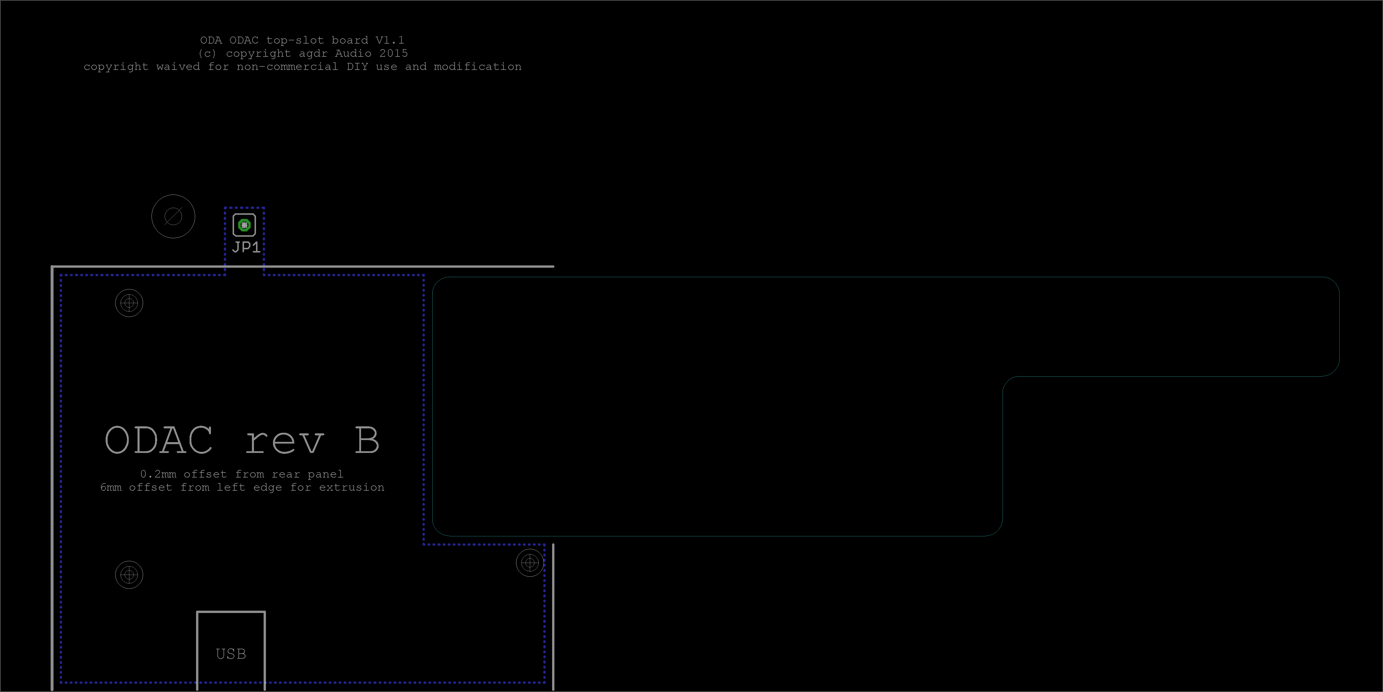

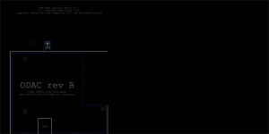

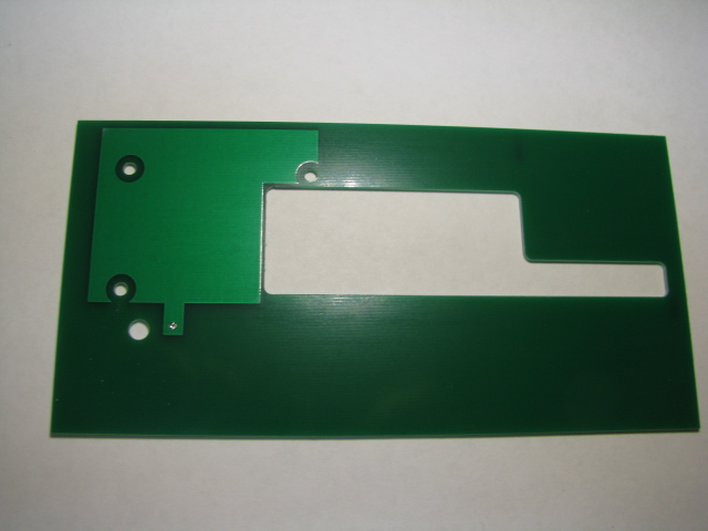

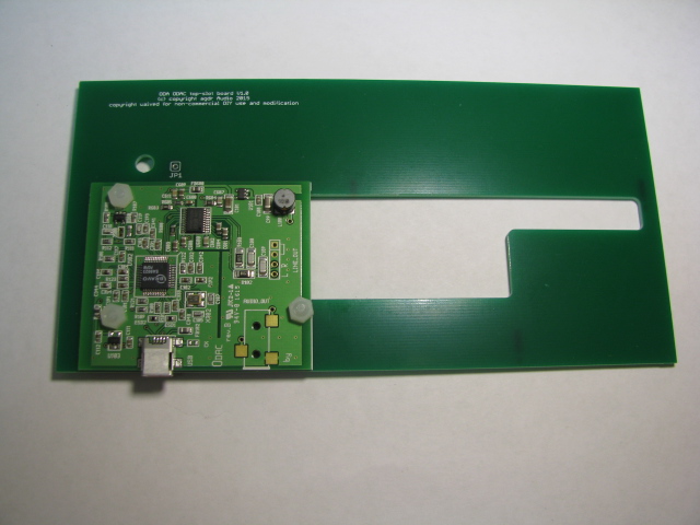

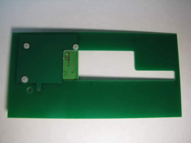

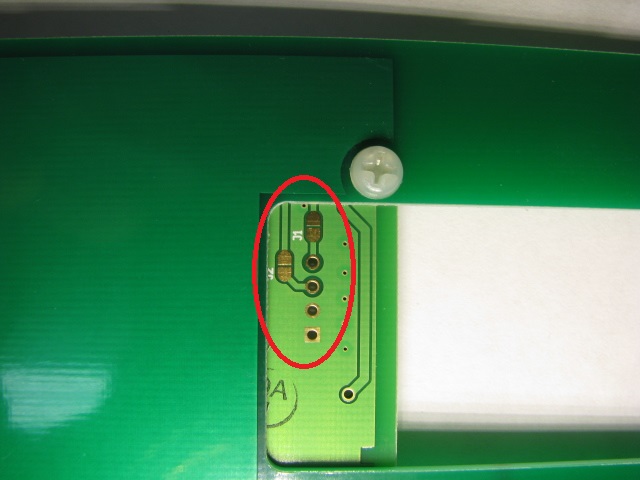

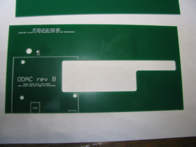

New ODA top-slot ODAC carrier board! And using pre-amp to re-buffer.
I finally got around to designing the top slot carrier board for the ODAC and matching back panel. 🙂
The board has a hole milled out of the center to allow heat from the output chips to make it to the top of the case and out a new row of vents in the (new) back panel.
The board layout, schematic (most complicated schematic you will run into here on the forum, lol!), and Gerber files for making your own boards are attached below. I've also added a new folder at the Google Drive link in the first post of this thread for "ODA top slot ODAC board", which has these same files in it.
The ODAC (either original or George's new rev B) is attached using three 3mm nylon bolts and nuts, as shown in the photos below. The ODAC board bolts down right on top of the carrier board. I've confirmed with George that is OK.
Note that the milled out section also solves one issue, as shown in the photo, that the 4 output wires go through the ODAC board and stick out the back. The carrier board would have required a hole there anyway. I just extended the milled-out section even though the ODAC board covers it.
The boards I've received today in the photos below are V1.0. I've just created a V1.1, which is what is in the layout and Gerbers below and at the Google drive link. The only change in V1.1 is that I extended the top of the milled-out section 2mm higher so it is flush with the top of the ODAC board, just for looks. 🙂 No functional difference.
I've included a ground plane on the bottom of the board under the ODAC area and included a solder hole to connect it to something. No need to connect it though, I just put that in for completeness. I've confirmed with George that having a metal plane 1.6mm under the ODAC like that won't affect anything on the ODAC.
The new rear panel has the hole for the ODAC USB port. I also left a round hole in case someone wants to solder on the ODAC's optional 3.5mm jack (requires jumpering the two sets of pads under the ODA). I wouldn't recommend using the ODAC's 3.5mm jack though - read the section below on rebuffering. It is a better way to go if you want your ODAC to also power RCA cables going to other equipment.
The new rear panels should be here in about a week. Once I verify the USB hole lines up properly with the ODAC USB connector I'll post that panel CAD out on the Google Drive link.
I've also had a chat with George about rebuffering, if someone wants to do that. NwAvGuy and George designed the ODAC to power the 10K load of the O2. Hooking other loads in parallel will increase the loading ont he ODAC an can potentially cause the ODAC distortion to increase, depending on the size of the load. George confirmed that the NJM455A, the surface mount version of the output chips in the O2 and ODA, would be a suitable chip for rebuffering if you want your ODAC to power long and/or higher capacitance RCA cables along with feeding an input on the ODA.
Well as luck would have it you can do that with the pre-amp buffer circuit and pre-amp outs on the ODA, if you are not already using them! 😀 So along with running your output wires from the ODAC to an input (rear RCA or front 3.5mm, holes by either) also run it to the input of the pre-amp chip (top and bottom pins of JP20). Then solder in a NJM4556A there and set the resistors to make it a unity gain buffer. The net result is the ODAC feeding one input of your ODA and also powering the pre-amp outs via the buffer chip. You will have no worries about how much capacitance your RCA cables have or their length with the output buffered like this.
Please note though that the pre-amp out does not go through a relay like the headphone amp out does, and the NJM4556A has that 3mV or so of DC output offset, so you might hear a small turn-on and turn-off thump in your speakers that you don't in your headphones. Another way to go is use a OPA2140 with 20 ohms of isolation resistance in series, using those pads (R57, R62) on the ODA board. Line level inputs at the other end of your RCA cables shouldn't care about 20 ohms. The OPA2140 has nearly zero DC output offset.
In the photos:
* 3452 and 3453 are the front and back of the board.
* 3454 is with the ODAC rev B bolted on with the nylon bolts
* 3455 shows the milled-out area where the output wires come through the ODAC board. Also the two jumper pads if you are using the ODAC's 3.5mm jack (again, not recommended).
* 3456 shows the whole backside of the board with the ODAC bolted on.
The Gerber files to fabricate a board are in the attached .zip file. The README file has the parameters you will need.
