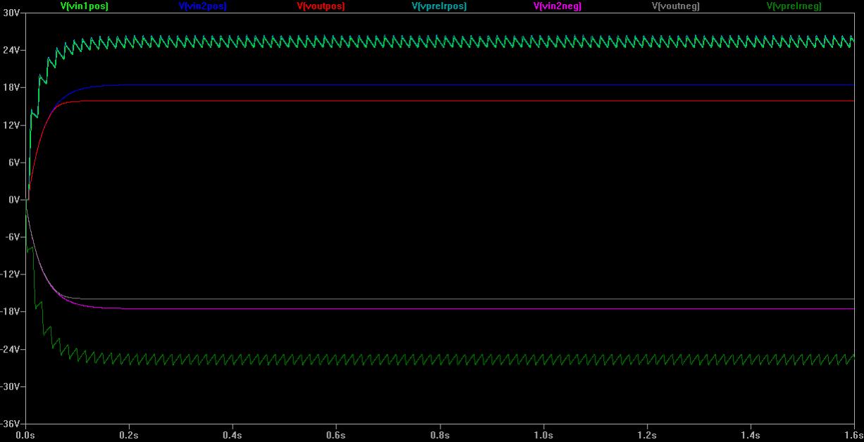

NwAvGuy/RocketScientist never did get around to publishing his O2 Desktop Amplifier (ODA) before he disappeared last year. For fun I've taken a few guesses on what might be in an ODA and whipped one up. :D

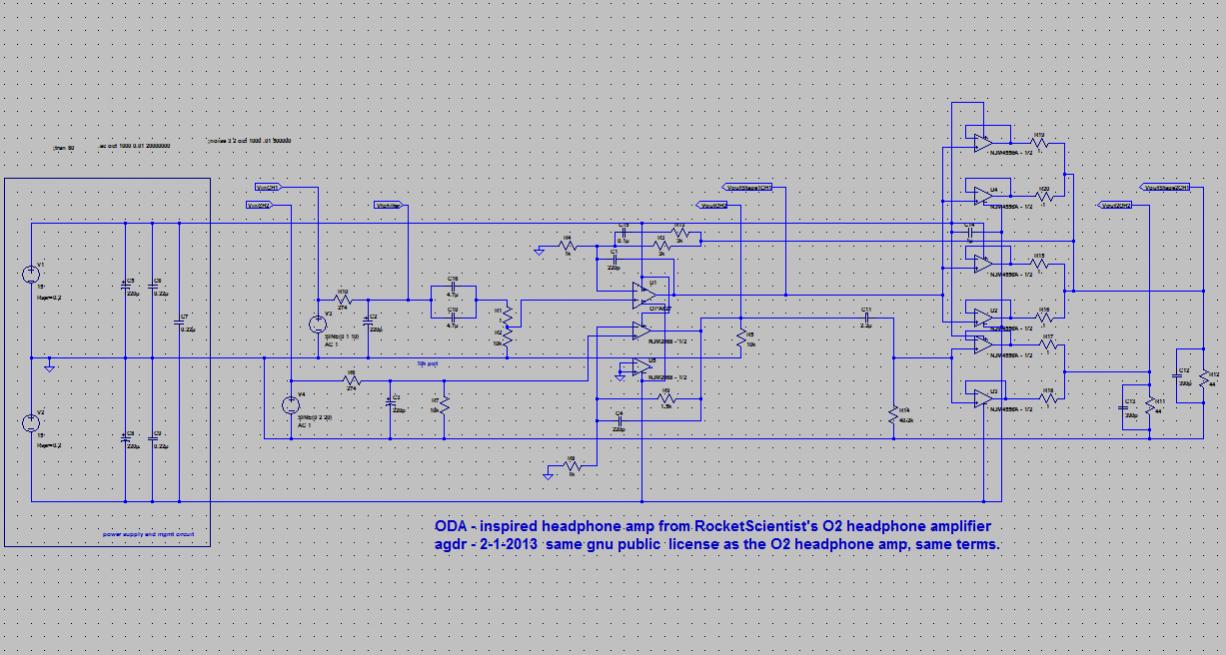

Below is an LT Spice sim of the ODA circuit on the top half, one channel, and the regulator O2 circuit on the lower half for comparison. From the plots the two outputs are virtually sitting on top of each other, green and blue, which they should be. The next two below are the schematic and about 2/3 of the way through a layout. Once the Chinese PCB shops open up in a week after the holiday I'll get one fabbed and stuffed. Once I finally get a working design I'll post the layout in the wiki section here for anyone who might want to DIY it. Since RocketScientist released his O2 under the gnu license, and this design is a derivation, I'll list it as being covered by the same gnu license for public DIY use.

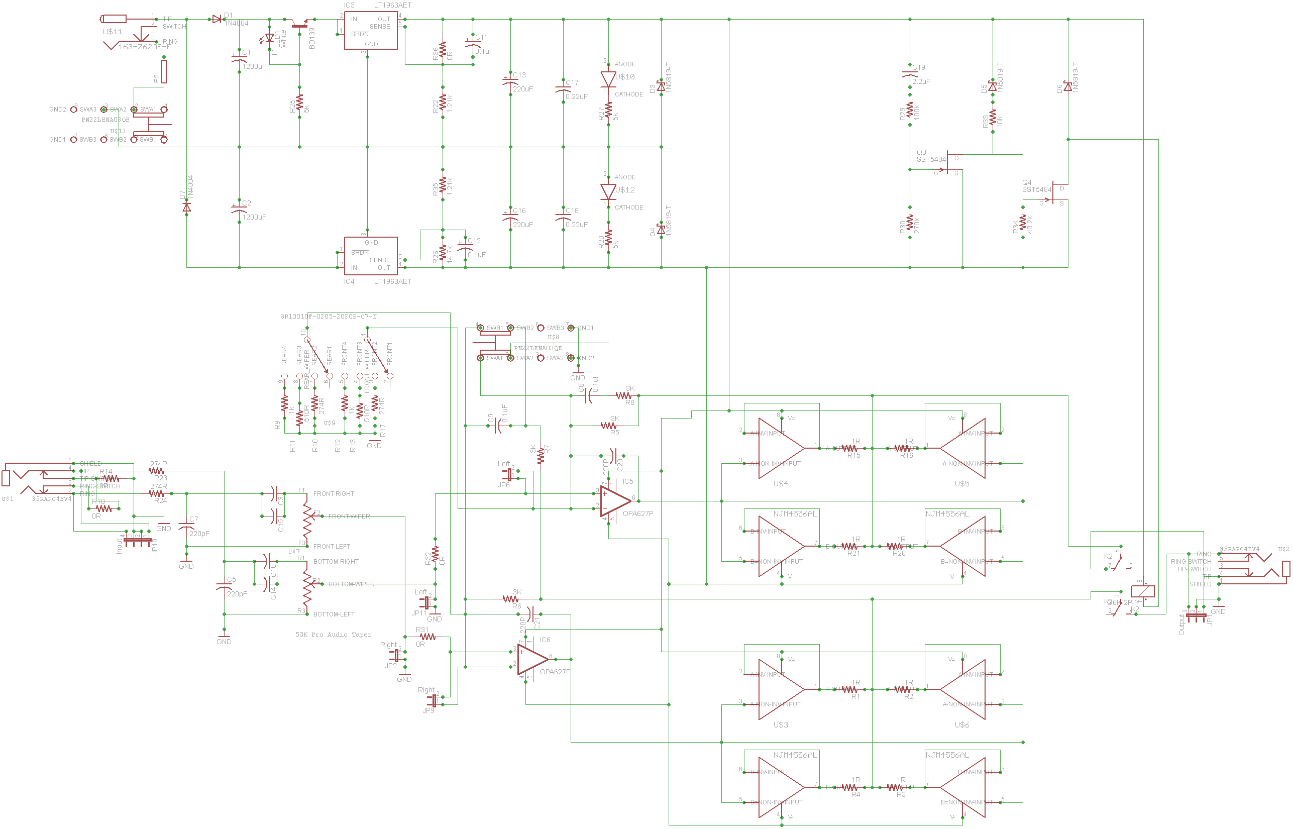

This goal of this ODA design is to maintain the same basic design philosophy that NwAvGuy/RocketScientist used, but to try to bump up the performance slightly in most areas. Plus add some features that people have posted about and a few of the O2 mods I posted.
I know that one of RocketScientist's goals with the O2 was to make it cheap to be readily affordable. I've kind of thrown that one out here with an eye towards some improvements. :) The OPA627 chips alone are $20 for the low end and $30 each for the high end. I don't have a dScope or AudioPrecision analyzer, so the final result here has not been properly measured, which of course was sort of the whole point of the O2, so fair warning.
Here is a summary:
Best new stuff:
  • · Up tp +/-16Vdc power rails with adjustable regulators for up to a 11Vpeak swing. Useful for high impedance headphones.
  • · Lower noise voltage regulators, LT1963A and LT3015. Probably won’t make any audible difference, though.
  • · Twice the output current capability and power dissipation - 280mA per channel. Useful for low impedance and low sensitivity headphones.
  • · 4 NJM4556A chips to handle the current and +/-16Vdc dissipation, two per channel. Uses the SIP 8 pin inline version, NJM4556AL.
  • · NJM2068 replaced with OPA627, which is now in a feedback loop with the NJM4556 chips to null out DC offset and reduce distortion even further. DC output offset voltage should be around 0.3mV = 300uV per channel.
  • · Has input RCA jacks and output ¼” Neutrik jack in addition to better (Switchcraft) 3.5mm jacks.
  • · Bass boost circuit – switchable on/off.
  • · Rotary gain switch with 4 gain settings.
  • · Relay-based no-thump circuit that waits 2 seconds to switch in the headphones and then drops them out quickly on power switch-off.
  • · Should have even lower background noise than the O2 headphone amp at high gain settings. 4 layer PCB with full middle ground plane.
  • · Volume pot is on the input now rather than the middle of the circuit, so it can attenuate “hot” sources as much as needed. Still no pot turning noise.
  • · Coupling cap is on the input, 4x as large to work with the 10k pot vs. 40.2k resistor in the O2, to block all incoming DC from the source.

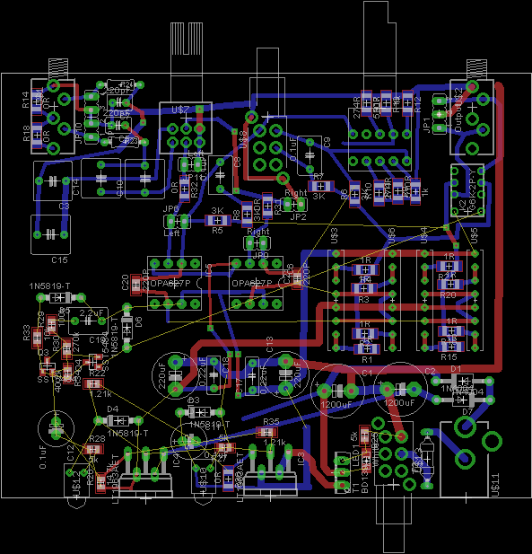

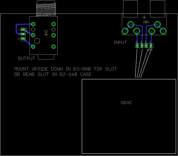

This version of the ODA uses the B4-080 case. In the layout below all the power supply stuff is now in the lower right corner, including the power plug. Having the power plug in back is something a lot of folks have posted about. The voltage regulators now line up along the back edge and are heat-sinked to the back panel of the aluminum case, one of the O2 mods I posted. So no finger-burning regulators in this one, although the transformer is now limited to 14Vac or 16vac, nothing higher or lower due to the input limitations of the new regulators.
The 3.5mm jacks are higher quality Switchcraft jacks, with actual springs inside and not just springy metal, another thing a lot of folks have posted about (bad jacks). I've used vertically oriented jacks to make better use of the vertical dimension and leave more front panel space. I've included 0 ohm surface mount jumpers on the back of the board to disable the grounds on the input jack switches if using the RCA jacks - no more cutting board traces as with the O2 to add the external jacks. The design has a companion top board that slides in the top slot of the B3-080 chassis, upside down. That board has a Neutrik 1/4" output jack and RCA jacks that can be wired for input or preamp out. The top board also has space to mount a ODAC.
New stuff on the front panel now includes a rotary 4 position gain switch. Gains are 1x, 2x, 4x, and 6x. There is a bass boost switch for boost on/off. The resistors can be selected for any level of boost, such as 3dB, 6dB, etc. Another one of the O2 mods I posted. The power LED is now on the back panel, one for each supply rail to help diagnose dead power supplies. The unit has a (pico)fuse now too on the AC input and the power switch shuts off the entire power supply now.
I've included the output relay mod I posted for the O2 which delays the headphone output turn-on by about 2 seconds, then switches the relay out quickly when the power is shut off to prevent thumps.
The rest of the new stuff is in the middle. The gain stage now uses an OPA627 with a feedback loop wrapped around 2 NJM4556AL (SIP 8) chips in parallel on each channel, for a total of 4 op amps in parallel now on the output. The pot in the middle had to go to allow the feedback loop (DC) to function. The pot and coupling cap are now on the amp input, with the cap value adjusted up 4x to account for the 10K pot.
The new arrangement should nearly null out (around 300uV vs. 3mV for the O2) any DC offset on the output of the amp, given the exceedingly low 100uV max input offset voltage of the OPA627 and its tiny 5 picoamp input bias current, which results in nearly zero IR drop across the input resistors. This also means the pot won't have any substantial DC through the wiper even though there is no longer the coupling cap on the wiper as with the O2. Just another way around the silent-pot design issue. :)
The cap is still there feeding the pot though to block incoming DC from the source. Highly not recommended to bypass that. I've made sure the frequency response still matches what RocketScientist's design had on the low 10Hz end.
A by-product the the new negative feedback loop design should be even slightly lower distortion. RocketScientist had pointed out that the distortion figures of the output chips swamped that of the NJM2068 input chip. Essentially made the output chips the limiting factor on distortion. They were just a necessary evil to get the high current. The NFB loop should lower that output chip distortion a small amount. The OPA627 has excellent distortion numbers.
The design uses both surface mount and through hole components and has parts on both sides of the board, so it probably isn't a novice level of soldering type of DIY build, unfortunately.

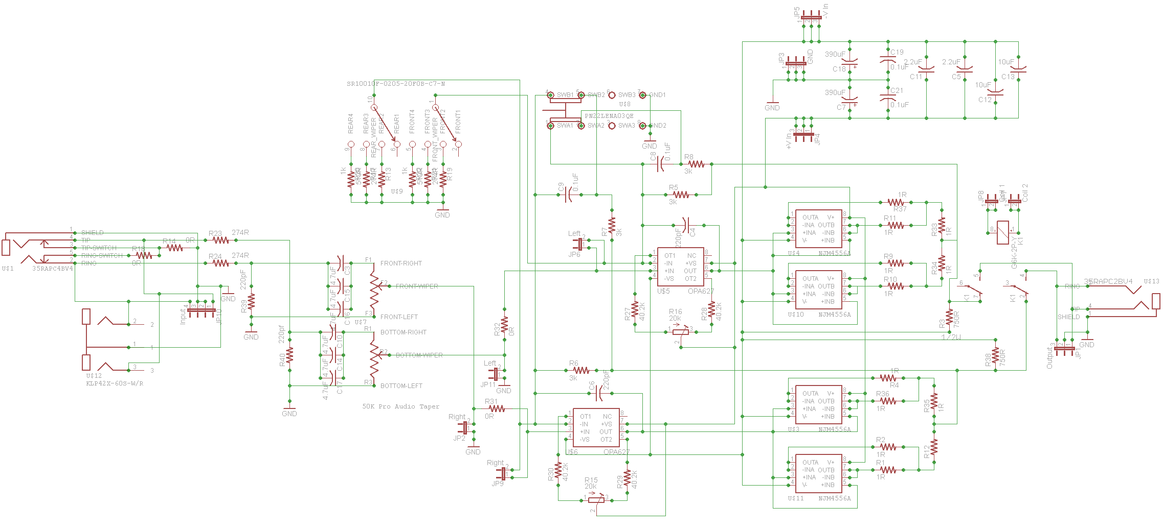

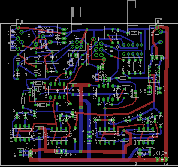

So the aim is to get better figures but not better listening experience? Carrying on the 'objective' philosophy but to the next level?
I'd be a bit worried that by sticking 4556s inside the feedback loop of the OPA627 stability is going to be compromised. Also is the 627 being chosen for its figures? If so, which figures?
The OPA627 is chosen primarily for the DC parameters, having both a very low input offset voltage and extremely low input bias current (FET input), along with having good AC parameters for audio. The project originally started out trying to reduce the DC offset of the O2. I posted a servo using the OPA627, then realized I could just put it in a loop around the buffer. TI actually shows this application of the 627, to reduce a current buffer's ouput offset, in figure 14 on the datasheet:
www.ti.com/lit/ds/symlink/opa627.pdf (opens PDF)
I took a look at the OPA211 which comes in a dual package (power pad, which I hate to solder) and also has low input offset. But that has bipolar inputs and still has a hefty input bias current. Having the FET input on the OPA627 lets me directly connect it to the pot wiper without a cap and solves that issue (pot turning noise due to DC current through the wiper). Also means very low IR drop in external input resistors due to input bias current, making the imbalance in impedance looking out the inverting and non-inverting inputs (a pot, which will be varying) insignificant. Interesting to note that the leakage current through the pot wiper coupling cap on the O2 should be about the same, or even more, than the 5pA of input current through the OPA627 input. So the two different designs really should be equivalent.
I've left the 220pF feedback caps from the O2 in to roll the chip's gain off to unity above the audio band. Turns out 220pF was still a good value for this chip.
On the subjective vs. objective thing, I'm in the camp that an amp has to sound good as well as measure well. I do believe an amp can measure well and sound bad. I'll post my subjective thoughts once I get a board stuffed and have a listen.
As for why someone would want 4 paralleled NJM4556s vs. just a single LME49600, BUF634, or even an OPA551 ddpak, beats me other than that seemed to be the logical extension of the O2 to an ODA. :) The ddpak parts make it a bit harder to build a compact amp due to the square inches of heat sink foil needed. I prefer chips that can be heat sinked, or in the case of thse SIPs do a good thermal transfer job themselves. The SIPs are rated at 800mW vs. 700mW for the DIPs in the latest version of the data sheet:

I actually laid out an all-smd version first but decided it would be too hard for folks to solder. Then I laid out an all-through hole version that used two 100 x 80 boards in a B3-160 chasis, with the amp board in front and power supply board in back. After pondering that one a bit I decided it was too physically big. That led to this version with the SIP parts to save space.
BTW, I left the OPA627 as DIPs in sockets rather than the SOIC version due to the senstive FET inputs. That way all the soldering can be done with the socket, then the chip inserted with anti-static mat and wrist strap later. I figured the odds of toasting the $30 chip with hand assembly would go way up with the smd version.

I've spent a boatload of time over the weekend with noise analysis on the front end, given the pot up front. Nearest I can tell the increased Johnson noise isn't really going to be audible, especially from the various posts that people seem to be using their O2 at 1x and 2.5x gain. The 6.5x wasn't as popular as RS initially thought.
From what I can tell it seems that maximum Johnson noise comes at the midpoint of the 10K pot, with 5K on either side of the wiper. Less rotation and the resistance & noise is less than 4K. More rotation and now the voltage divider starts doing its thing and reducing the noise along with the signal. If anyone has worked that out (noise figures from a pot at the front of the circuit) and has some thoughts to share, please post. At least the current-induced resistor noise will be negligible with just 5pA of input bias current.

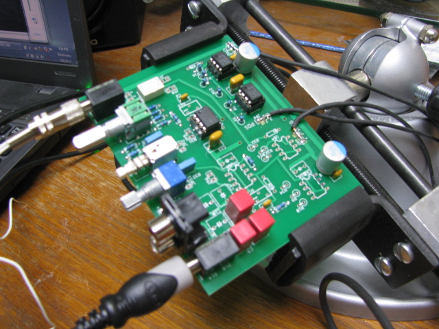

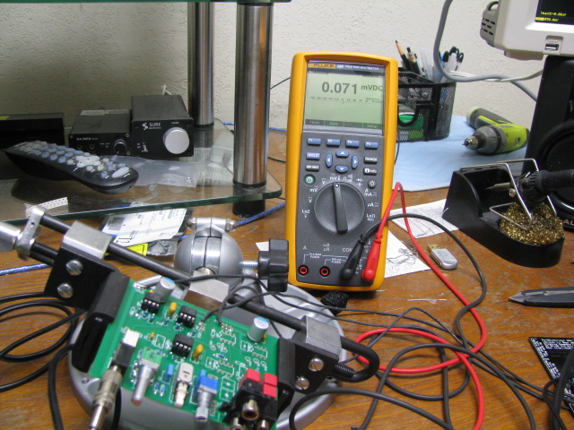

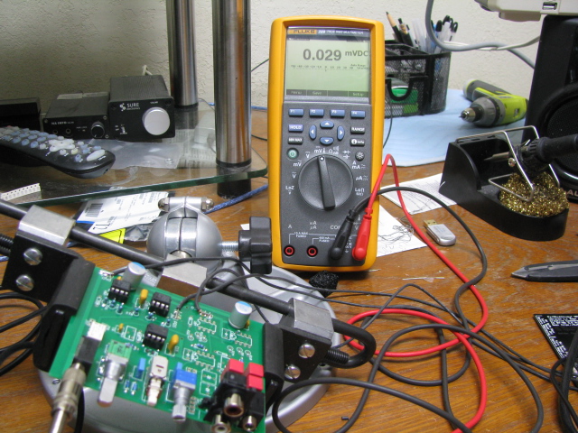

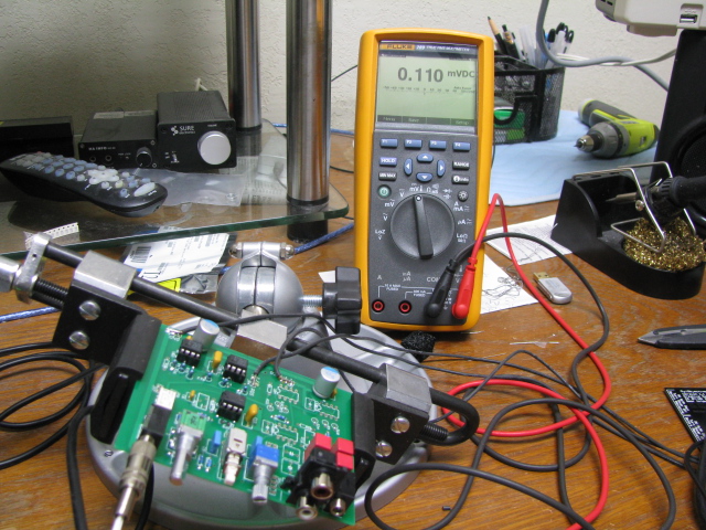

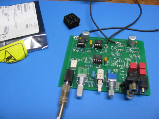

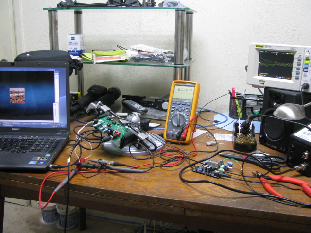

It works!
The crazy thing works! The PCB's arrived from China on Monday and package of parts from Mouser today.
The project has actually exceeded my expectations and I'm not entirely sure why at the moment. It is completely noiseless, at all pot settings, with a gain up to 12x. The O2 headphone amp has a extremely small background hiss at 6.5x gain and the volume all the way up (input grounded), so this thing actually has less even less hiss than the O2. That is a surprise, given what should be the increased Johnson noise with the pot at the input and the FET input op amp. I just wasn't sure from the noise calculations. Hard to translate that into what is actually going to be audible. And that is with my senstive AKG K550 cans that are full volume at about 80mV.
The 12x gain was a mistake too, :) I had forgotten the feedback resistor is now 3K for the bass boost circuit, rather than 1.5K in the O2 amp, therefore the resistors to ground need to be doubled. So instead of the 1x, 2x, 4x, and 6x I had intended with the rotary switch I have 1x, 4x, 8x, and 12x. But worked out well for hiss testing. Just a matter of pulling out those resistors and stuffing in double the values.
Nuking the O2's 3mV or so of DC offset was the primary goal of my project and it certainly has achieved that, as the photos below show. I was expecting a low of about 300uV (0.3mV). Instead the 1x position in the photo is just 30uV! The DMM is good for 1uV resolution so that should be fairly accurate. The 4x position is 71uV, the 8x position 98uV, and the 12x gain setting 112uV. Woohoo!
No oscillation at all up to the 100Mhz limit of my scope. I even tried a parallel 680pF capacitor across the headphones to try inducing instability. Nothing. The bass boost didn't de-stabilize it either, even though that is putting a 0.1uF in the feedback loop which causes phase shift. I was really expecting some stability trouble with the bass boost, especially at the high gain setting with the increased load capacitance, but not so.

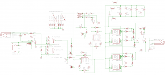

The schematic and layout that went out to fab is below. Since then I've traded the 1/8" output jack for a 1/4" output jack which seems to be more standard on desktop headamps. I managed to get a front panel RCA jack wedged into this one along side the input 1/8" jack. I used solid polymer electrolytics for the power rail bypasses (390uF) in this one rather than the wet electrolytics.
I also manged to stuff in a third 4.7uF film capacitor in parallel for the input blocking capacitors on each channel, bringing that to 15uF. That was important since I decided to lower the pot from the 10K used in the O2 to 5K (audio taper). The lower pot value may be one of the things that has led to the exceptionally low hiss. But to keep the LPF corner frequency the same as the O2 between the blocking cap and the pot I had to up the blocking caps to 15uF.
The output balancing resistor scheme seems to have worked out very well, too. The O2 uses one 1R resistor from each op amp output to the headphone output to balance the two op amps in the single package. In addition to that I've added another 1R resistor between packages, as the schematic shows. The theory was that the op amps in a package would be well matched but not so much between packages. Measurements this evening tend to bear that out. I measured around 300uV across the two 1R resistors in one NJM4556A package, while both in the other package were around -100uV.
I'm not entirely sure why those DC offset drops are so much lower than the O2's 3mV. I know half of that 3mV was NJM4556A input bias current going through the 40.2K resistor to ground, which is all removed here. The OPA627 will effectively has zero ohms out, of course. But that leaves 1.5mV of inherent DC offset at the chip's input. Apparently the feedback loop with the OPA627 is working extremely well to null that remaining NJM4556 input offset, even though there are 4 op amps now on each channel over two packages.
No significant heating of any of the chips either. Lol - only stuffed one channel to see if it was going to oscillate itself to death or what. :)
In the photo I'm tapping off the +/-12Vdc from an O2 since I don't have the power supply board for this thing out to fab yet. So all of these numbers are with just the O2's power supply.
I also haven't stuffed the offset trimmer pot holes yet, and at this point I probably won't. I know that using the trimmer adjustment on op amps is one of the quickest ways to kill the PSRR and unbalance the op amp's input stage. With just 30uV of overall DC offset there really is no point adding the trimmer circuit.
jcx - if you happen to read this - I decided that clever class A scheme was a bit more than I wanted to roll into this one, but I have added a position on the PCB for the simple resistor on each package output (after the 1R resistors) to a rail to bias the NJM4556A's into class A that way. I haven't tried it yet but probably will. Looks like 750R or so would do the job. :)

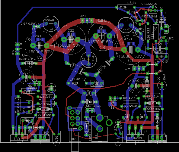

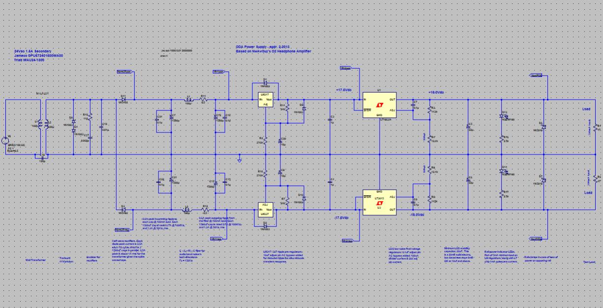

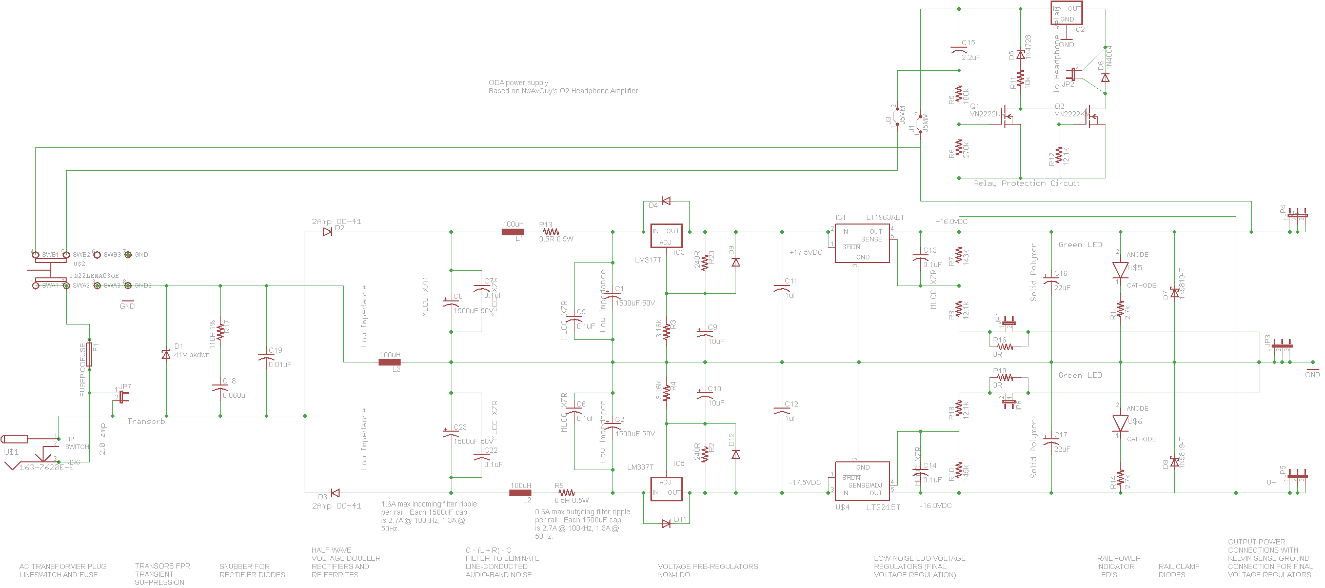

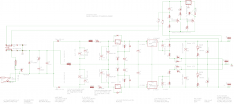

...and the matching power supply board that goes in the other half of a B3-160 aluminum case. I've already posted about this in a thread in the power supply section here. In the latest incarnation LM317/LM337's are acting as pre-regulators for low(er) noise LT1963A's and LT3015's. +/-16Vdc.
I've labelled the various sections for any hobbyists out there learning some electronics. :)
