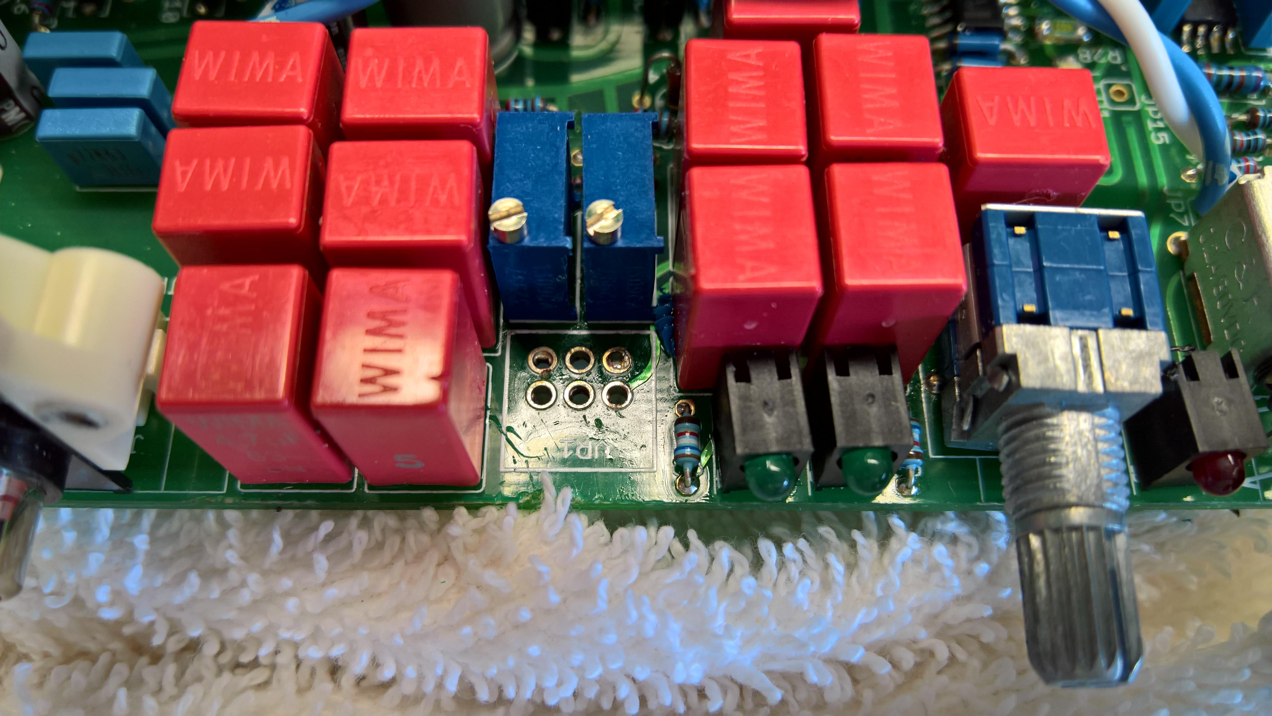

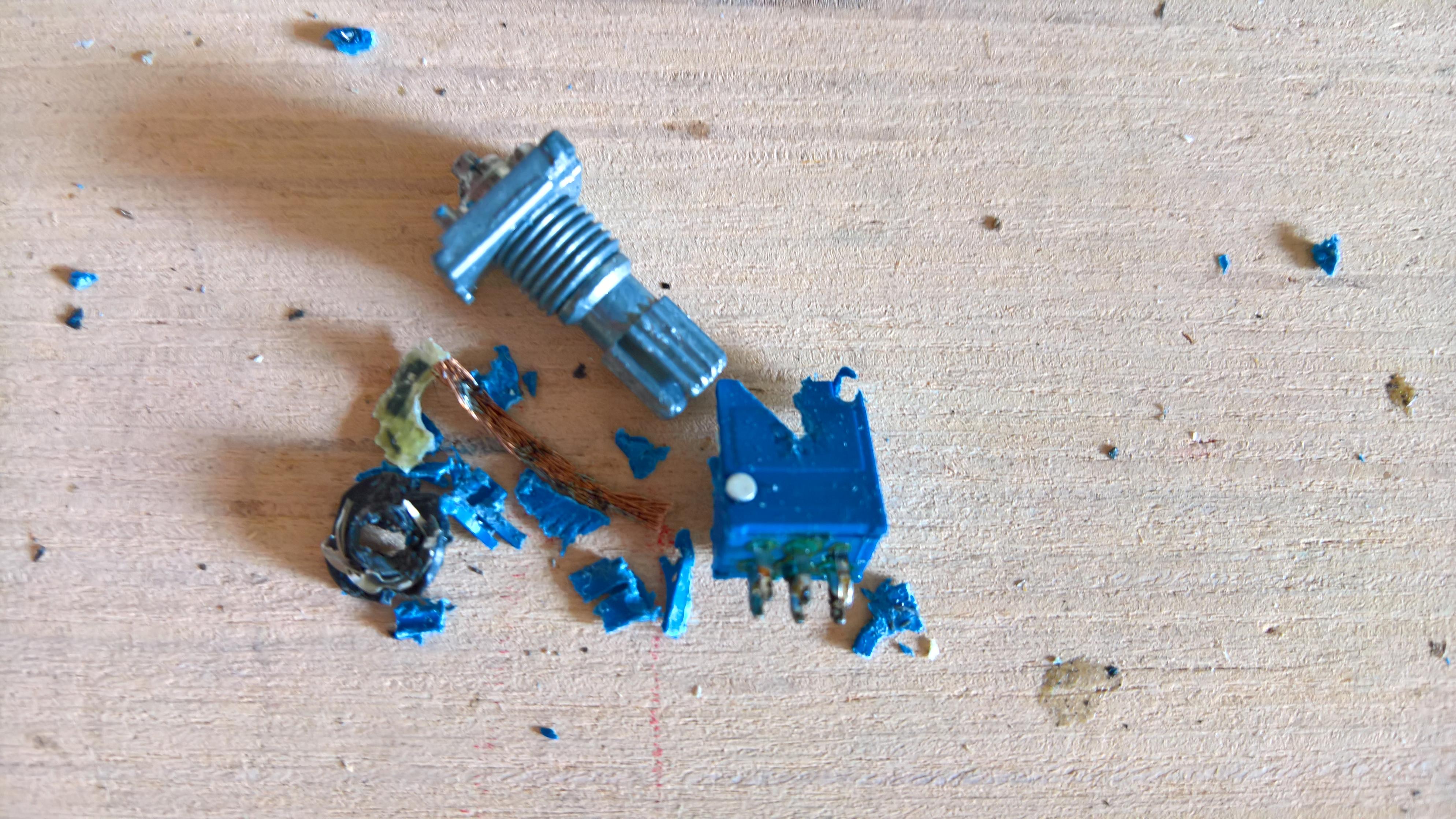

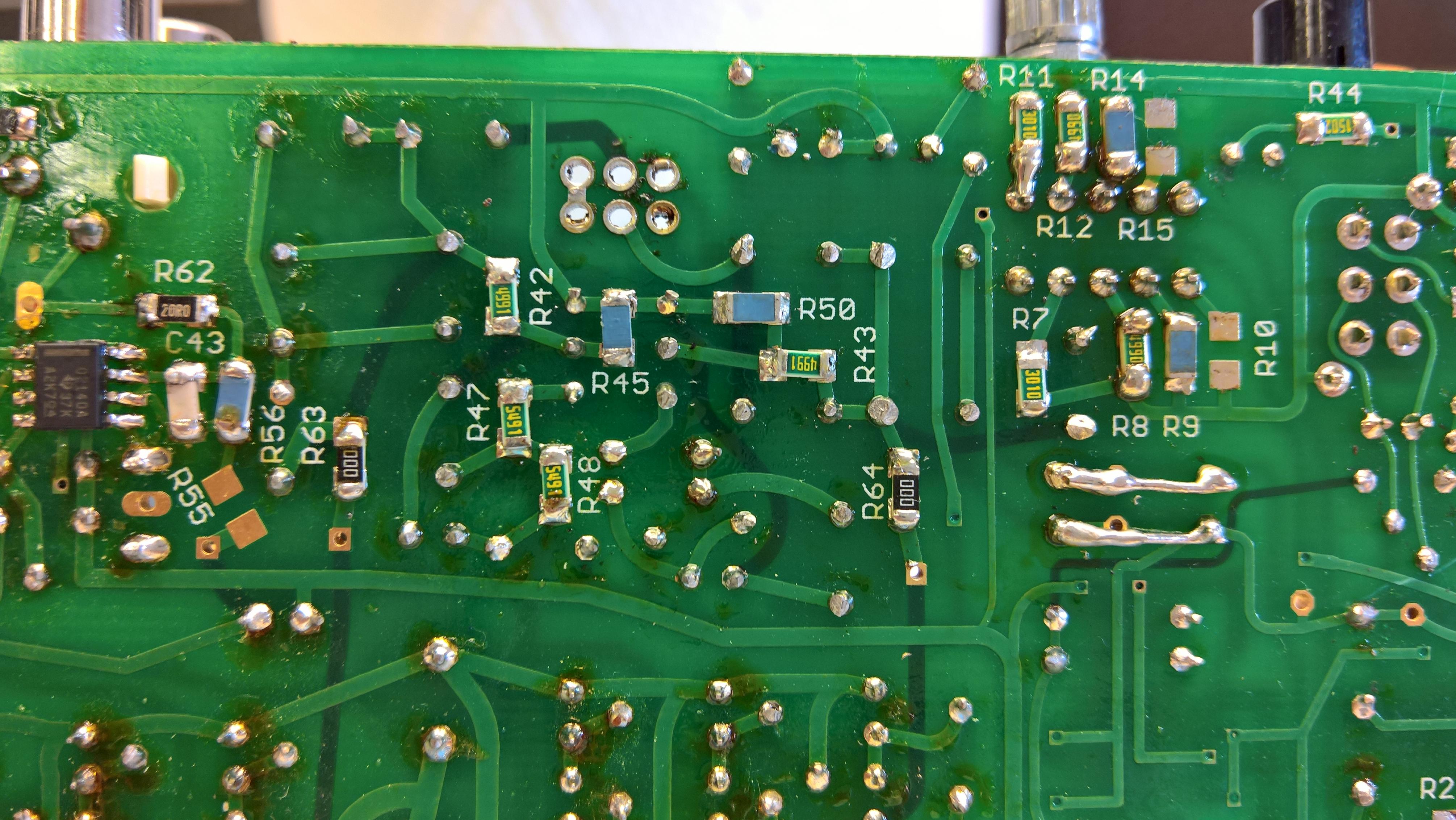

OK 4x4F150.....I ordered a new pot. Just removed the old scratchy one. I dont have a neat Hakko sucker so it was going into careful destructo removal mode!!
Using a small drill, drilling as many holes into the pot without hitting anything else, using some solder wick and flux to remove all of the solder I could. Then slowy prying the remainder of the pot out...she came out willingly!! Ha!
Now just need the new pot from mouser in a few days and we should be bcak to scratch free listening!!
Where there a will theres a way...
