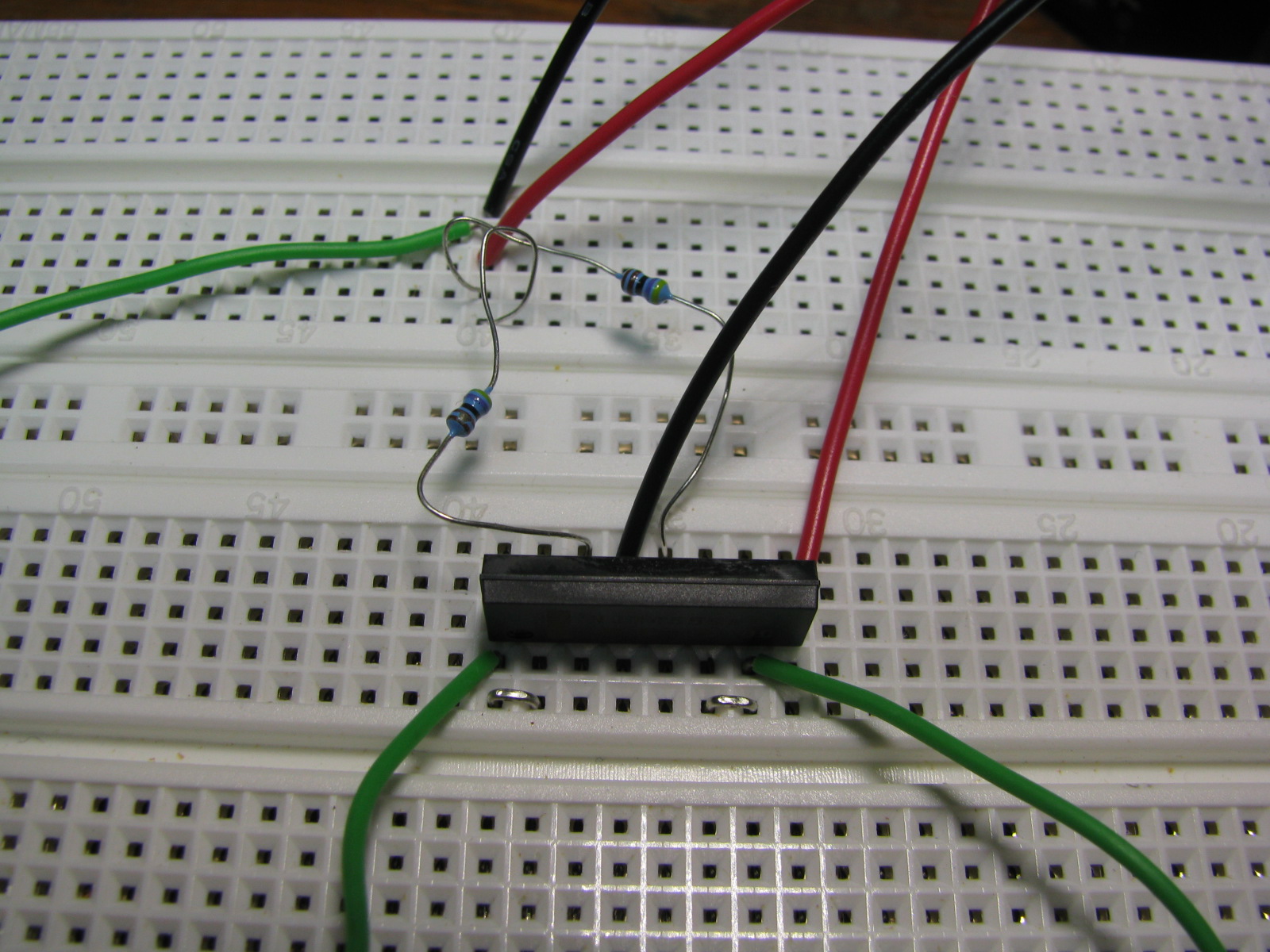

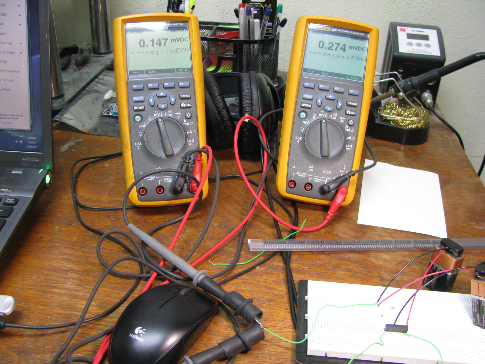

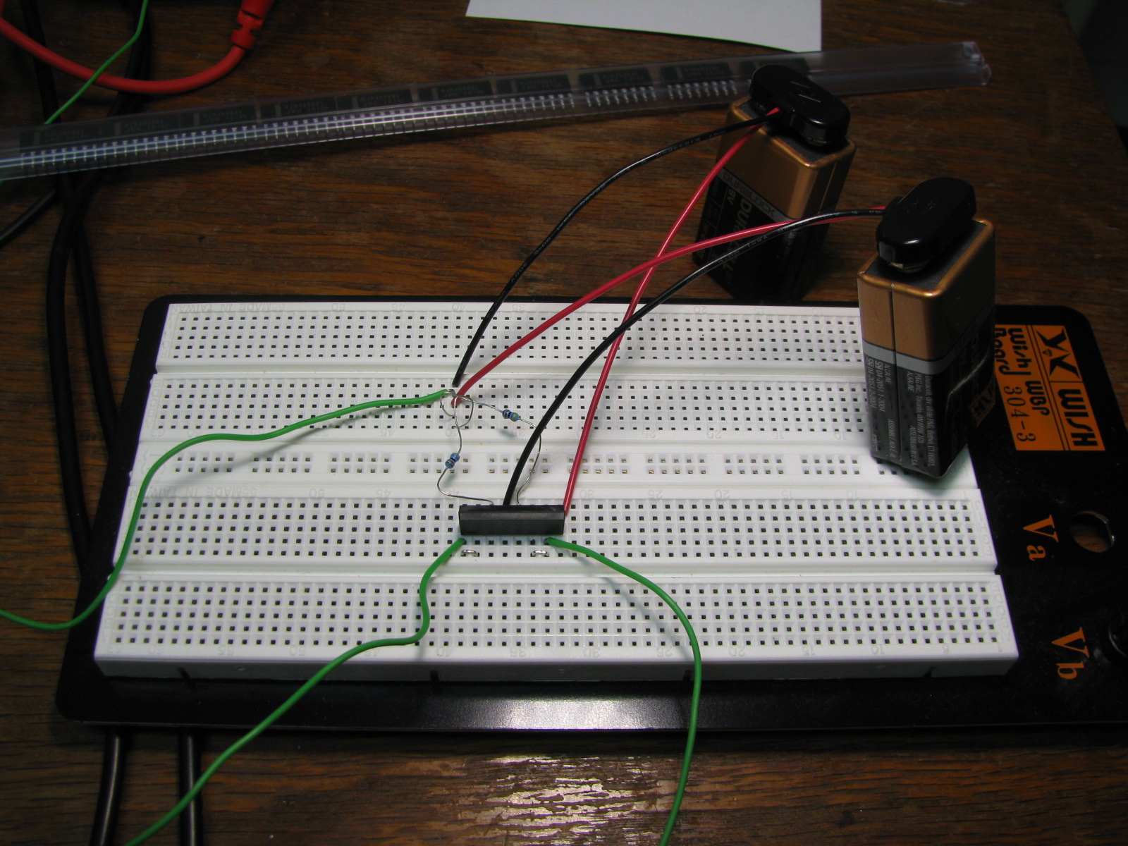

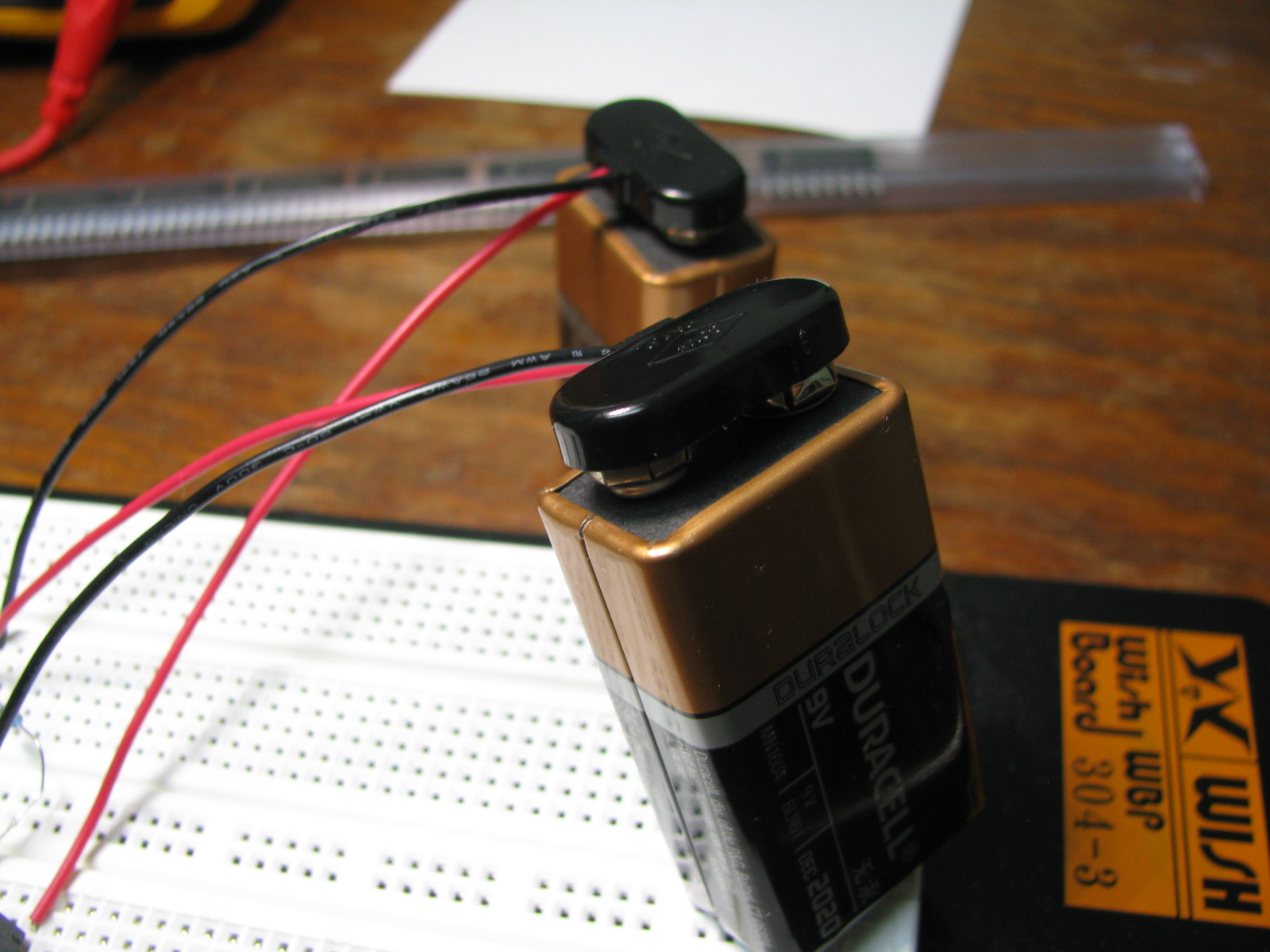

I did the matching on a bunch of the NJM4556A chips last weekend and took some photos to show how it is done, below. :) Not hard, just a bit time consuming. Close counts here. Not looking for exact matches, as with jfet matching, since the zeroing circuit will cover quite a range. Just looking for any that are particularly different from the rest, to throw away.
* The first 5 photos show the test setup. We are looking at output DC offset voltage here. Just a solderless breadboard with +/-8.7Vdc applied to the chip from two 9V batteries (measured, to make sure the batteries are roughly equal). The non-inverting inputs of the NJM4556A sections are returned to ground through a 4.99K resistor. This is important! If you just ground the inputs (without using the series 4.99K resistor) all you see is the inherent input offset voltage of the op-amp, which will be roughly centered around zero (both polarities). But if you use the actual 4.99K ground return resistor from the circuit, the input bias current of the NJM4556AL times the resistor value produces about half of the resultant DC output offset voltage. And it also skews the polarity of the output almost always positive, due to the consistant direction of the input bias current at idle (and AC zero crossings).
The net result: your measured DC output offset voltage will be nearly all positive with respect to ground. That is what the ODA's DC zeroing circuit is designed to expect.
The output is tied to the inverting input on each section, as in the actual circuit, to form a voltage follower.

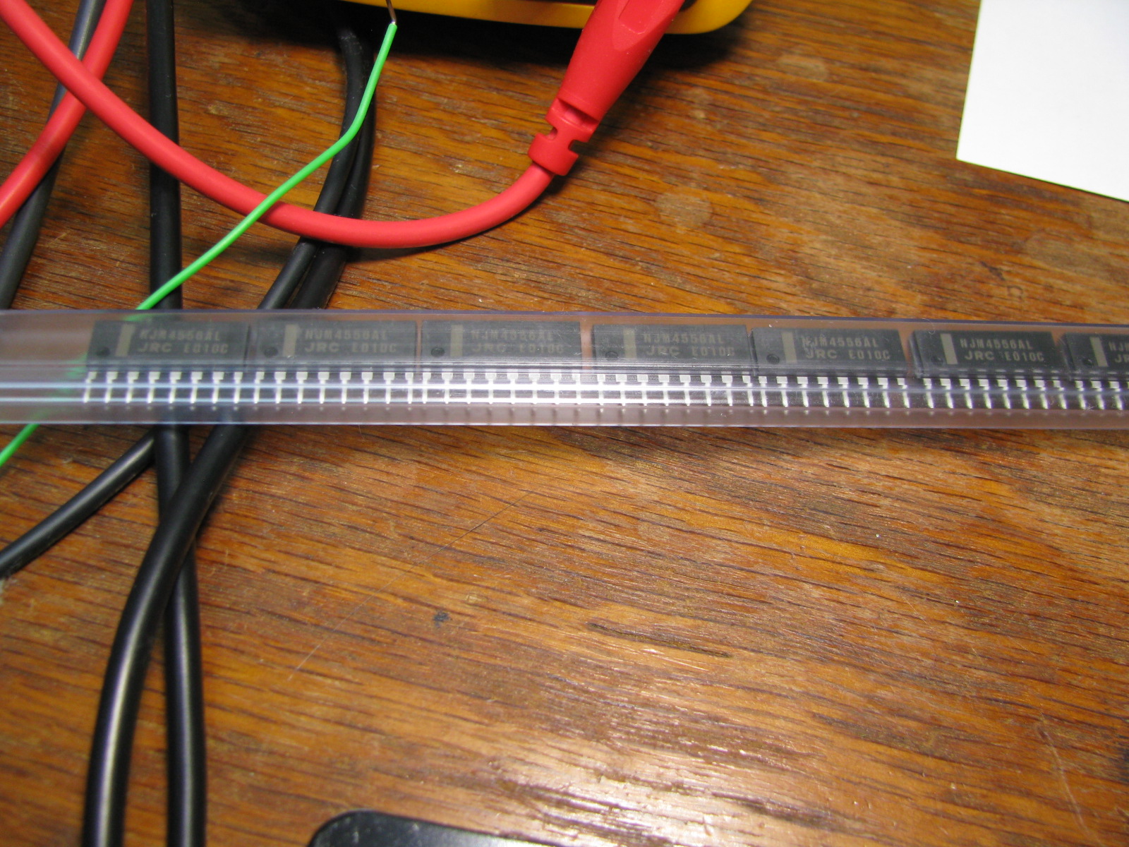

* The next photo shows a tube of the NJM4556ALs from Mouser

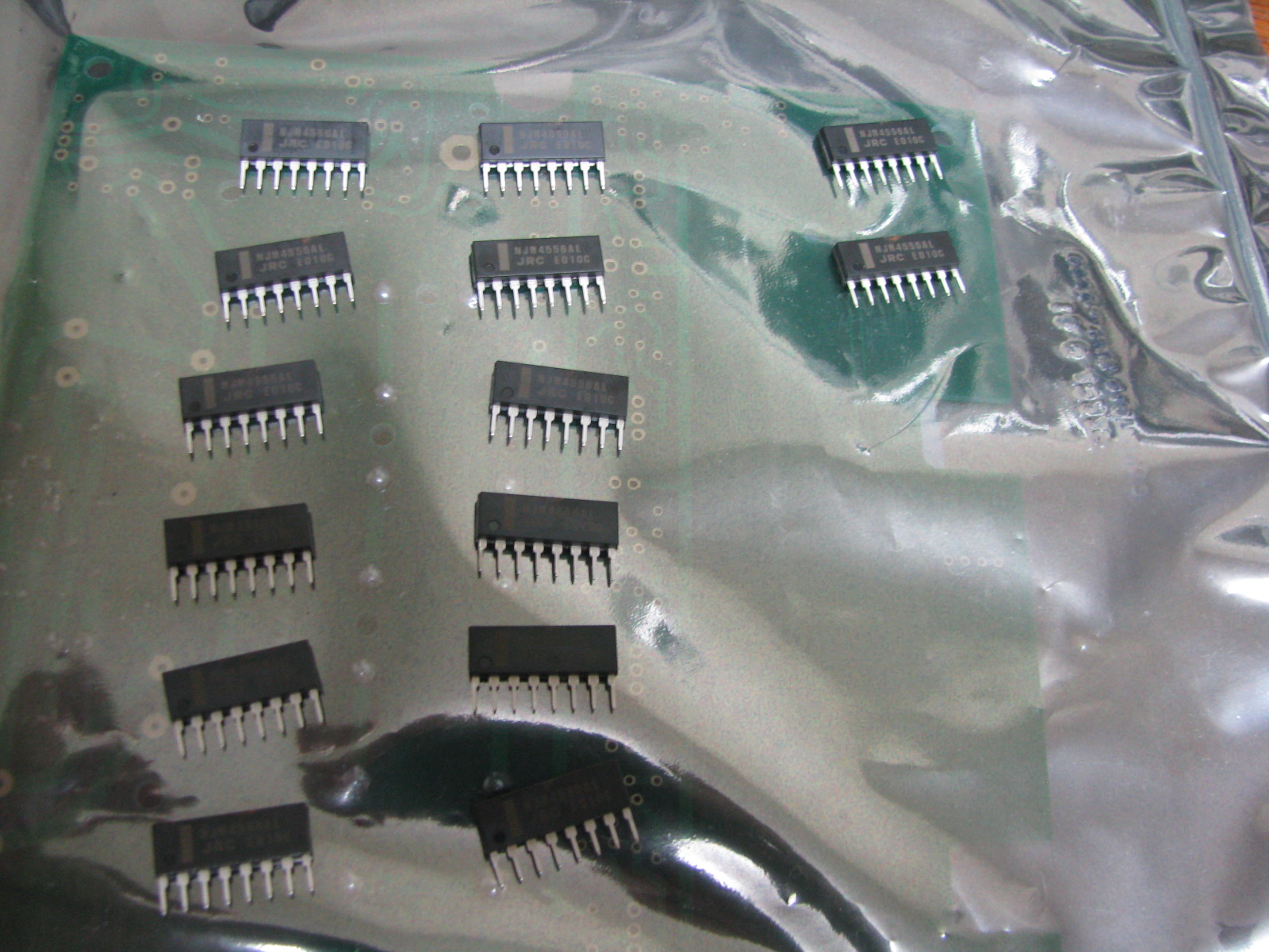

* The next 2 photos show the results. I've numbered each chip tested out of the tube and placed them on an anti-stat bag. From the hand-written results you can see that I've marked out chip #2 because that second section was all the way up at 1.37mVdc, way out of the average of the others just looking at the list here. That one went in the trash, as did #8 since the first half measured slightly negative polarity. I didn't have it marked at this stage, but #4 also eventually went into the trash. Once I did a second tube of chips I decided that 0.175mVdc on the first section was a bit lower than average too. All the rest of the measurements are just fine. You can see how I matched them up from the lines at the right. I put #1 and #5 together so the higher 0.906mVdc from the second section is reduced by the lower 0.360mVdc on #5's second half. Same with the first halves, matching up the higher 0.721mVdc of #5 wit the lower 0.342mVdc of the first half of #1. Then #6 is relatively equal on both halves.
Again the DC zeroing circuit has a wide range, so close counts here. Does *not* have to be exact matching. Just getting rid of things like that 1.37V and the -0.148 help keep the zeroing trimpot in the middle and not out slower to one end or the other.
Also just a comment, as can be seen a certain number of the chips go in the trash here. 3 in this case. On the next tube of chips I that did 4 got thrown away. So that also figures into why the cost of the NJM4556AL matched set in the ODA board kit is about 2x the $0.73 cost of the chip at Mouser, along with the time it takes to do this matching.
