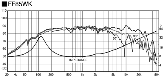

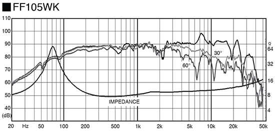

Here is the frequency response for the speakers I am thinking on using. (I haven't purchased them yet)
My main focus was on the 3" model FF85WK, but there is also a 4" FF105WK. The 3" seems like a perfect fit being as it's rated for 5W. The 4" is rated for 10W, but it is more efficient at 88dB/W vs 86.5dB/W on the 3".
Both are more than 8 ohm on average looking at the curves and both of these speakers get really good reviews on this forum in the full-range section. I might go with the 4" model to get more low end, but it will be under driven based on the specs.... decisions, decisions.

Good questions about nominal speaker impedance! Thanks for posting the curves. Either of those would be just fine as 8 ohms seems to be the minimum. Those peaks in the curve at 70Hz and 120Hz show why having a low output impedance from the amp is so important. If an amp had several ohms of output Z those peaks would start forming a bit of a voltage divider.
But yep, in general, it is good to have a look at the impedance curve if available. Something advertised as 8 ohms nominal might actually be spending most of the time at 6 or 4 ohms. A few small dips down to 6 ohms in a speaker impedance curve wouldn't be a problem.

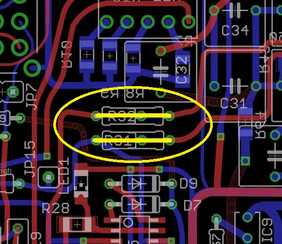

I have the Massdrop edition AKG K7XX which I usually need to have the gain switch cranked to the 5th position for. I'll take a look at which resistors I installed and solder a bridge on the underside like you recommended. Thanks for the response. If I have any questions I'll give you a shout.

Yep, that is likely one of the problems, you need to short those two attenuation resistors. I've attached the spreadsheet below. Here is the specification page for the Massdrop K7XXX:

The K7XXX uses the K702 drivers, which are 62 ohms and 105dB/V sensitivity. Plugging that into the spreadsheet below gives 5.63Vrms (= 8Vpeak) and 90mA(rms) required per channel to hit (super loud, but for instantaneous musical peaks) 120dB SPL.
The problem is that with the attenuation resistors installed the maximum output swing is cut in half, from 10.25Vpeak to 5.1Vpeak = 3.6Vrms. So your maximum output voltage swing right now is 2 volts less than you need. Short those two attenuation resistors across and you will get your full 10.25Vpeak=7.25Vrms maximum output swing back.
However: The 3.63Vrms maximum output swing you should be getting right now is still 115dB SPL, which is as loud as a freight train. You probalby have another problem lurking in there somewhere! Go ahead and short those resistors across and let me know how things go. If you have a DMM please check your power rail voltage readings too, JP18 to ground (JP6) and JP19 to ground.
And those connection wires you used are OK too.

So just to be clear with the gain position at the 3rd step and the volume at max the amp will push enough power through my headphones to blow my head off. The only reason I was asking about shorting the attenuation resistors is because I wanted to keep the gain and volume knobs low while keeping my computer's volume at the same level I use to listen to my music on my speakers. (I have powered speakers plugged into the amps pre-amp outputs)
This is the reason it's been so many months and I havent had any reason to bring it up. Everything is working great and the sound is wonderful I just wanted to step the headphones down from the max gain and use the volume knob instead.
I've installed the jumpers just now and am reassembling the unit. I'll let younknow how the headphones sound after everythings tighted back up.
Although I feel like maybe I should keep it open because I've been wanting to install your plate and slap the ODAC in this puppy sometime in the near future.
That is right!
Hmmm... but I'm making the assumption that your source level is in the 1Vrms to 2Vrms range. Could be the problem is that your incoming source level is just really low, given how you have it adjusted for the PC's speakers. If that is the case then shorting those attenuation resistors should help. They] change will 1x the input rather than 1/2x it. Please let me know the results! If low source is the problme the next thing to do would be to change the gain resistors so that instead of 1x, 2x, 3x, 4x you had 2x, 4x, ... or any custom set of gain positions you wanted.

holy freakin moly....
WE ARE AT MAXIMUM PERFORMANCE.
I cannot explain how superb the level of sound this amp has achieved. I cannot thank you enough for building this device for us agdr. I am in absolute awe at the pure raw performance your amp is introducing into my headphones. I love it! Thank you!
Cranking this thing up to zero attenuation is leaving me dumbfounded in my music. Thank you my man!
