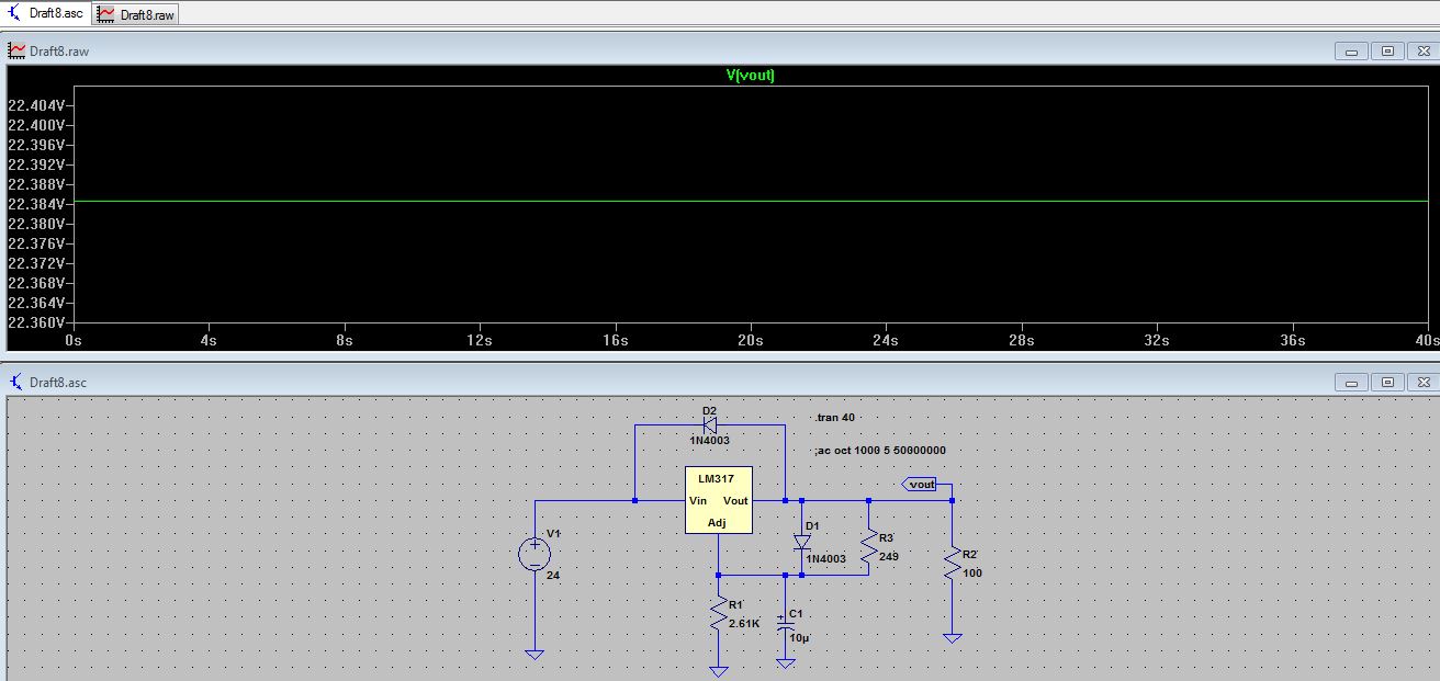

OK I'm back the computer! 🙂 So here is some interesting things about your power supply measurements.
I wasn't sure exactly what revsersing D5 would do, so I simulated it, results below. Turns out it essentially bypasses the pre-regulator and lets nearly the full input voltage go to the LT3015. In this sim I have 24Vdc going into the LM317 and 1.6V less, 22.4Vdc comes out. That 24Vdc input would be the result of a 18Vac transformer secondary.
So - you are lucky this happened with the negative power rail because the maximum input voltage of the LT3015 is 30V, but for the LT1963A on the positive rail it is only 20V. That is one of the reasons I have the pre-regulators on there, to drop the input voltage down enough for the LT1963A chip. If your input voltage (JP11) isn't running more than 30V, your LT3015 should be OK, at least no over-voltage. But the LT3015 would wind up with 12V across it and it would get hot fast, since it doesn't have a heat sink. The LT3015 has thermal shutdown though, so it probably survived the dissipation if it didn't run very long that way.
Long story short: your LT3015 probably survived. 🙂
The regulator chips all have a certain amount of natural +/- tolerance on their internal "set" voltages, which is what causes the small amount of variation from the +/-12.5Vdc power rail target voltage. In your case the 12.483Vdc positive rail came out great, but the internal reference votlage of that LT3015 is off a tiny amount to result in -12.402Vdc. Here is where it gets fun though. 😀 Even though the 0.08Vdc difference really doesn't matter, it would jsut reduce the maximum output swing by that amount, why not get it perfect? That is why I put the two "set" resistors in series on each regulator, R35 and R36. That 60.4 ohm R36 can be changed to get the two voltage exactly matching.
Starting with your measured -12.402 I worked the voltage set equation under figure 2 in the LT3015 datasheet backward to come up with what the actual internal reference voltage in that chip is running at, -1.2115Vdc rather than the "typical" datasheet value of -1.22Vdc. Then using that equation with the calculated -1.2115 set voltage to produce -12.483Vdc output, to match your positive rail, comes up with using a 48.2 ohm resistor instead of the 60.4. The closest standard value is 48.7 ohms, which should produce -12.480Vdc. I just happen to have some 48.7 ohm resistors here, I'll put one in an envelope for you, no charge. 😀

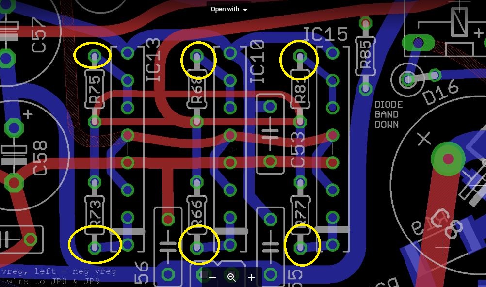

bozoc - that is correct, IC10, 13 and 15 for the right channel.
Good that you measured the zener voltages, those look OK. Also see what you get across the trimpots at the measurement points in the image below. Each zener feeds a trimpot through a voltage divider. That circled end of R54 would let you measure the left trimipot, but for the other you may need to solder a small wire to the trimpot lead under the board to measure it.
The other image is an idea for trying to track down which output chip might be bad. try measuring the voltages to ground at the points in the yellow circles. Those are just the points where the output of each chip section feeds a balancing resistor. If one chip or chip half has an excessive offset it may show up there.

I have an idea. 🙂 The 1R balancing resistors are small enough that they are forcing all the outputs to measure about the same. To find the bad chip the outputs need to be isolated. It will be a lot easier to lift one end of resistors rather than remove the NJM4556ALs. so one thing to try is unsolder and lift out the 6 circled 1R resistor ends below. Then measure the voltage on the empty PCB pad, which will be the output of each half-chip. Then the culprit should show up.
In fact for starters, maybe just lift that one end of the top 3, R75, R68, and R81. That would give you half of each of the 3 right channel chips. The thinking here is if a chip is bad, both halves may be bad. If you can use the vacuum desolder those 3 resistor leads should come right out. Otherwise I usually just stick my soldering iron tip under the lead at the end of the resistor, heat it up and pry it out. Then clean out the hole with solder wick or taping the board lightly while the pad is hot.
It will be really interesting to see the DC offsets of the 3 chip halves with those balancing resistors disconnected! They should be 1.5mV +/- 0.3mV or so. When you make the measurements probably best to have any input sources unplugged and the input select switch set for the front panel 3.5mm jack, since it grounds the inputs with nothing plugged in.
If those 3 chip half outputs look normal then go ahead and unsolder the ends on the other 3, R73, R66, R77 and then take those chip output measurements for the other chip-halves.
We should be able to track it down to just the one chip that is bad and needs to come out! 🙂

agdr- I have desoldered all balancing resistor connections at the points on the diagram.
They still crazy oscillate sometimes to -100mV when after the amp was just turned on.
Sometimes voltage settles to around -10mV.
I think it is the best if I desolder them all and test them.

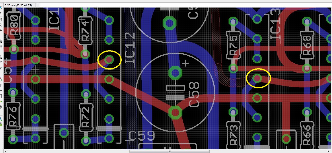

Please tell me a little more about the right channel. I want to confirm my understanding that you unsoldered all six 1-ohm resistor ends, and when you measure the pad the resistor used to go through you get 10mV on all 6 pads (no longer touching the resistor lead that has been removed on each of course)? Also would you post a picture in your gallery of the way the board is right now with all 6 resistor ends unsoldered? As they say here, a picture is worth 1000 words. 🙂

I added two photos(named them accordingly) to my ODA Gdrive album, I have also damaged C46 while desoldering R81 🙁, I will replace that cap although it measures fine.
https://drive.google.com/drive/folders/0B40kmOKTFDu0ZTVLSDZzSGZiN28
I have also took new measurements on empty pads. It is interesting how voltage changes with time. When the amp is turned on, left side is crazy high, up to -100mV and sometimes even positive 100mV(mili - m, not micro - μ; that is as low my multi meter can go, although it can detect change that low, precision is not so good). If the the amp is working for few minutes it goes down to -20mV or so on the right side.
Left side is around +-0.02mV.
All the measurements are taken with 3.5mm input selected, without input signal, volume on max, gain on first position with right side resistors unsoldered like in the diagram you linked unless noted otherwise.
https://drive.google.com/drive/folders/0B40kmOKTFDu0VUtLY0d4MzRCQWM?usp=sharing
