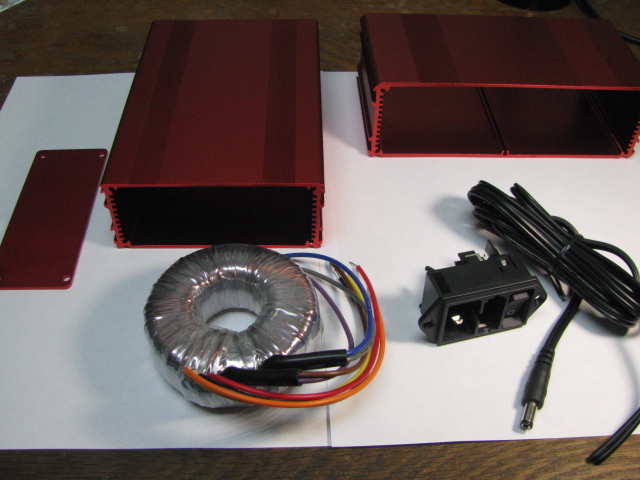

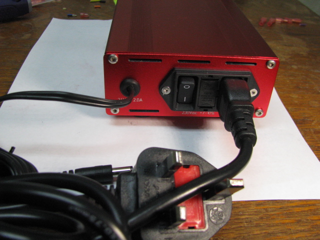

50Hz Euro/UK transformer build for the ODA
I think it has been mentioned in the thread a few times that we've hit a glitch with the european energy efficiency rules. AC wall transformers are no longer allowed. Everything has to be the (more efficient) DC switchers. Which is great unless you want a linear supply rather than a switcher for your audio gear - and your amp needs AC input!
Up until now everyone outside the US who have built an ODA have boxed up their own torrroidal transformers. I've been hestant to build or even specify something with a line cord that I couldn't test. But it finally occurred to me that 50Hz transformers run just fine on 60Hz, the other way around is the (heating) problem. So I've helped louiebh build up an ODA trasformer for UK/EU use. I wanted to share the details as it may help others.
The first problem is that the US part suppliers - Mouser, Digikey, Allied, Newark, etc - only list 60Hz transformers. The overseas suppliers like Farnell only list 50Hz. So right off the bat louiebh had to purchase the transformer in his country and ship it to me in the US. This was a +/-15Vdc rail ODA build, so the transformer was one with two 12Vac 2.2A secondaries that can be wired in series for 24Vac. For a "standard" ODA build with +/-12.5Vdc rails a transformer with two 9Vac 2A secondaries (total of 18Vac in series) would be the one to use.

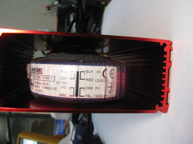

Then what to mount it in. I went with a Box Enclosures B3-160 case. The transformer data sheet specifies a minimum of 5mm clearance around the sides. This box gives it about 8mm. The long form factor of the box leaves plenty of room on the back for an IEC connector. Using an IEC connector it becomes an easy thing to switch cords to go from a UK plug to an EU plug - or in my case an US power plug to use for 60Hz testing.

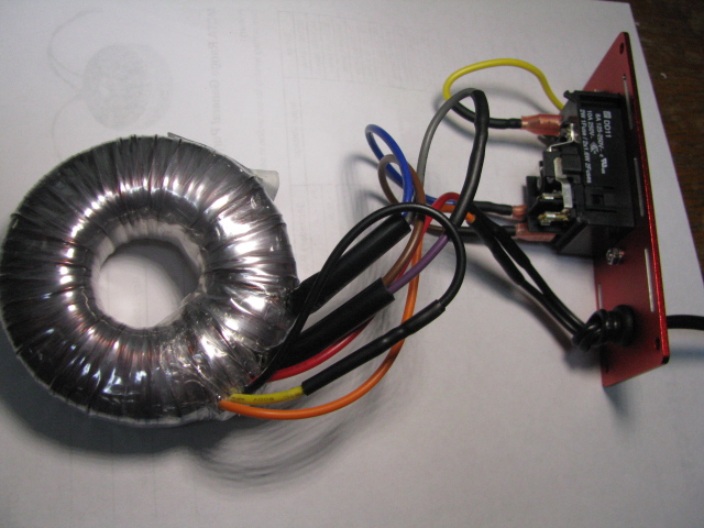

I used an IEC jack by Shurter that includes a switch and fuses. I used a 2 pole jack because of my initial testing here in the states, where 230Vac is phase-phase and not phase-neutral. If you are assembling this in the UK/EU you could use just a single pole unit. The fuse drawer and the fuses in this jack all have to be orderd separately. The jack is Mouser #693-DD11.0121.1110, or Allied #70080287 (Allied sells the B3-160 cases, so you can get both at the same time). The fuseholder is Mouser #693-4301.1401 or Allied #70080677. The fuses are the 5x20mm size, Mouser #693-2010.0021 (2.5A slow blow) or Allied #70160339 (2A slow blow). Tip on the fuses - get the Shurter fuses, they are only 60 cents or so each. For some reason the major brand like Buss in 5x20 slow blow was like $6 each!
The particular power cord involved also has an embedded fuse, but hey you can never be too safe! 🙂 The US cords are also not fused. I have to say I'm just in love with UK/EU power parts!! Geezzz, our 120Vac here just isn't enough for large space heaters and such without going to enormous plugs made for clothes driers at 230Vac. The 120Vac plugs here are relatively tiny and are easily knocked loose from the socket. Gravity always wins over time if a larger wall power transformer is involved. The UK/EU plugs are fantastic IMHO from a physical standpoint. I wish we had EU/UK power in the US!!

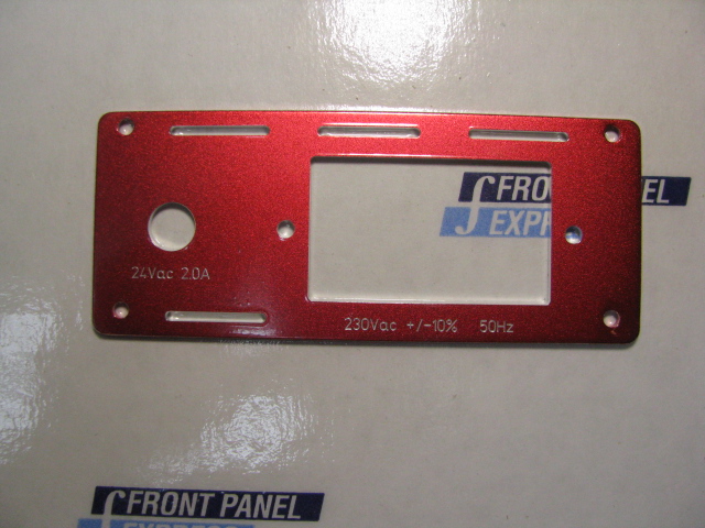

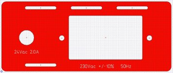

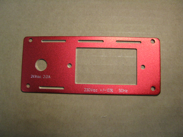

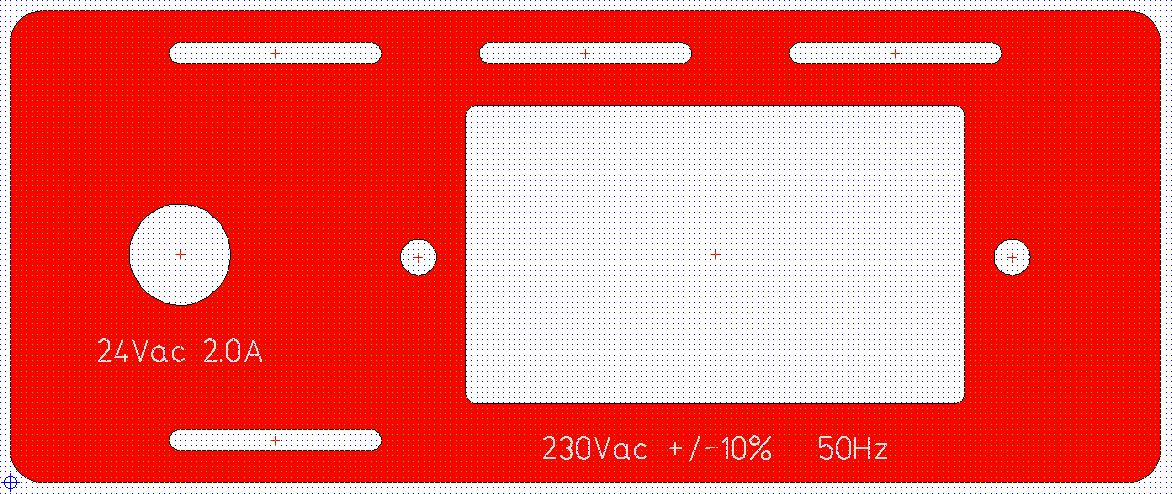

The rear panel on this was drilled out and engraved by Front Panel Express. I've included their .fpd cad file below. In this case the blank pre-colored panel from the case was sent to FPE to use, so the CAD drawing does not include the four mounting holes at the corners. I put the slots on the top and bottom for ventilation.

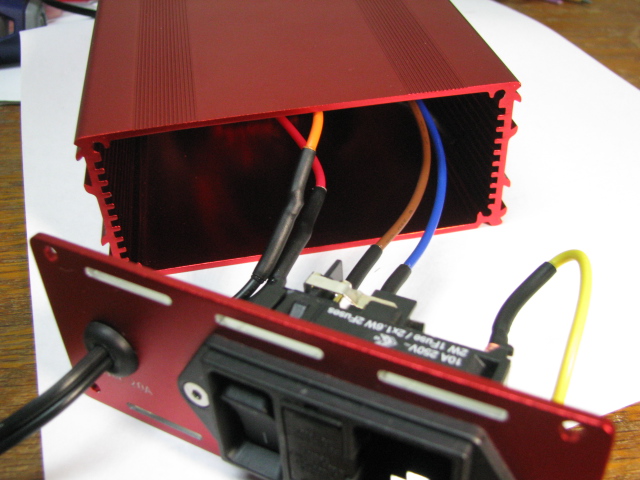

Photos are below:
* 3375 shows the IEC jack wired to the transformer and 2.1mm/5/5mm power barrel cable cord. That is double wall heat shrink over the wire-to-wire solder connections and the Faston connectors. The Shurter jacks use the harder-to-find 0.186 wide (and thick, there is also a thin) Faston - something else worth getting from Mouser since you probably won't be able to find it on the shelf anywhere. The loopbacks putting the two primary windings in series for 230Vac and the two secondardy winding in series for 24Vac are just done with solder and heat shrink.
* #3376 shows the clearance around the transformer. It comes with the typical rubber pads for top and bottom, mounting bolt, metal cap and nut. The challenging part was getting the nut and a lockwasher to stay put while threading the bolt, since you really can't get a finger or pliers in that small space on top. 😱 I eventually discovered that a piece of duct tape (what else? 🙂) over the nut and washer works miracles for holding them to the plate while threading the bolt.
* #3377 shows that there is plenty of space left in the B3-080 case for the IEC and output cable wiring. BTW, if you are using the 2x 9Vac 2A transformer for the standard O2 +/-12.5 Vdc rail build, it might fit in the less-tall B2-160 case. I just had a quick look at it along the way, you would have to take a closer look at the dimensions to be sure. Those mounting bolts on the IEC connector are flat heat metric M3 stainless steel hardware from boltdepot.com.

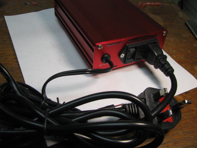

* 3378 & 3379 show the back panel attached to the case and cord plugged in. Push hard! At first I thought the cord was bad it was so loose in the IEC socket. But then I realized I just hadn't pushed it in hard enough. Nice tight solid fit. The grommet for the 24Vac cord is a Keystone 735, Mouser #534-735.

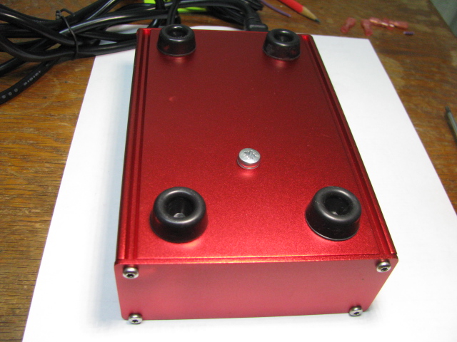

* 3380 & 3381 show the front and bottom. Those rubber feet are the same adhesive backed one in the ODA hardware kit.
* The next photo is a screen grab of the panel from the .fpd CAD file. Remember you can download the Front Panel Designer program for free (to read this file) at the Front Panel Express website.
* The next two are the panel back from FPE, and the final is just the parts laid out.

Oh that is right you did! I completely forgot about that. 😱 It really did come out looking sharp. Hopefully louiebh will post some pictures. He did a custom engraving on the front panel which came out looking great, then added a graphic to the top of the case.
Looks like I somehow didn't post the picture of the bottom of the transformer box in the post above. Here it is.
