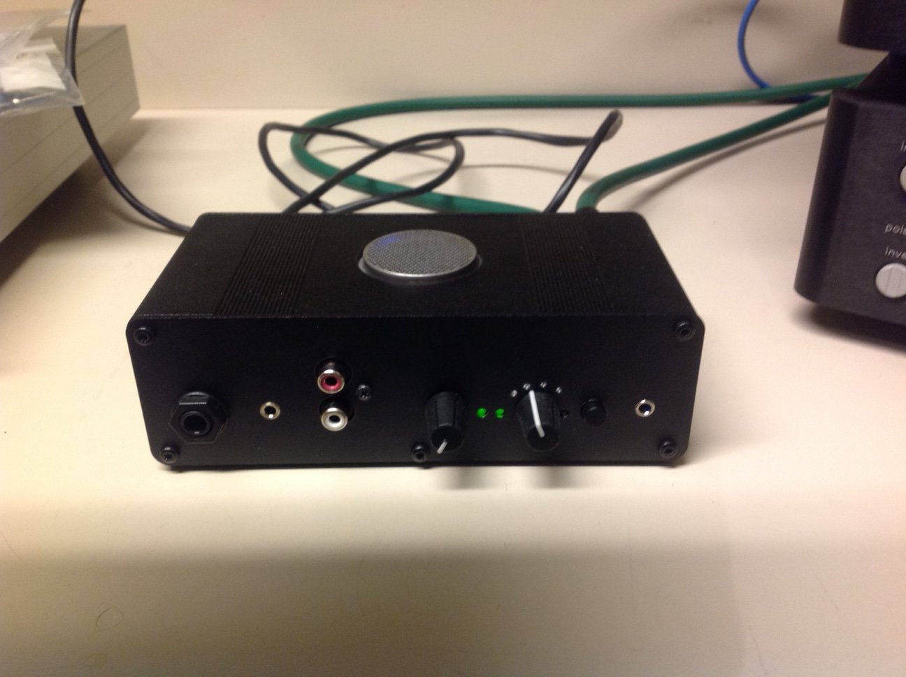

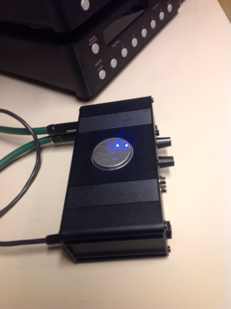

My ODA is completed, case and all. I added my own touch. I thought that the internal blue leds were just too nice to hide, and I added a top window on top 😀 That even help for the internal ventilation, not that it was needed but it is nice...

I'm curious, how did you make that nice top hole? I'm not sure how I would go about one that big. Maybe drill a center hole big enough for a thin saber saw blade, then cut around a scribed circle? I have some hole punches with a threaded bolt in the center, but none are that large.
That window is looks great. Those two blue LEDs are used as voltage references for the clipping circuit's window comparator. I was originally going to replace the LEDs with zeners, but the LEDs looked too cool to do away with. What I did instead is swap the original narrow 40 degree lens one for the current wide dispersion 130 degree lens.
Interesting! I looked around a bit today and sure enough, there are small hole saws in the stores. When I think of a hole saw I typically think of something 5 or 8 inches in diameter for recessed ceiling lighting. Well good to know! That certainly produced a nice round hole.
