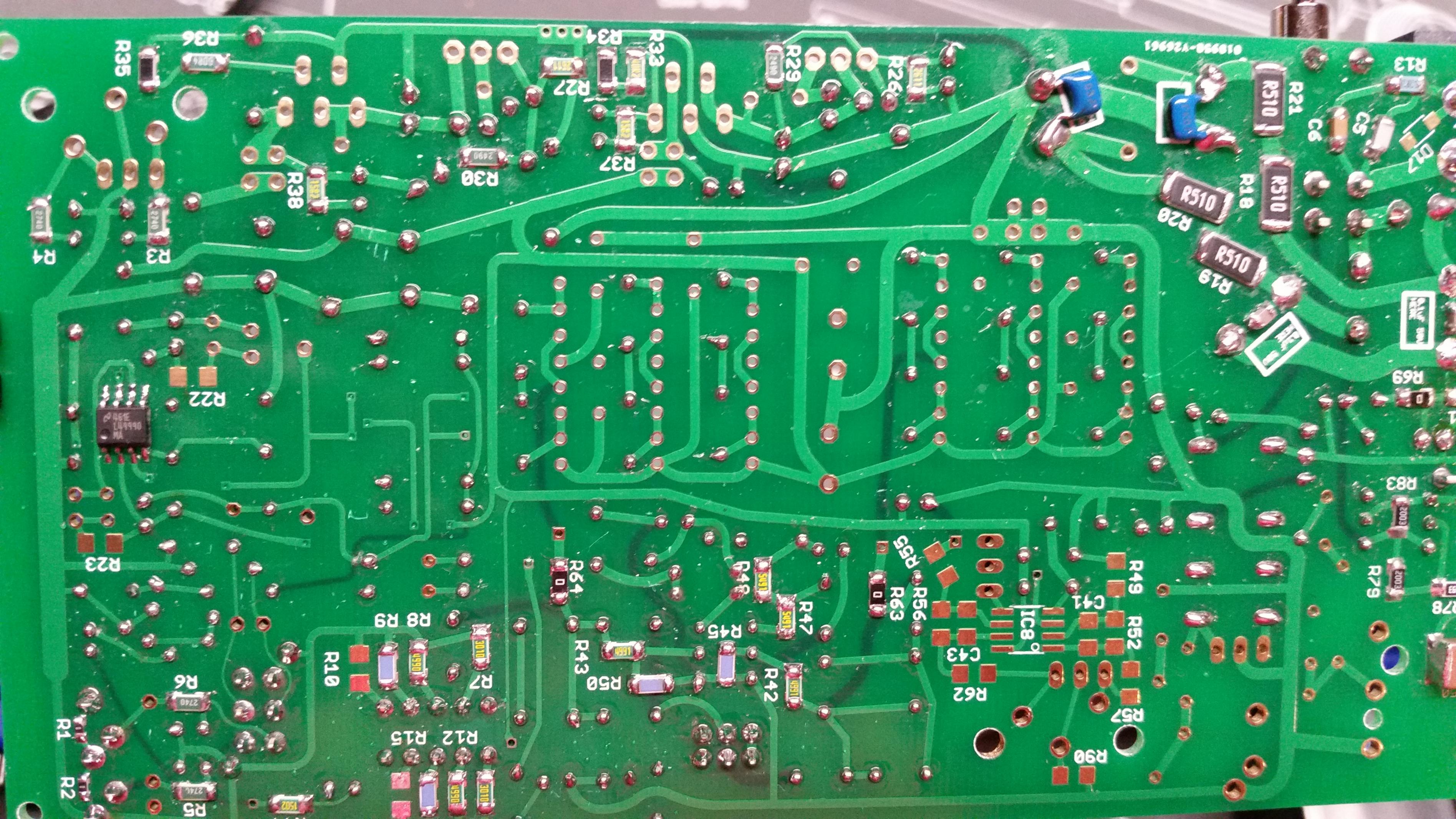

Also just finished step #6, as always pics below.
Those trimmer resistors were a PITA!!! Hard to keep the DMM on the leads without slipping off while the measurement is taken. Also I wasn't very sure how sensitive the screws were and also didn't know what direction I needed to turn, so it took me a minute to figure out that a bunch of turns make little difference. And didn't know that they adjust opposite of each other as in turning clockwise makes the right post go up in ohms and the left post go down in resistance, so that was a little weird as well when you're not expecting it.
Finally, fixed the R15 / R50 flip-flop (you can see my R15 pads will be silver from now on 🙂)
The panel DPDT switch I went with to toggle the pre-amp and headphone outputs was part number 611-SF2UEE from Mouser. Wanted to stay with c&k since the input push-button switch is from that company and the buttons should be very similar in color/shape. The buttons are a little different in size but its very little difference (the panel mounted one has a larger button).
I can see where ordering parts in batches like that would help! The parts shipping cost - here in the states anyway - is kind of a drop in the bucket vs. the total anyway. That saves having to wade through a big pile of parts all at once.
For some reason I always had a toggle switch in my head for the panel mount, but I have to agree the push button switch will probably look more professional. It will also take up less X and Y axis space on the panel by making good use of the depth available. I like it! Those are nice switches. I bought one of those series, a 4PDT I think it was, for the rear power switch on my "O3" project.
Yeah those trimmer leads are really thin and like to slip through meter aligator clips. I should add some more words about that in the build instructions. A good way to do it is use mini hook clips like Mouser #565-3781-36-2 (or Radio Shack 278-016 if you have one nearby that hasn't gone belly-up yet). Hook one end on the trimmer lead, then on the other end hook it on a scrap of 20 AWG or larger wire that the meter aligator clip can also get hold of properly.

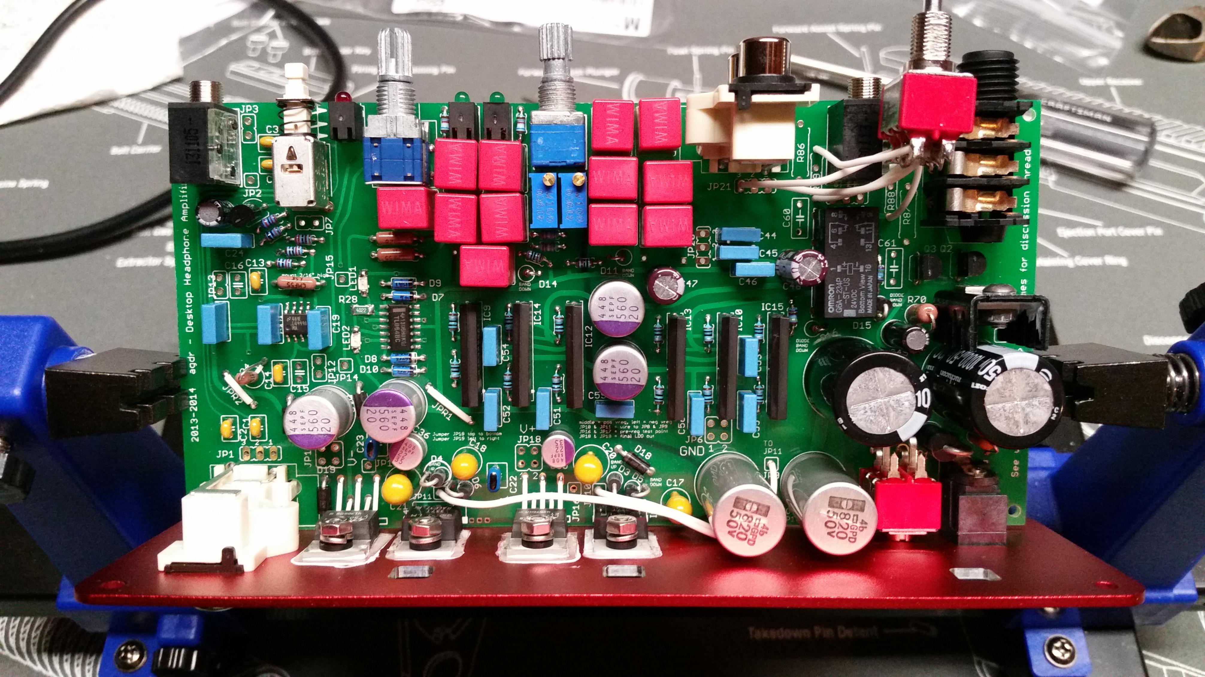

Build update:
Step 7 done; pics below. This thing is starting to look like a finished product. 🙂
Looks great! 🙂 Excellent work.
I've been wondering why jpr1 and jpr2 were not in yet in the last few photos, I figured that I must have left installing those to later in the build instructions for some reason. I thought the white line I was seeing was the PC board silk screen marking. I just realized that is the white jacket of the teflon wire! 😱

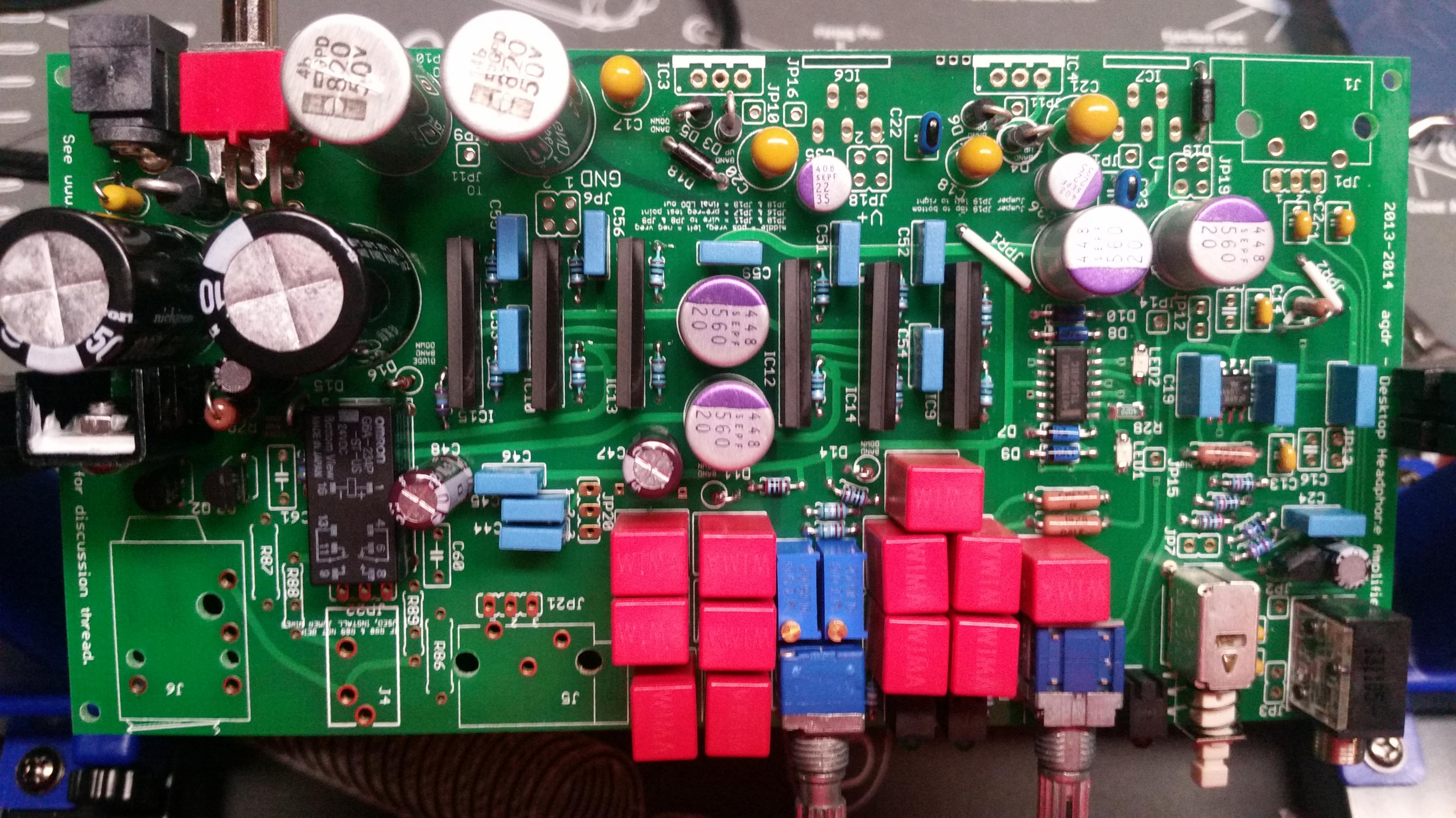

I finished my build this last weekend! Powered it up, did the voltage checks, then hooked it up to my iphone and a pair of vintage Grado 325's (yes I did check with a cheap pair of headphones first) and it came to life with no problems -- sounds great!
The only problem I am having now is that it did not seem to fit in the chassis properly. It is like the case is too deep front to back, so that the front panel switches do not stick through the front panel far enough to get the nuts threaded on. Everything lines up OK, just that the board needs to come forward a little bit, but it cannot because it is bolted to the rear panel. At the rear, the circuit board is touching the rear panel, but I can see that there could be some tolerance there depending on how the rear heat-sinked components are tilted -- a little forward or backwards.
Any ideas from anybody on how to fix that fit issue? I did not spend a lot of time looking at it yet, but the quick thoughts were that either: 1) try to move the circuit board forward a mm or so by gently flexing the heatsinked component leads; or 2) file down the case a few mm's.
Hey that is great news your build is working! Congratulations! 🙂
Interesting problem you have run into with the case. All of those V2.1 PC boards are from the same run and the whole stack is the same size. I just tried a board on two B4-080 cases I have here and it just exactly fits in both. Somehow your case must have been out of spec. You probably got the case at Newark or Allied Electronics. I would suggest sending them an email about. I know that Mouser at least is good about sending out replacements for defective stuff at no charge.
But in the meantime, yes that is OK to just bend the regulator leads out (forward) a little as needed. Just as long as the regulator bodies stay bolted flat to the back panel you are OK. The board really does need to come all the way flush with the front panel to get that nut on the 3.5mm input jack, which in turn does the single point ground of the chassis to the input ground.
Alternatively though you could do it exactly like NwAvGuy did with the O2 and just solder a wire to that input jack ground pin, then run the other end around the corner case screw. In that case that 3.5mm jack nut could be left off. All of the front panel jacks and switches are firmly mounted on the PC board. No mechanical need for any to be flush with the front (other than the input jack nut for that grounding issue).

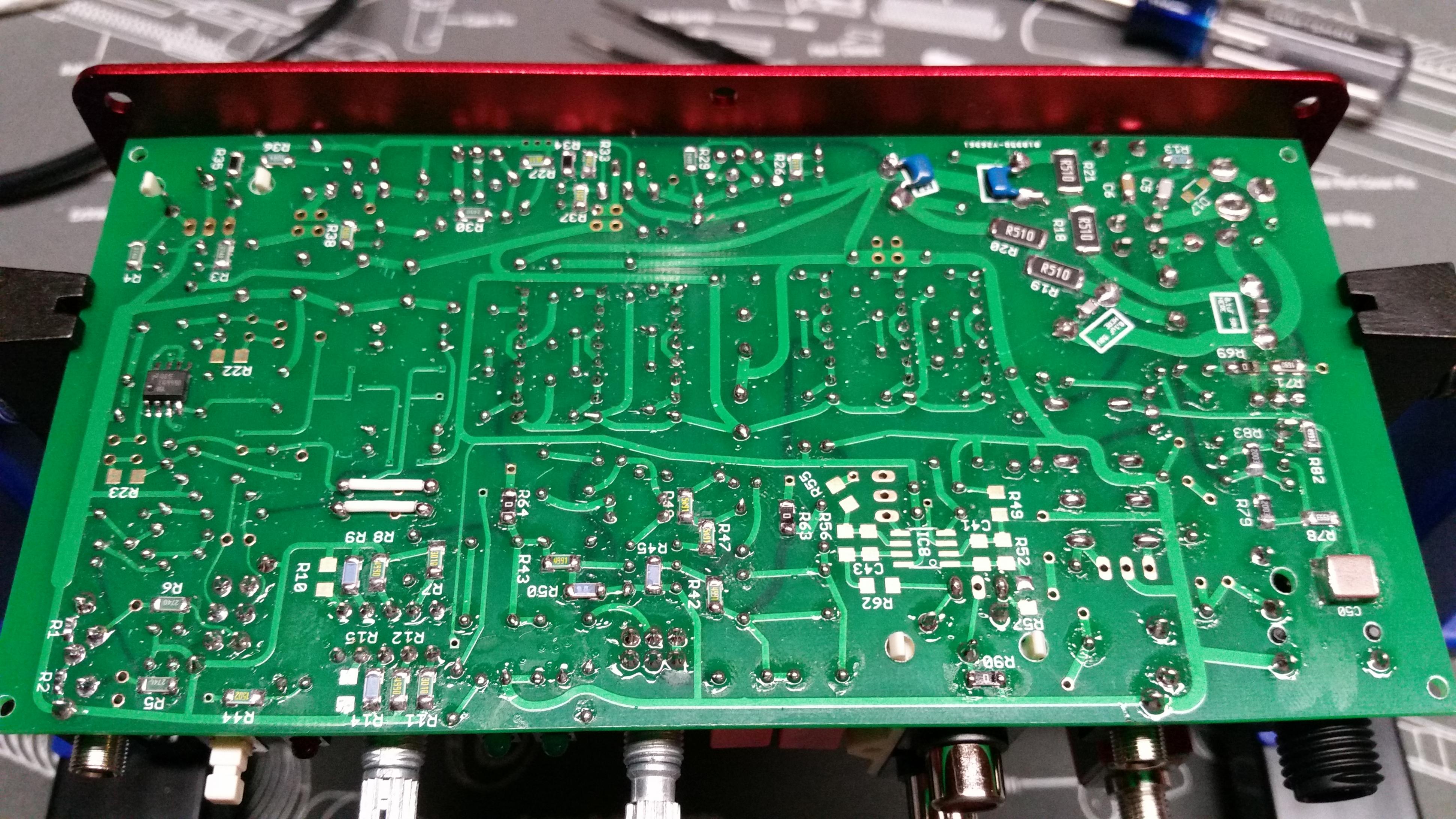

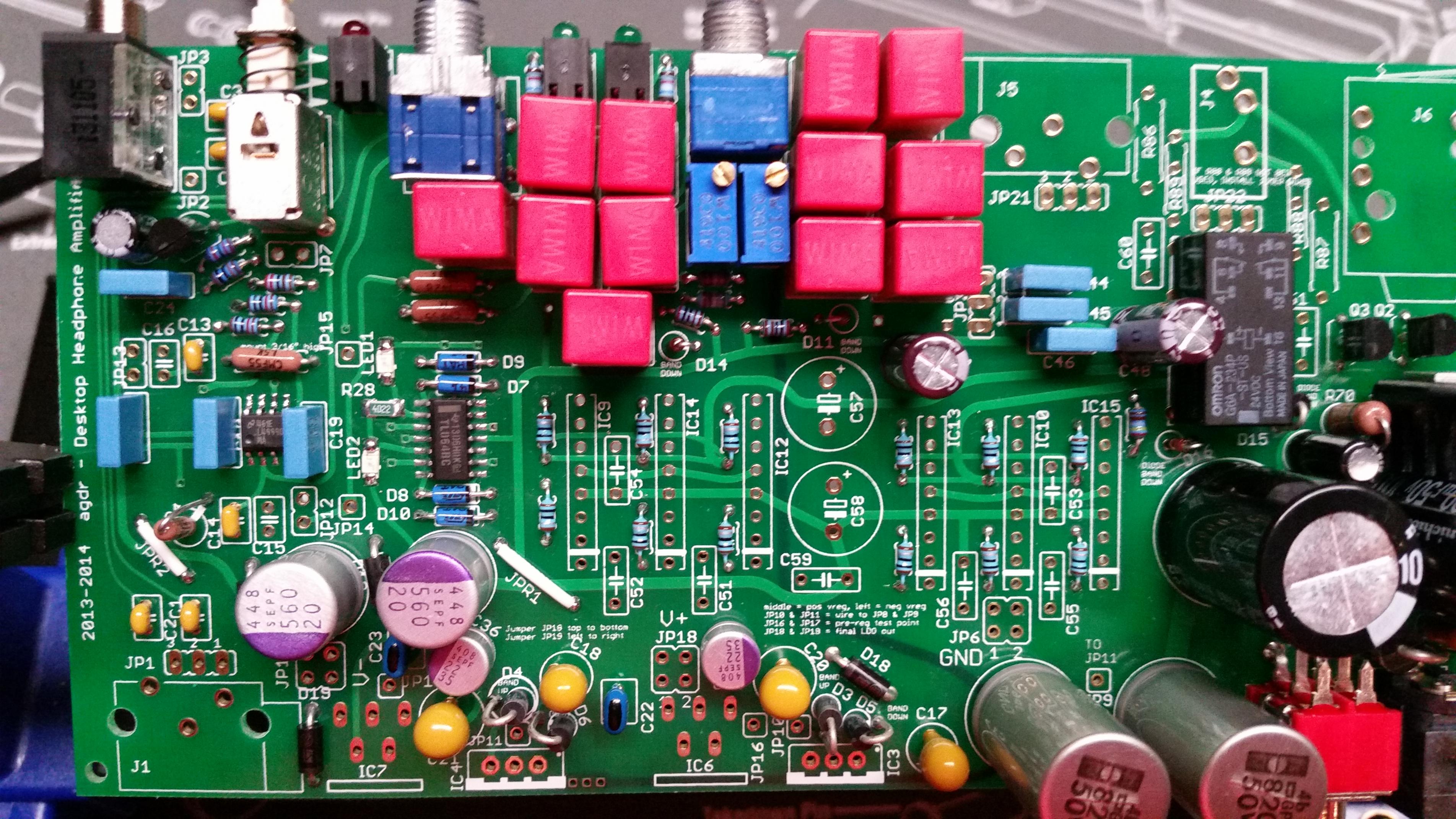

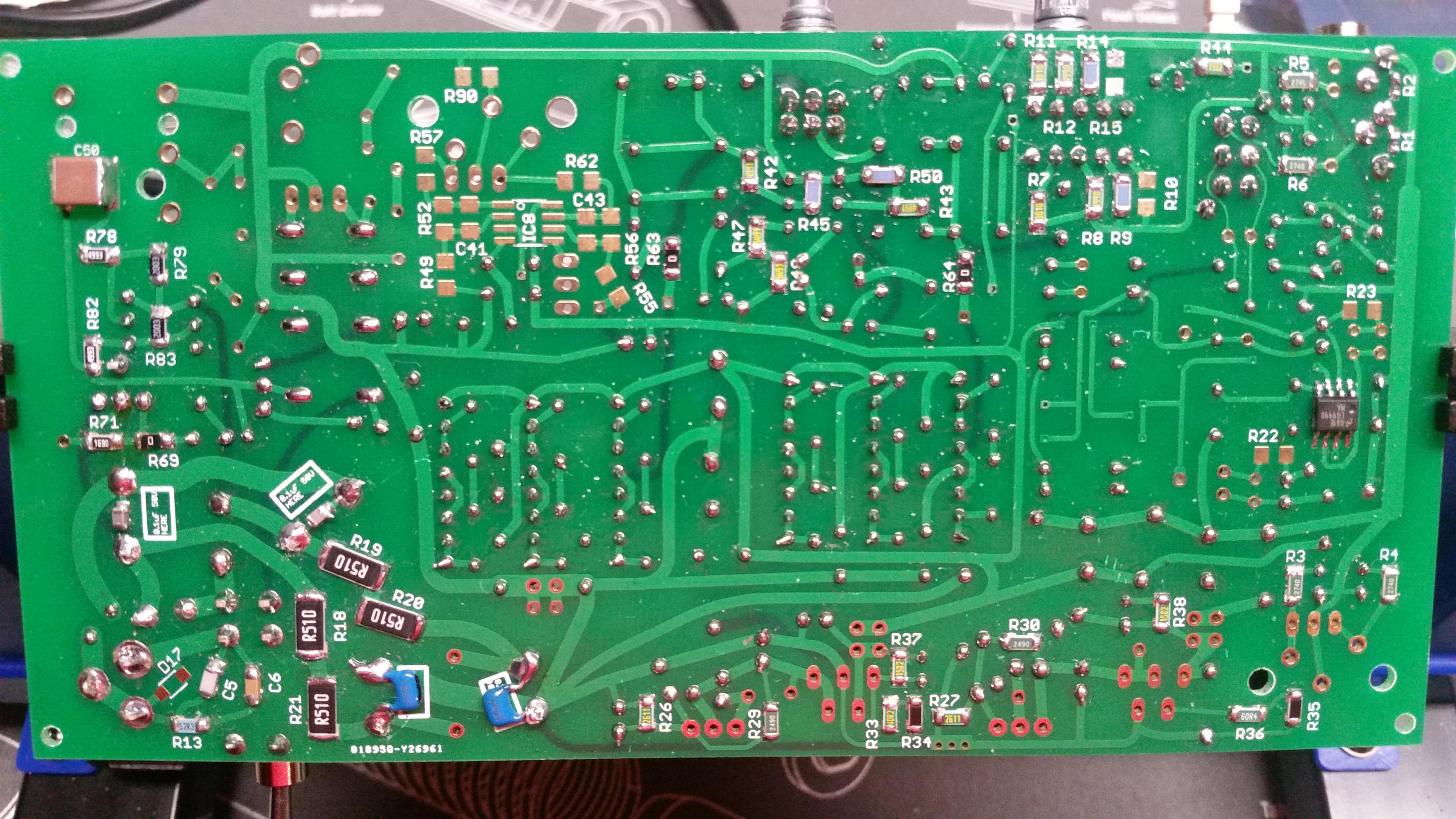

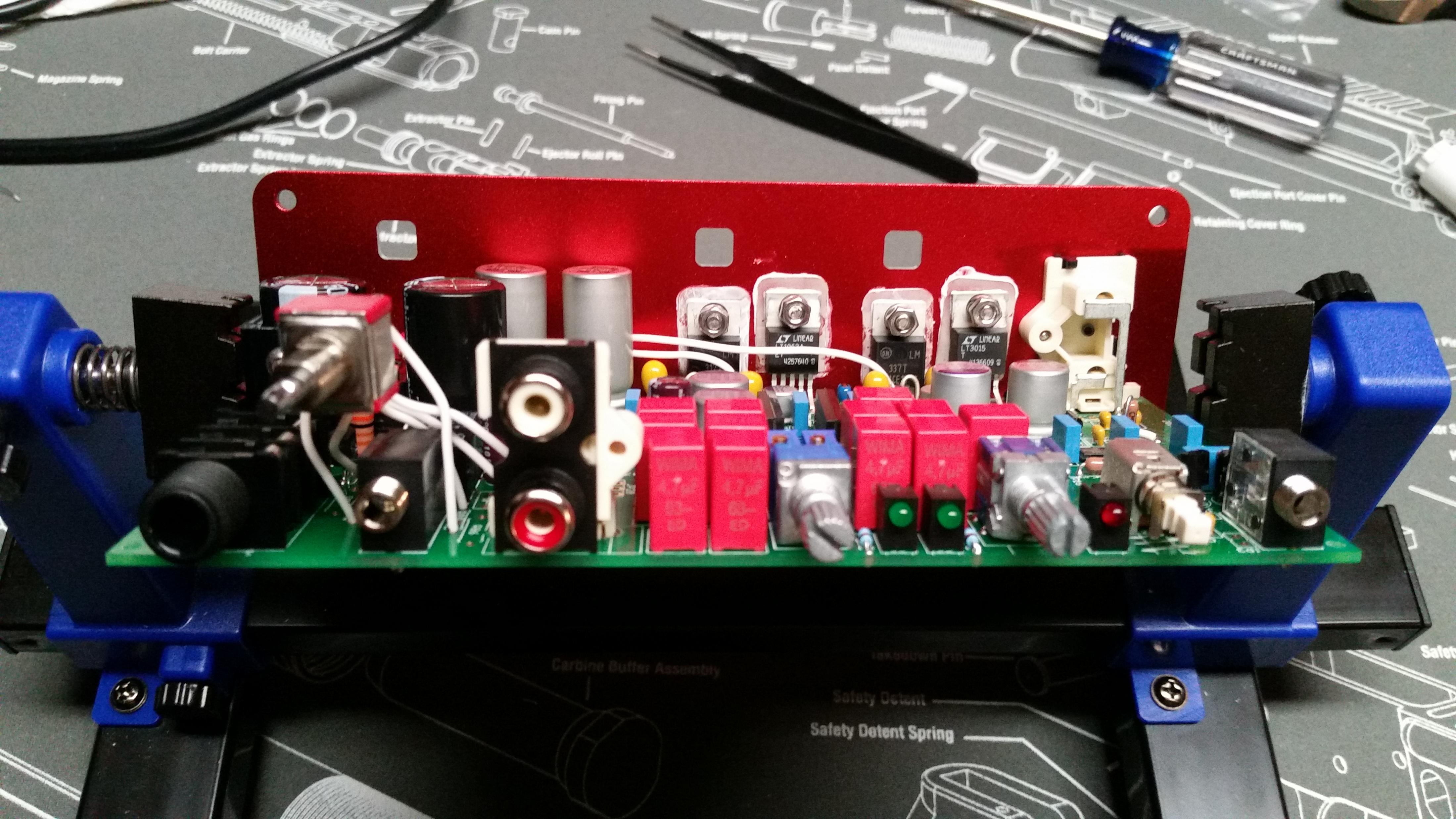

Build Update:
Steps 8, 9, and 10 done. Pics below.
On the bottom of the board, you can see I jumper-ed across attenuation resistors (R31 and R32). I want to start out at full power, and if I don't need the full voltage swing, I'll remove the jumpers to decrease each gain stage by 1/2 and put it back to how it was before. (This was suggested by agdr a few posts ago).
I also posted a pic of the panels as they came back from Front Panel Express. The quality on the etching and cuts is phenomenal. There's a plastic film on them which reflected weird in the photos (the white-ish spots), the panels came back with no scratches. For anyone curious, these are the red panels from the box enclosure with a grey letter filling... probably should have just left them with no fill and saved a couple bucks. I wanted a pic before I ruin these by drilling my own hole for an extra push button DPDT. 🙄
Speaking of the extra push button DPDT, you can see it in the overhead view where all the white wires are near the front. And in the front view, it is the upper left thing just "floating" in the air not attached to the board. It seams this switch is going to work out really well and mount in the upper left of the front panel.
Tomorrow is testing; for now... sleep 🙂
