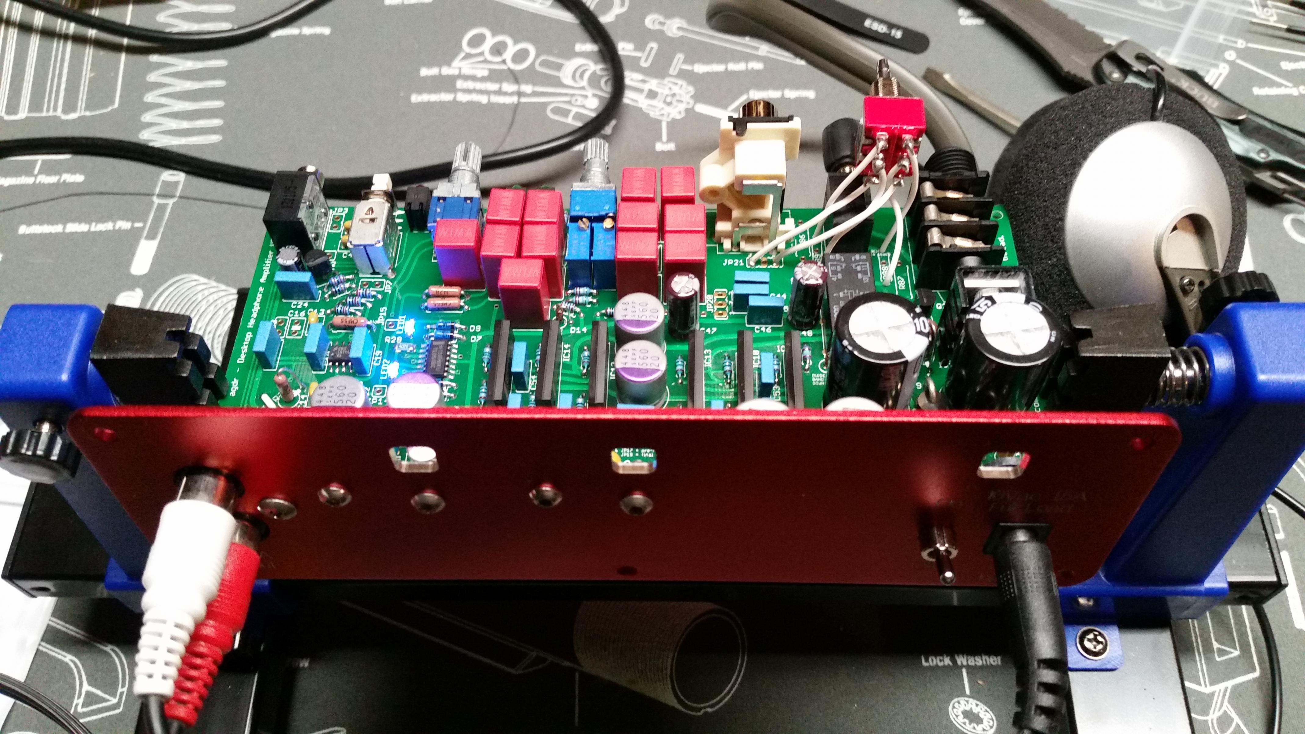

Hey I see one thing I would suggest doing. The bolts holding the 4 voltage regulators onto the rear panel could be tightened some more. In your photo I can see the lock washers are still mostly expanded. When the bolts are tightened down all the way those washers will be pretty much mashed flat. That will give you the best thermal transfer to the panel. After you do that though it would be a good idea to repeat that step of doing an ohm meter reading from the tab of each regulator to the panel to make sure it is a much higher reading than dead short (10,000 to over a million ohms, etc). The inside machined surface of any of the top vent holes is a good place to measure to since the insulating anodization has been removed. The measurement just makes sure the mica insulators are still doing their thing.

Yeah I only have those "hand tight". I misplaced my tiny needle nose pliers and didn't feel like looking for them and it was getting late last night, so stopped for the day. I did a preliminary test and all 4 chips are fully insulated (DM measuring infinite resistance) but I will check again after I tighten them down.

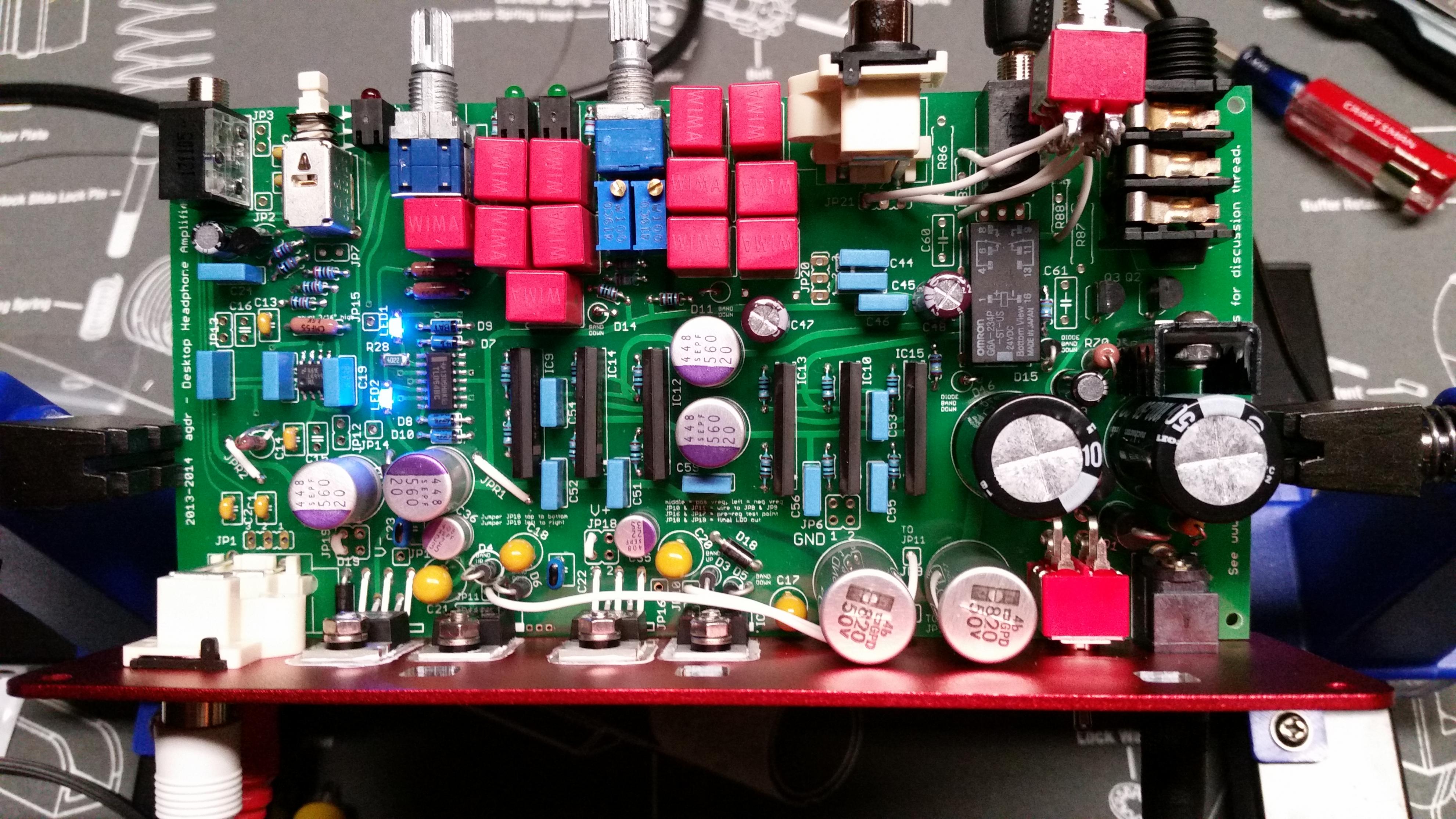

I should probably explain more of what I did for anyone that may attempt this build and use my pics as reference:
Step 8 - instead of using jumpers for R88 and R89 (which the directions call for), I put in a DPDT switch that takes as input R88 and R89 and the output goes to one of two places - [other side of R88 and R89] or to [JP21 pin 1 and pin 3]. When the switch is in one position it will act just like a jumper across R88 and R89 and when the switch is in the other position, it will give the output to the front panel pre-amp rca jacks. Everything else was done as described in the instructions.
Step 9) Because of the switch explained above, I did not install any of the preamp parts other than R90 which provides ground to the preamp rca jacks.
Step 10) Normal.

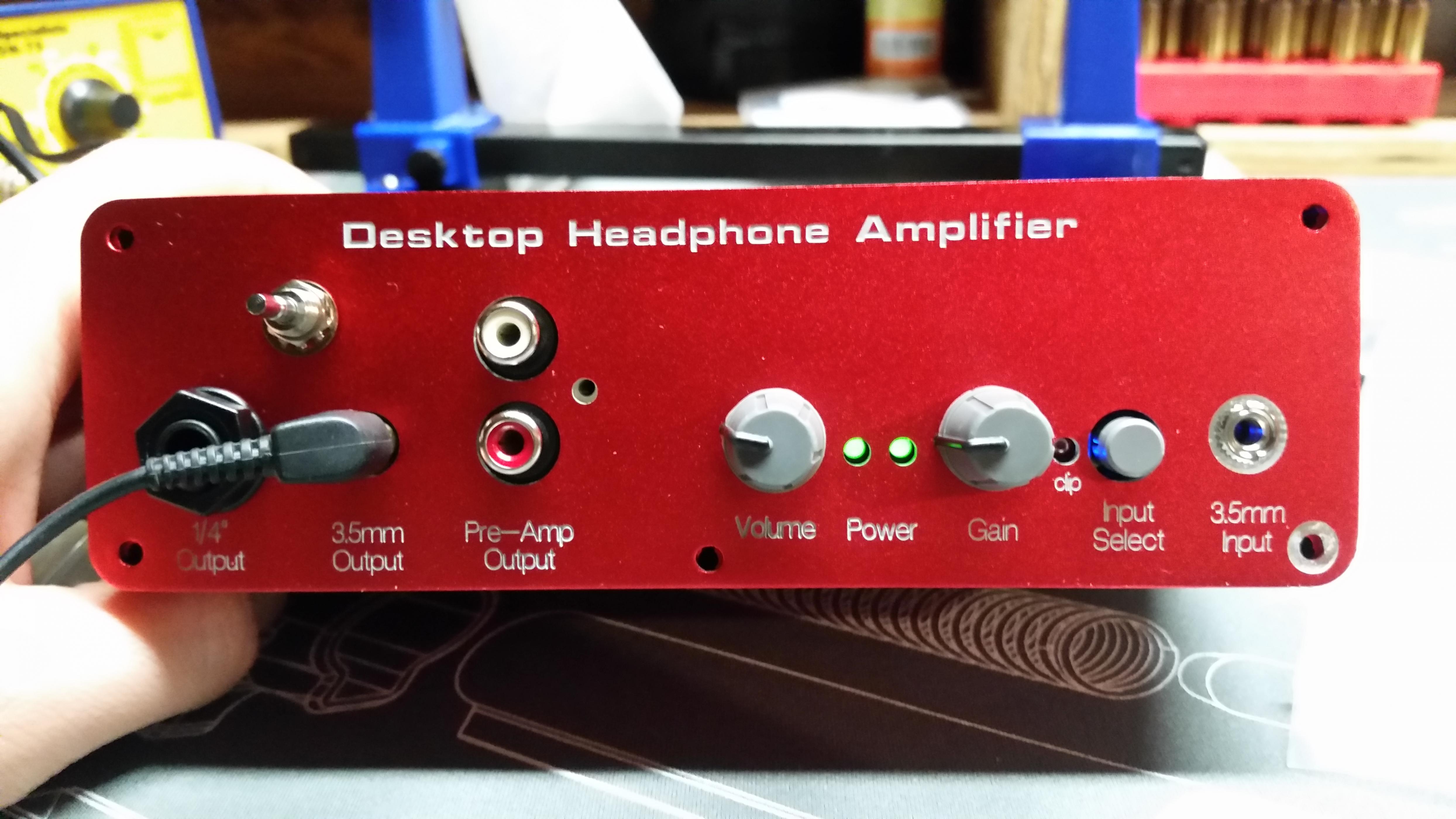

The reason for the switch is that I want to control the volume on a pair of powered speakers with the preamp output or listen to headphones with only one volume knob on the ODA. I don't want to unplug the headphones or speakers depending on what I am doing on my computer. I will simply have to push a button and pay attention to the gain when switching between the two. 🙂

IT'S ALIVE!!!... (cue evil sounding music)... IT'S ALIVE!!!!!
All the measurements tested well and plugged in my cheap throw-away phones (you can see them in the second pic and its even missing some plastic trim on the right side lol). And... there's sound. 😱
But seriously, the amp sounds good on the crap headphones. They are pretty sensitive and with no source playing, I can hear only a little hiss when the volume is all the way up on the 1x (lowest) gain. It goes away on any of the higher gain settings. I also double checked that music does get louder as you go clockwise on the gain knob so its not like I flip-flopped something. This seems kind of counter-intuitive to me as the hiss "should" get louder as the volume goes up.
About the build...my drilling of the extra hole turned out pretty well... not as good as the FPE laser cut holes, but definitely doesn't stick out as bad and I think if I didn't tell anyone, they would not notice. The 3.5mm input jack stuck out far enough for me to get about 1.5 rotations of the nut. I did have to kind of squeeze the front and back panels together to get the nut on; just laying there it didn't exactly stick out the hole. I think it would be a good idea to move it forward just a bit if not too complicated of a layout change.

Is it normal to have a little hiss at the lowest gain and max volume? (If there was actually music playing, there would be no way to hear this)
My negative voltage did measure a little lower than my positive +12.48 and -12.40, I assume these are within spec but is it normal for the negative to be that much lower?
Finally, is it "safe" to use my good headphones or should I do a few hours of listening with the throw-away ones? (I've only listened to 2 songs so far, but the amp has been on for about an hour while testing)

I'll bet I know what the hiss is. 🙂 It looks like you are using the rear RCA jacks for input. Change your input select switch to the front panel 3.5mm jack and leave that jack with nothing connected. Is the hiss still there? The 3.5mm jack automatically grounds itself when nothing is plugged in, just as with the O2. But not so for the rear RCA jacks. When nothing is plugged in, or if a cable is plugged into but there is no signal, there is nothing to ground the jack and you may hear hiss. This is true with any RCA jack device. To ground an RCA jack there are RCA shorting plugs that can be plugged into the jack, or at the end of an unconnected cable. Once the source device is powered up through the issue goes away since the RCA inputs are no longer floating.
You are right though, in general hiss should get louder as the gain goes up. If that test above doesn't solve it please let me know if the hiss is in just one channel or both, and if both is it about equal. Also let me know the impedance and sensitivity of your test phones (or manufacturer and model number).
Those voltage readings are OK. For amps it is more common to read something like +12.7 and -12.2. To have variation out on the second decimal place is really a close match. But... I designed it specifically so you can get that just as close as you want! 😀 That is what R33 and R36 are for, the small value 40.2R and 60.4R resistors in series with the main 1.65K set resistors. You can increase or decrease those as you wish to get the rail voltage just as close as you want. So for example with the 40.2R you could go to 39.7R or 41.2R - both in stock at mouser for 1206 SMD thin film. But electrically it really won't make a hill of beans difference. All that happens is at the very highest volume levels the output wave will hit one power supply rail 0.08V before it clips on the other. It would even be hard to see that much difference if you were feeding in a sine wave and watching the output on a scope.
Why you get a voltage rail difference at all is the +/- tolerance of the voltage source built into the regulator chips. Because of that there will always be some reference voltage variation between regulator chips, so a given set of "set" resistors like this will always yeild slightly different output voltages. If you were to try 5 different LT3015s for example you would get 5 slightly different rail voltages. The variation is small though, and if a closer match is needed the best solution is the above to just move the set resistor values up or down a tiny amount as needed. 🙂

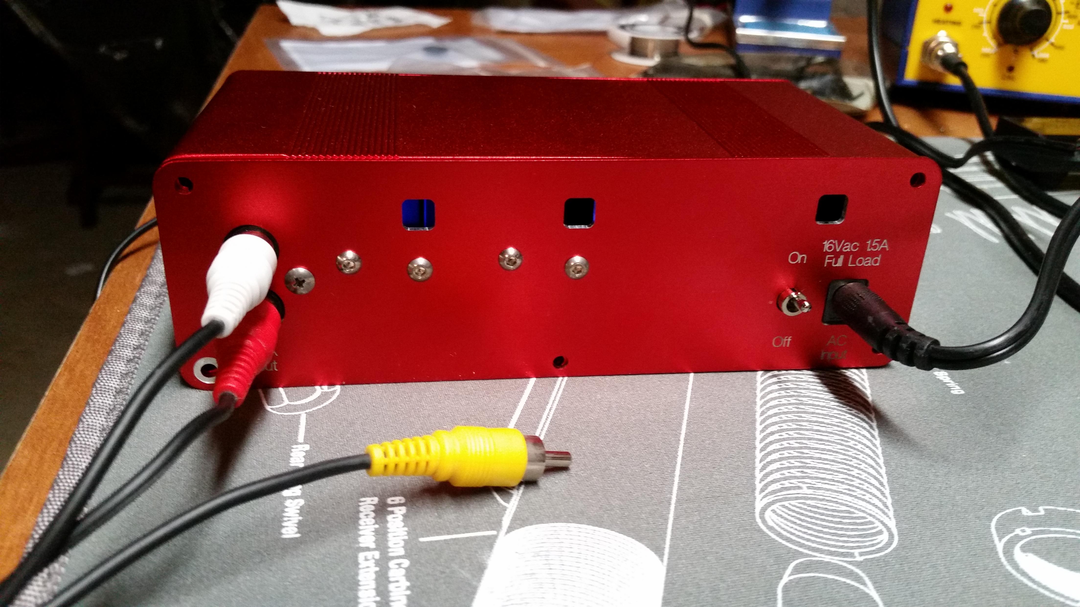

But I did have one problem... those screws that come for the front and rear panels are cheap. The screw head in the upper right of the front snapped off before it even made contact with the panel. Now I have a stuck screw shaft in the enclosure. Not a big deal but cosmetically it hurts. My drill was even set to low speed and torque; and I wasn't even using full speed of the low setting.

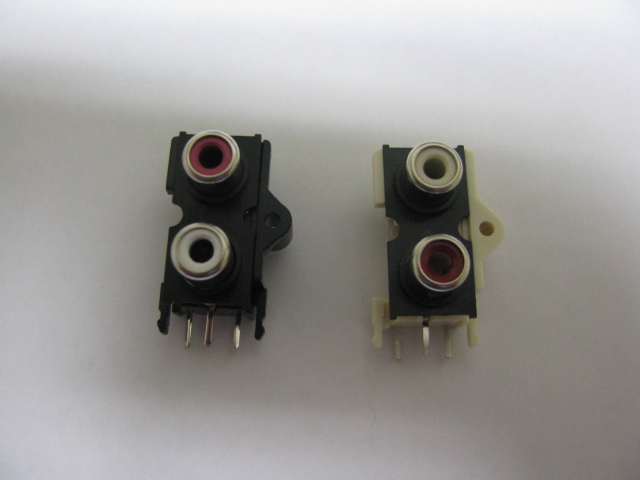

Edit - OK just found my first problem... when using the RCA input on the back, the left and right channels are flip-flopped. If I use the 3.5mm input on the front, everything is good... how in the hell was I able to do this? Have to start going back over my photos to see if I can find a mistake. (I triple checked the cord and even tried 2 different RCA cords, both with same result)
Is (hopefully) enough of the broken screw sticking out to get a pair of lockjaw pliers on it and twist it back out? I have a bunch of those screws here in both black and silver. I'll send you out a couple of new ones. If there isn't enough of the screw shaft left to get lockjaws on I'm not sure what more could be done to get it out. The aluminum case would be softer than the screw so drilling it out wouldn't work. I think an argument could be made for a defective case there to Allied or Newark - worth a try at any rate!
I have noticed the screws get tight on their way in. Makes me wonder if some galling is going on between the aluminum and whatever the screw is made out of. I think I'll try getting some anti-seize compound for aluminum like this
Easy solution - swap those RCA jack inputs. 🙂 What colors does your RCA jack have on the top and bottom.? I believe the Kobiconn has different colors from the Switchcraft. I don't think there is anything you could do in the build to swap channels. Hmm... I just looked at the BOM and I don't see the Switchcraft listed as an alternate. I'll look into that. Mouser was out of stock of the Kobicon for quite a while and the switchcraft was an exact duplicate, at Digikey.
No nothing sticking out to grab with pliers. I have some interesting backing out tools around here for broken bolts in cars, but will have to check to see if I have anything small enough for this.
Definitely, I bought it from allied so I'll contact them to see what they say.

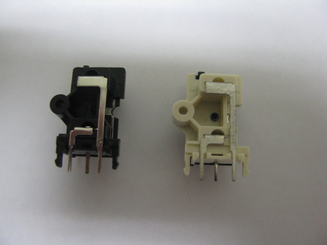

Yep, swapping the inputs was the first thing I did. I bought the Kobiconn ones and they are red on bottom and white on top. I was looking at the schematic and I think I found the problem... If you look at one of my photos where you can see the rca jack on the backside, the side of the jack closest to the side of the enclosure goes to the top and the one toward the middle of the board goes to the bottom jack. This makes JP1 pin3 (closer to side of enclose) go to the top (white) and JP1 pin 1 go to the bottom (red). The schematic says the opposite about JP1. So I bet even though the Kobiconn and the Switchcraft have red and white in the same positions bottom and top, they wire them up different on the back of the jack.
You can see all this really well if you zoom in on post 760 second pic. The top view here shows the connectivity on the back of the rca going to the board and JP1 labels.
Red and white colors swapped on Mouser vs. Digikey RCA jacks
Well look what I just discovered, below. The black plastic one on the left is the CUI (I was wrong about it being Switchcraft) from Digikey while the white plastic one on the right is the Kobiconn from Mouser. Hmmm... now what is wrong with this picture.. 😛
Turns out these are both the ones I have in the BOM right now for the RCA jack in the Mouser and Digikey columns. They are identical from a physical size and mechanical mounting footprint standpoint. In the second photo it shows they are wired the same in terms of which PC hole the top RCA goes to. The colors are just switched. Thanks goes out to 4x4F150 for the discovery!
I just did a bunch of Google searches on the whole thing. It sounds like there really isn't a strong standard here. I've just looked at the TV and a few other devices around and they all have red for the right channel, but some of the reading says that white has been used for right too.
Luckily Digkey offers USPS shipping unlike Mouser, which is fairly cheap, if you want to swap jacks. I also have those CUIs I'll sell to anyone working on the ODA at cost ($1.67 plus postage) if you want to switch jack colors - just send me a PM. 🙂 The good news is the jacks should come out fairly easily with solder wick since the holes are large. You can snip those two plastic lock tabs that go through the PC board off with wire cutters. For that matter can probably snip the leads off too on the top of the board, then just unsolder the remains from the holes.

Digikey RCA jack is red for right channel, Mouser is white
I traced out the wiring today. Using the standard TRS jack "ring for right channel" the Digikey CUI-brand RCA jack gives red for the right channel and white for left. The Mouser Kobiconn-brand RCA jack gives white for the right channel and red for left.
The LT regulators already have to come from Digikey. I've been keeping those on hand here too so folks don't have to place a separate Digikey order. I'll do the same with these jacks going forward. If anyone who has built an ODA wants the Digikey jacks the shippiing is on me, just send me a PM. 🙂 I should have noticed this difference in jacks long ago and had a note in the BOM. I'll sell them at cost, the $1.67 each that Digikey charges.
Mystery solved 🙂 My "educated" guess on the problem was based on 2 assumptions, red was supposed to be on the bottom and red is supposed to be the right channel.
There really is no real "rule" here... I too have searched the internet and red being the right channel is nothing more than a suggestion that is followed by most.

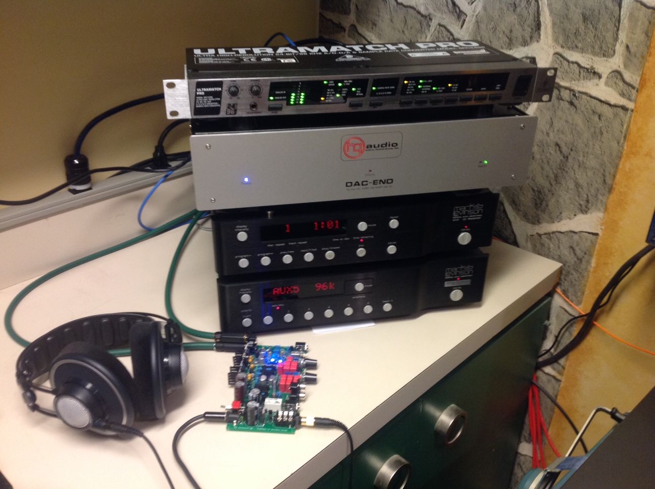

This is my main headphone and test dac rig with a Mark Levinson ML 37 transport, ML360S dac, Beringher rate converter and other dac AD1865 dac with tube output. I have currently two main headphone amps, PS Audio GCHA, balanced version, and my best, my own DIY version of the all discrete, all fet Borbely Class-A headphone amp. Single ended interconnect Furutech OCC and Furutech RCA connector. I know overkill 😎 but if the ODA sounds good with this kit, it is that good.
Well first impression is excellent, probably at least as good as the much more expensive PS Audio!
Right out of the bench the ODA is just great. I'm sure it can get just better with some burning.
Thanks again AGDR for such a great design and all your hard work with the 4-layers pcb design. I think it is a success 😀

Algar_emi - hey thanks for the listening feedback and the photos of your gear! That is always great to hear that the ODA is holding its own vs. a much more expensive amp.
