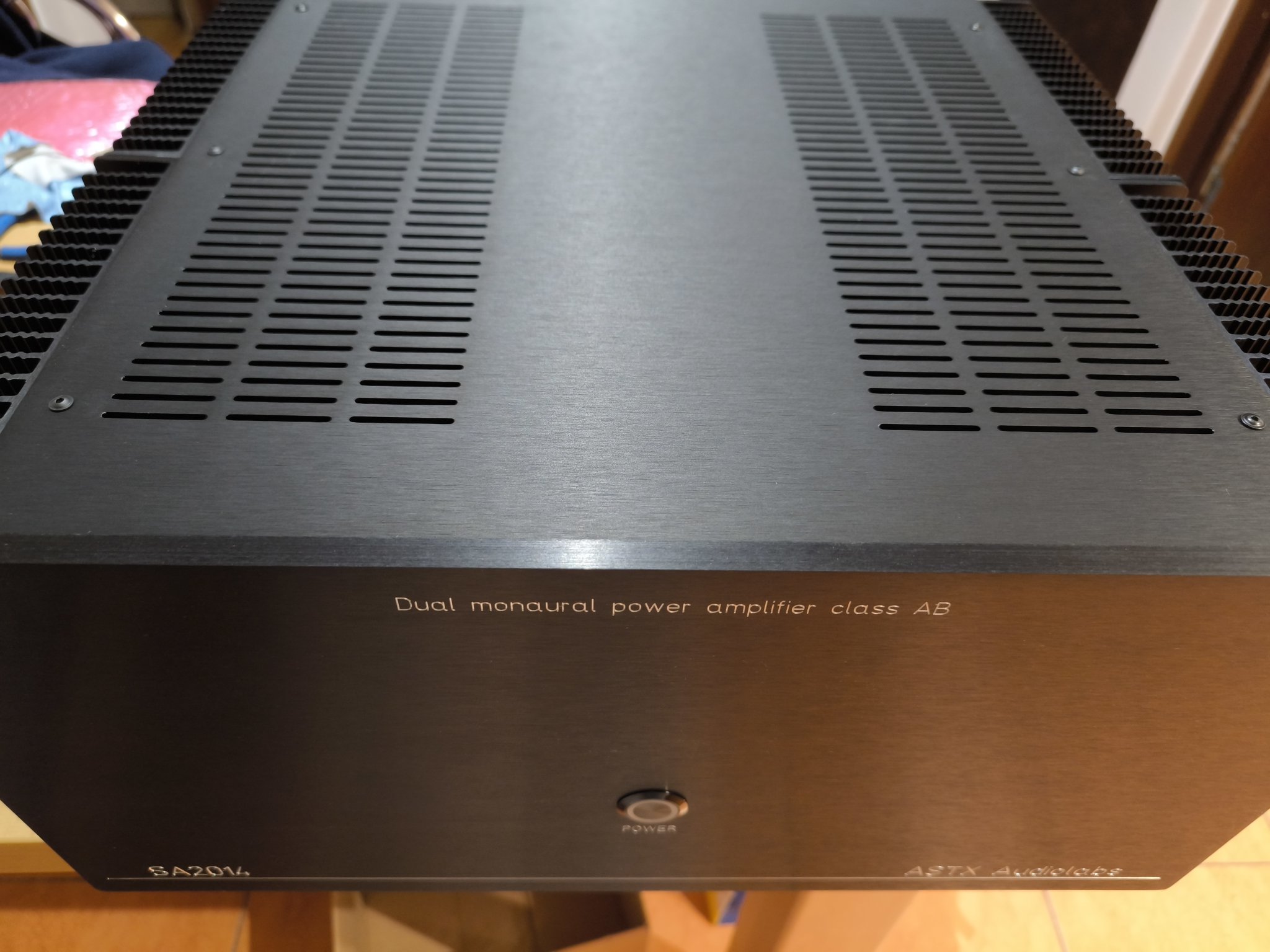

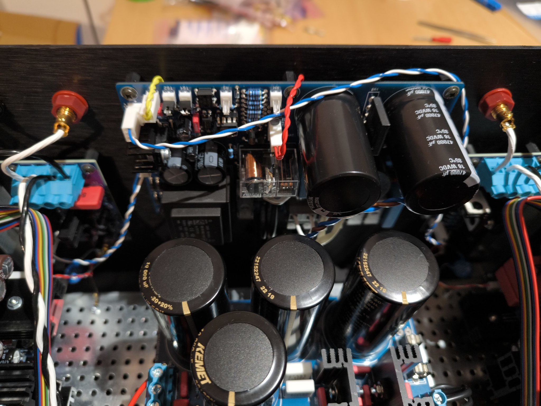

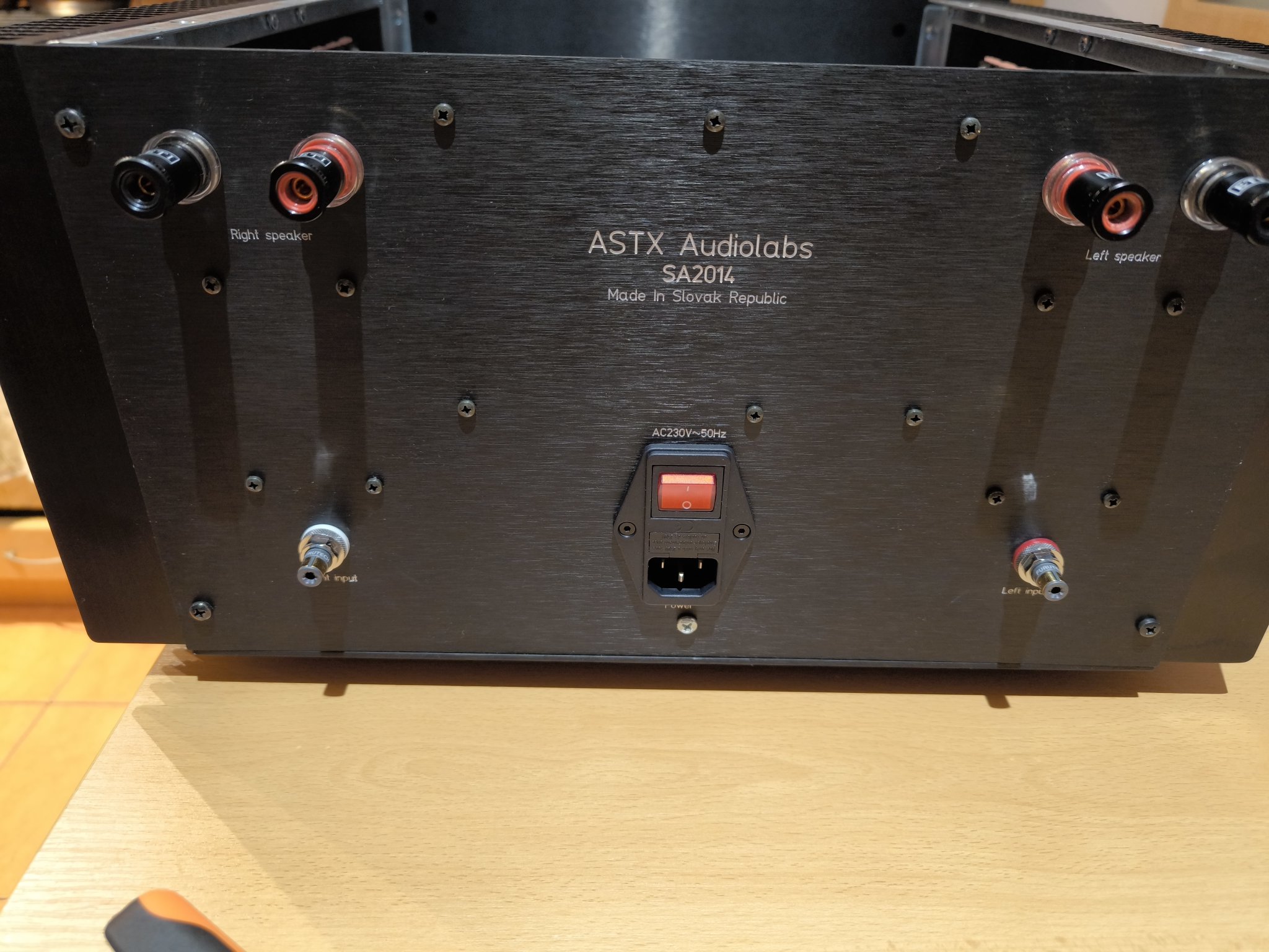

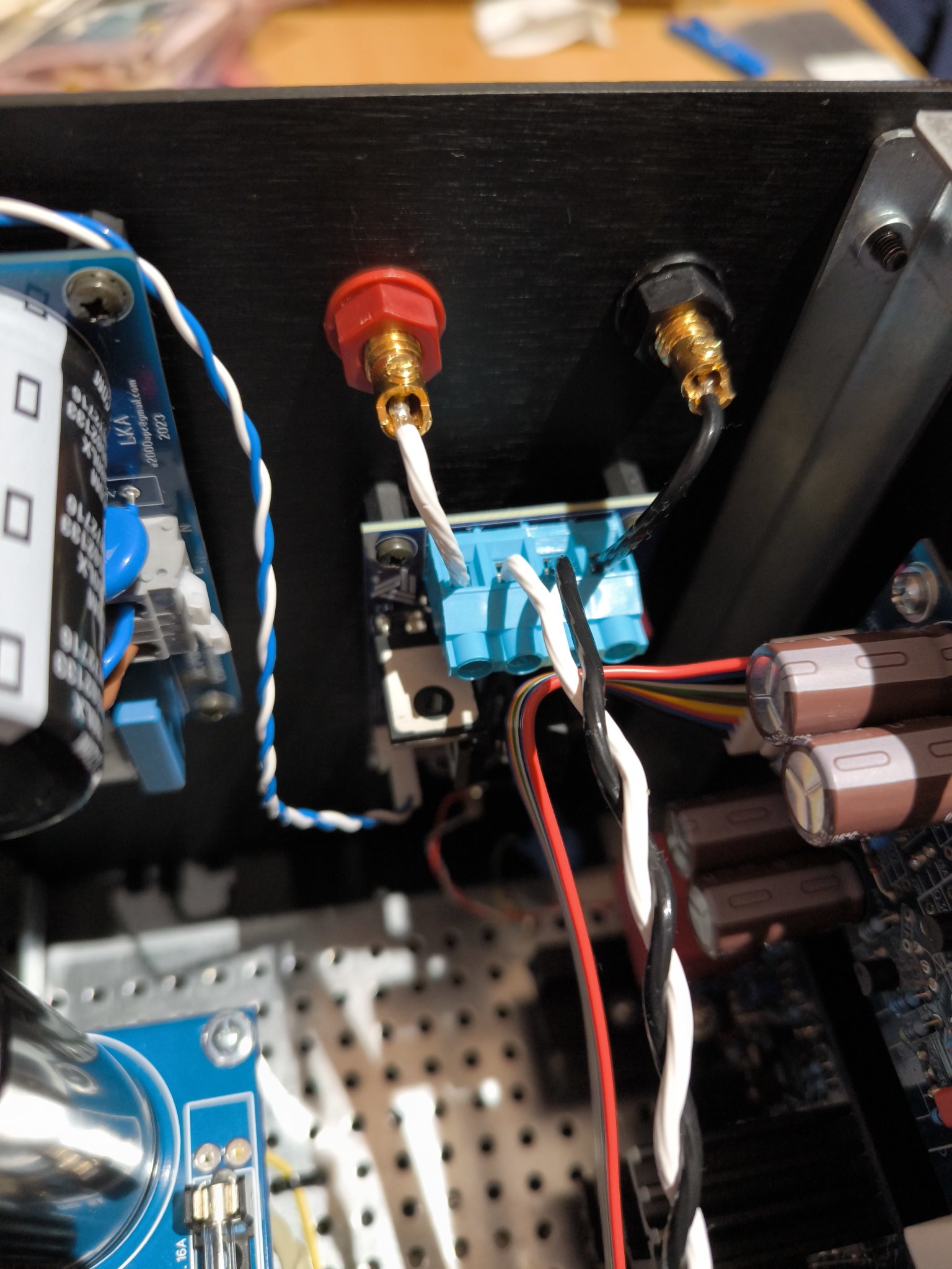

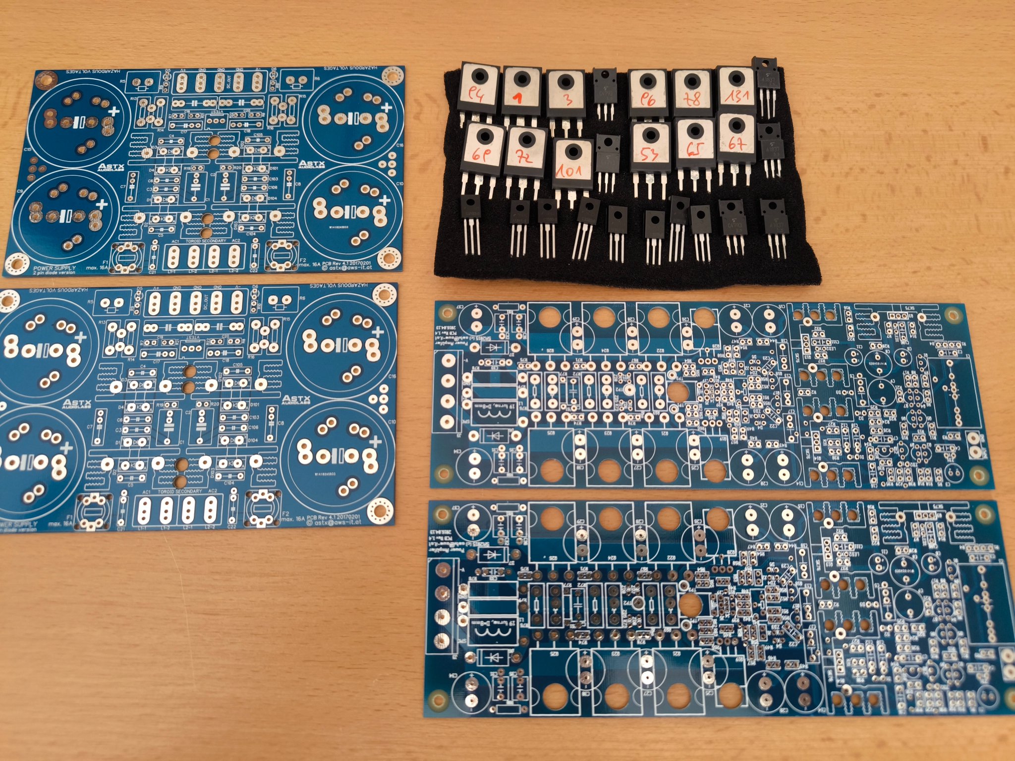

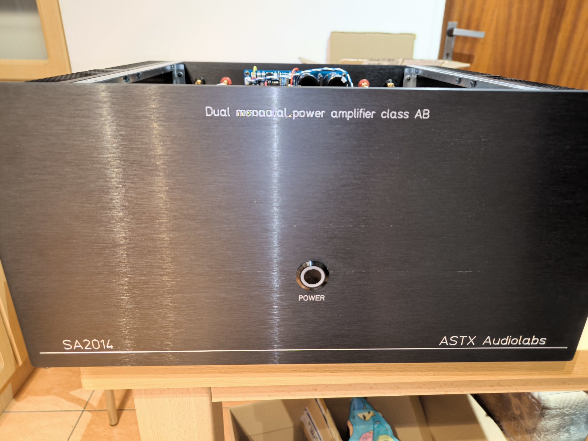

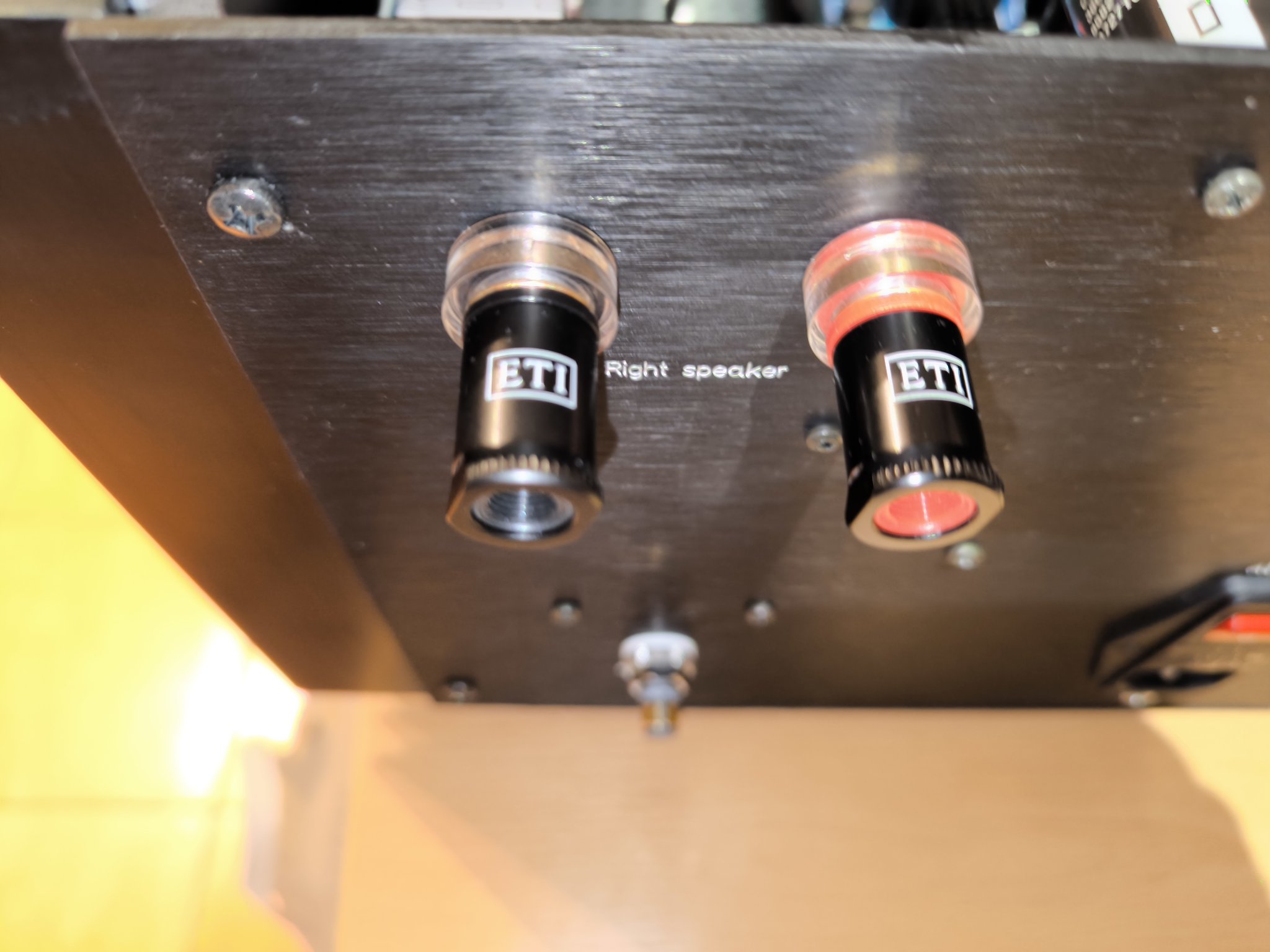

Finally finished a proper piece of amplifier, reference product from ASTX -- SA2014. On the bottom of the chassis 2 massive audio toroids 600VA, above each extreme filtration 80.000uF per channel. The amplifier also has a proper 400W/4Ohm and 200/8Ohm output. Grounding I did through two diode bridges. No hum or noise. Now I just need to save up for a big tower speaker Jenzen Illuminator. Sound Good 🙂

So wow I finally decided for SA2015 V-Mosfet (with IRFP). The first set from astx is already at home.
I will take another one at the beginning of December, I decided for a 4-channel bi-amping amplifier. Again it will go into 5U modushop box, 2x 500VA toroid and extreme filtration 4x 33.000 uF per channel (2 amplifiers) 😉

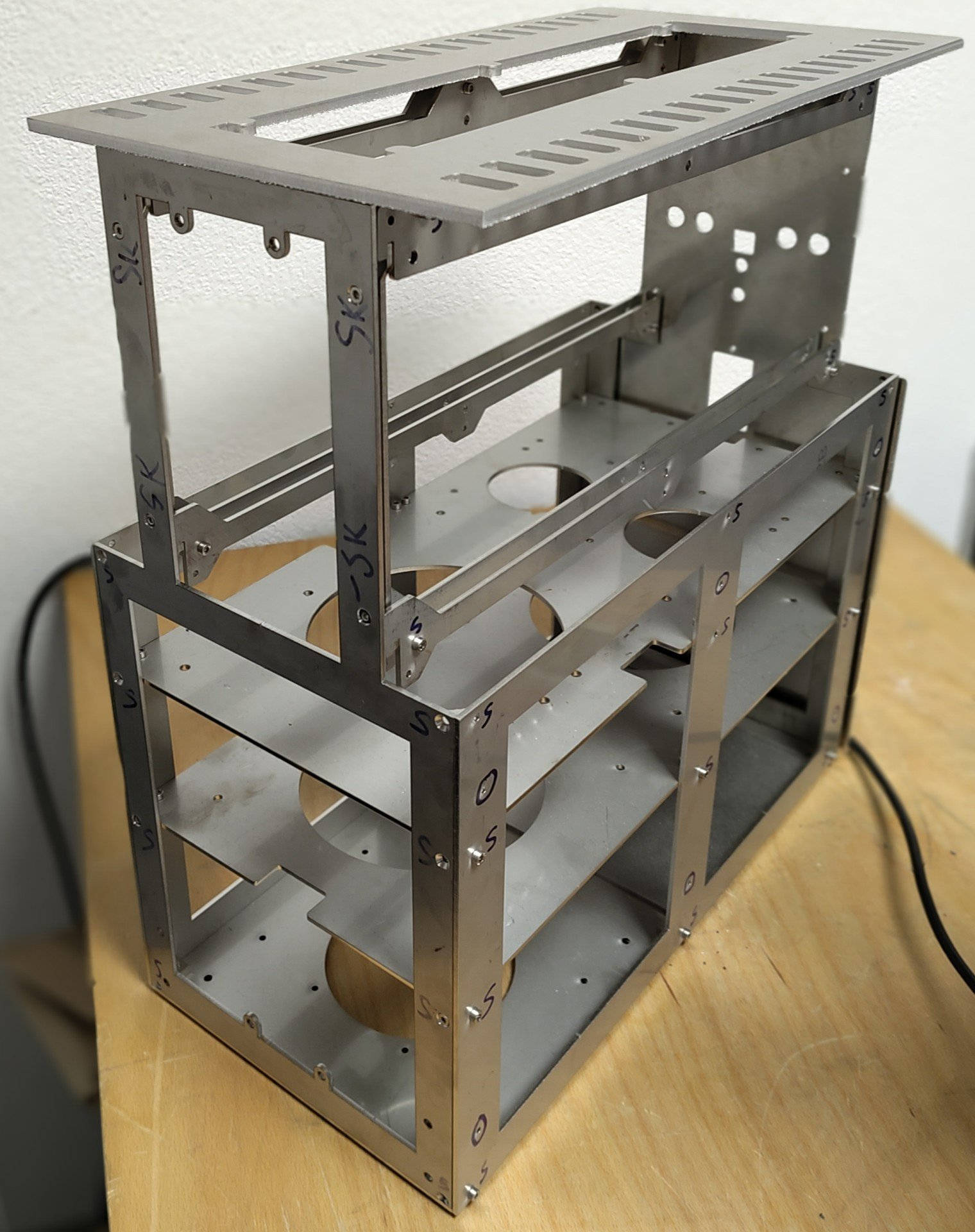

Today I was working on the heatsink support plate, tomorrow I will check the spacing and send it to production... (200x150x10 mm/ black elox)

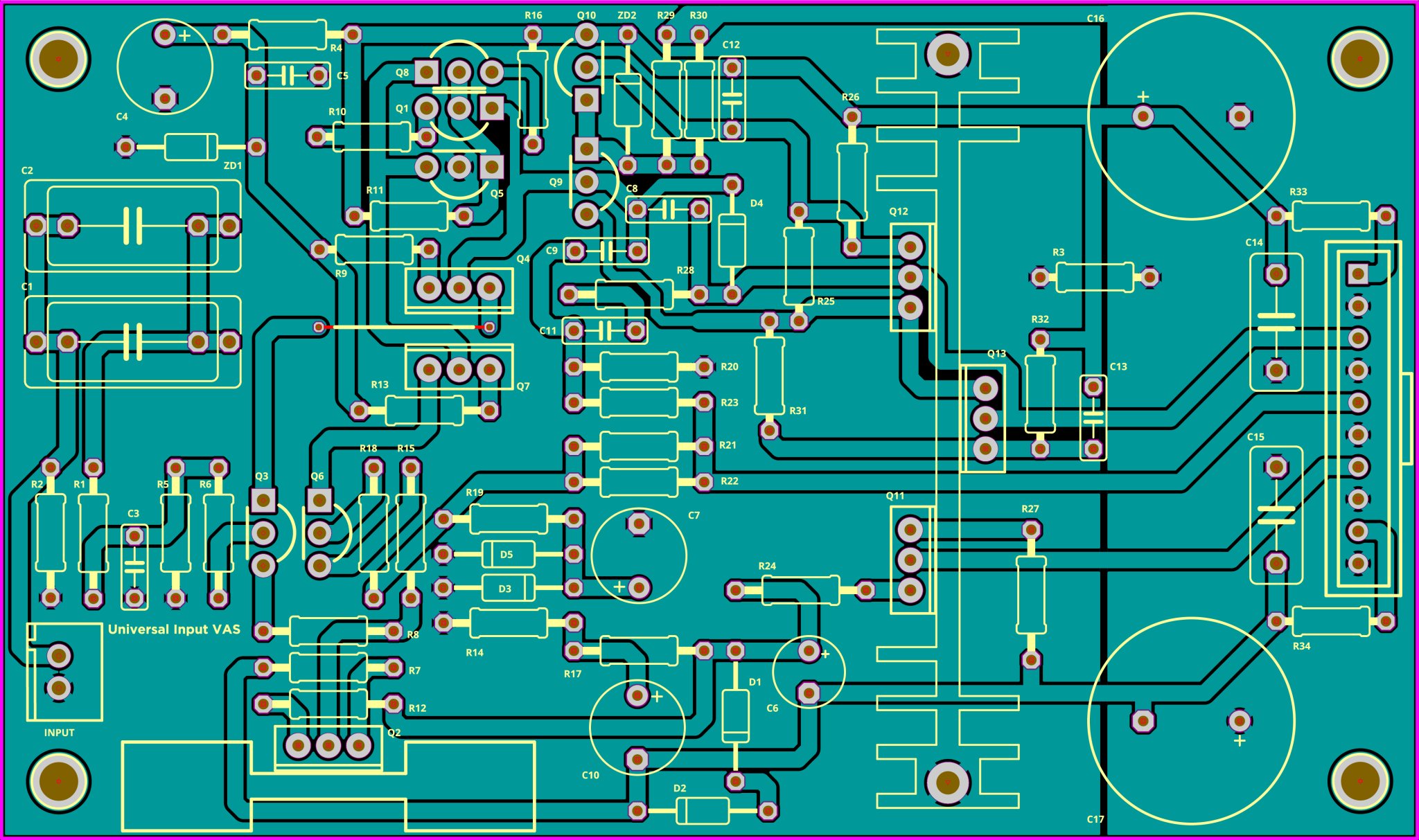

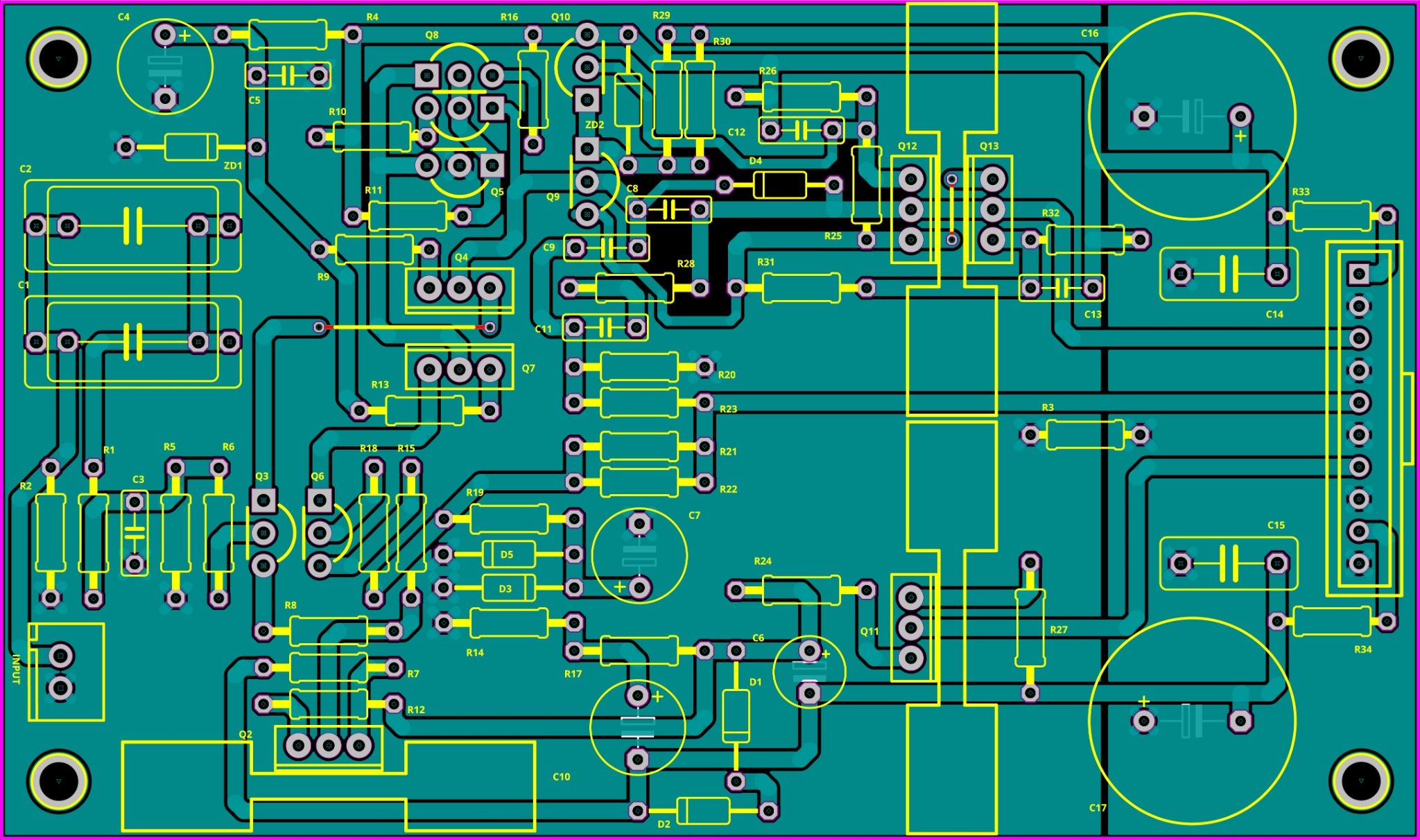

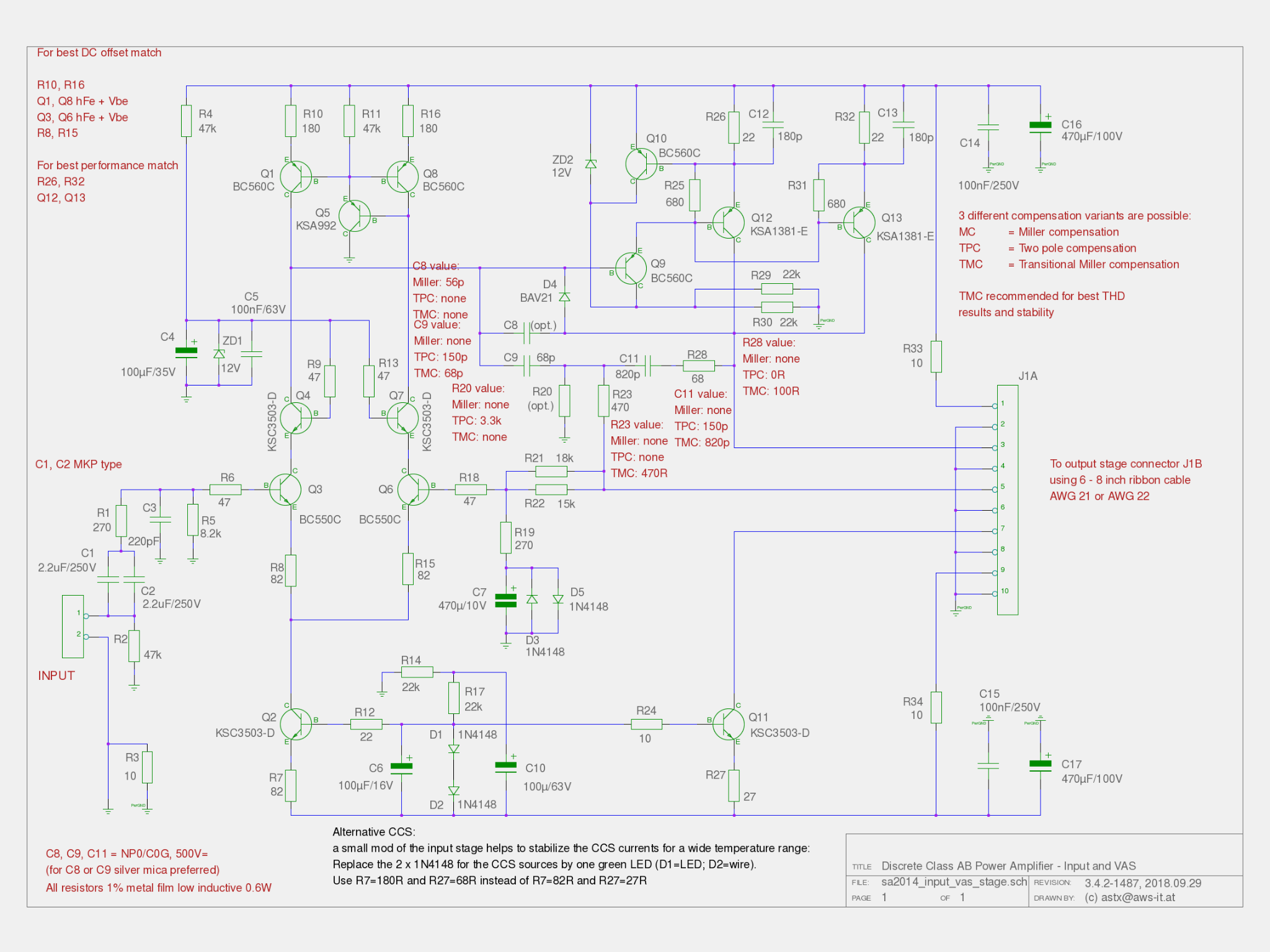

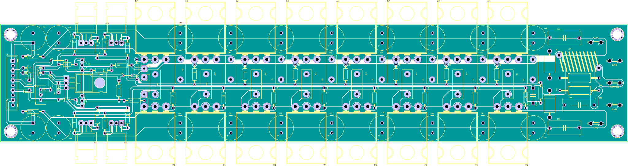

Greetings everyone,
Hope you're all doing fine.
Here's my (cloned) version of SA2014 VAS based on the latest schematic and PCB layout available by Toni,
Didn't test it yet
I had to remake it because I wanted to build this on single layer PCBs for my use.
PS. I'm no professional/skilled PCB designer, I know there are tons of mistake here, recommendations are always welcome 🙂
Didn't test it yet
Nice work, here the (untested) official single sided version of the SA2014 input stage in the same pcb size as the double sided variant. The output stage still needs to be done as single sided pcb
The CCS mod is highly recommend!
BR, Toni

Thanks for your response Toni!
I'll etch and test it and I will add the CCS mod in the VAS side PCB for me.
I'm halfway done laying the output stage on a single side,
Should I really skip the "opt" parts or you recommend adding them on? If so how can I find their values?
Parts with "opt." are for development only - do not populate them. Use only "TMC" compensation scheme. R8=68R, C9=68p, C11=820p, R23=470R
If the amp oscillates (test with square wave and scope.), try to increase C9 to 82pF or 100pF.
Yes, connected. It is a buffered feedback current mirror. D. Self named this current mirror "EFA" (Emitter Follower Added) in his book APAD 6, p133

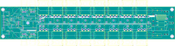

Single sided (untested) version of SA2014 output stage.
Tried to do with as less jumpers as possible, it's only 2 jumpers now because of the removal of "opt" components else there'd be much more.
Need to do a lot of optimisations to the layout before sending to fab.

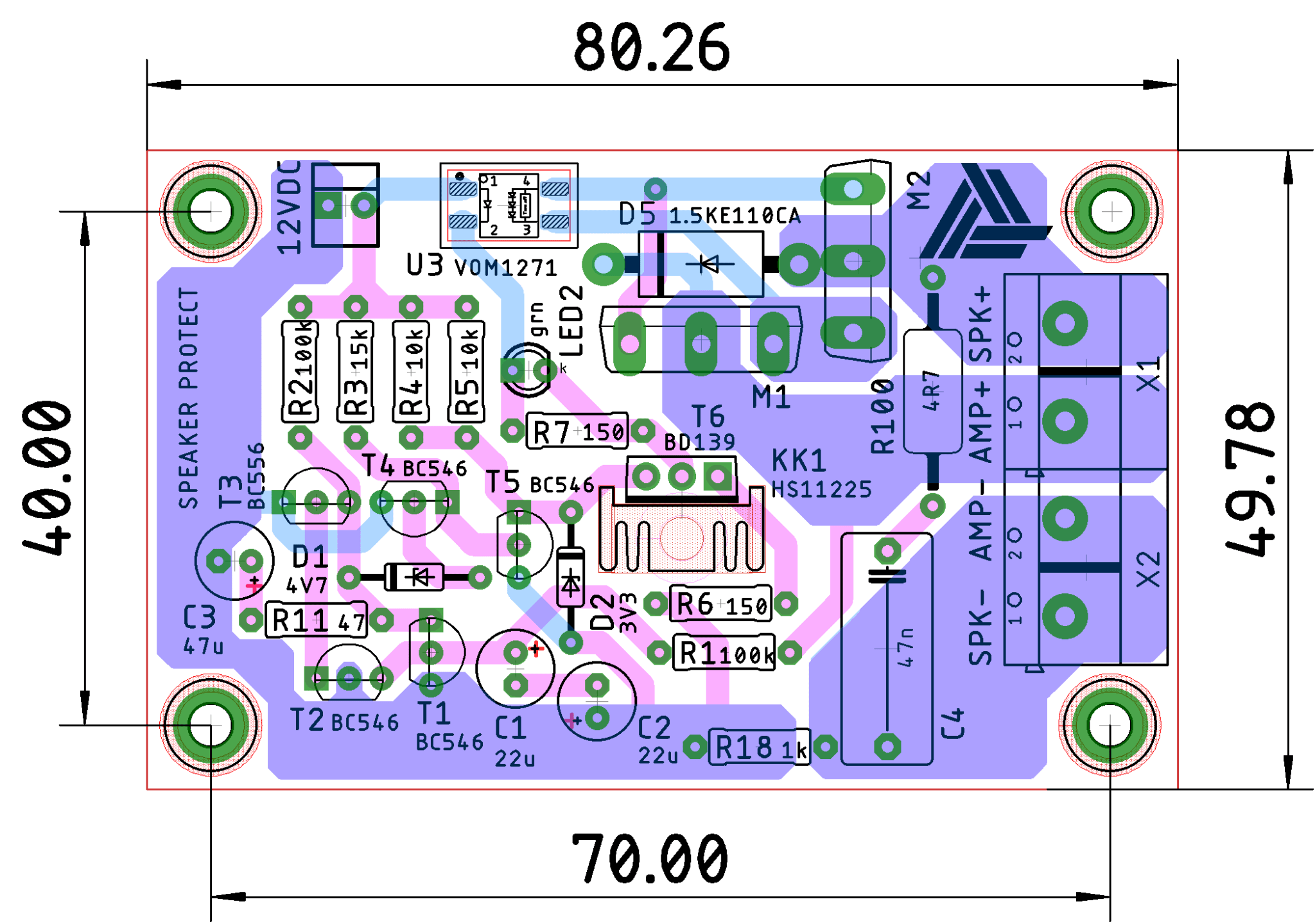

Thinking about moving zobel network part to speaker protection board.
Any suggestions are always welcome 😀
