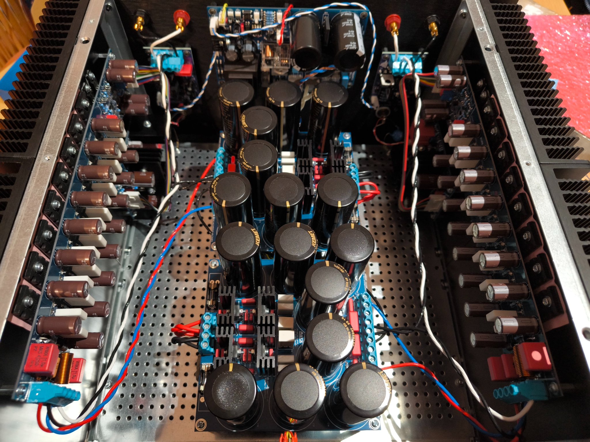

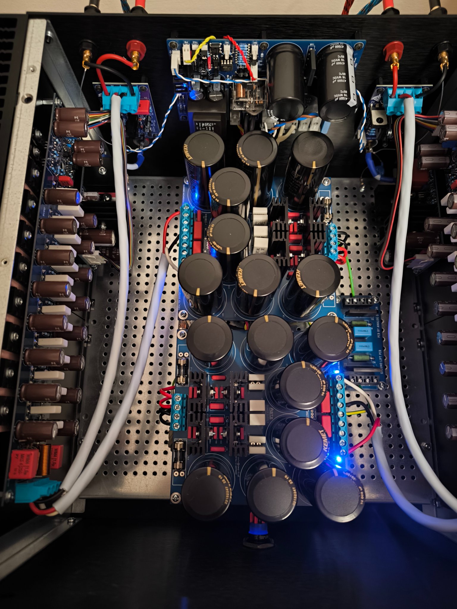

Friends, I finally got around to replacing the internal cabling after a year. I replaced the cheap chinese cables with SUPRA branded ones.
1, for power connection SUPRA RONDO 4x2,5mm
2, for speaker connection SUPRA RONDO 2x2,5mm
3, for signal connection SUPRA DUAL
Old cabling
Upgrade cabling
Reactions: asuslover and astx

There is a cost saving using the isolated package, not needing the insulator, shoulder washer, but Pd is not as good as the exposed metal.
It's nice to see the new chassis heatsink brackets in use. A few threaded inserts in the back makes it easier.
Did you have fun with the bottom screws for the front panel? I used some studs inserted into the FP first, attach to the bracket using a flat/lock washer, nut or keps nut. A small wrench to tighten.
Wiring looks neater, what gauge original and after? #16AWG should be good enough.

Dear Roman,
what I can't clearly see if the speaker output minus is as short as possible connected to the GND input stage... the new/second picture shows a small cable ...
(effectively minimizes dc offset and THD+N; case design and input/output stage placement and new cable routing allows you to get the best out of the design)

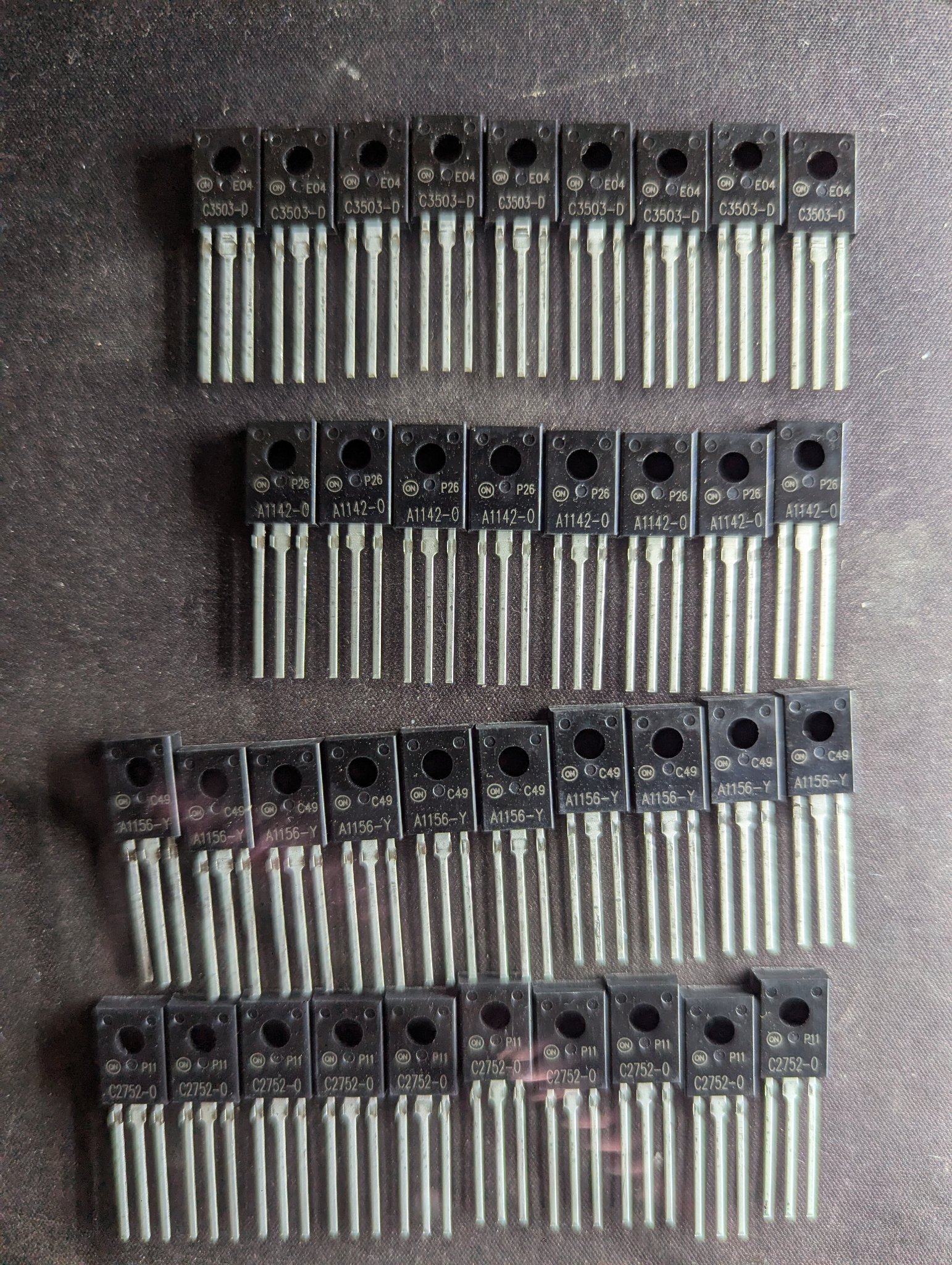

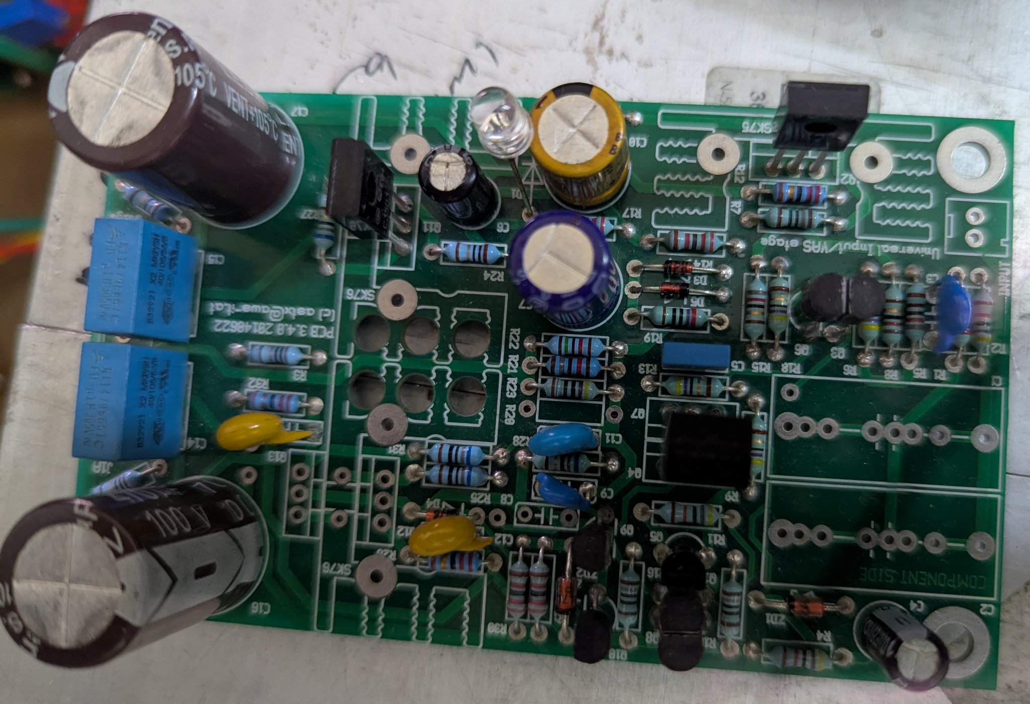

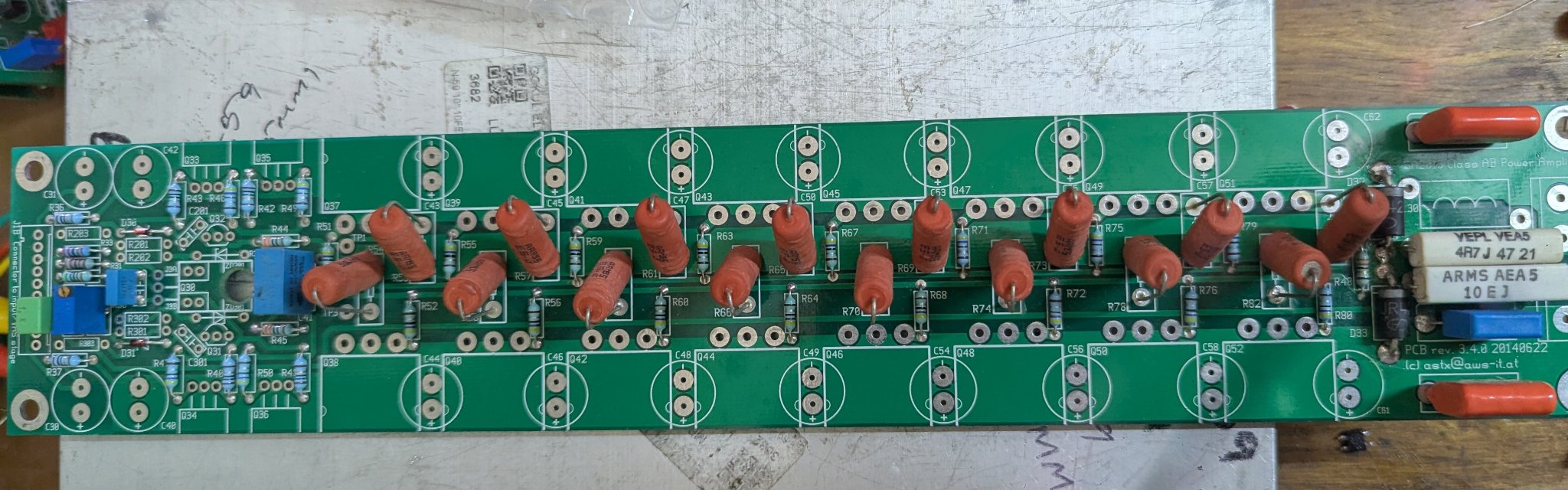

All my required devices have arrived except KSA1381. I got KTA1381 (only 3 pieces), since KSA1381 is EOL, it was "back order" when I ordered it, but went out of stock.
So I have following two alternatives with me, if I can use them!
O1, Can I use KSA1142 in place of KSA1381 (Q12,Q13 in sa2014_input_vas_stage), I know KSA1142 is a 180v, Ic=100mA, hfe=114, Pc=8W, ft=180Mhz and Cob=4.5-7pf with a good SOA.(also EOL)
https://www.mouser.com/datasheet/2/149/KSA1142-89939.pdf
OR
O2, Can I use KSA1156 is a 400v, Ic=500mA, hfe=145, Pc=10W.
https://www.mouser.com/datasheet/2/149/KSA1156-62023.pdf
Pardon my ignorance I am a beginner and trying to learn.
Arshad.
