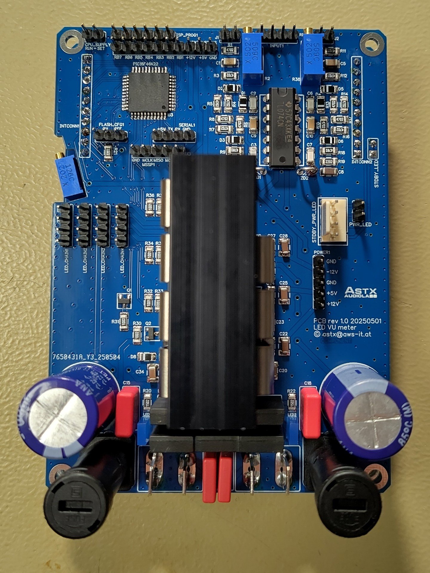

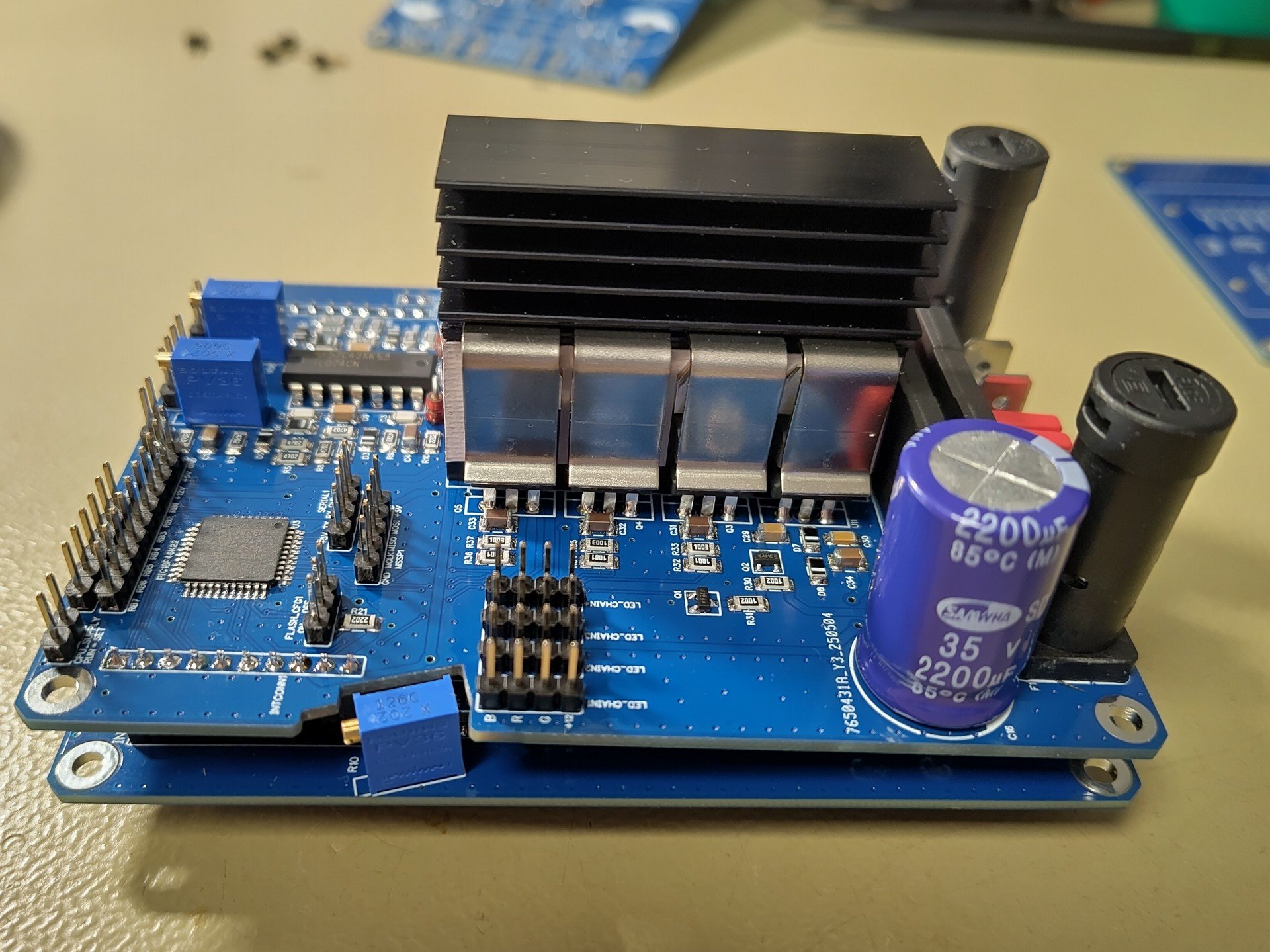

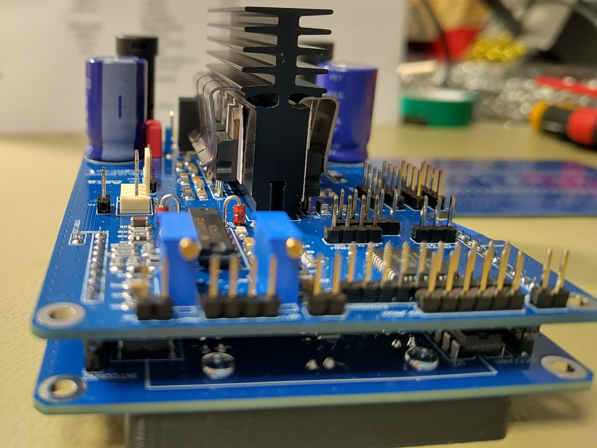

SA2021-NCH will get a LED-VU meter .... remote controlled ...

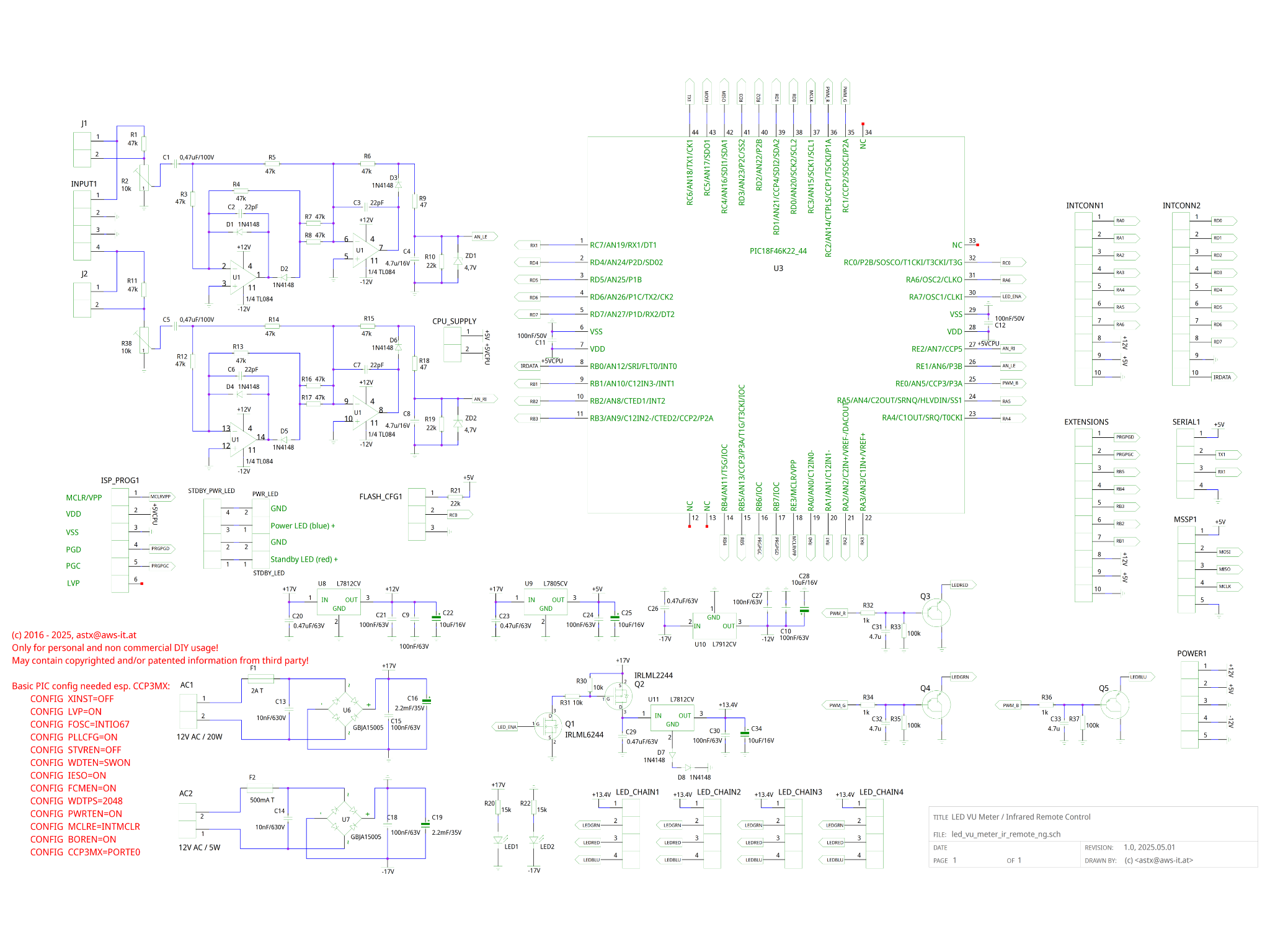

There are 3 PWM channels which controls RGB led stripes in the inner to show the electronics.
The LED bar can be controlled to display classic VU meter, peak only, VU and peak hold, difference, difference and peak ...
The VU scale is from +6dB down to -32 dB in 2dB steps and showing the last 4 steps in 4 dB steps down to - 48 dB.
The LED's are multiplexed 2000 times per second in 6 groups which is about 166 Hz per LED.

SA2021 LED VU: Looks like it would be soon ready for production ...
Remote control works. Mode switching works, changing amplifiers inside backlight color and brightness works (can be seen at the end of the video).
VU modes:
Code:
        LED_MODE_DARK,
        LED_MODE_BAR,
        LED_MODE_BAR_AND_PEAK,
        LED_MODE_PEAK_ONLY,
        LED_MODE_DOT_ONLY,
        LED_MODE_DOT_AND_PEAK,
        LED_MODE_OVERLOAD_ONLY,
For "LED_MODE_OVERLOAD_ONLY" it can be configured, that the display only works if a minimum dB level has been reached. So normally the VU meter is dark, but just be4 clipping occurs, the peak hold starts glowing.

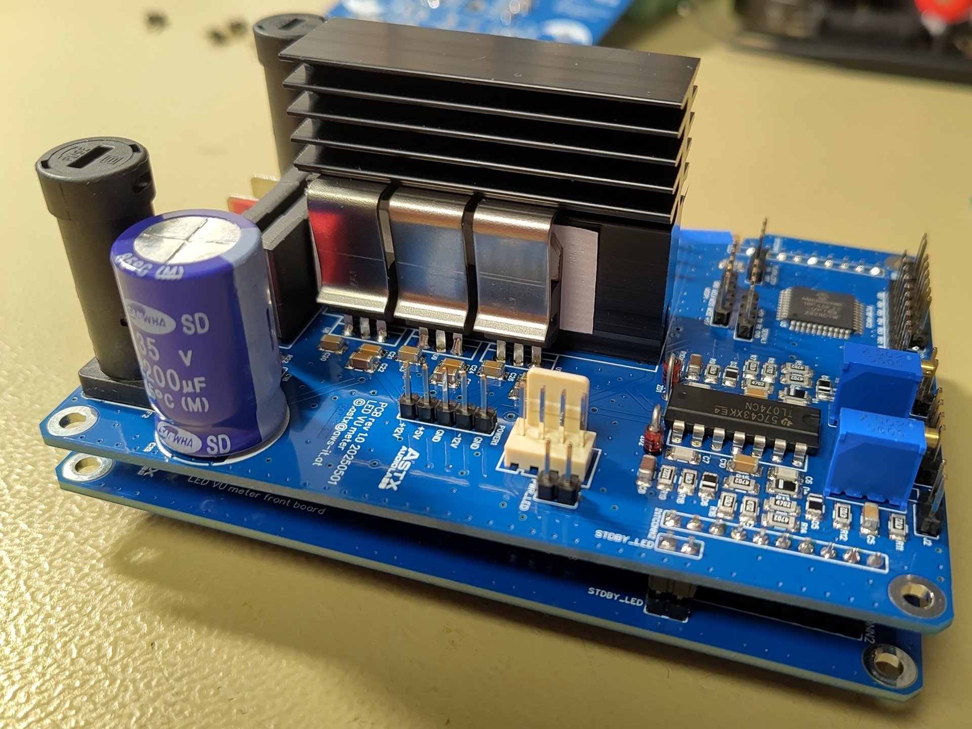

The 2x24 VU LED's are multiplexed in 6 x 8 matrix with a 2000 ticks task which gives a comfortable 166Hz per LED. No ghosting and no flickering. The brightness of all LED's is equal during all modes.
The board drives a 3 color RGB LED stripe which lights the inner of SA2021 tower. The brightness is not adjusted using multiplexing, instead it uses 3 PWMs (160kHz base freq.) to generate a 0-5V "DAC" output to generate a 7 - 12V voltage for the LED stripes.
Have fun, Toni

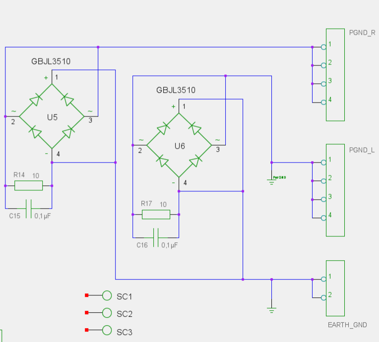

Hi tony,
I have a question about the parts around the ground loop. My main concern is 10R resistor and 0.1uF capacitor 😕
10R - metalfilm or wirewound / 3W or 5W
100nF - safety capacitor? X1? or lower voltage
thanks
