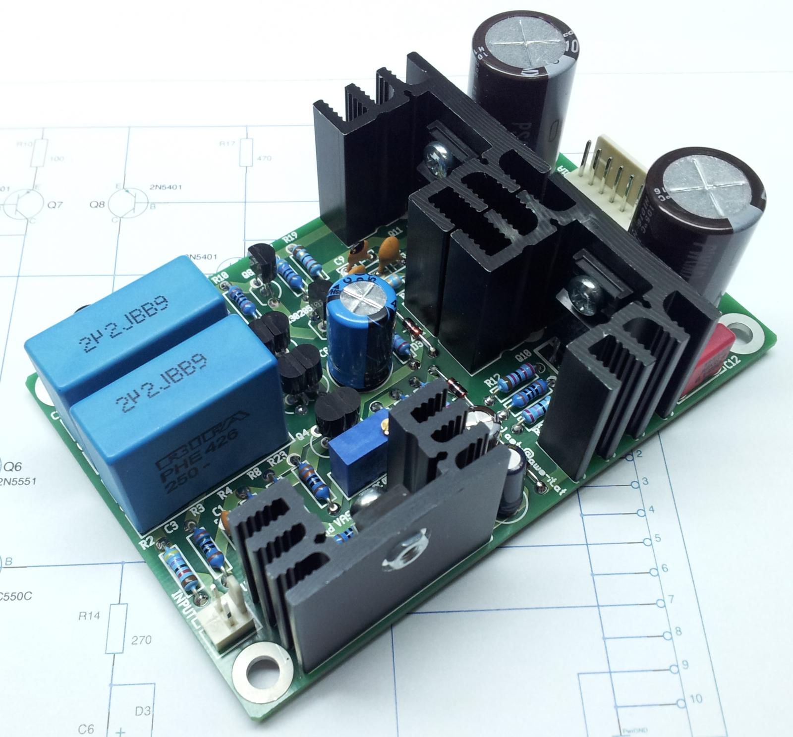

Heavily inspired from books of Douglas Self, Bob Cordell and other great authors I decided to design a discrete power amplifier to learn how LTSpice can be used for my DIY projects.

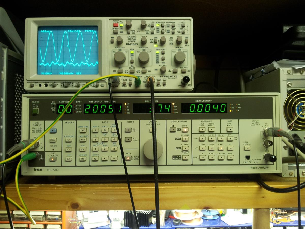

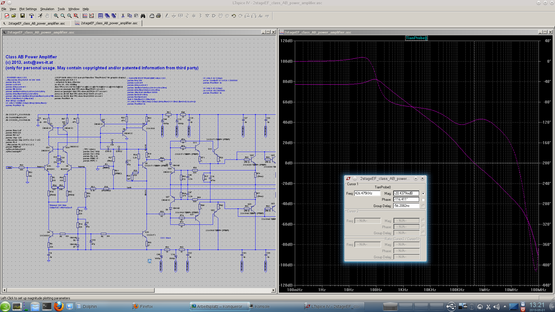

Attached is the current simulation file and some information about the real world result: a very good working 2stageEF power amplifier with high performance.
The simulated THD performance is about 0.0004% at 20kHz@200W@8R.
Real life THD+N performance of working prototype amplifier is about 0.0015% at 20kHz@200W@8R (80kHz bandwidth).
Using the HP3585A spectrum analyser (100dB resolution) while running 20kHz@200W@8R test only H2 and H3 are visible above the noise floor.
To download the needed BJT/JFET/MOSFET/DIODE ltspice library file "Cordell-Models.txt" please visit CordellAudio.com - Home
During the years some smaller amplifiers based on the same topology have been developed. These projects have been discussed in detail and have been built successfully by different users. See the index below for more information.
In addition a high performance discrete opamp "MyDOA" and housekeeping circuits have been developed and built many times too.
More test results, THD plots and other information will be updated from time to time.
Have fun, Toni

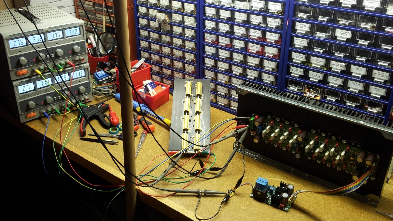

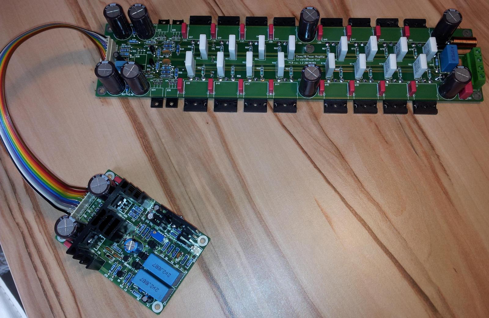

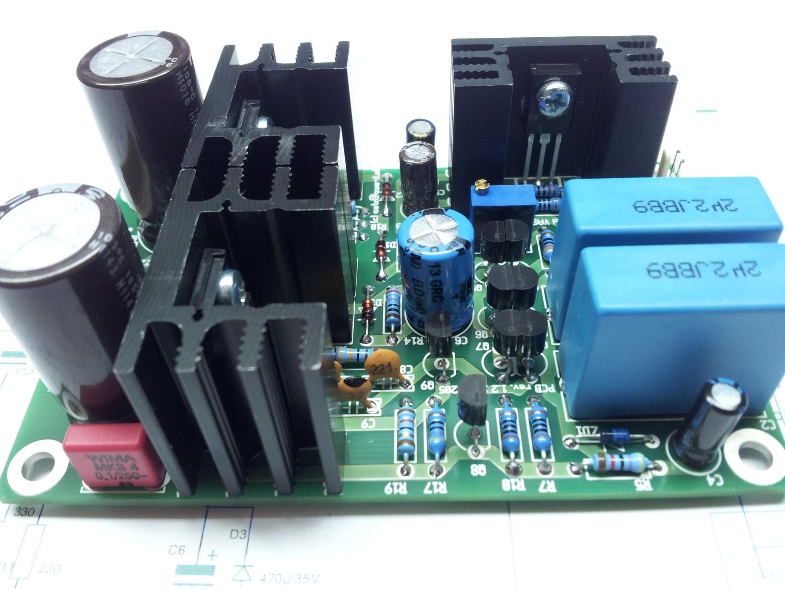

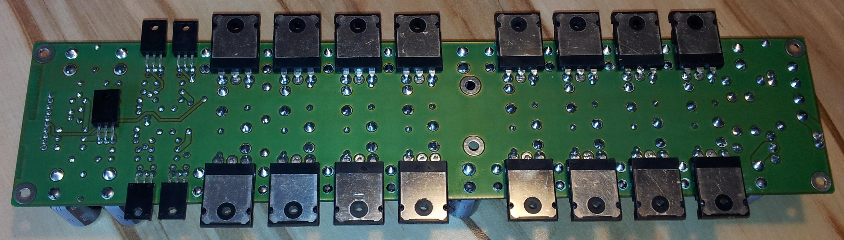

Using 2N5401 for Q1 and Q2 is a mistake. At low Vce these transistors perform badly.
The BC5x0, BC3x7, and 2SA1015 are known to have excellent okay quasi-sat behavior. There are virtually no transistors with Vcemax>50V that have good quasisat behavior.
Because SPICE does not model quasi-saturation, this problem will not show up in your simulations. However, since the above recommended transistors are pretty close to ideal, if you use Cordell's or NXP (Phillips) models for them they will get you within 6db of real life at low Vce.
... think you are referring to ltspice simulation file as the part numbering of the attached schematic pictures is different:
Maybe you are right that 2N5401 is not the best BJT for the current mirror.
Using BC560C instead of reduces THD simulation indeed about 3ppm.
BTW the used transistors for Q1/Q2 are hand selected from a big number of measured devices and have hfe > 220. Perhaps this is the reason, that the real world amplifier THD figure is better as simulated one...
Will try your BJT tipps the next days in real world.

PCB and input stage assembling details ...
Before soldering the heat sinks place pvc washers between pcb and heatsink solder legs to avoid short circuit with rail voltages. Do this even if your pcb has a very good stop paint!
slobber slobber 🙂 Congratulations on this beautiful piece of engineering.
It looks looks really professional to me - you must do this for work too and not just as a DIY hobby!
Thanks for sharing this btw - really very inspiring stuff 🙂

Wow, looks good, you have a nice bench set up there and you've built a good looking amplifier. I hope you are pleased with the sound too.
Thank you. I am very happy to have such a beautiful hobby.
Thank you. It measures very good and it sounds very good in mono (the second/other channel is assembled and mounted on heatsink since yesterday, but not yet ready for listening - needs the burn in test 1 hour full load 20kHz@200W8R).

Dear keantoken, manso, AndrewT
interesting discussion about current mirrors. During learning LTSPice I have simulated "simple current mirror", "EFA current mirror", "wilson current mirror" and "4 transistor improved current mirror". Douglas Self has made a comparison between these 4 CM types (APAD Handbook, Fifth Edition, page 85) .
One of the conclusion I made, that if using bjt's with beta > 200 the error of the simple current mirror between current in/out is very low in comparison to the "better CM" variants. So I decided to use a simple current mirror as the simulation showed only a few ppm THD difference.
As there are many empty input stage pcb's left (got it cheap from overproduction) I will try to test different bjt's and degeneration values during the next days and will give a feedback
Btw.: the same input/vas stage exists assembled with matched 2SK170 and about 150R degeneration. Will add ltspice asc file the next days.
