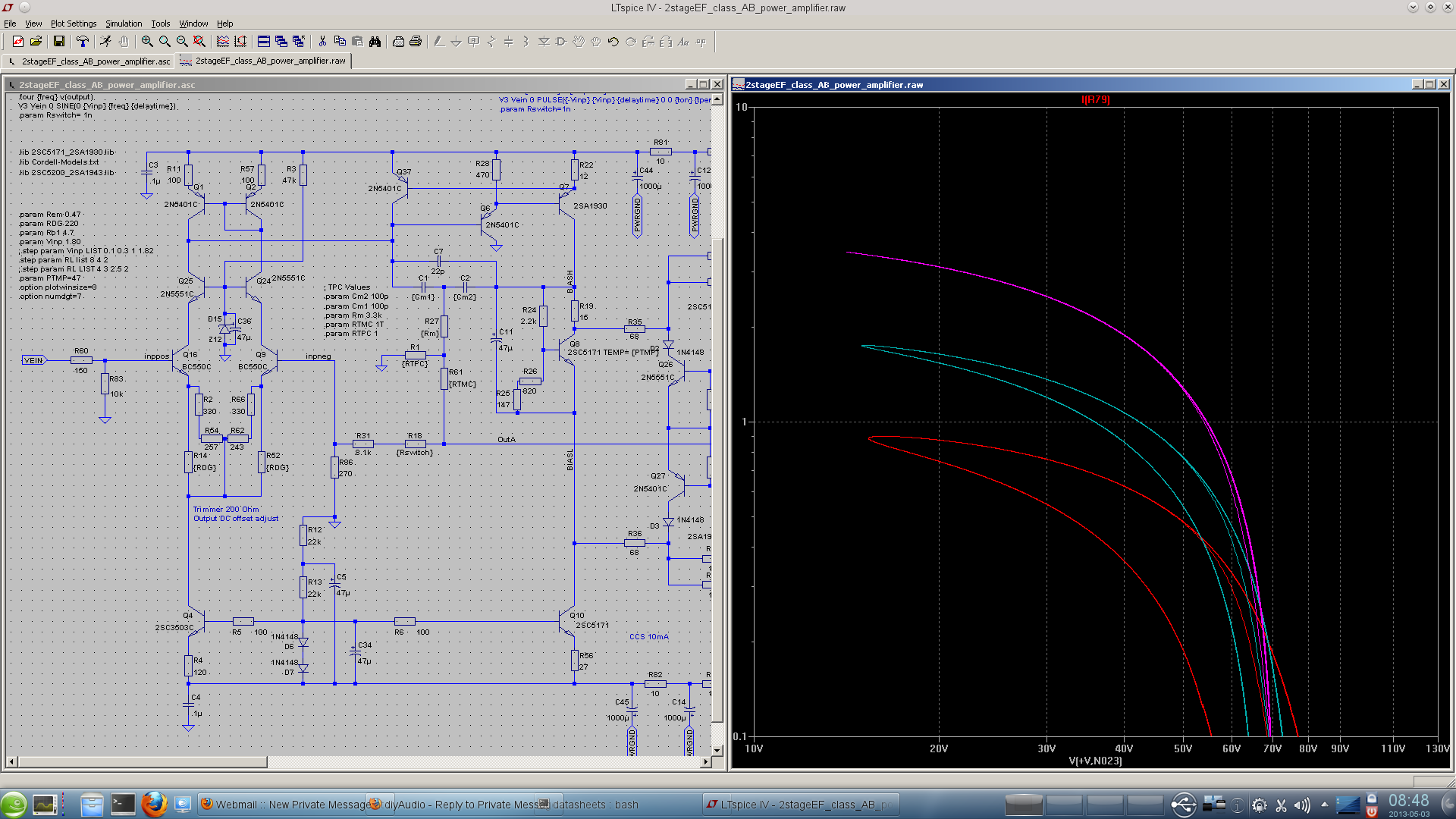

Output protection / SOA
Attached a SOA plot of 8, 4, 2 R load. Short circuit starts too late at about 1.7R load.
Sorry - my fault 🙁:
I changed the emitter resistor values the last days from 0.22R to 0.47R and adapted the short circuit values not correctly.
Thanks michaelkiwanuka for reporting this to me.
Give me some time to correct these values - or feel free to help here.
BR,
Toni

where is R79?
The output stage and the feeds to the protection are hidden.
Ratio of R22 to R56 is liable to entering triggering while still handling a valid audio signal into a valid audio load. R56 > R22*2 and preferably 3times to 4times. 27>12*2
If you split R22 into R22a+r22b=R22 and tap of the junction, you can experiment with different R22a:R56 ratios.
R22a < 27/3 or < 27/4 will delay the onset of triggering and still protect the VAS from overheating.

If you can't open the asc file: R79 in ltspice simulation file is R53 in the schematic picture in post #1.
Thx for checking VAS load.
Will check your findings at weekend.
BR, Toni
check operation of Q37.
By the time you apply 400mVbe there will be some triggering effect building up.
That why I said 3 to 4 times for that resistor ratio.
It might be something else.
Check the output protection. Again 400mVbe could be approached at that particular point in the waveform.

You are correct - the output protection is the source of this trigger spike. Sim load was 4R.
We have to do some rework to meet the SOA of the 2 EF stages to drive 4R loads. A lower supply voltage is required for safe 4R usage.
BR, Toni

I mean power supply Voltage reduction due to SOA problem mainly at the pre driver stage 2SC5171 and 2SA1930. Maybe I have forgotten to recheck SOA after reducing R17 from 150R to 33R (to reduce distortion at high output levels).
So finetuning is needed:
  • pre driver stage: using other driver bjt's with better SOA or 4 instead of 2 bjt's
  • VAS: split R22 to avoid too early trigger of VAS over current protection
  • recalculate protection threshold and also recalculate transient pass capability of output short circuit protection
With current predrivers SOA the title of the project should be better corrected to "2stageEF high performance class AB power amp / 200W8R" as it is currently not save to drive 4R loads at full power. :headbash:
BR, Toni

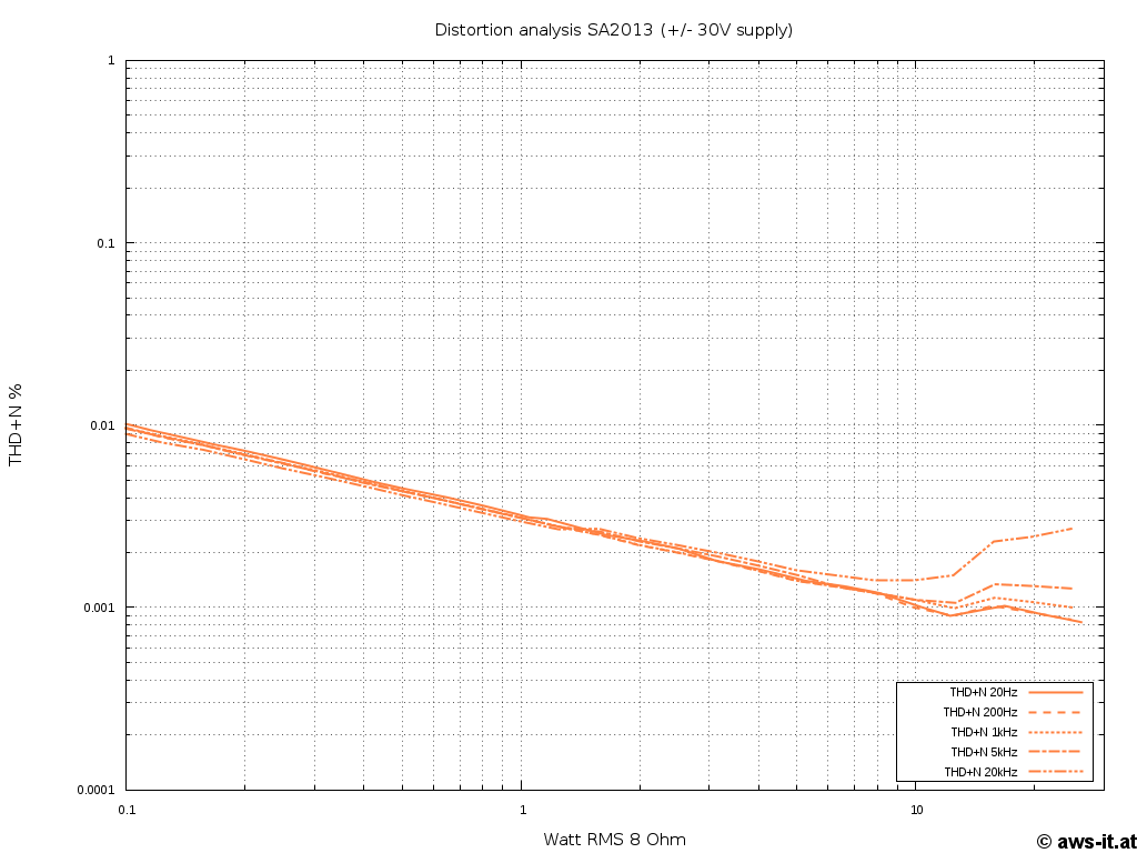

The simulated THD performance is about 0.007% at 20kHz@200W@8R.
The real life THD performance is about 0.004% at 20kHz@200W@8R (80kHz bandwidth).
Hi Toni,
really impressive, obviously you have managed to get every smallest thing right.
Did you evaluate THD20k at low output power, e.g. at the point where the OPS leaves class A operation? My impression from listening experience is that this figure is quite important, if it is within the region of actual listening level.

Do you mean something like the attached plot? Leaves class A between 10 and 20W output power but no extremely rising of THD viewable ...
This plot made with homebrew GPIB software controlling Levear VP7723D THD Analyzer. Amplifier was running only at +/- 30V supply.
Note: need to measure this again at full supply voltage.
BR, Toni

I thought of pure THD obtained from spectral analysis (simulated or even measured). The problem with THD+N is that the 'real' noise is uncorrelated to the signal whereas the distortion products are correlated. Our hearing system seems to do a brilliant job in detecting correlated signals, even if they are well below the 'real' noise floor.
Attached a SOA simulation for Rload 8, 4, 3, 2.5 and 2 Ohm stepped.
Assumed that cooling is good TTC5200 and TTA1943 are in the safe SOA region down to Rload of 3 Ohm.
Reworked short circuit protection. Removed C46 and C47.
NOTE: It is not possible to keep the output bjt's in safe SOA part during a short circuit situation. If power supply fuses are fast enough the outputstage may survive a short circuit!
Next amp version will get a multislope VI limiter...
Using the SPICE models of keantoken from post #22
  • removed the mysterious simulation spikes seen/reported in post #27. The output protection wasn't the source of spike so there is currently no need to split R22. Q37/R22 limits VAS current to about 56mA. There is enough distance to normal VAS operation (~ 20mA).
  • synchronized simulated and real life THD values.
Thanks goes to keantoken providing these bjt models.
Updates to pre-drivers are in work due to very bad SOA of 2SC5171 and 2SA1930.
BR, Toni

............output protection wasn't the source of spike so there is currently no need to split R22.
The VAS protection is there to protect the VAS. There is no correlation between an output spike and the R22a value.
Q37/R22 limits VAS current to about 56mA. There is enough distance to normal VAS operation (~ 20mA)...........
are you sure?
what IC current is passing the protection transistor when 56mA of VAS current is flowing.
How low does the VAS current need to go to turn off the protection transistor.
I think very many builders get this wrong and then blame the protection for sounding wrong, when It is possibly early triggering that is affecting the sound.
