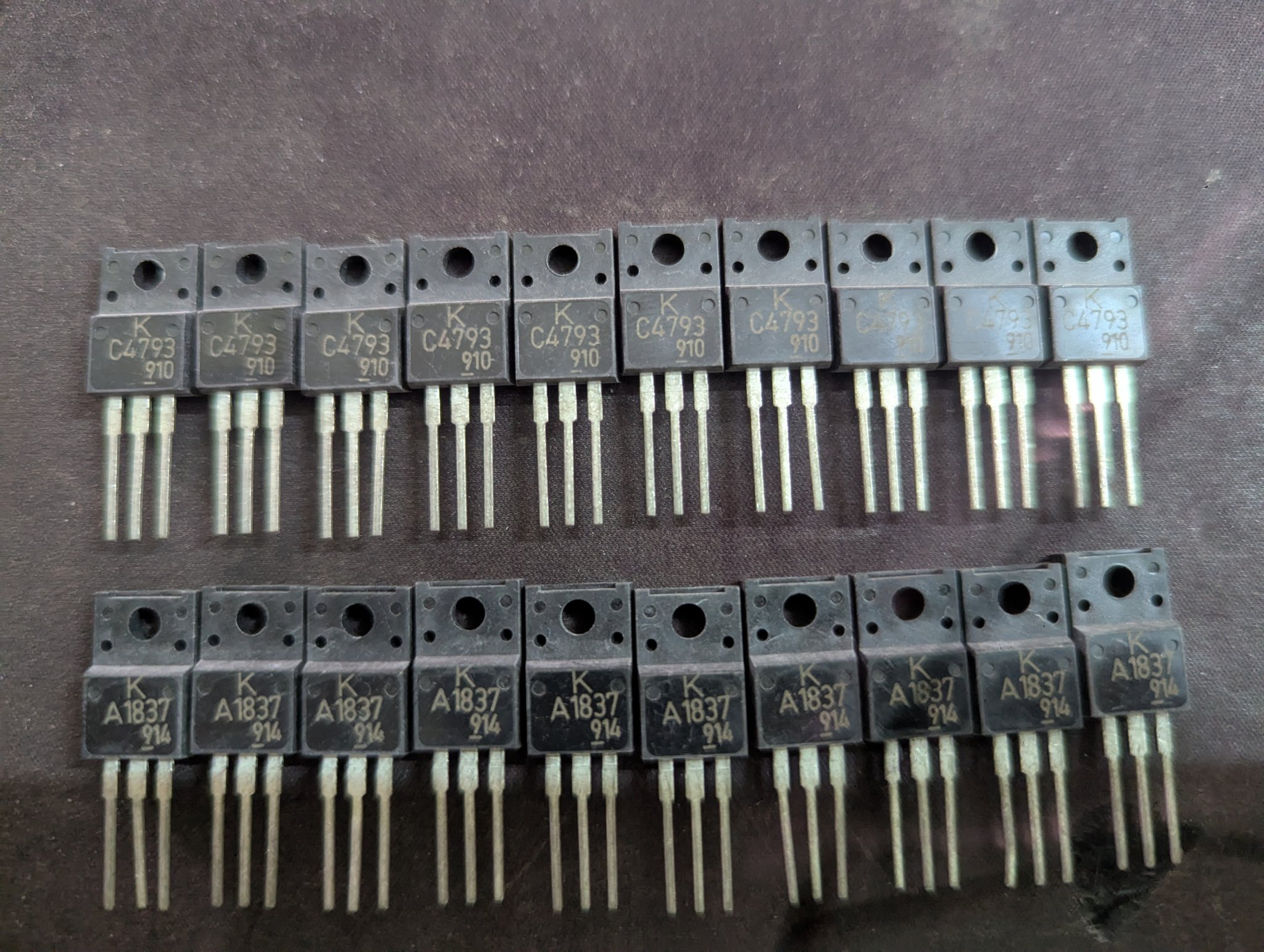

Ad Q2: Using MJE15032 & MJE15033 is a no go. They have to low hFe and are too slow. You need the high gain of 2SC4793 & 2SA1837. Note: It's a 2 stage EF output.
You are right, I understand now that gain is critical here. Its EF2 not EF3 output stage.

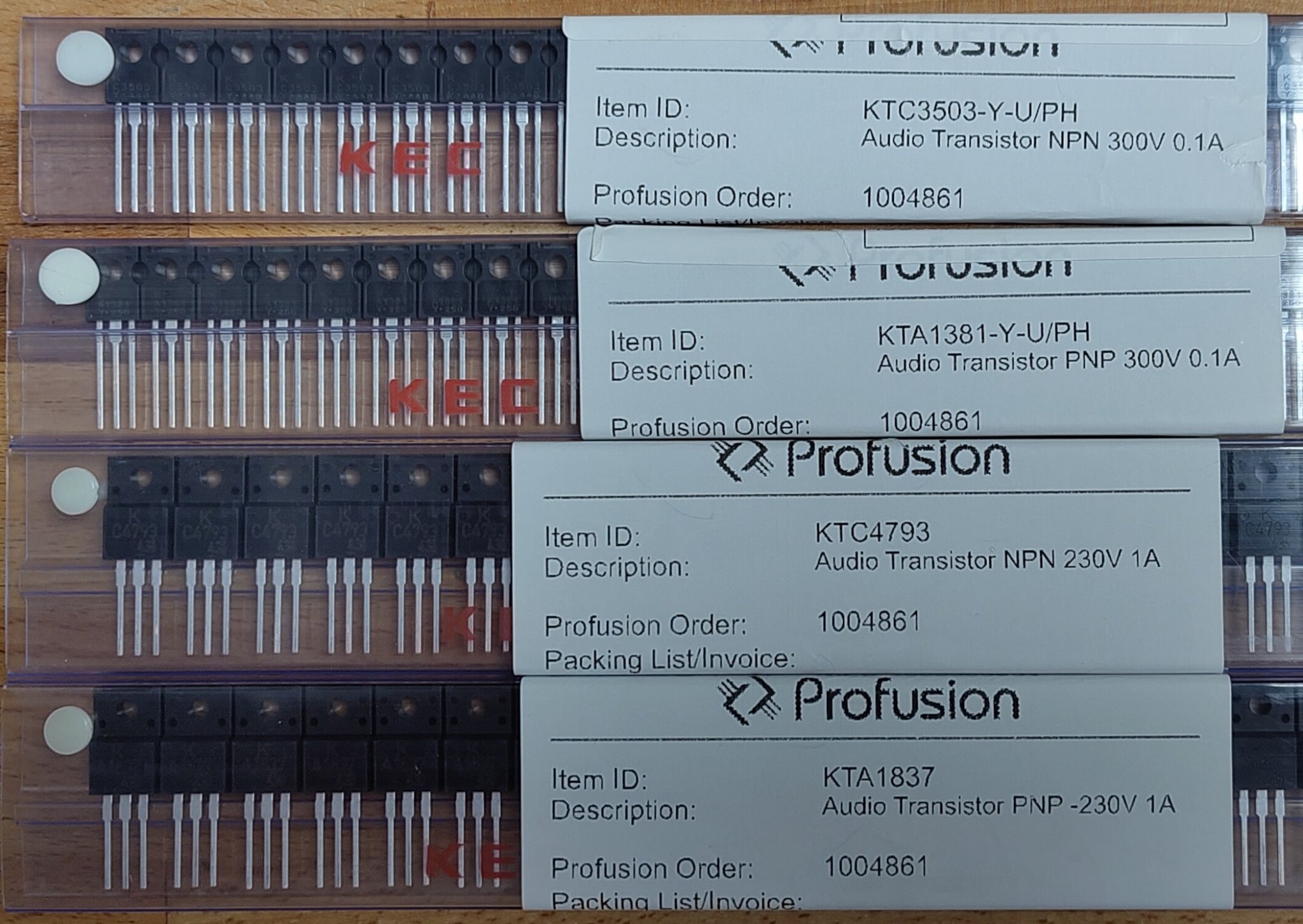

What do you think about these devices I have, they are the clones of 2SC4793 & 2SA1837, can we use them?
https://www.keccorp.com/en/product/product_view.asp?idx=354

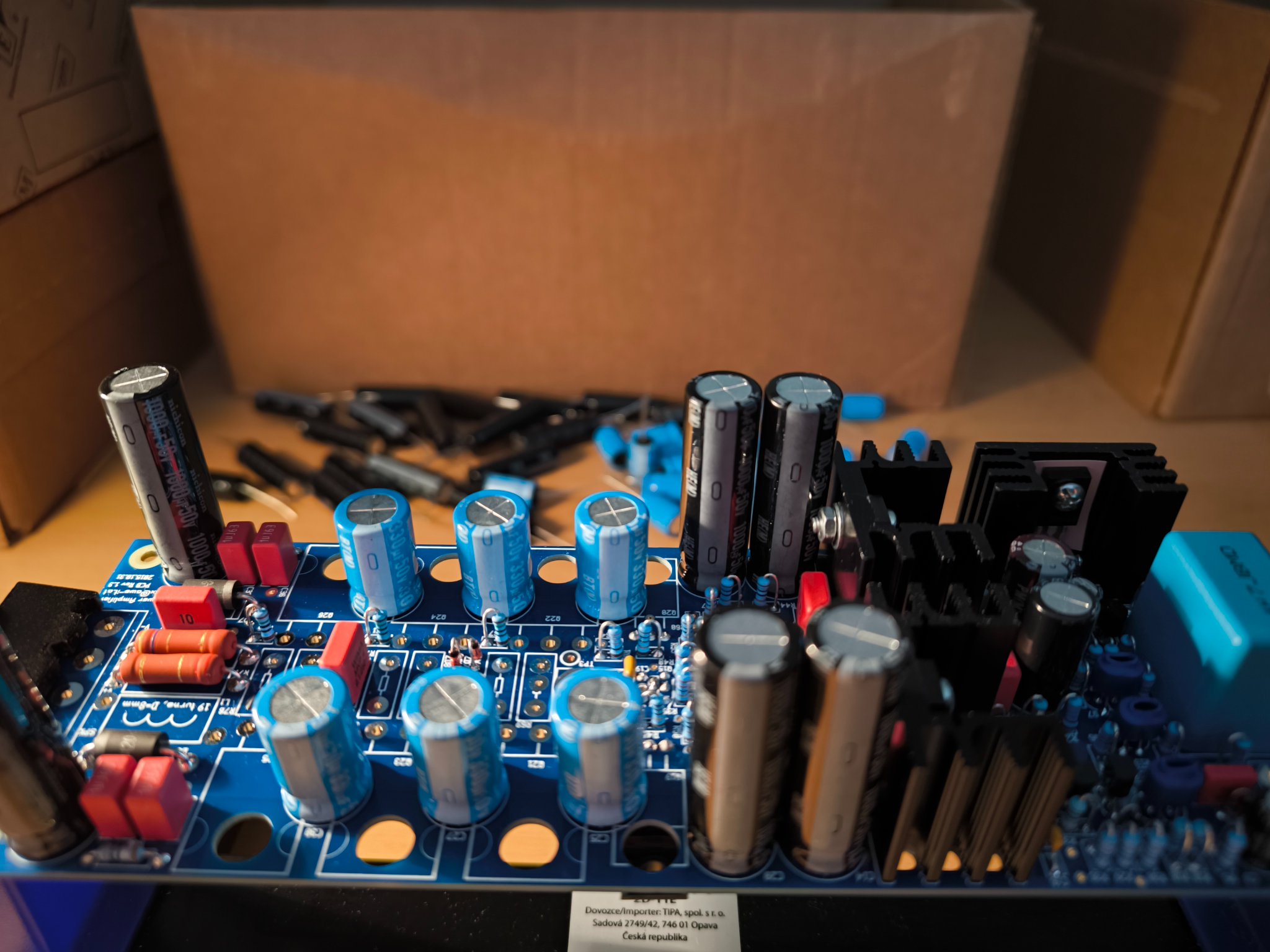

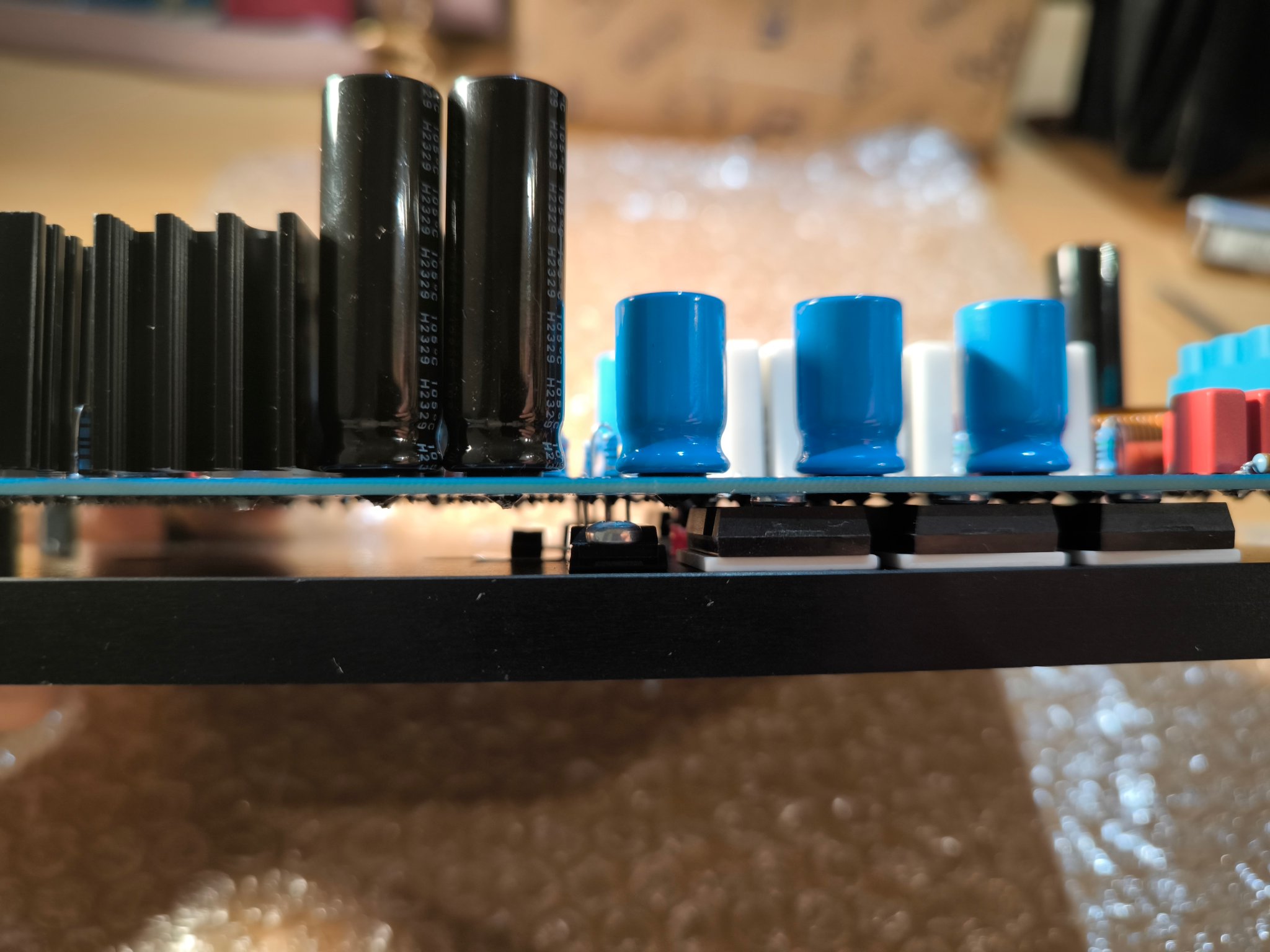

Friends I'm about to finish SA2015, so far the first channel is almost done, ...I'm still waiting for the delivery of the ceramic pads to start testing! Several of you in the past have addressed in what order to solder capacitors, power mosfets and power resistors.
For me it's probably best like this:
  1. Capacitors 330uF
  2. Power mosfets
  3. Power resistors

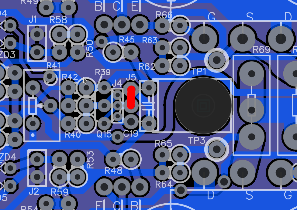

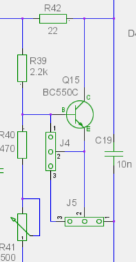

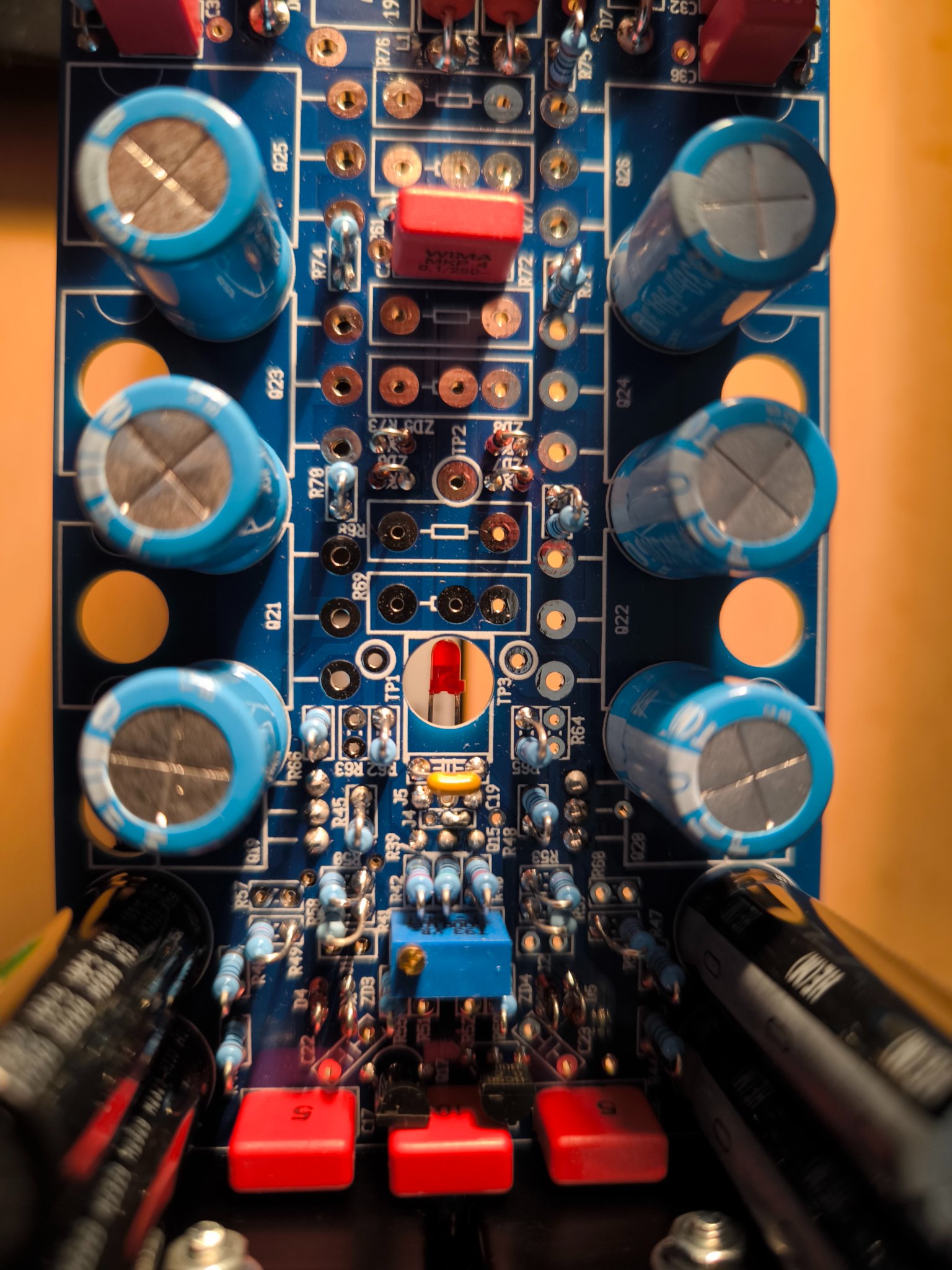

See attached picture: J4 unused, J5 connection from pin 1 to pin 2 (red line).

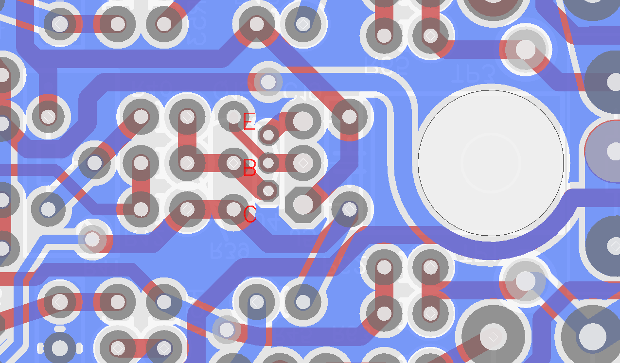

The pcb is a bit modular. For the SA2016 L-Mosfet the bias transistor Q15 is a BC550C so the big hole right stays empty. The BC550C needs to be soldered on the SOLDER side mirrored on the vertical axis. A hole in the heatsink about 1-2mm deep for the BC550C top is recommended. Add some thermal compound into this hole to get a good thermal connection for the BC550C. Similar to the SA2015 IRFP/MOS pcb.
BR, Toni

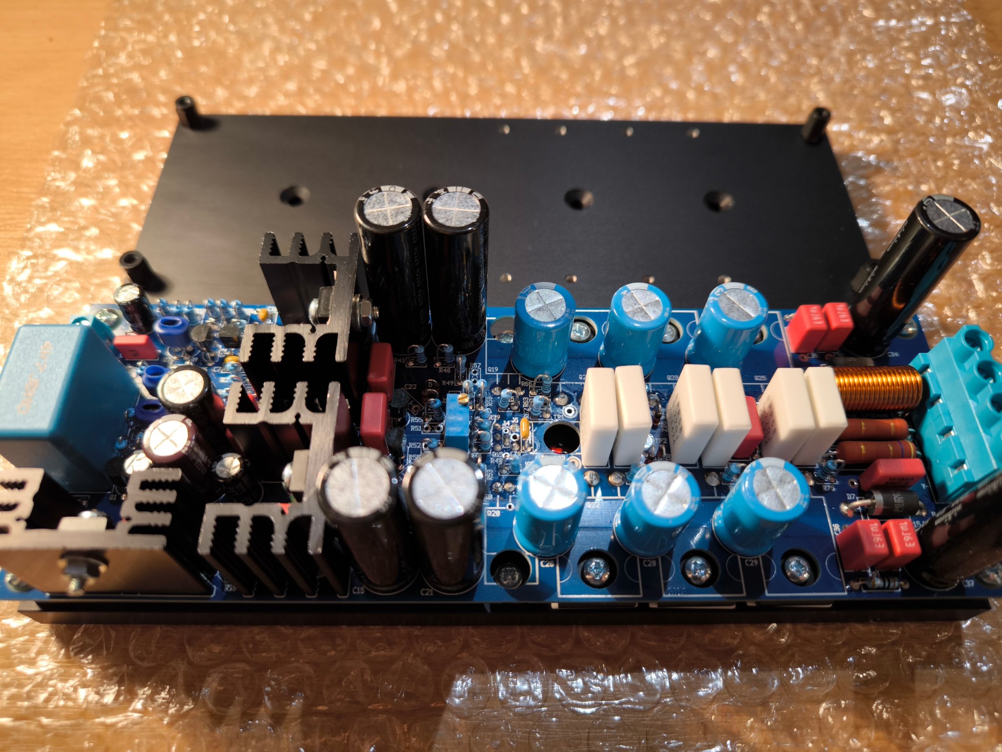

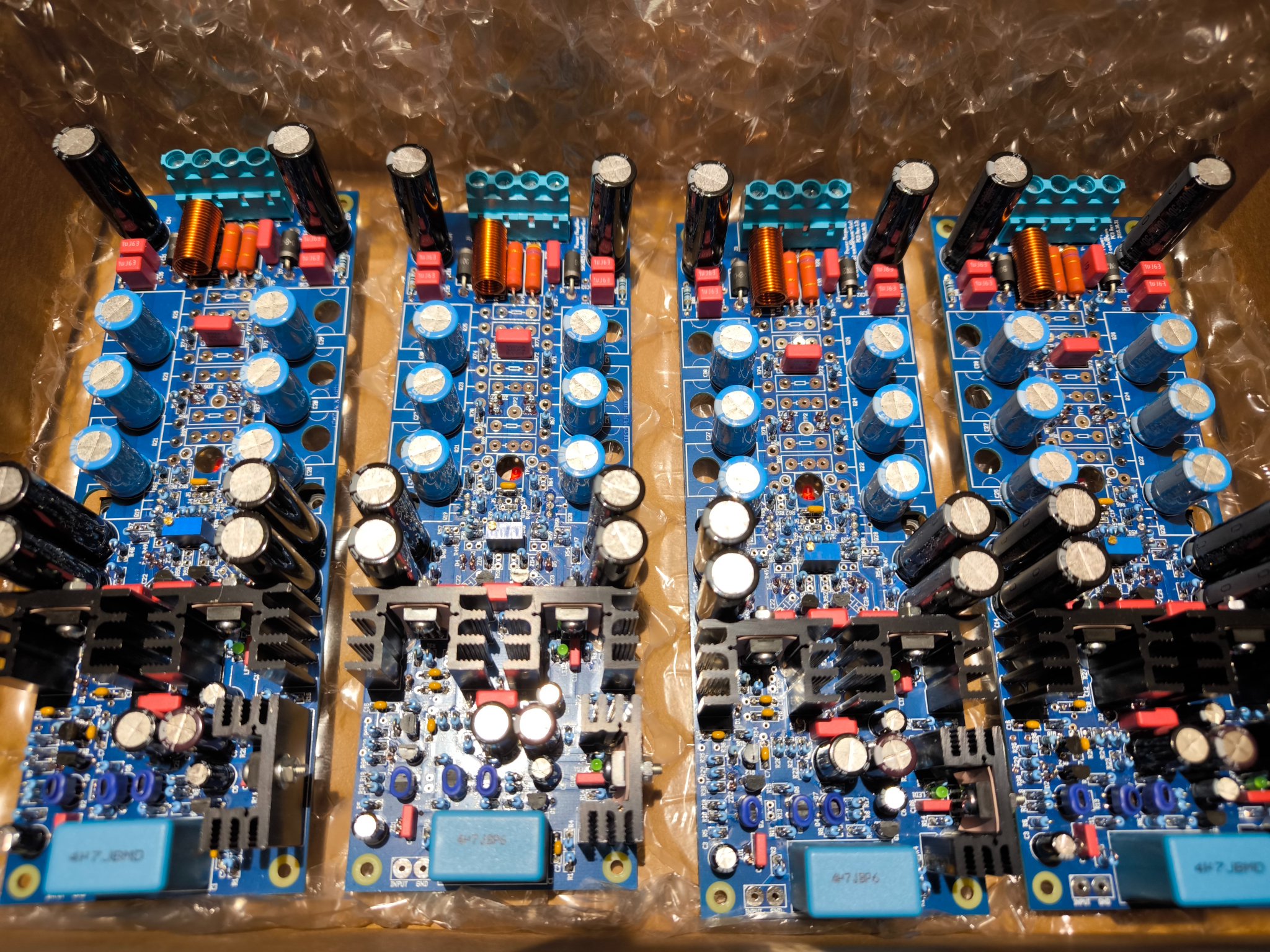

4 modules ready for mounting power mosfets. I'll probably get to that next week, ...I have a working weekend ahead of me 🙄
Maybe you are asking the question why 4 modules? My DIY path leads to active 3 way speakers.
1, active crossover - 2x miniDSP 2x4 HD
2, tweeter, mid - SA2015 (140W)
3, bass - SA2016 (300W)
