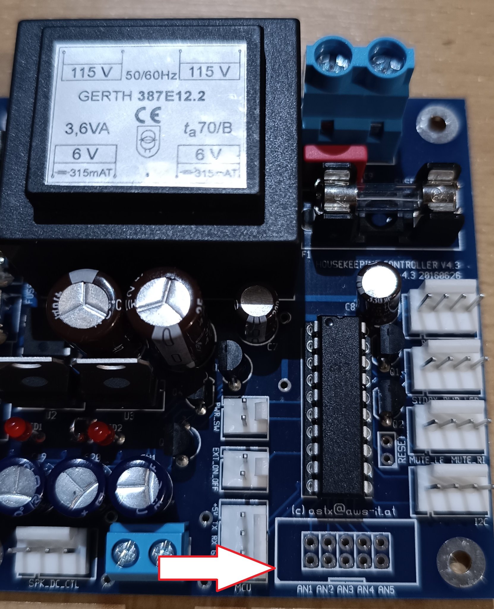

I have used CNY17-4 with DIP6 footprint.
Maybe also the MCT2EM will work too. Just compare the datasheets.
For the AN1-5 ports you can use any type of 2 row pin headers in 2.54mm raster.
BR, Toni

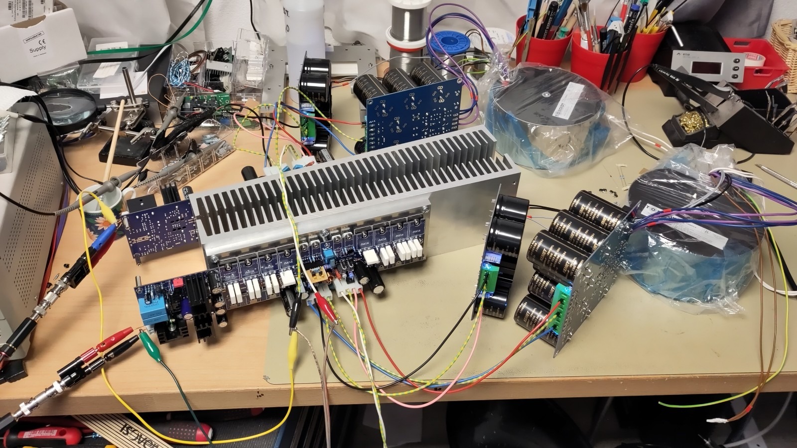

Tony if you can compare of all the amps you've built SA2014 to SA2021, which is the best sounding so far?
Nice Toroidy condoms!SA2021-NCH: First hearing test - IMHO very impressive! 😎
Both are gainwires! THD+N is hardly measureable. SA2021-NCH is higher power, greener and more expensive, much more expensive...Tony if you can compare of all the amps you've built SA2014 to SA2021, which is the best sounding so far?

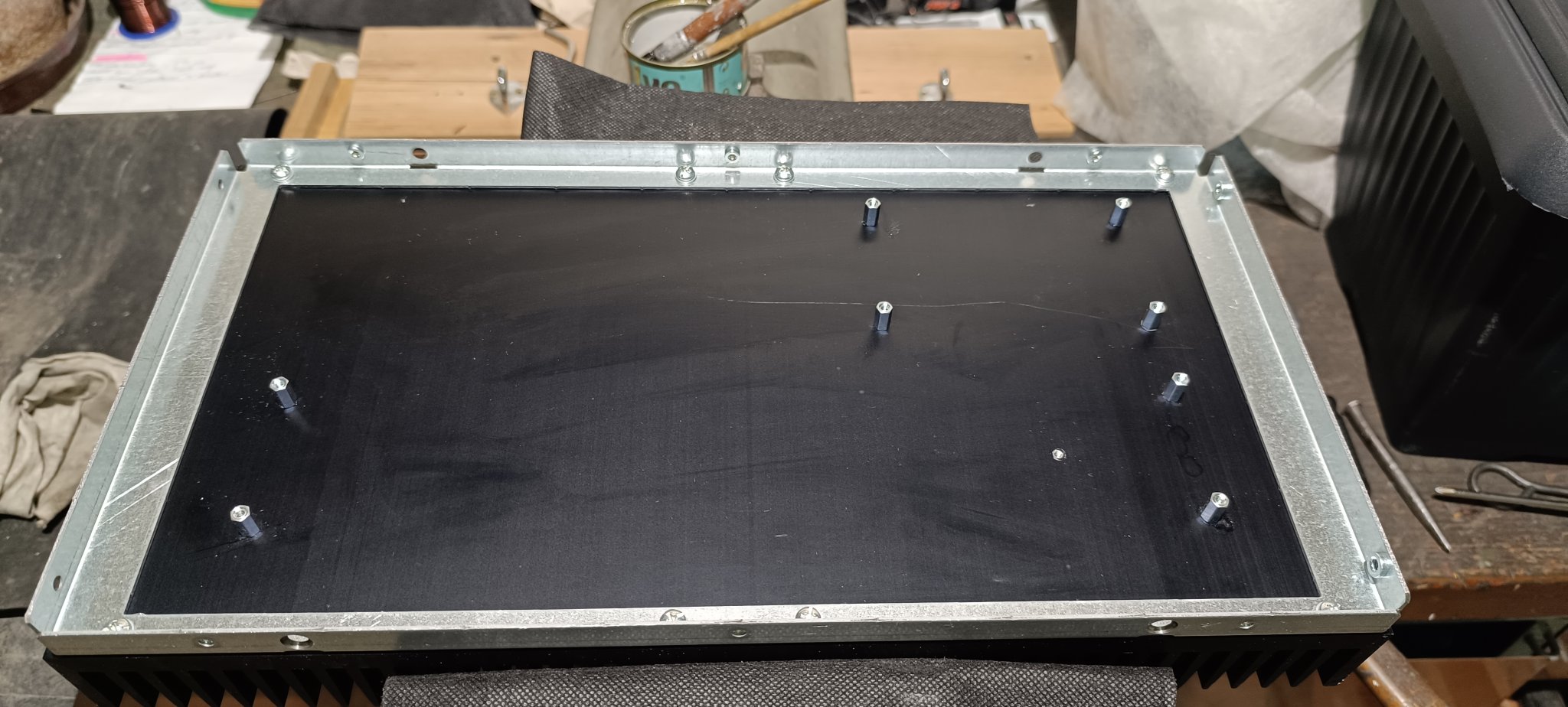

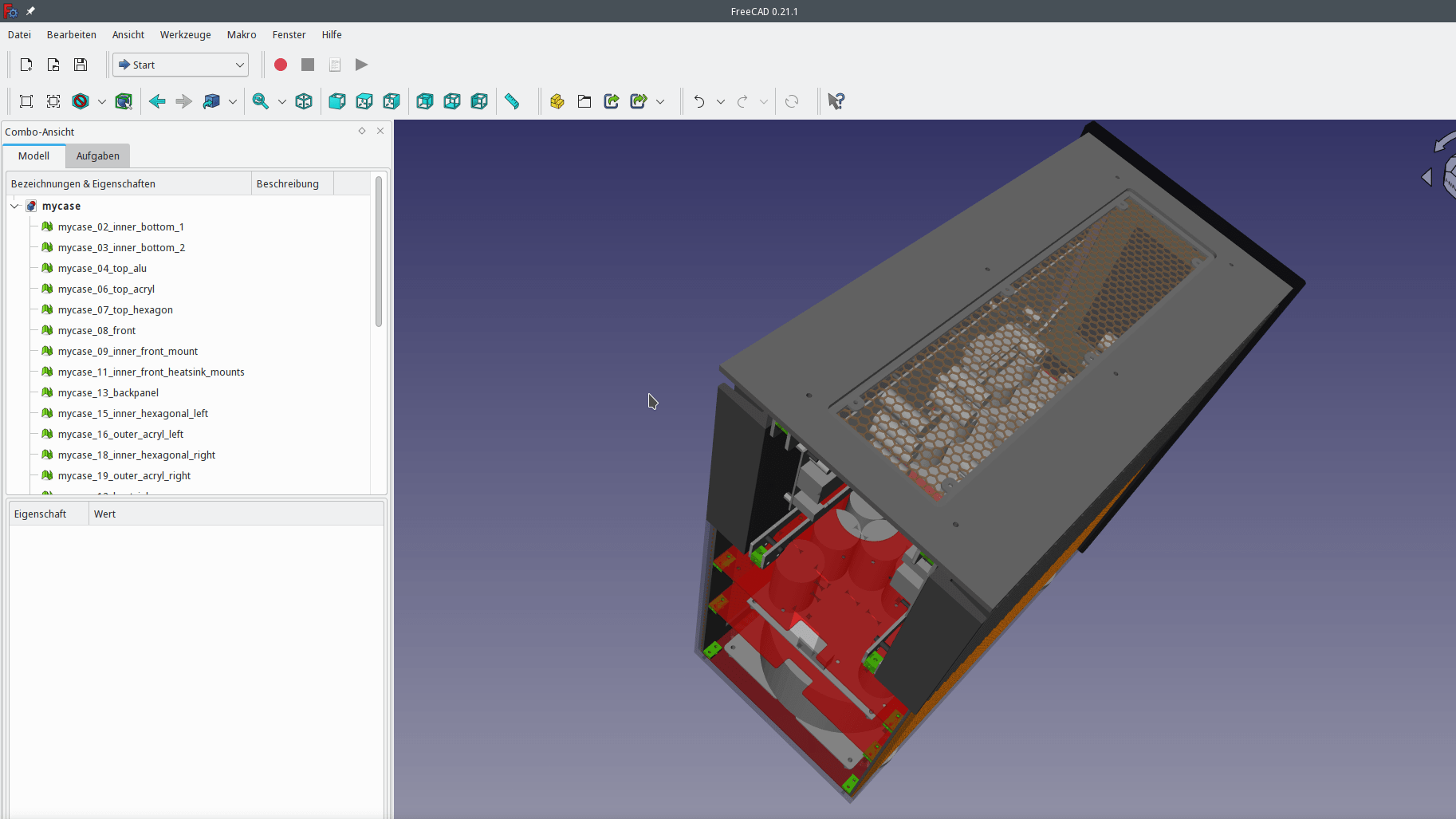

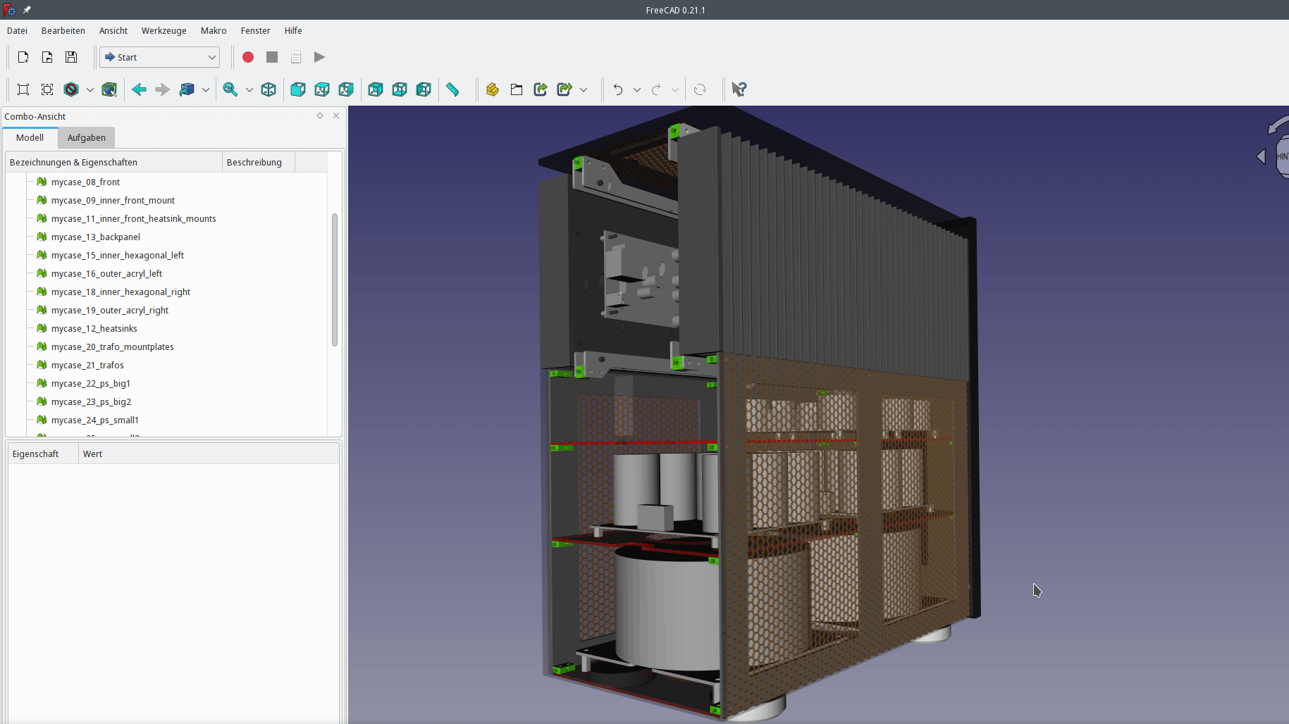

SA2021-NCH: case design study. Would be my first tower design if it will ever materialize ... 😉
Side panels and part of top panel are translucent black acryl so it would allow to have a look inside when LED stripes are installed.
EMI is blocked using hexagonal aluminium panels mounted between acryl and inside steel panels.
Have fun, Toni
Have fun, Toni

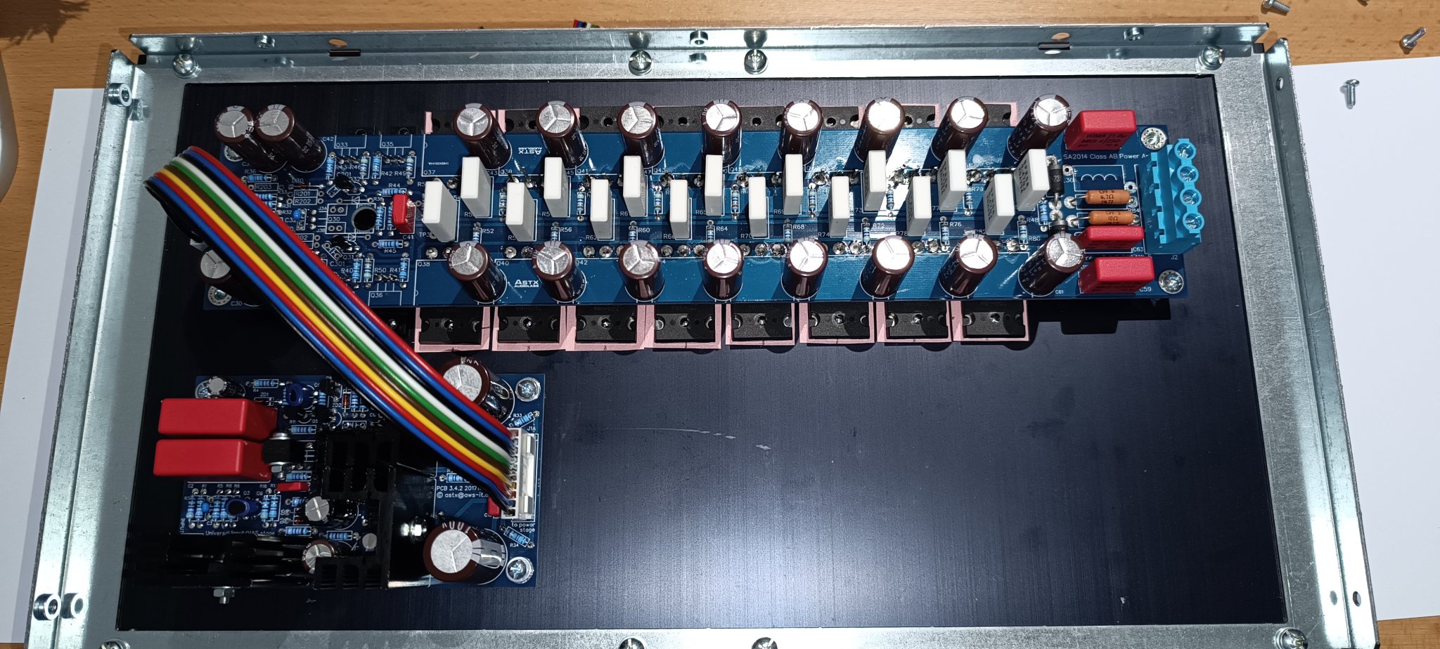

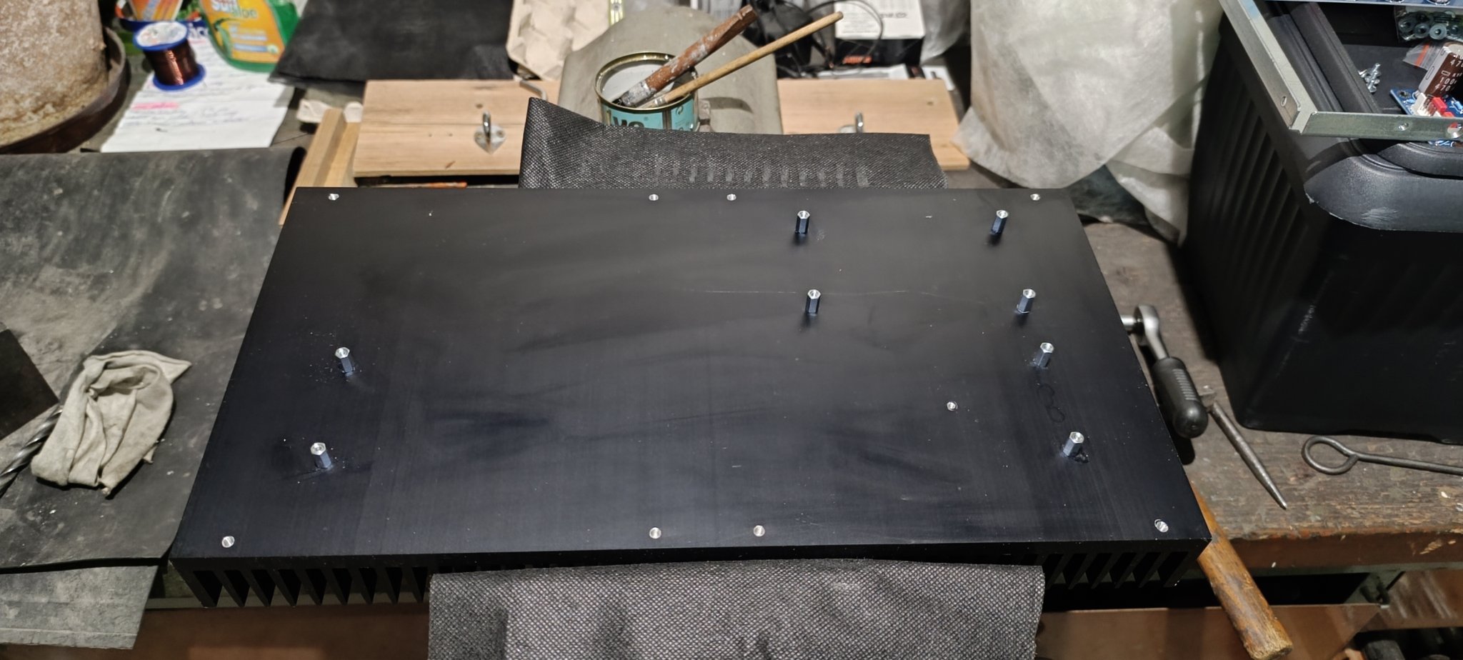

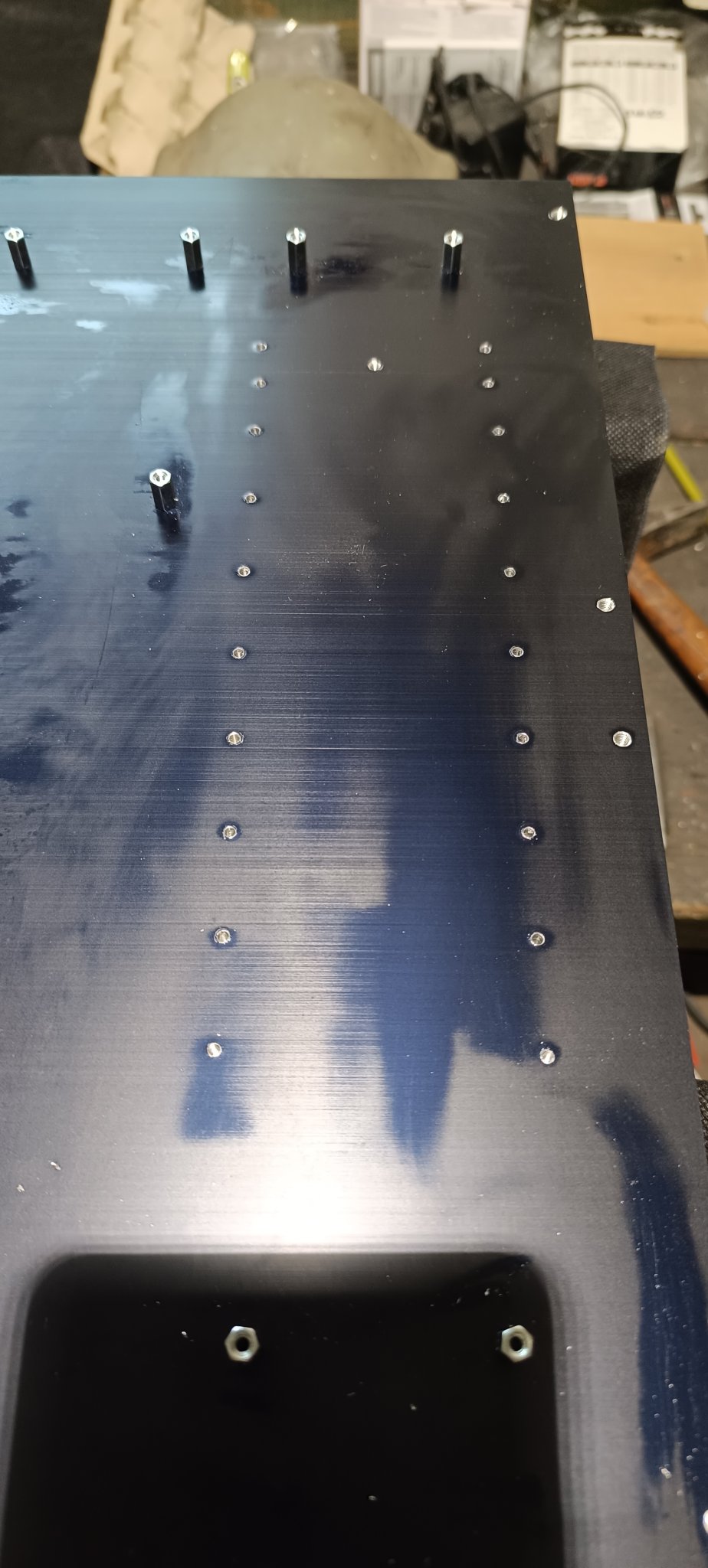

Tony,
I want tomorrow to cut out the pad under 8 transistors, I have Keratherm 86/60 (4.5 W/mK), is it necessary to put paste between the transistor and the pad?

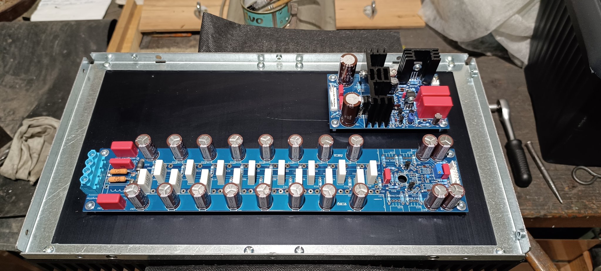

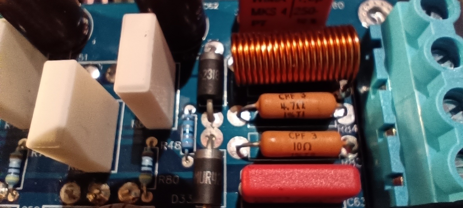

Finally the cable finished, probably ate up most of my nerves! I'm still going to wind the choke and the first test can begin!
I still don't know how to solve the aesthetic side of the pcb, I can't get to all the pins of the transistors to pinch off them. Obstructing capacitors 🙁
May help: Electronics End Cutting Nippers ESD / Vornschneider
Electrolytics should be soldered as last step before final mounting.
