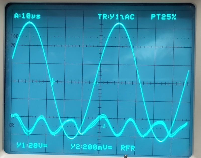

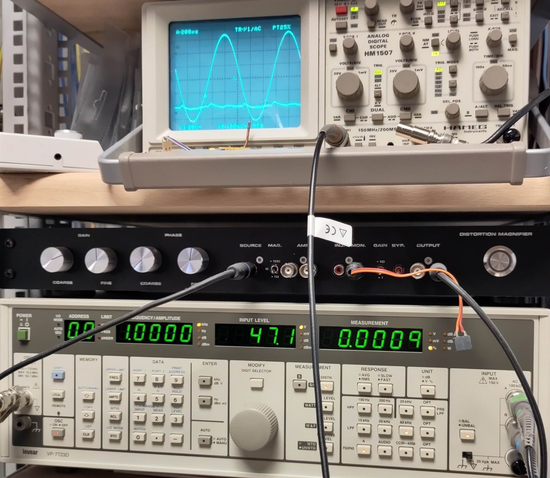

The picture shows the THD+N 20k 270W@8R output wave form and distortion residual measured at the load resistors.
BTW: practically nearly no sticking viewable at overload at 20kHz!

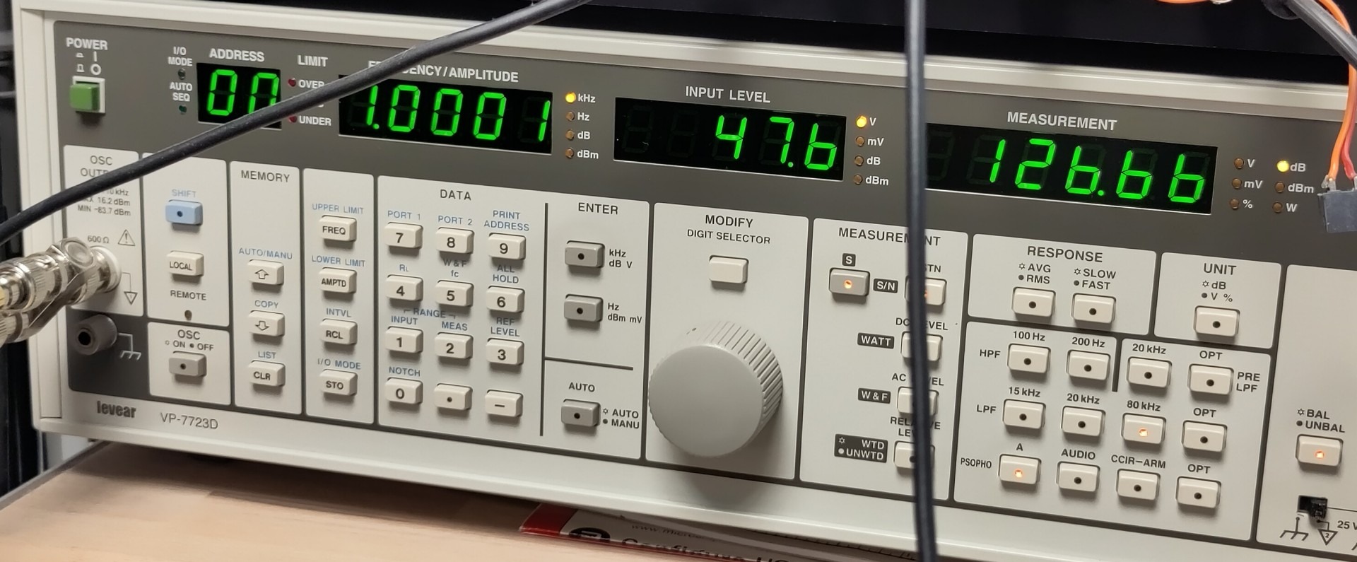

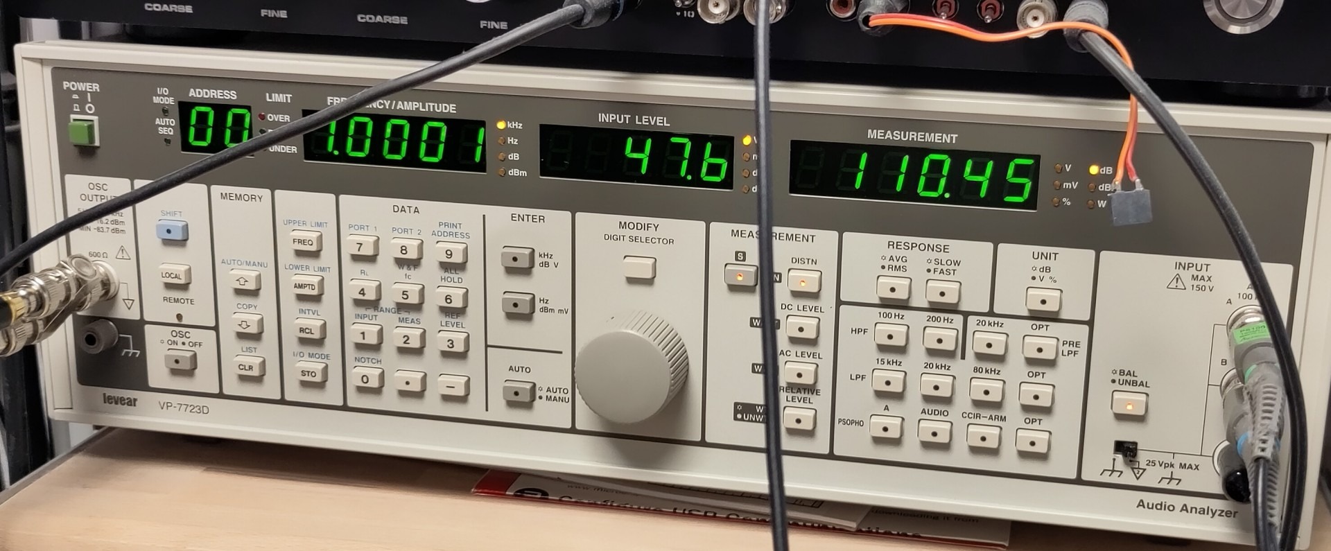

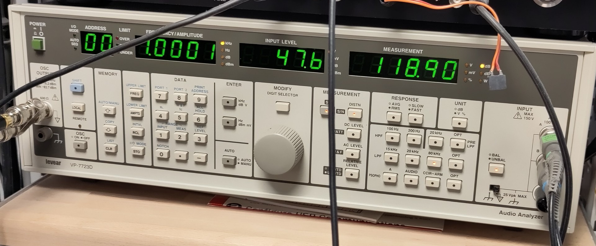

THD+N 1k 277W@8R 0.0009% (power supply limits higher output power)
SNR full bw: 110dB
SNR 80kHz bw: 118dB
SNR A-w: 126dB (my VP7723D limit)

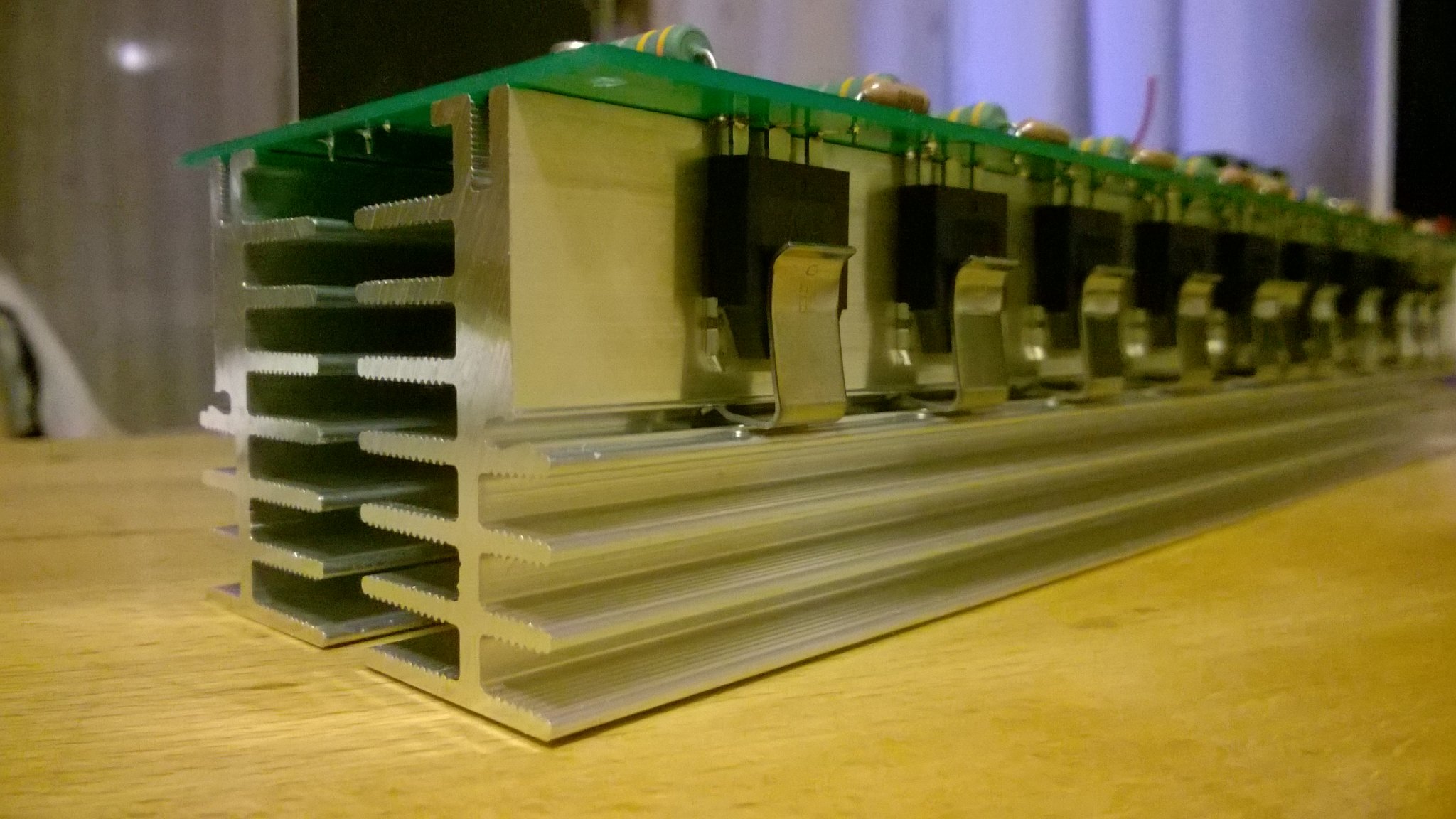

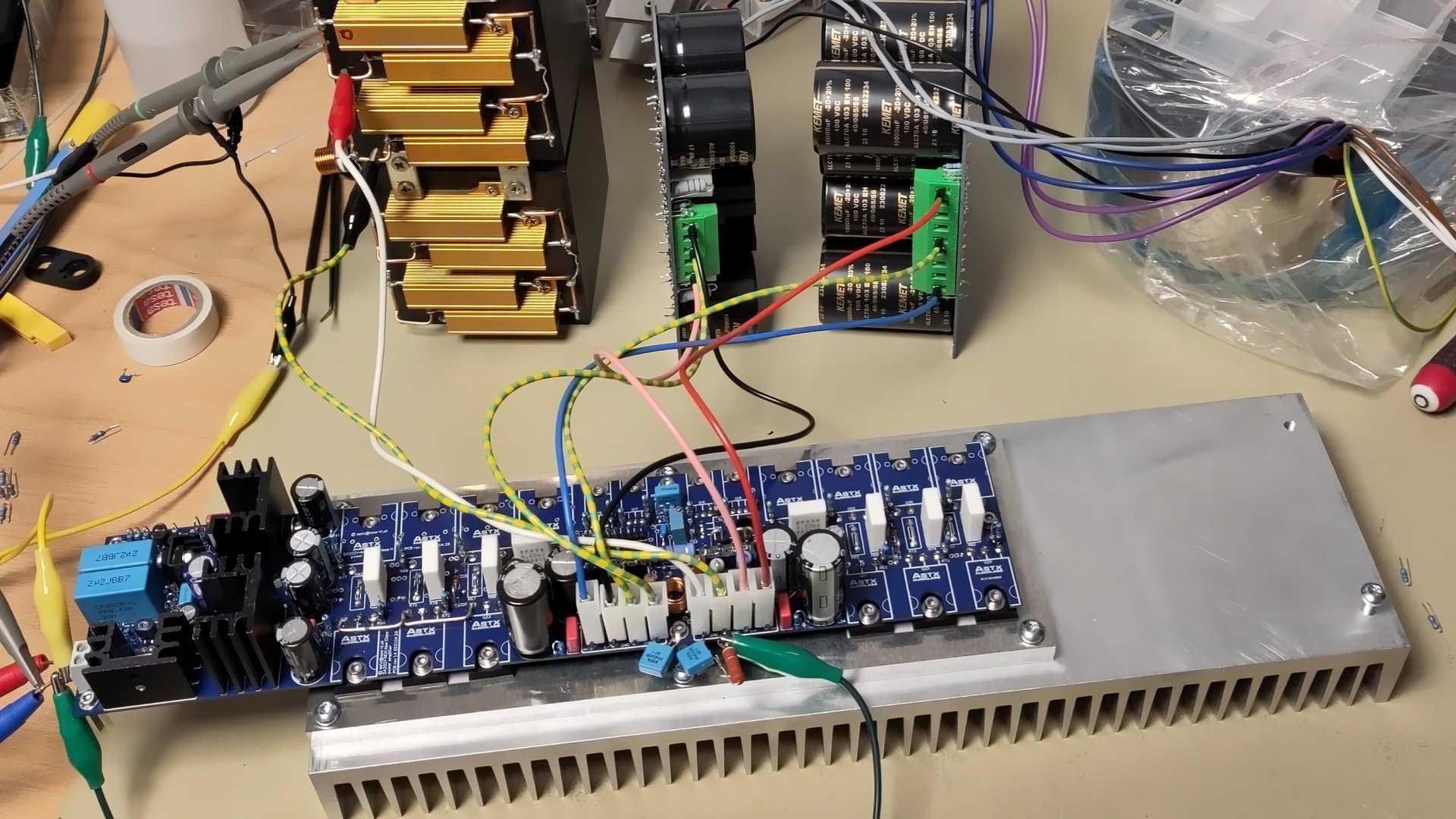

  • LTP degeneration: back to 82R
  • decreased Rgate to 22R for the IXYS
  • added 6x Gate/Drain snubbers 2.2n + 22R
Looks very stable down to 3R load but more testing needs to be done...
Have fun, Toni

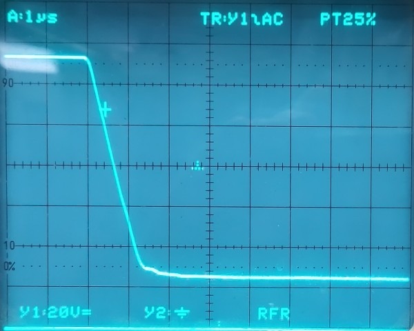

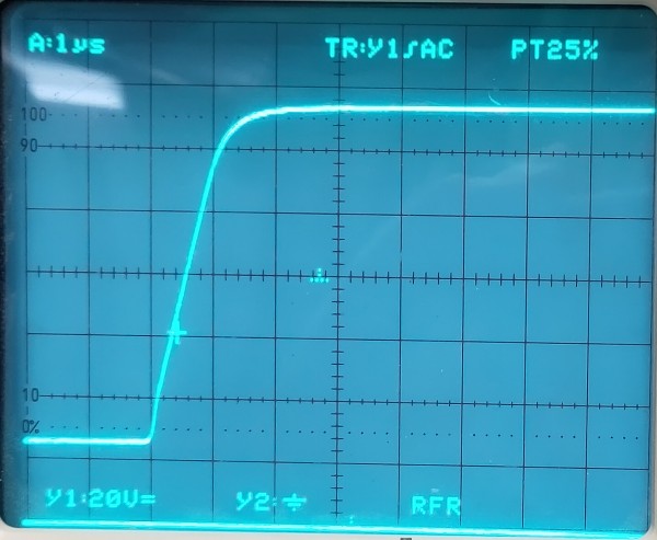

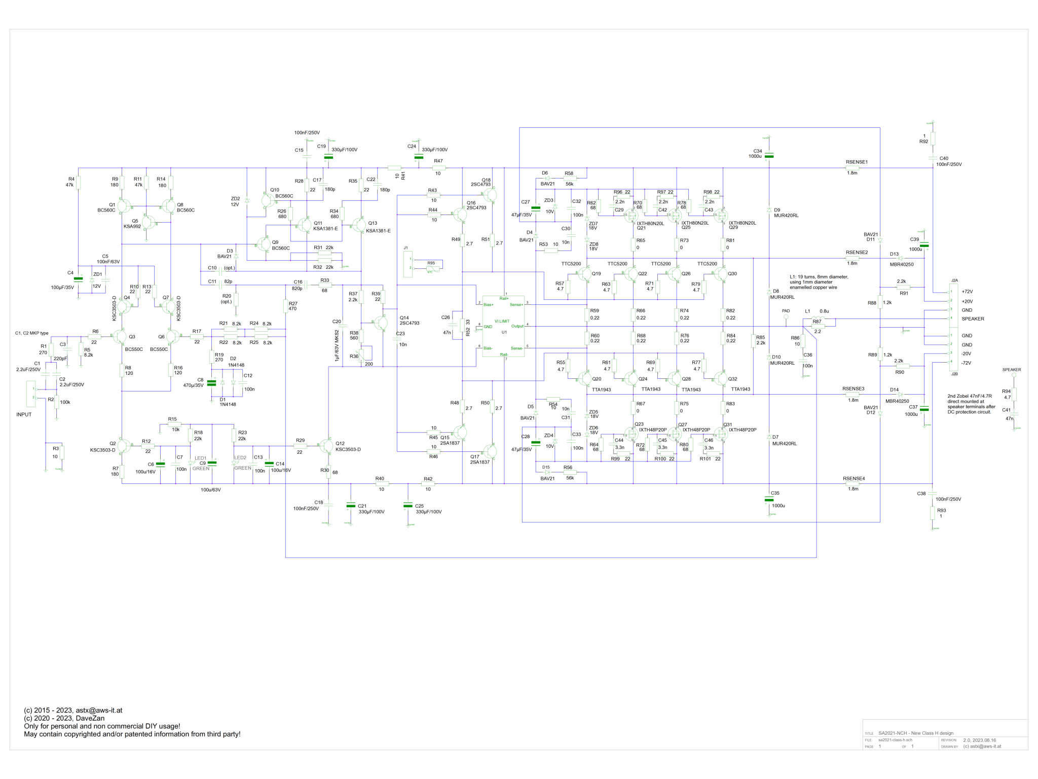

... now a bit closer to a final version ...
The most important changes are
  • C30 and C31 - increased to 10nF otherwise the slew rate suffers. Now I have a clean >80V slew and tested stable down to 3R load.
  • Gate resistors and Gate-Drain snubbers added/changed
  • LTP degeneration increased. A hardly measure-able small THD performance lost for stability.

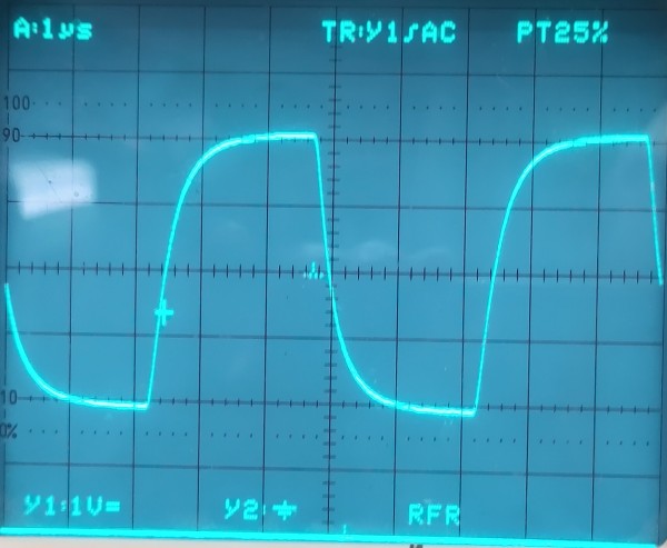

square wave @4R
  • small signal
  • rising edge 80V/µs
  • falling edge 80V/µs
more to come...
Have fun!

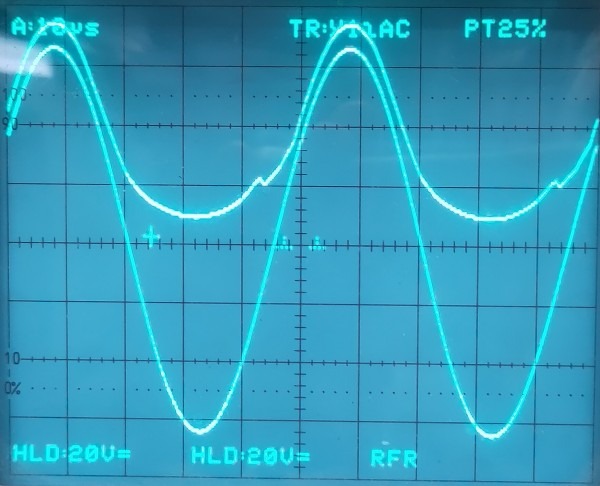

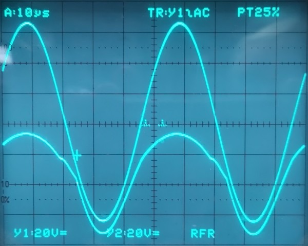

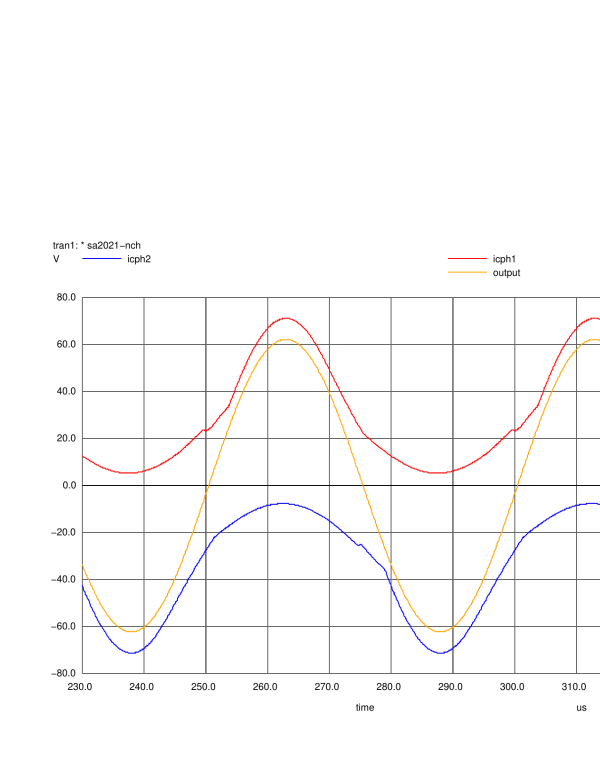

  • upper/lower gate voltages @20kHz vs output level
  • simulation which corresponds to the real world measurement
... now it smells a bit strange in my "ASTXLabs" - the zobel resistors do not like full power 20kHz ...😎
