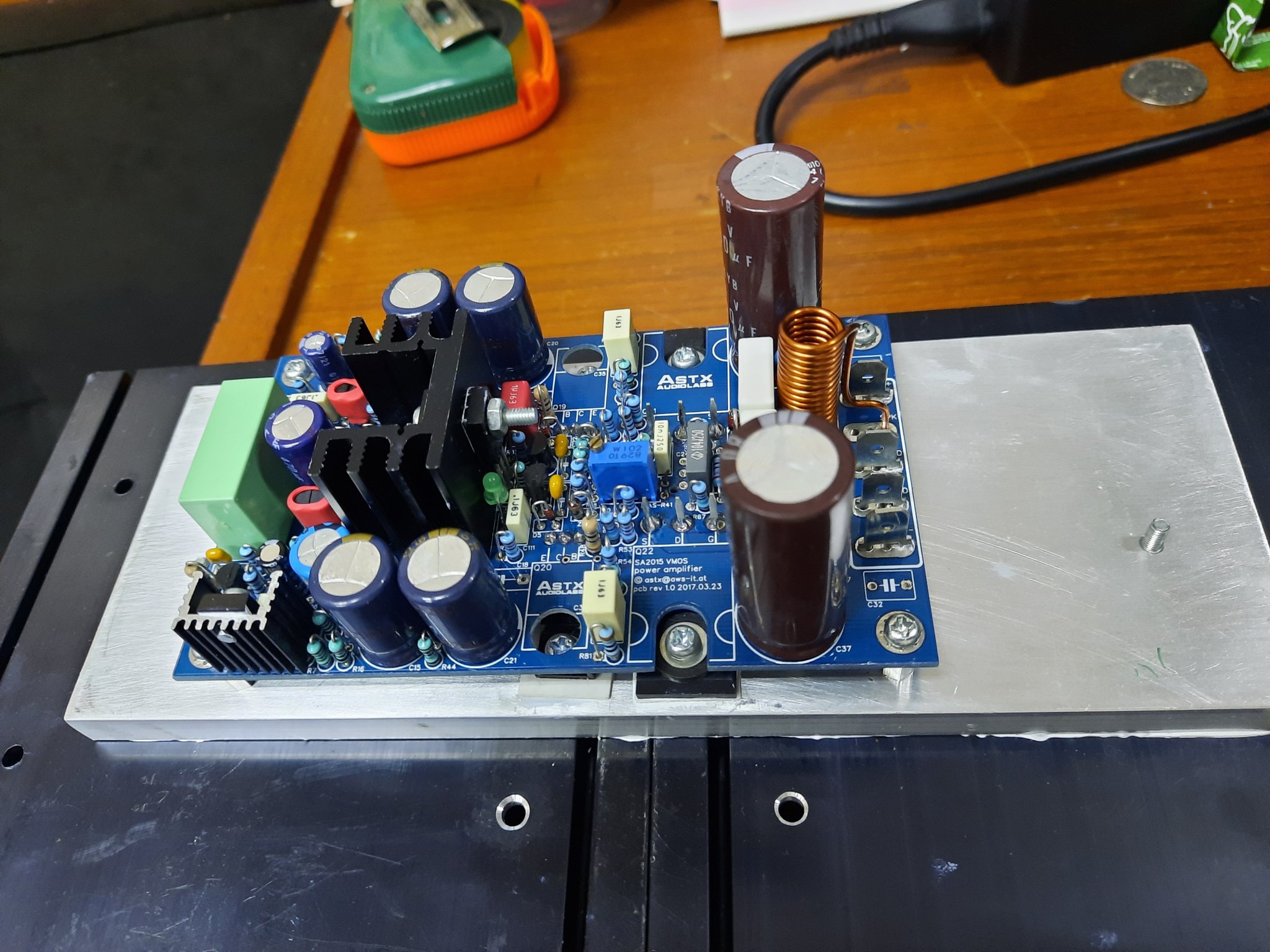

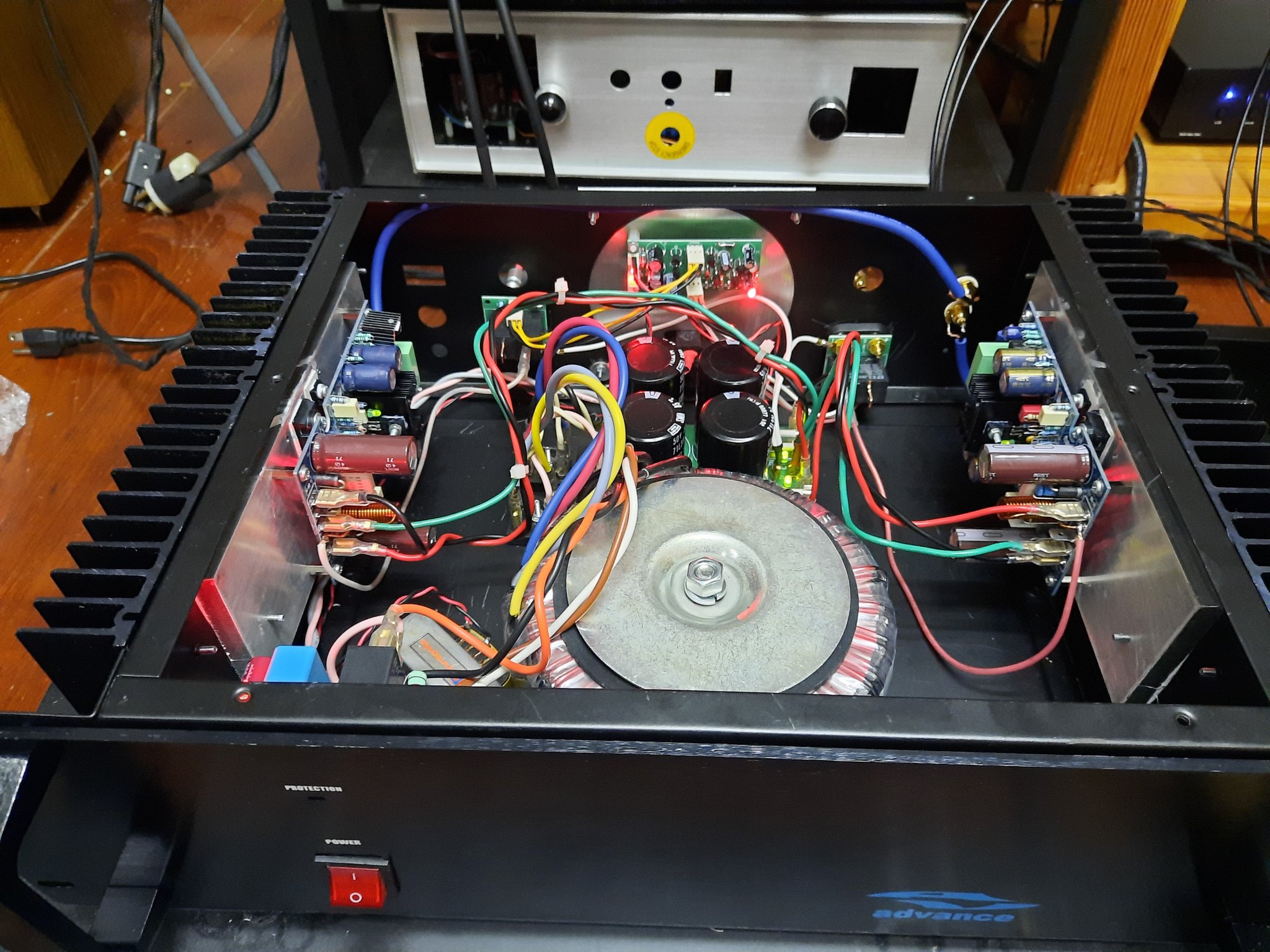

Both channels are singing now. Sound great so far, sound quite accurate. Bass a little bit overwhelming, but I have small room. I think position of speakers need adjusting.
I use 30vac, it is 40Vdc, 40000uf for both channels. Bias is 18mv across 0.12 Ohms.
Bias is stable but offset is a bit high. I have around -58mv (red probe is on speaker output) on both channels. I match hfe but not vbe. Is there anywhere I can adjust this without pull out transistors? Can it be done by adjusting r10 and r18?

If the input ground and the speaker output ground is connected to the silent star ground, offset will be zero...
